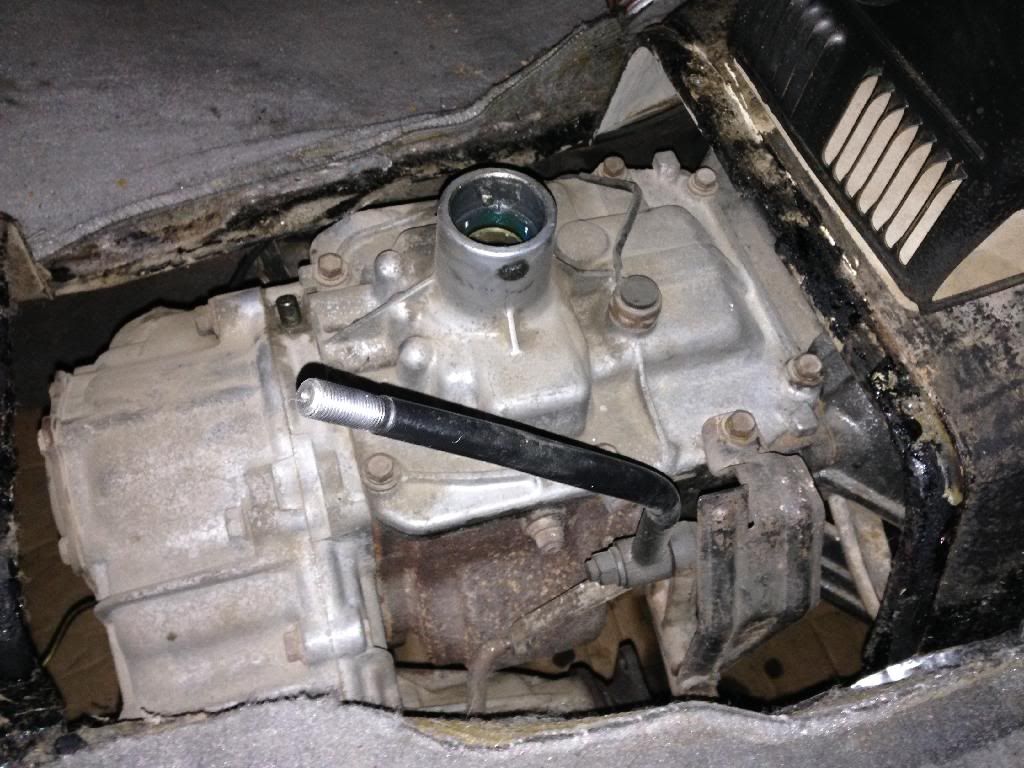

I have the drivetrain installed. I just cannot remember how the transfer case shift linkage was hooked up. Can some of you guys post some photos from different angles that show how the 3 speed set up.
I would like to look at a any. Thanks.
I started looking at my parts for hooking this back up. It seems like I am missing the linkage with the blue circle around it. What is the likelihood of finding one of these laying around? I may need to borrow one so that I can have one made.
Any one up for that?
Threadchaser, I got the part today! Thanks so much. I am going to clean it up and install this week. You saved me from a huge headache.
I having trouble hooking up the lower end of the linkage to the shaft where the new boot is. Any ideas? The shaft has a groove cut into it and no threaded anything. The linkage has a hole in the bottom of it like it is supposed to be bolted. I am at a loss!
Thanks. I have ordered one from SOR, and hopefully, when it arrives, installing this will complete my T-case linkage install! This must have been missing when we removed the drivetrain back in Sept. I never saw anything like this little piece. Without it, I guess you couldn't control the front wheel drive from inside.
Thanks again for all of your help!
part is in, and now we are going to give it a shot. Thanks for all of ya'lls help with this. Some of this stuff is not obvious.
