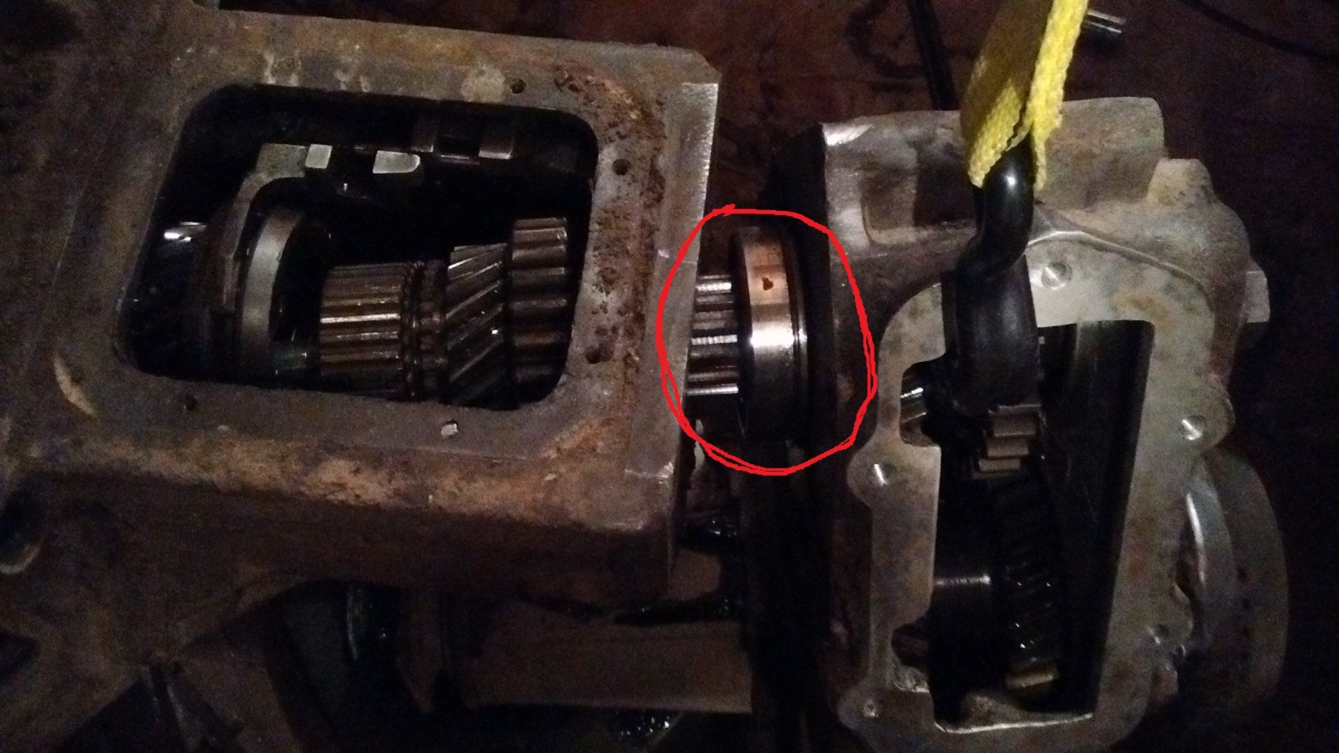

hello, i have a 1967 fj40 and im trying to remove the transfer case. now i read how i should undo the bolts and slowly back it out with a prybar which is what happened but my gears are still on the shaft and i cant get the case off. do i have to seperate the part i highlighted in a red circle?

You need a puller to push the shaft out of the t case
It bolts on where the round tin cover on back of t case is after you remove the big nut and spacer
I made a puller out of a spare cover by drilling a hole welding a nut to it and using a piece of threaded rod to push it out
Geez! Hit that nut with a big air impact wrench and it'll spin off fine. You have a HUGE mess in front of you though since the transmission has now partially disassembled itself. With nut off, you should be able to separate the cases. I've never seen anything like that
Yes, that shaft is the transmission output shaft. It runs through the transfer case and both the PTO and transfer case input gear are mounted on. Remove the nut and the spacer directly under it. Then use a puller or smack the transfer case with a soft faced dead blow hammer several times to remove it from the transmission output shaft. Both the PTO and input gears will fall out after that
Unfortunately as others have stated, you're in for a transmission disassembly and reassembly also at this point
