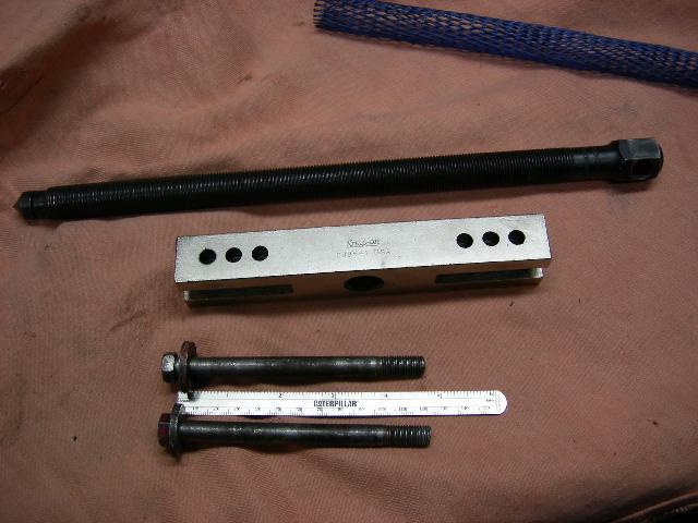

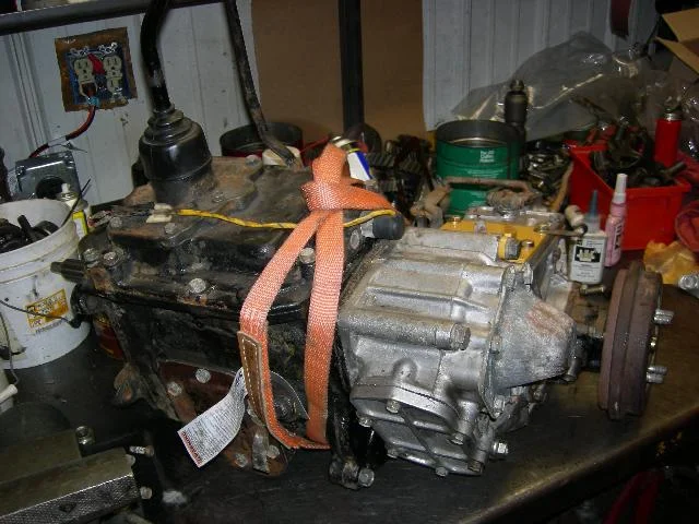

So apeterson stopped down today. He wanted me to re-seal and gasket his transmission and transfer case, and pick up some other goodies for his build. While doing this, I opened up the parking brake/transfer case rear output seals housing to accept two seals. It appears that no one has ever been into this thing as the three long bolts that retain the transfer case to the transmission still have the green locktite on them that comes on the new factory fastener as will be seen in the following pictures, along with the orientation of the transfer case input seal. It was very clean for being a 1975 unit. There are also pictures of the puller that I use to separate the two pieces.

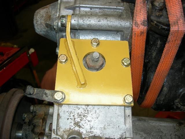

Got him loaded up and back on the road this morning.
Pics of the assembly and of the case saver installed:
