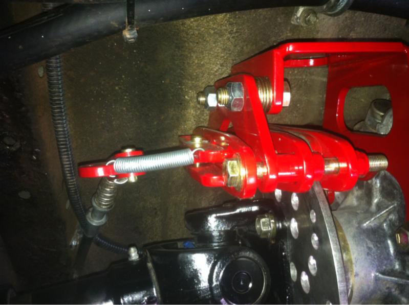

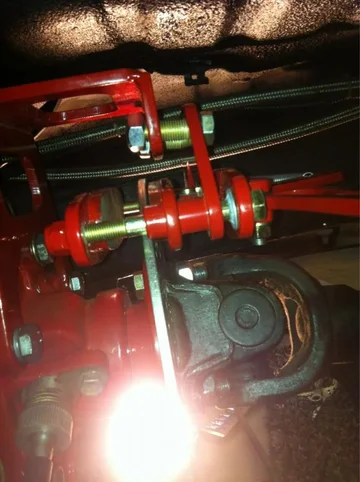

Anyway the directions were a little vague. One pic would say a thousand words. Other than that its really built well. I think I can make the original parking brake cable work. Or at least give it a try.

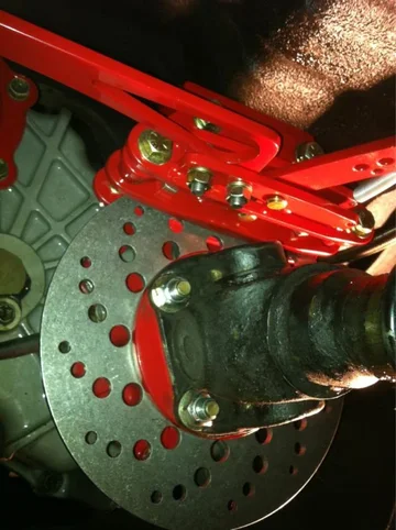

My biggest mistake was thinking the disk went between the flange and the DS. It doesn't.
Right way.
Wrong way
The caliper is well built.

My biggest mistake was thinking the disk went between the flange and the DS. It doesn't. .
so the disc goes in from behind the flange .. ( so you must remove it to install disc ) ..

I think i messed up
I just got done installing this brake. and i installed it in the way what you called wrong. I am curious why it is the wrong way? I used the washers in the kit for spacers on the top bolts. It works for me, but i seem to manage to get a square peg in a round hole all the time, if you know what i mean.
I agree with the directions... not best.

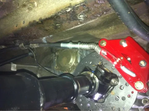

I did get the e-brake cable to work. just reused some of the springs and shorter it down to the first metal piece on the cable that is down line from the floorboard hole. It should be around 30".
E brake cable set up. This is how I set up my transfer brake. It works so far but I might be lucky. Actually I probably am lucky.
