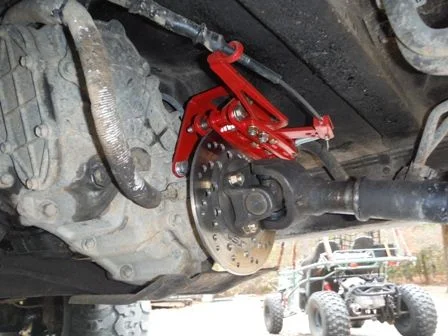

We installed one of those kits on a buddy's FJ62 not too long ago. The bracket can be used in any orientation on the transfer case. It does not have to be that low. When we installed the e-brake setup, we clocked it as such:
attachment.php
Bringing this one back from the dead; do you remember if he had any degree of body lift to accommodate that setup? I run a 1", but TSM recommends at least a 2" to have it mounted up like this. I have no desire to add another inch so I was curious if you managed to fit it with less than 2".

I may go ahead and order it when I can drop the cash, and if it just can't fit mounted high on my tcase, I'll modify the bracket like Chris did earlier in this thread to tuck it up tight and mount it low.
