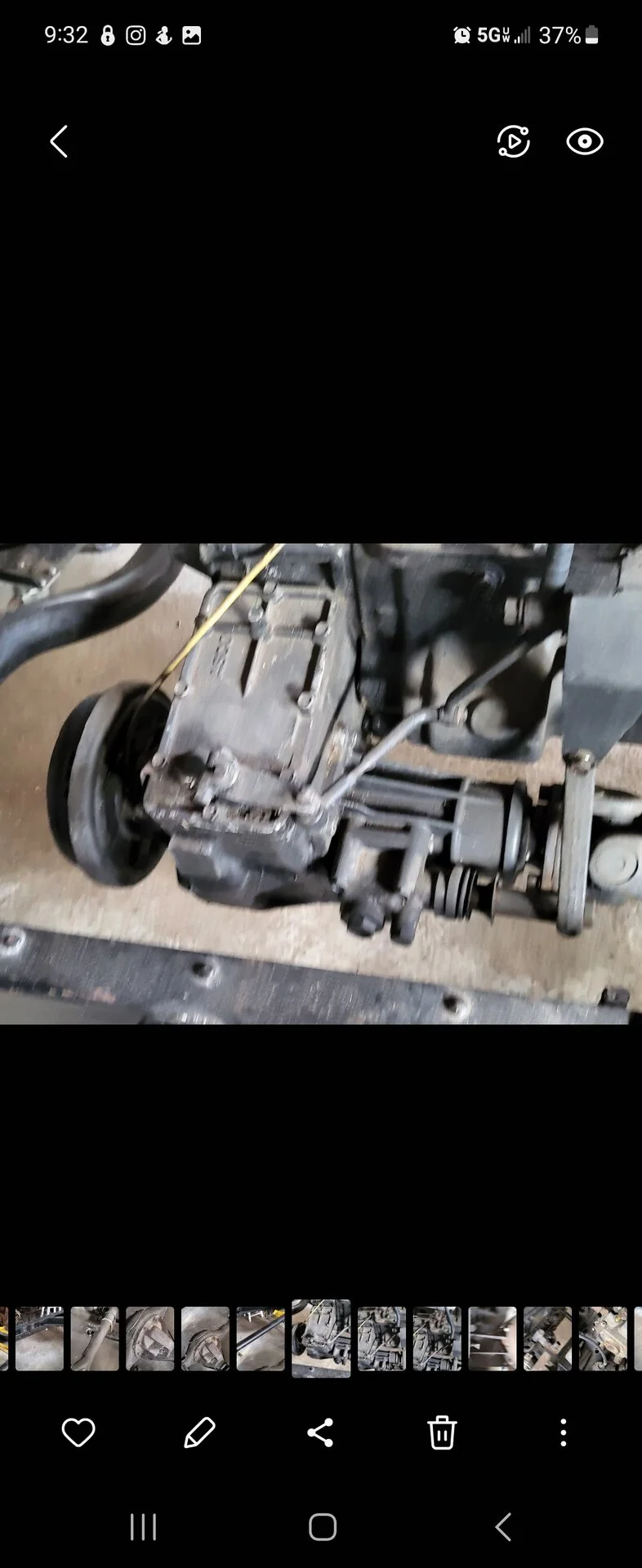

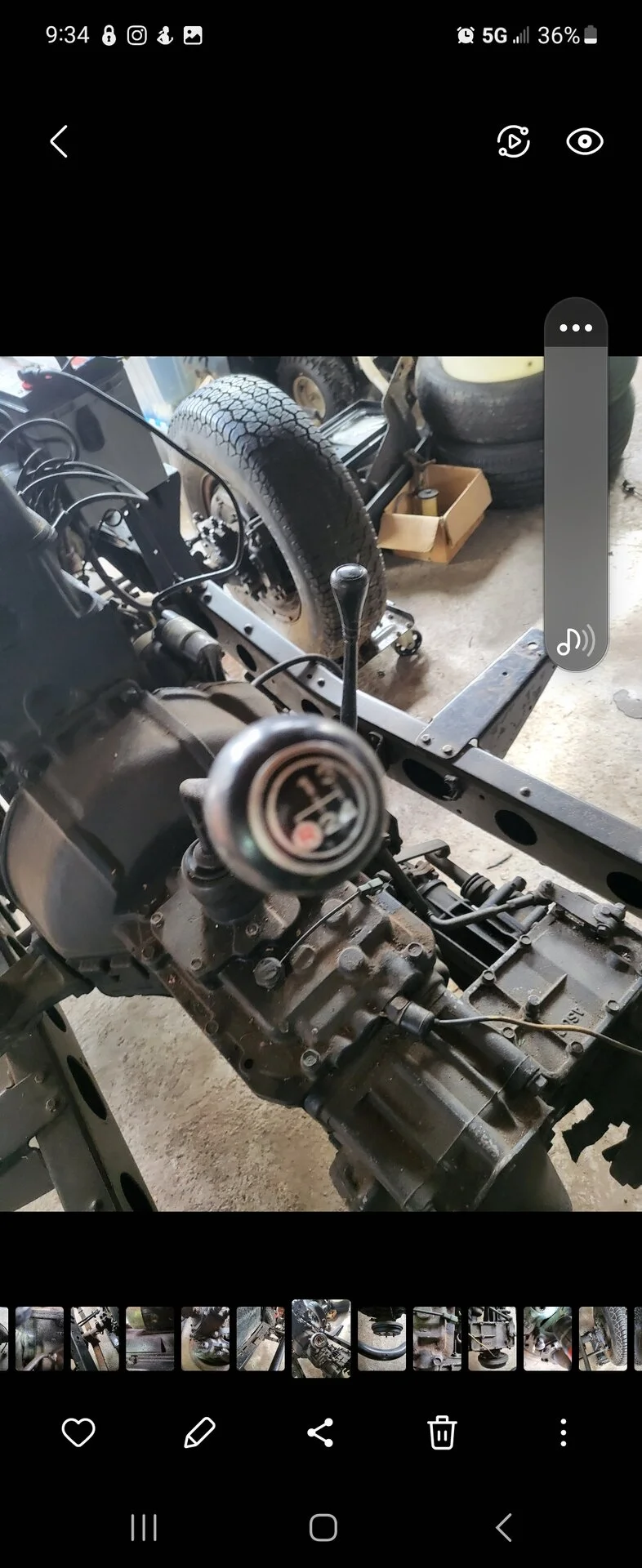

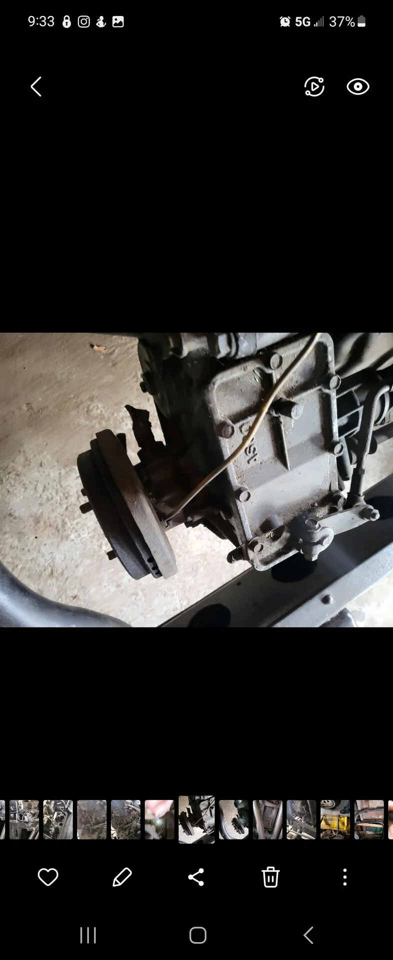

I am out of town so have to go off pics can someone identify if this is a 3 or 4 speed transfer case thanks
PIA to try and manipulate the pic's for me. I have a 4sp tranny with its transfer case sitting on the porch.
The 72 has the original 3sp tranny with its transfer case, but I'm not wanting to go lay in the snow to look at it.

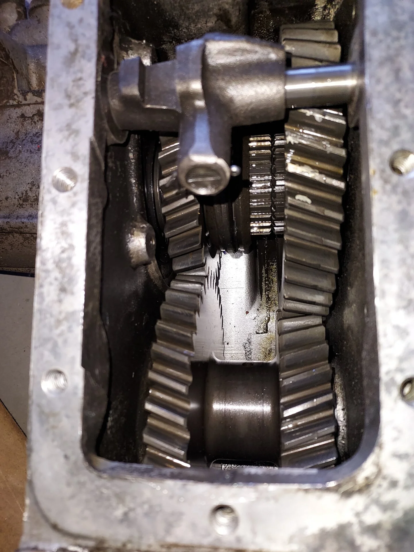

Easiest way to tell is a picture of the idler gear.
This transfer case style has three different gear sets.
Three speed has narrower gears. Input gear has twenty nine teeth. 1-74-4/75 four still has twenty nine teeth. Input gear and high range gears are narrower. Low range gears are wider. So idler gears are two different widths. 5/75 and newer input gear is wider as well as all gears and has a thirty one teeth on the input gear.
Here is a 11/74 transition case. Idler gears at two different widths.

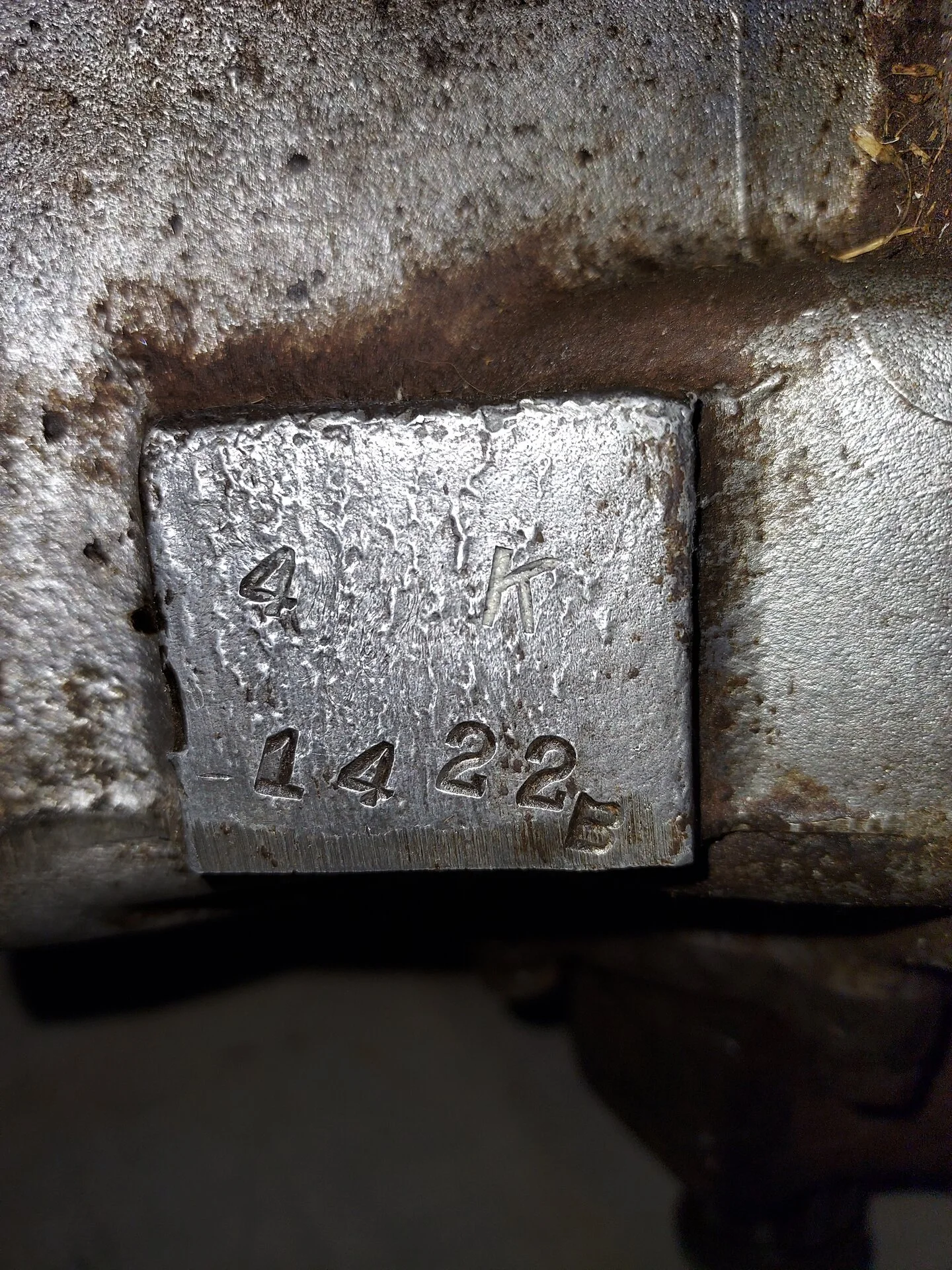

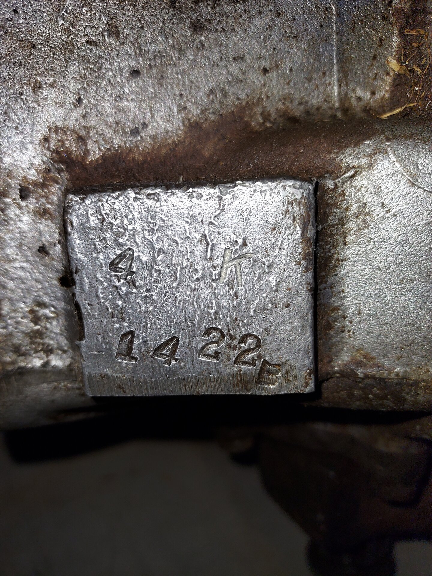

4 is for 1974. K is for eleventh month, November. Other numbers are the case made that month.
The only real advantage of the transition case is the twenty nine teeth input gear with sixteen splines that fit the four speed. Low range gearing is the same as the later case with all wide gears. But with that input gear can use the rest from a three speed case and have a lower low range.
This one the high low shifter is 4/75 newer. But just changing the top cover could be change from the earlier style. I say this because my 79 was changed out at some point with a 74 transfer case and has a hybrid linkage using some of the pre 5/75 and some later pieces. Next time I pull the transmission and transfer case will change the high low lever that points to the right to one that points forward like the one in this thread. So that alone can't be used as a reliable way to what a case over forty years is.
