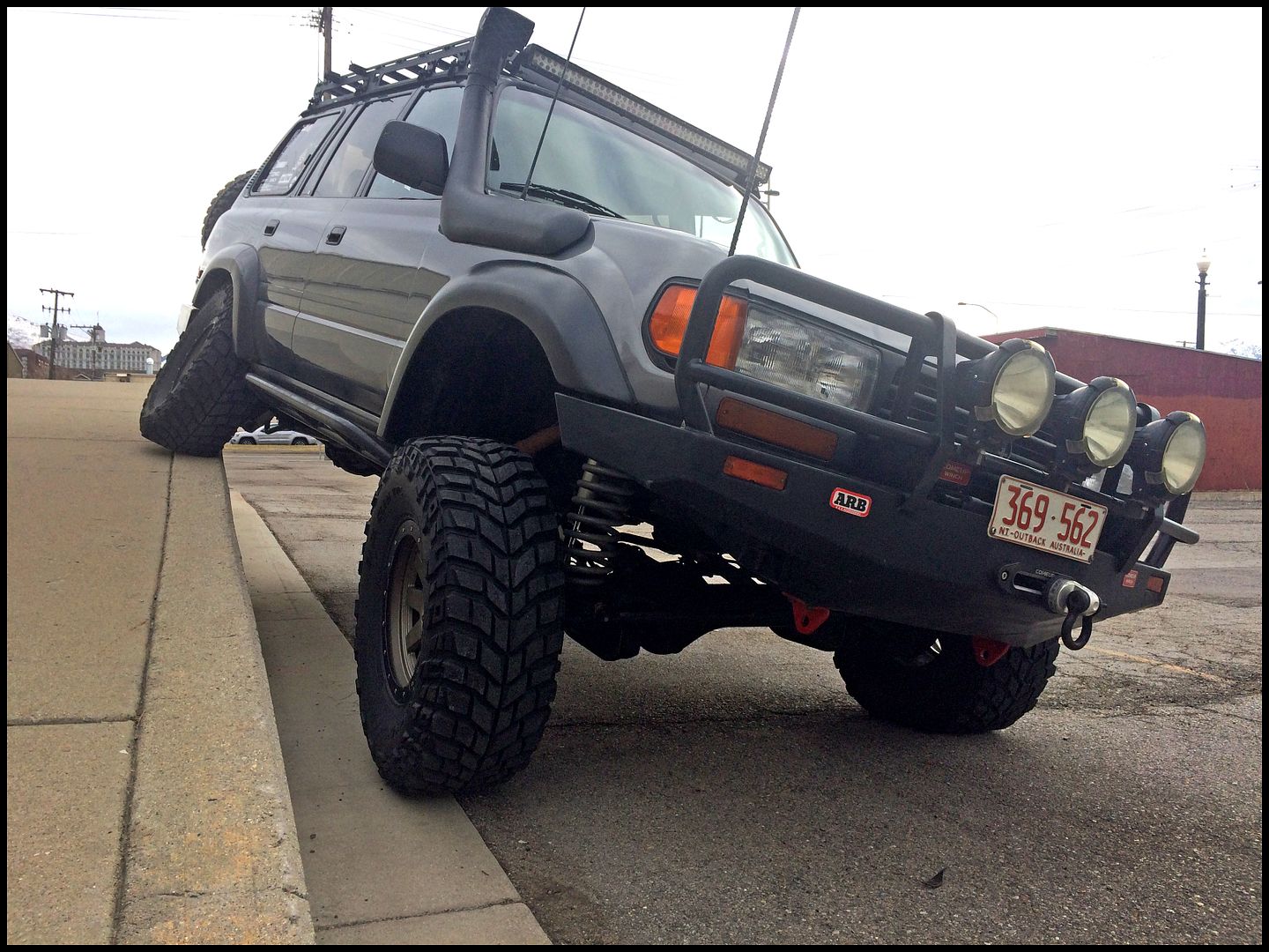

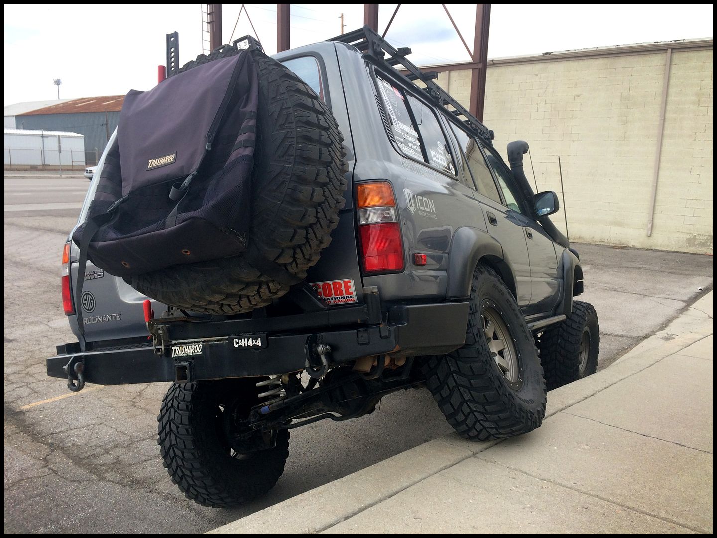

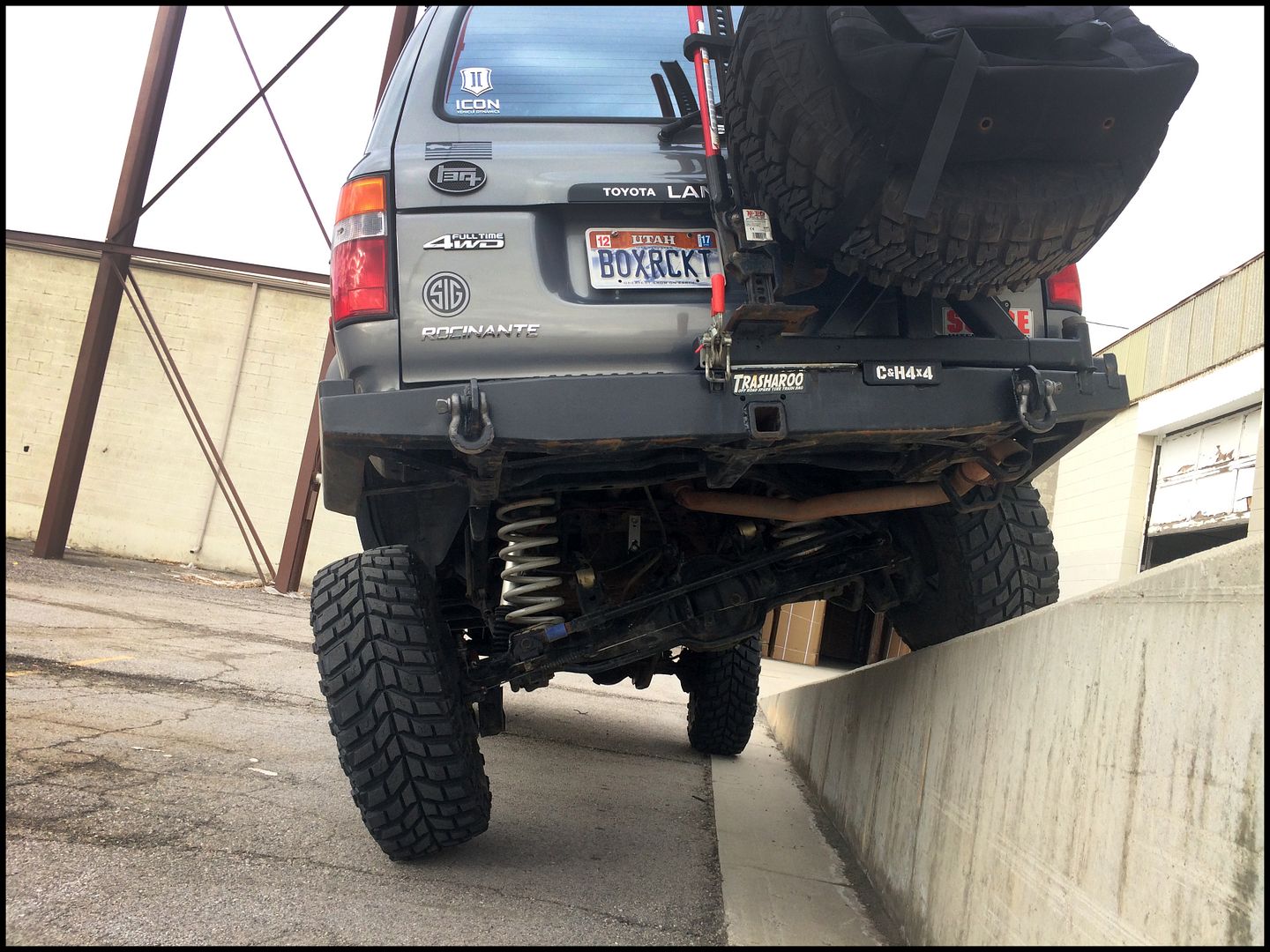

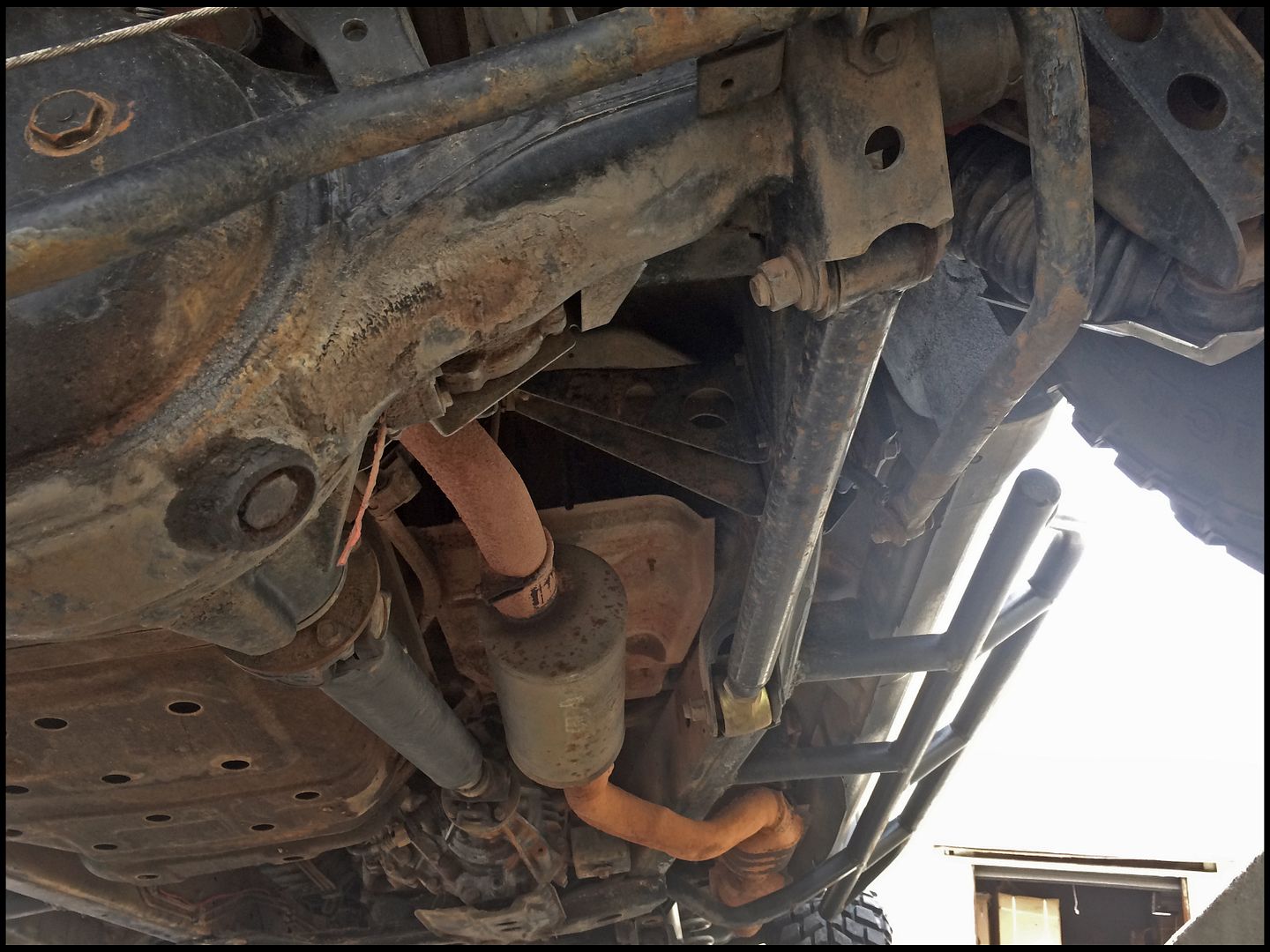

I've meant to get some additional photos up for a while but winter hasn't cooperated. So I had to resort to some "urban wheeling". :)
There's a few things at play here. For starters, the Slinky suspension has lots of flex on its own. In these photos I was NOT at the limit of travel. There were still 4" of shock travel left and more than that from the springs. Front and rear sway bars still attached.
However, it was clear than the Trail Tailor arms are allowing for a better range of motion and smooth operation. You can see the Johnny Joints deflecting and there is no compression of the poly bushings in the arms. All evidence of no binding, resulting in no limited travel from the arms. I'm confident I'd run out of spring and shock before the arms would fully bind. Also, no visible sign of "rear steer" from the axle when flexed.
I'm really pleased with the combination of the Slinky suspension with the Trail Tailor arms. The arms would be a nice compliment to any suspension and a clear upgrade from stock.
