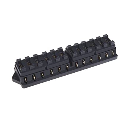

Which I could build using a cheapo 12 circuit panel and jumper wires:
Right now I'm leaning toward:
-wiring the alternator to the battery directly, with a circuit breaker
-using the last diagram with the 12 circuit panel
-Engine/starter/headlights/turn signals/whatever's left as it fits with what I have
