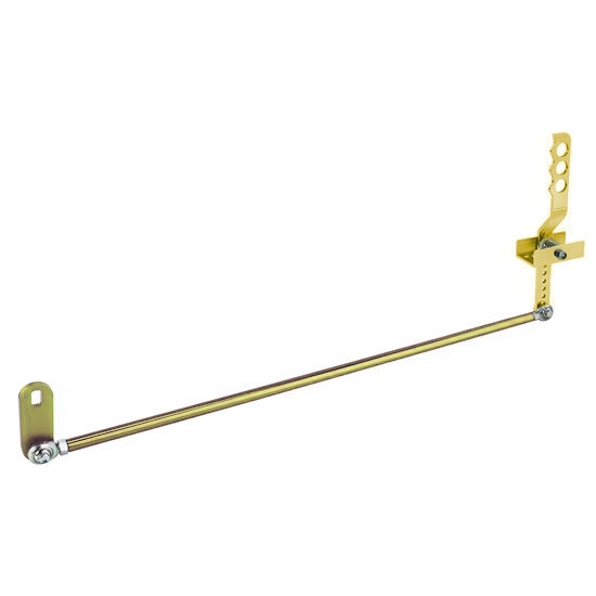

been looking at what to use for an auto shifter, my budget won't really allow for something nice like a Lokar or B&M....I found a 60's/70's Corvette shifter for a few bucks, but i think it's too short as-is.
The mechanism and detent stuff will help me build something out of it i hope, failing that, i've also been looking at the circle track style...i could easily home-make one, but there's no extra detents or lockout for park or reverse or anything.....
