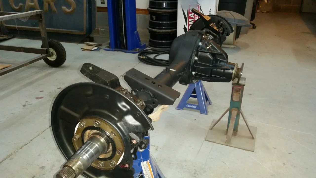

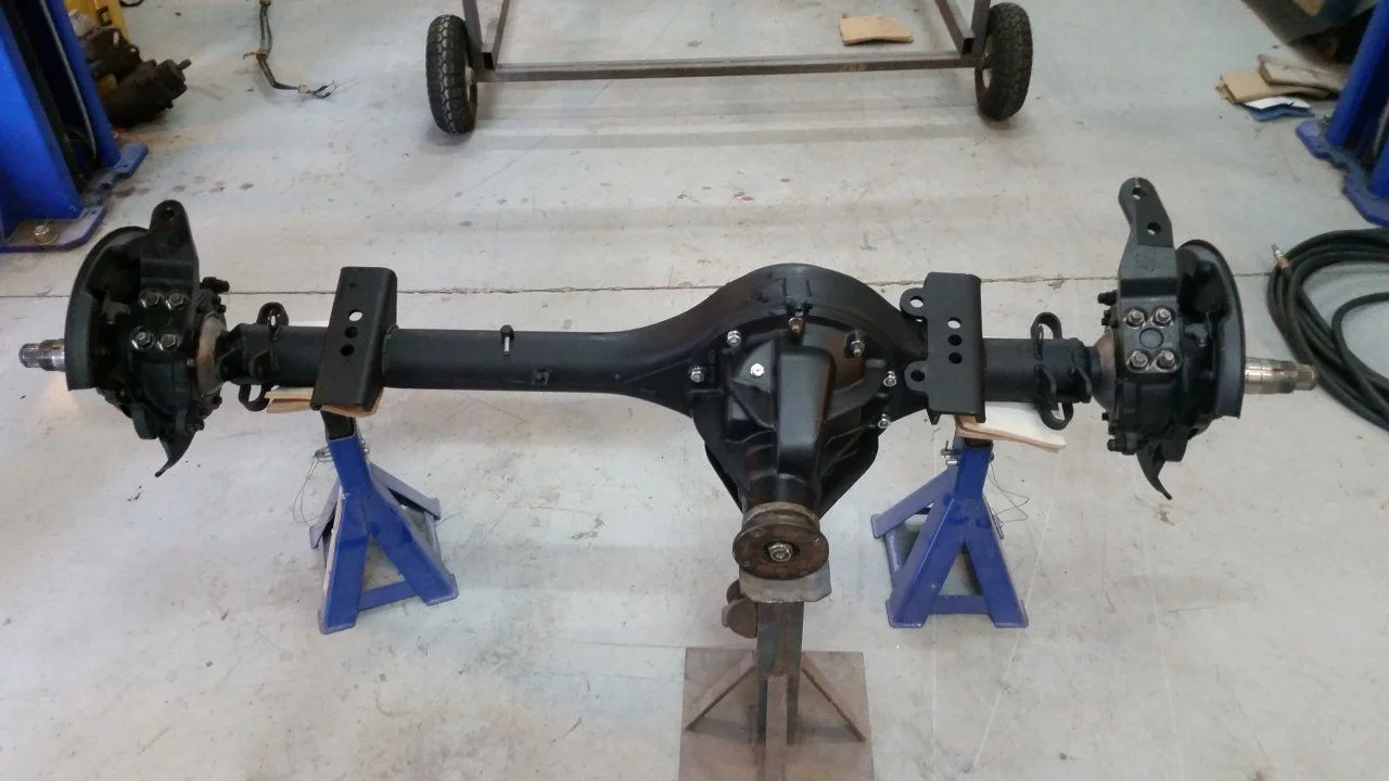

It was like a 5 year old waiting for Christmas last night. All I thought about was working on my front axle. So, went to up to Santa Lee's and got the front axle built out to the spindles. Thanks a million Lee, really appreciate it my friend
20151015_180916-jpg.1147677
20151015_180950-jpg.1147678
20151015_180930-jpg.1147679
Gotta love Santa!
Looks very nice, and I'm jealous.
Gotta love Santa!
Thanks Doug. Can't wait to get it on all fours and ready for the next step.
Is that an air line into the diff? :)

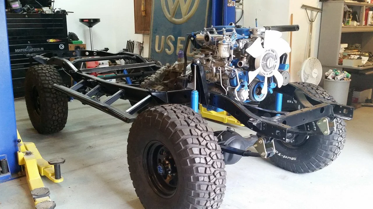

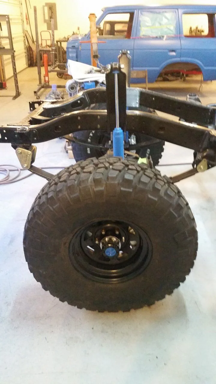

Got the front end all finished up and sitting on all fours
I'm seriously jealous of your shop size. I have a 2 post house too but my shop is 1/3 the size. Makes it a tight work space lol
What size km2's are those?
They are 35x12.5x15
Having a big shop has always been a dream of mine. Like my father said though, "no matter how big you make it, it's never big enough ". I'm already wanting to add on, lol
