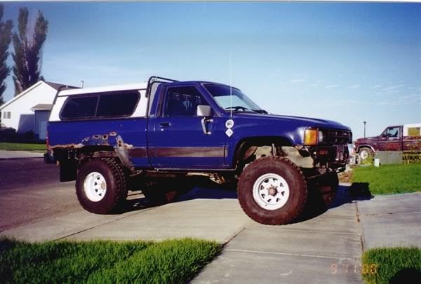

Not entirely true, I don't know how many were made but sorta rare and I've been looking for this bed for a project. 4x4 flared fenders with rolled edge and hooks.
I'm not convinced. That truck was either a one-off custom job, or it's a fiberglass replacement bed. With all the other crap bolted on that thing, could be anything. What's up with those mirrors? :eek:
