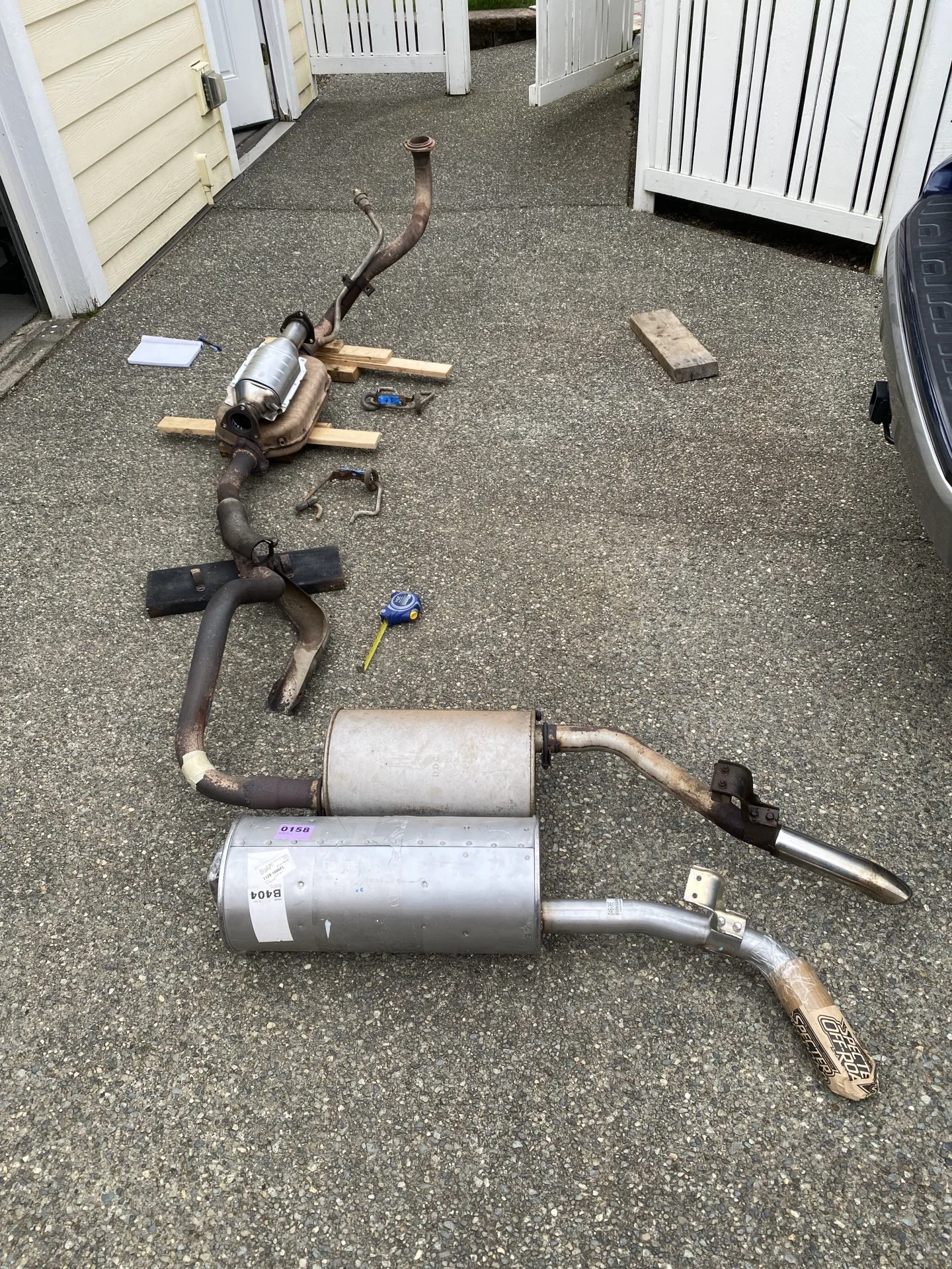

Already have a new cat and a NOS muffler, was in the middle of this project when the part dropped. I was planning to build that section of pipe but stoked to just bolt this one up. I’m keeping all the emissions stuff in my restoration. Not required in WA. Just trying to keep it all stock.

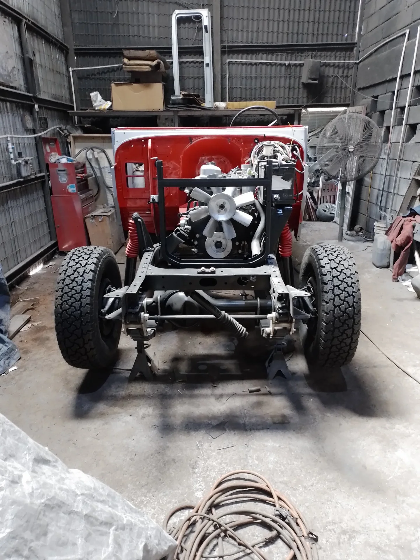

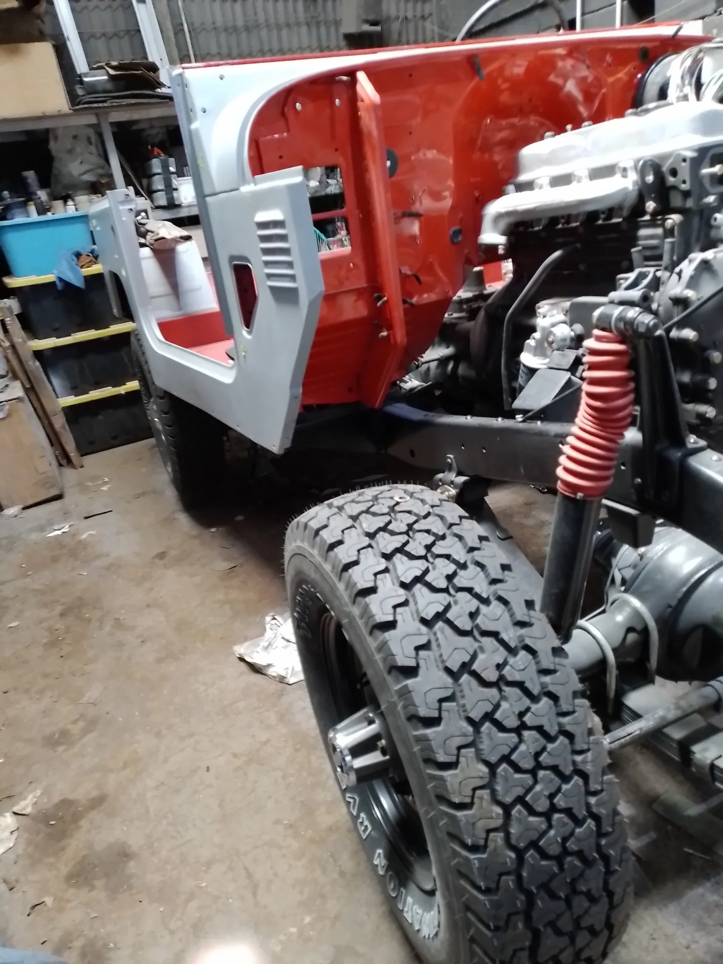

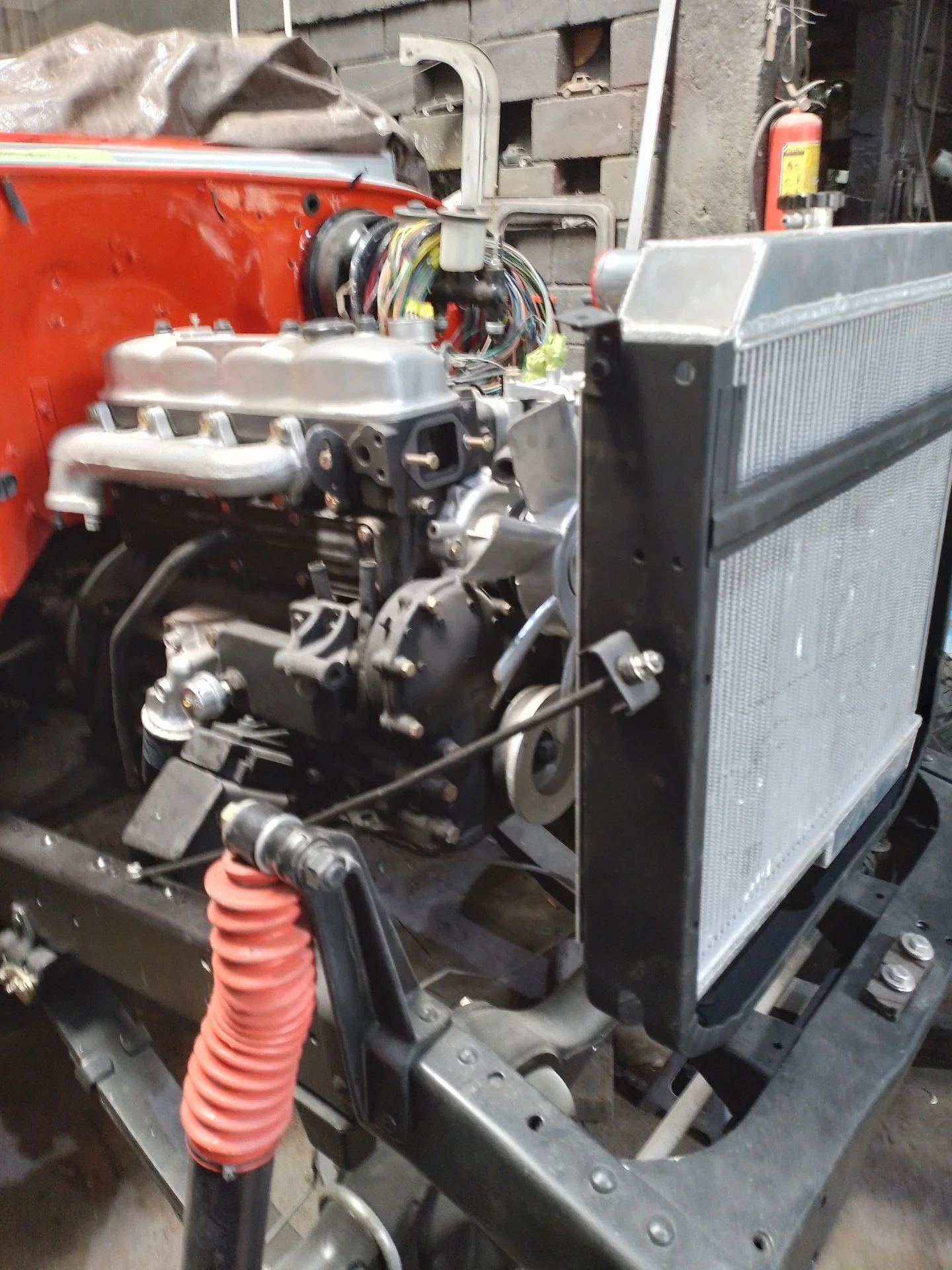

All metal is done by a company named SEQSA here in Costa Rica. They sell exclusively through Cool Cruisers of Texas. Go to there website as they have all the information about the metal used in the contruction of the metal body parts.

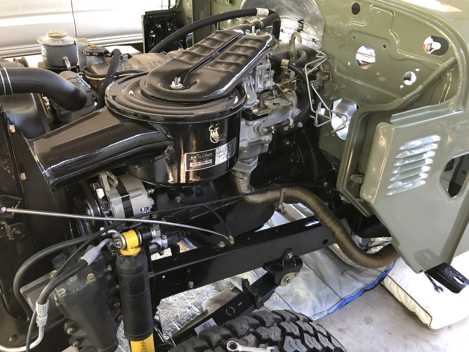

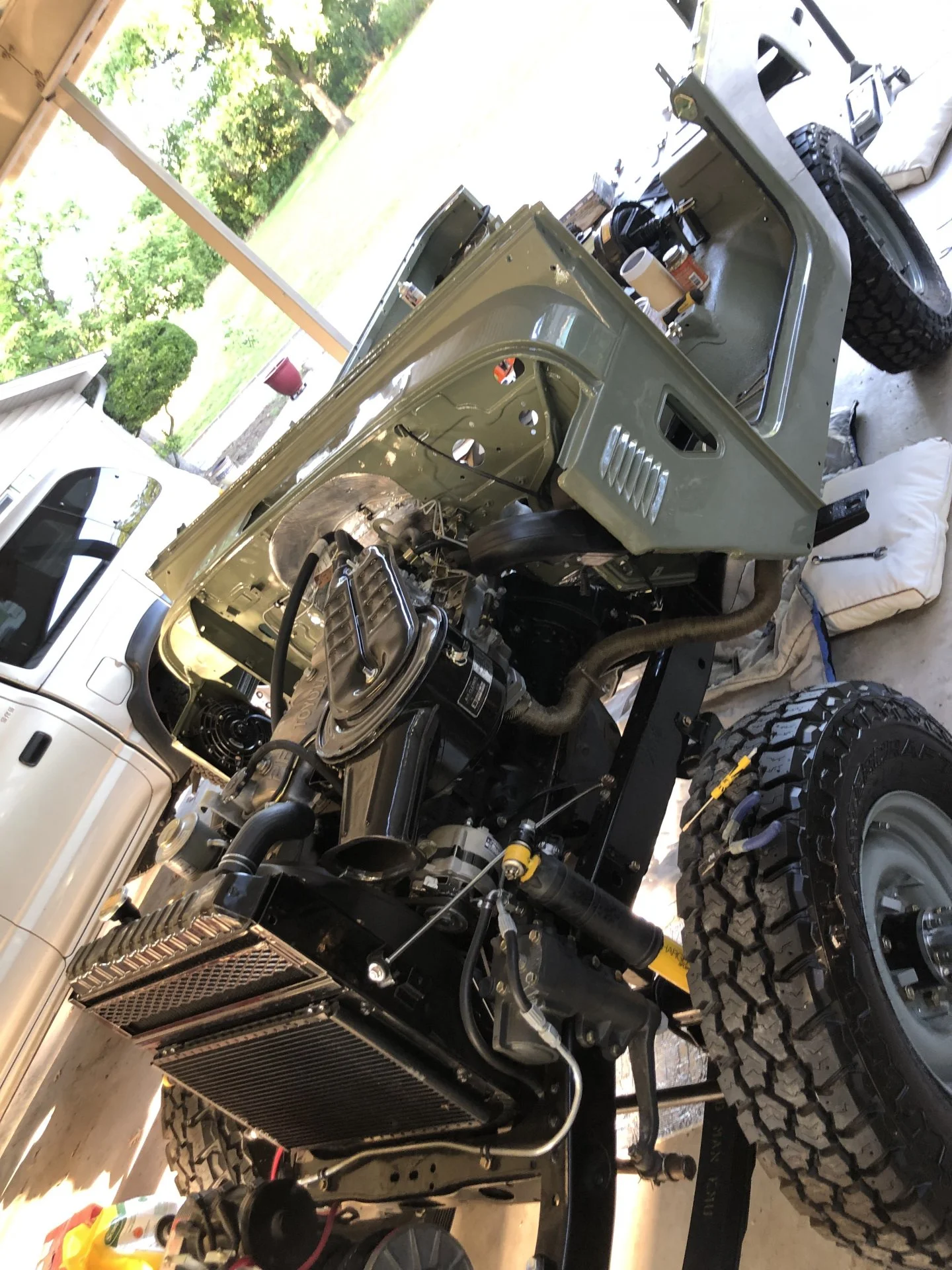

Above the frame and still room for the PTO? Pics of how this works. Is there a skid plate in the equation?
This are not my personal pictures but show the 1/79 routing of the exhaust except for markets with a CAT.
Those markets the exhaust still went out side the frame just went under the frame on the 79 and 80 models. 81-83 it was above the frame like the rest of the world except it has a small EGR pipe. 8/80 a heat shield was added on the left foot well in the cowl. The CAT makes the exhaust run hotter. This is why it was run under the frame in 79 and 80. 81 model Toyota added the heat shield and moved it above the frame like the rest of the world. When the exhaust was run under the frame it blocked the routing fornthe PTO winch driveshaft. Even after 8/80 when Toyota routed all exhaust above the frame they never offered a PTO winch option in the US. I have sourced a couple non US market 8/80+ PTOs and driveshafts. Personally perfer the exhaust routed outside the frame. There is no skid plate for it but is higher than the frame. Two track trails the tire tracks have better clearance the the center. There the skid plates are lower than the frame. Routing exhaust above the skid plate added heat to the cab and transmission and transfer case. Toyota never added any type of heat skids in that area.

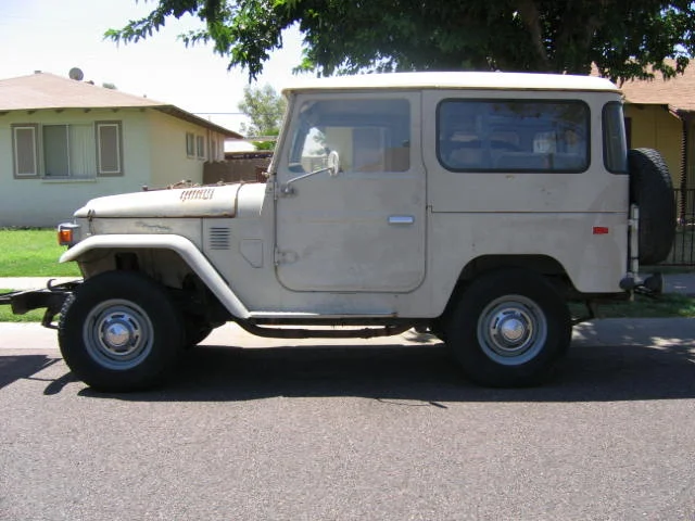

This is original exhaust on a 10/75.
To my knowledge this is the routing up to 1/79. Probably worse than the US 79/80 models. Rare you see the original routing with the exhaust run under the skid plate. When running a factory PTO winch very hard to get clearance between the frame and PTO. Have a 70 FJ40 that the original owner added a Ramsey PTO winch. The PTO mounted to the back of the transfer case allowed for room to run the exhaust above the skid plate.
