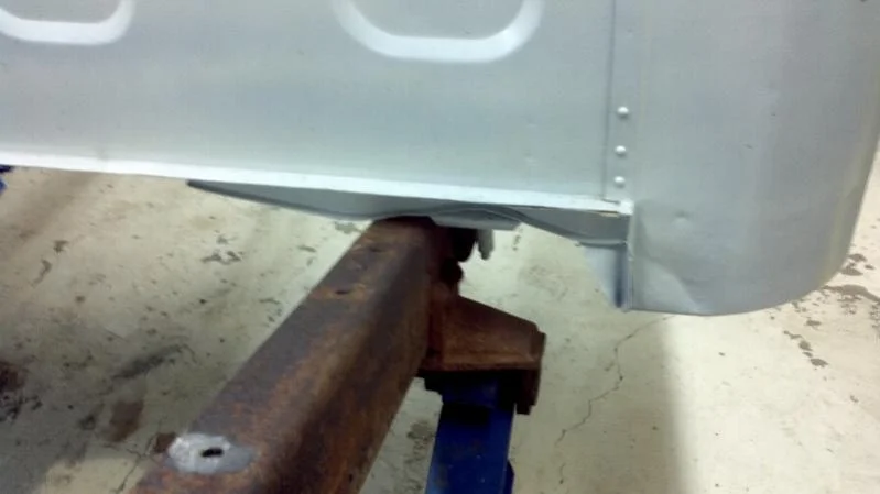

Tornado takes the top off 1964 SWB FJ-45

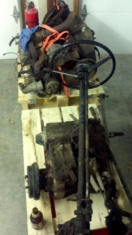

Steering mount off

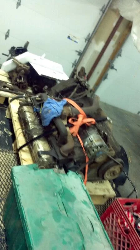

Stuff waiting on travel to killerpee

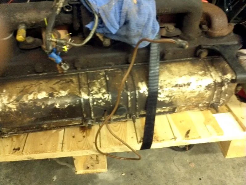

This is the line I was talking about
I was trying to locate a stock spare to send only managed to find a carb rebuild kit two cartridge filters and a fuel filter instead
Loaded to go to ks for transport to ok
Yeah, that copper line is an EXTERNAL feed, not internal like factory. Usually done when there has been a pressure issue with the stock feed off the cam, or a collapsed stock tube. The external line usually 't's in to the oil pressure sending unit fitting on the block. It's a little crude, but VERY effective.
REALLY nice to see this project moving along Erik.:)

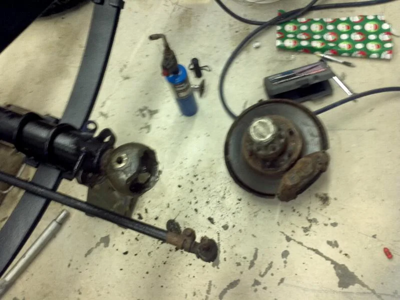

Shock mounts off will replace with ford mounts to utilize fj60 power steering and pto

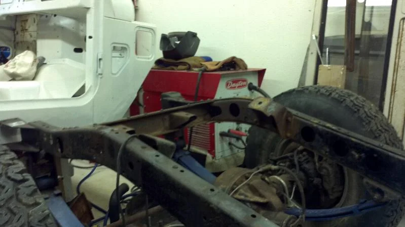

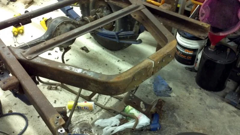

Rear frame member off to fix a couple spots
Taking off all older stuff from years ago including these my first rear disk conversion from about twenty years ago cut with a torch have some new ones out of stainless to go on later
Powerwashed the frame yet again to get forty years of gunk off its only 35 degrees out what fun that was but only had one day off this week stripped everything off as well to prep for paint on frame

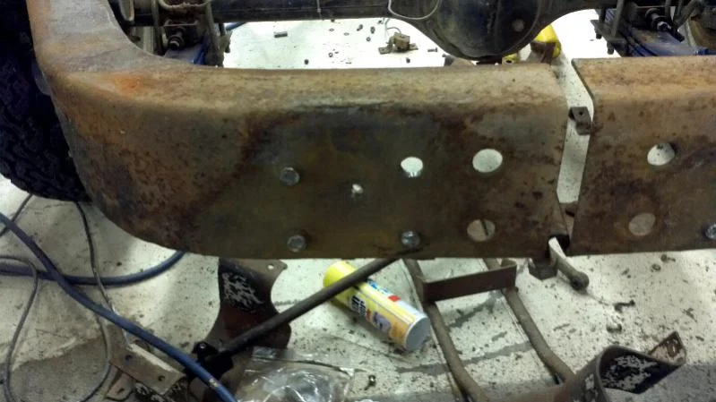

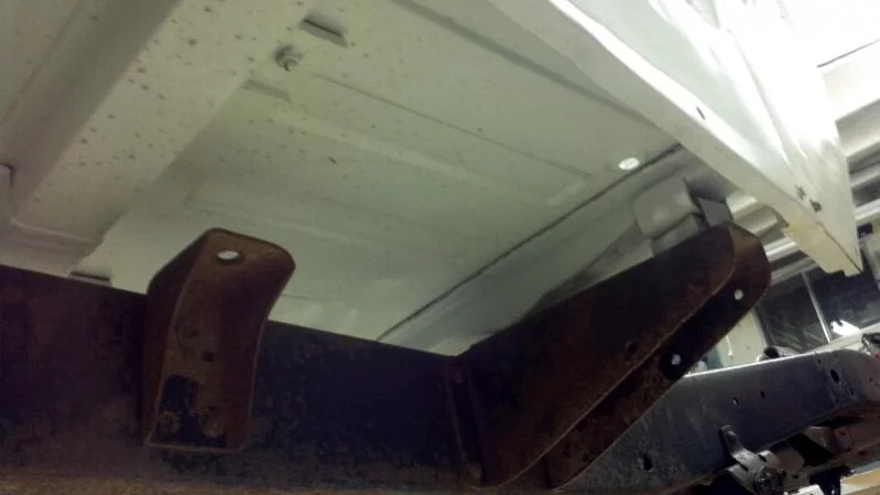

Need some help crew need to know how high the mount that fits here should be. Need to remove the other two unused mounts and relocate two of them for the new cab. Could someone take me a few pics with a tapemeasure as a reference
Cut out bad sections of frame gussets welded in new next are body mounts for cab

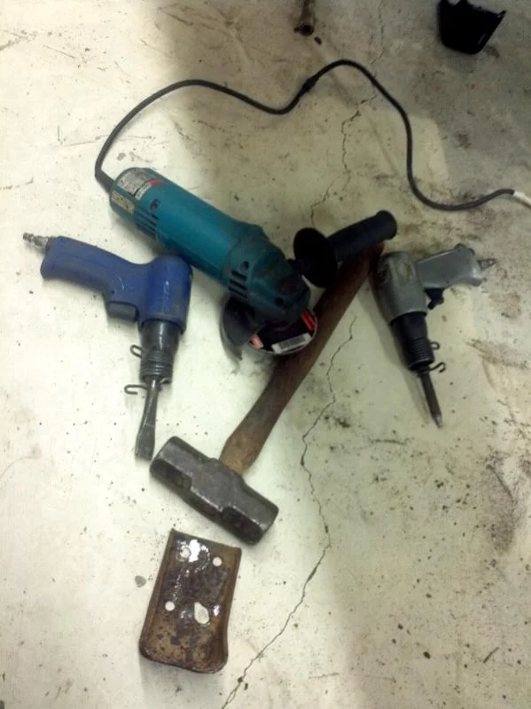

Old body mounts off last night impact chisel,impact punch and a grinder made fast work of them

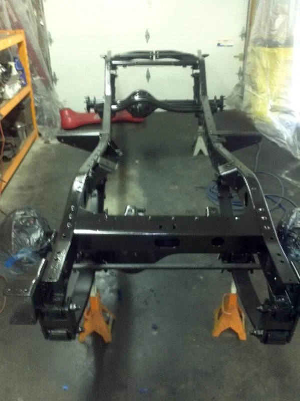

I gotta try to keep up with gumby and the others frame will get one more coat of epoxy then I can get my garage back

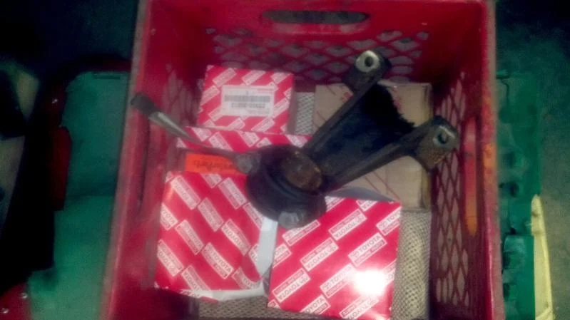

Front axle small pattern knuckles off to prep for large knuckle disks with the cheaper to find rotors and aisin hubs
