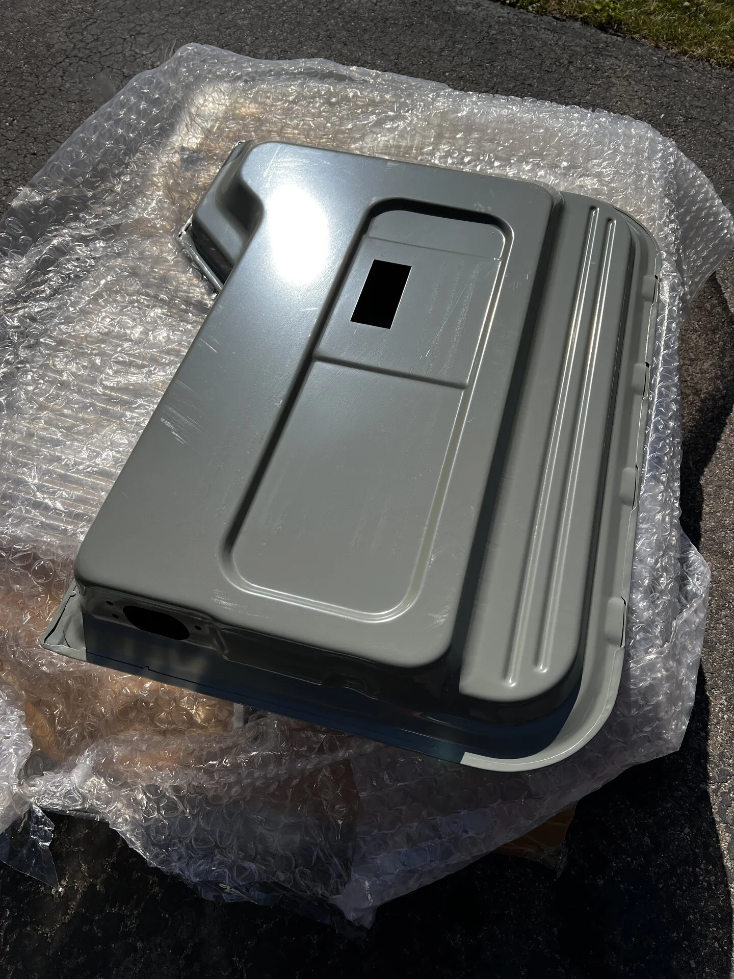

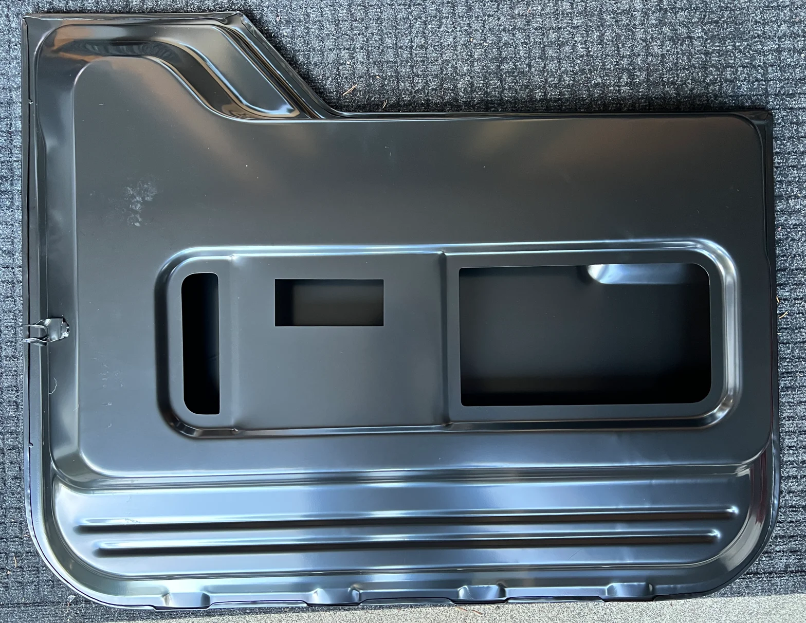

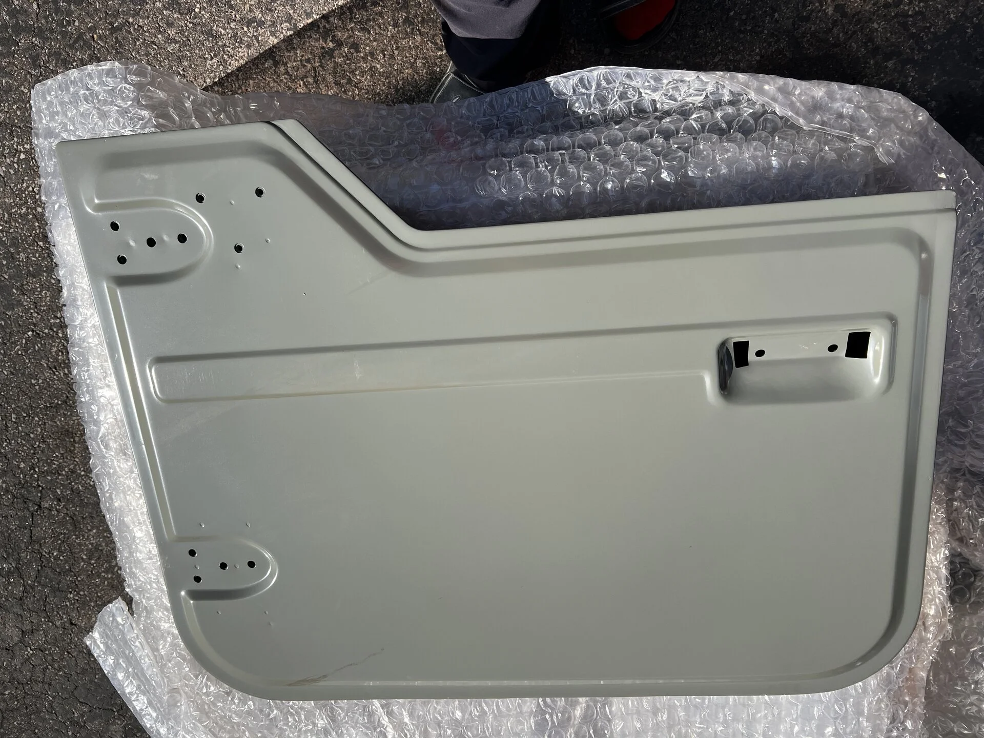

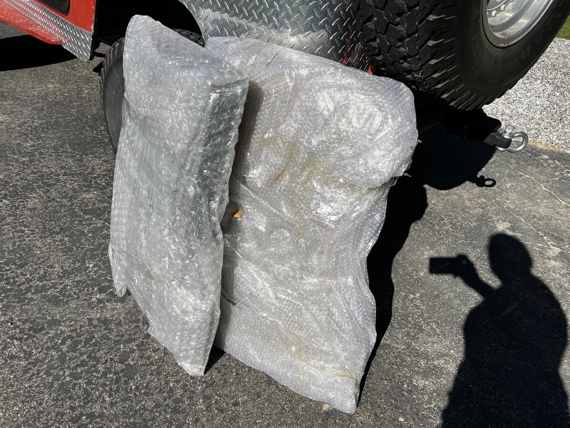

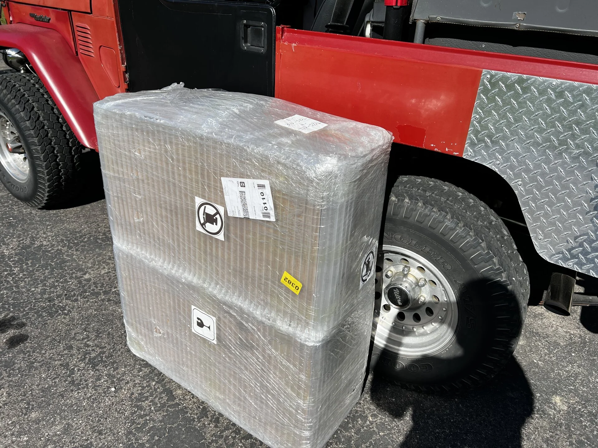

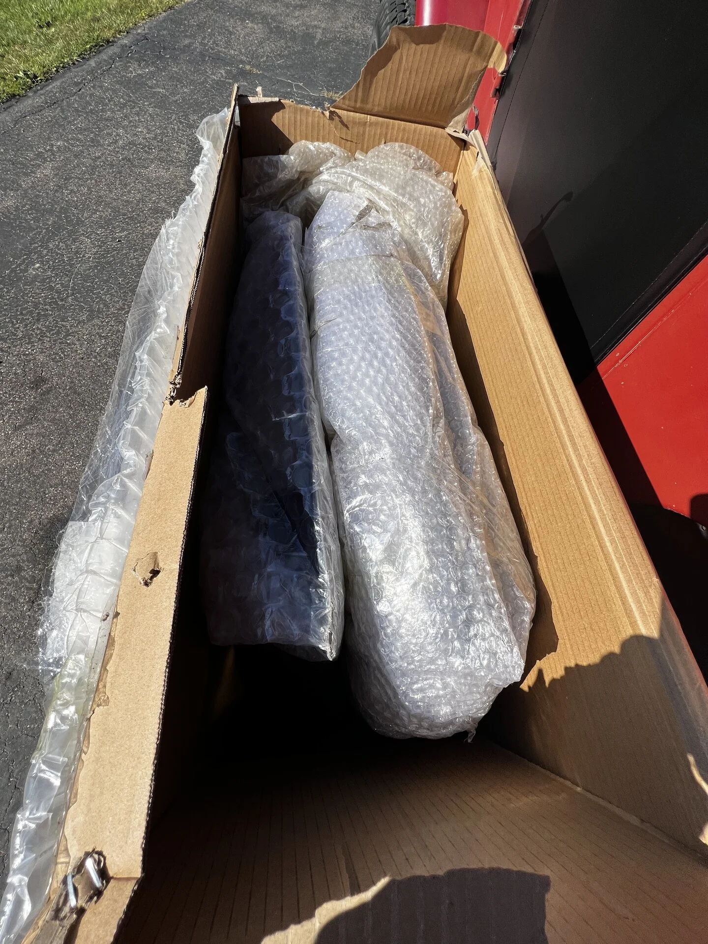

I received my Topnault half doors a few days ago and wanted to post up some pic for everyone and also ask for some suggestions. Overall, I am happy with the quality of the doors, they were packed well and arrived undamaged. I will start with some unboxing pics.

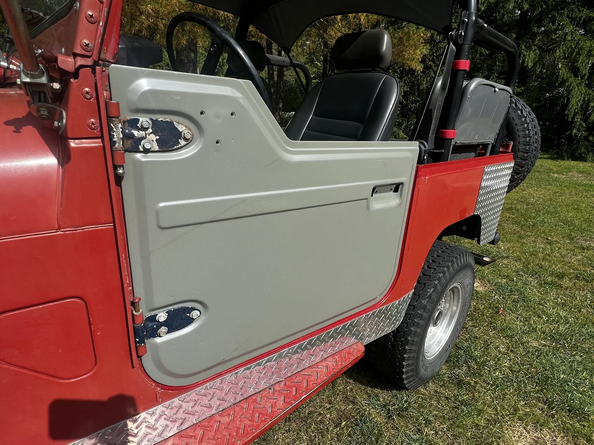

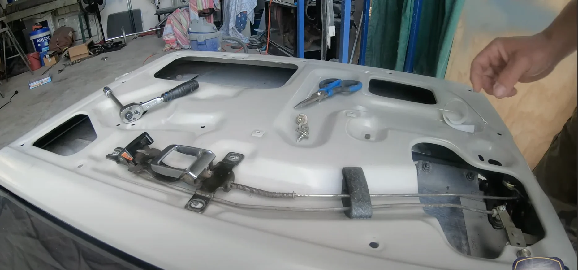

I was hoping to spend the day making a video of the door installation after adding the door regulators but they are going to take some thought and more than a day to accomplish that. I thought about just forgoing the inside regulator and just opening from the outside for now, but I still would need to cut some sort of access hole in the door to do that. If I'm cutting holes, I guess I should just install the inside regulator since it should not create that much more work, or maybe it will since the OEM doors have the mount and a channel depressed for the mechanism rods to run to the door regulator... I definitely will need some time to think this over and some advice from the wizards here. I just put one on temporarily to get some pics to post for you all :)

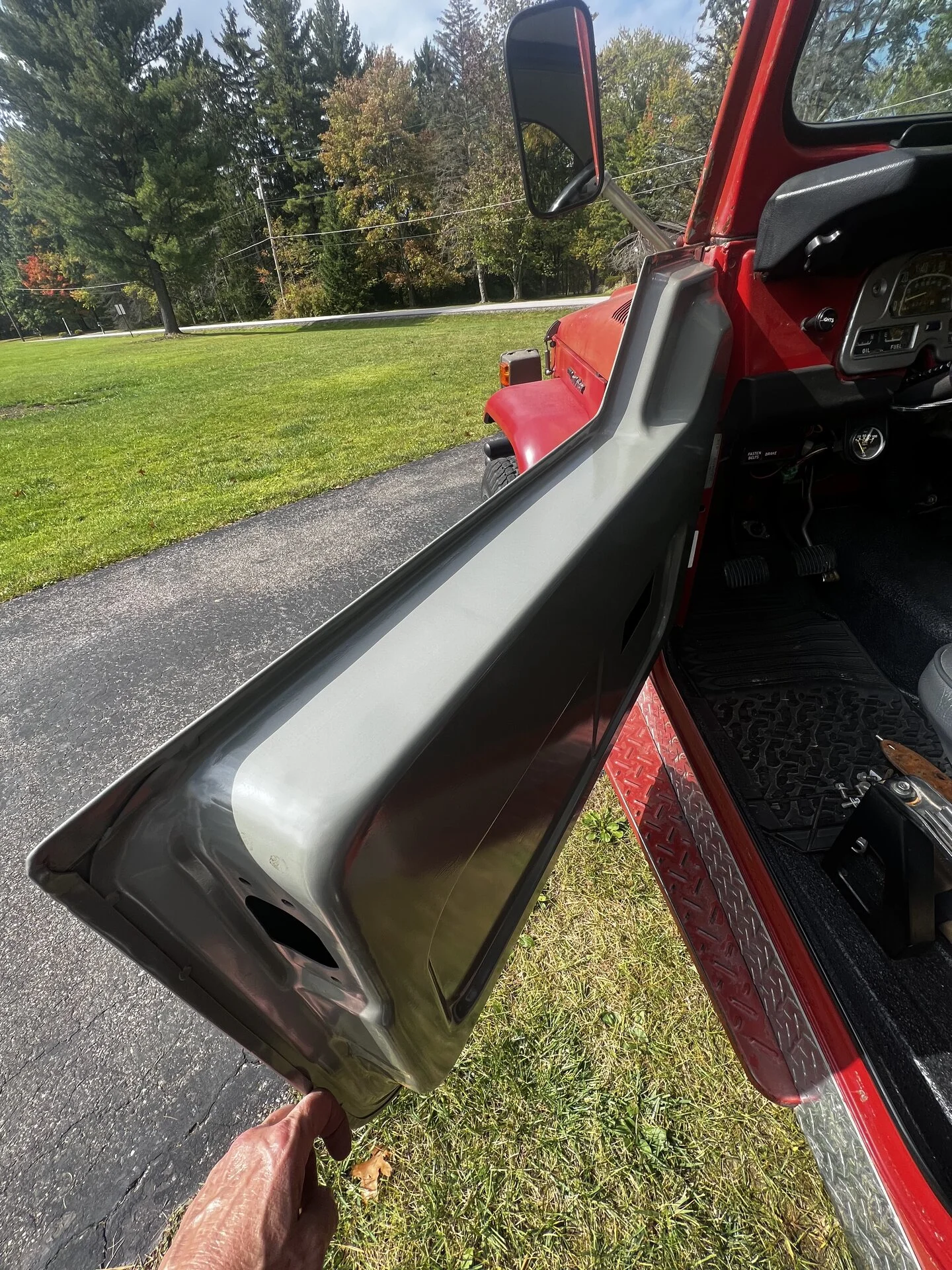

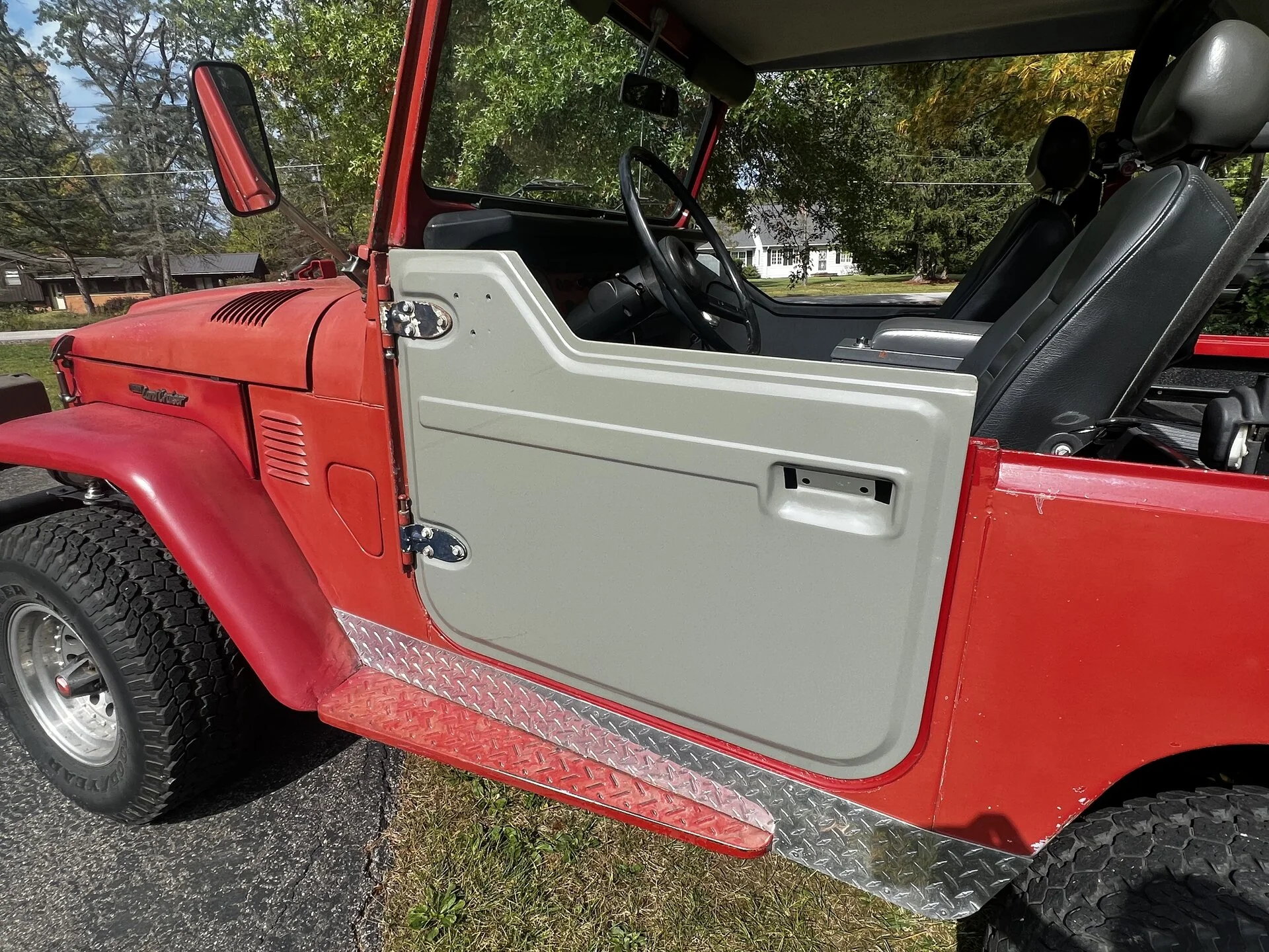

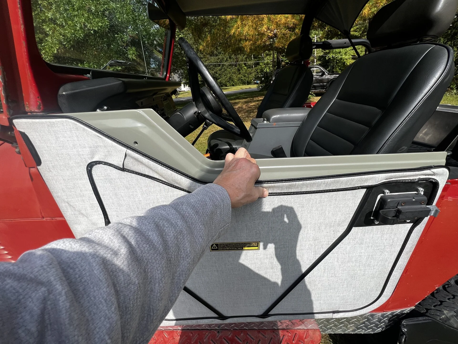

Some posted about a concern of the door not being flat on top but there is plenty of room to rest your arm. I held up my Bestop door for comparison.

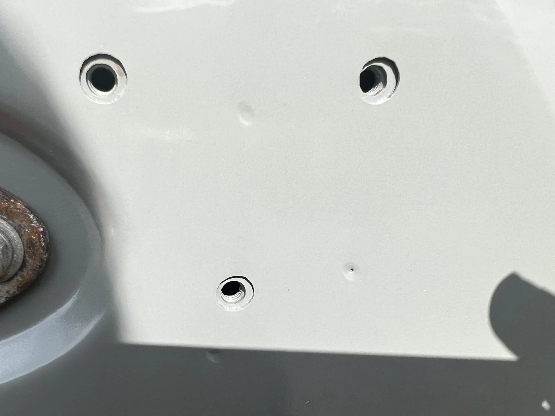

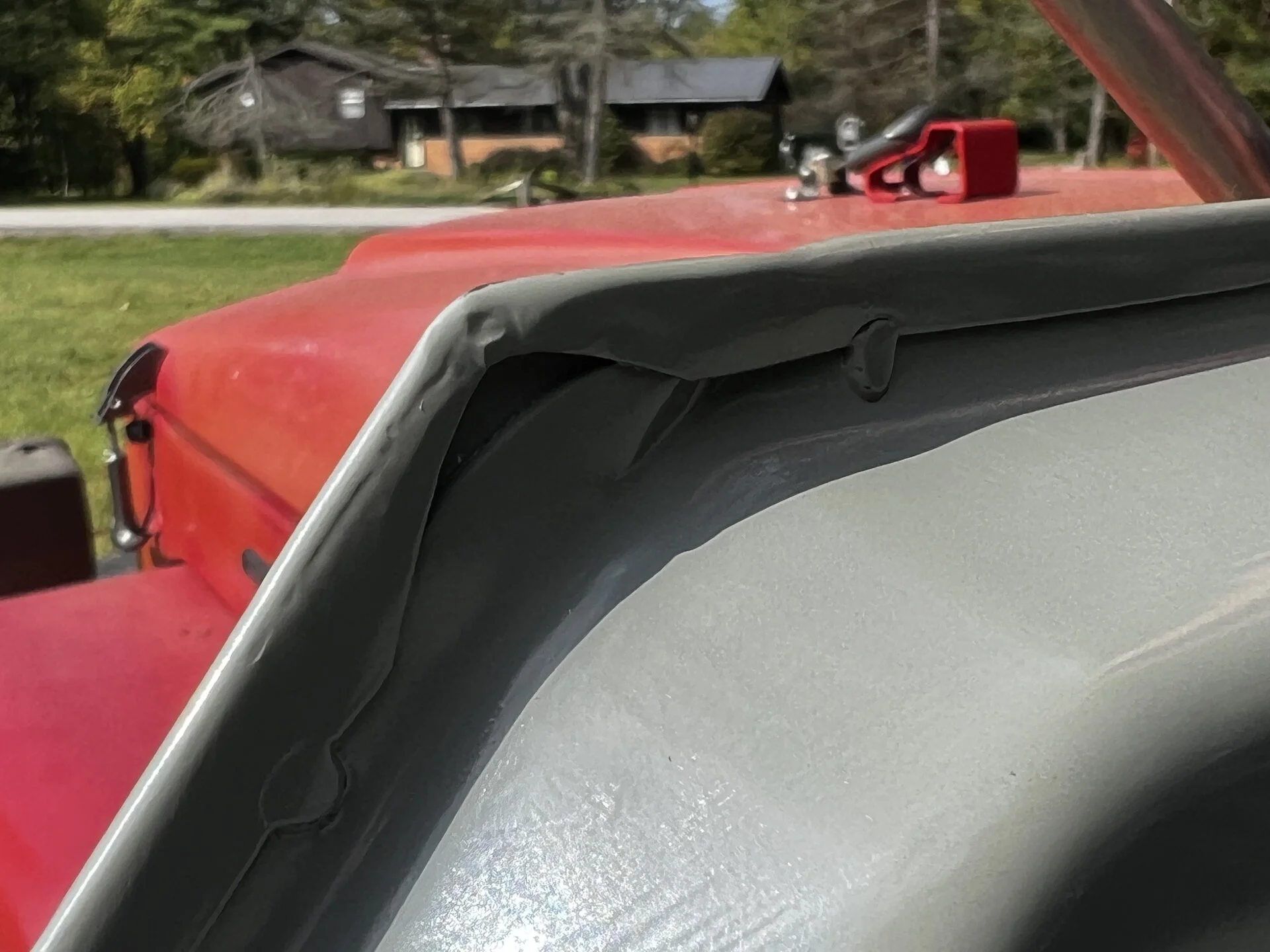

I'm not liking how this inside corner looks and would like to use a file to ease the sharp corner a bit, also don't like that you can see all of these tabs. What would be the best way to fill this all in and make this edge smoother? Seam sealer?

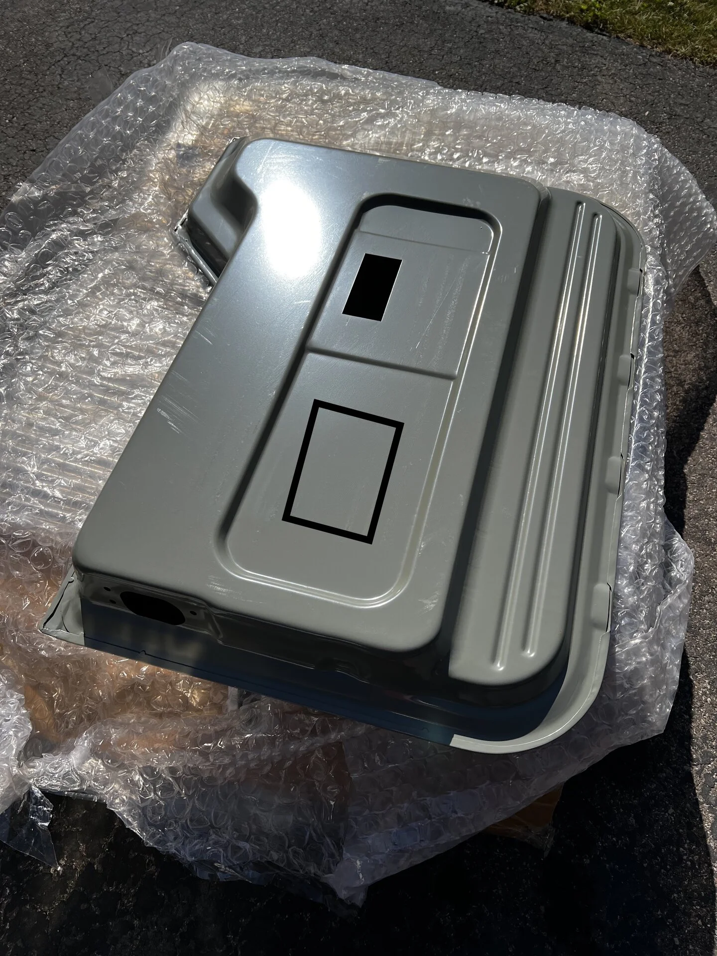

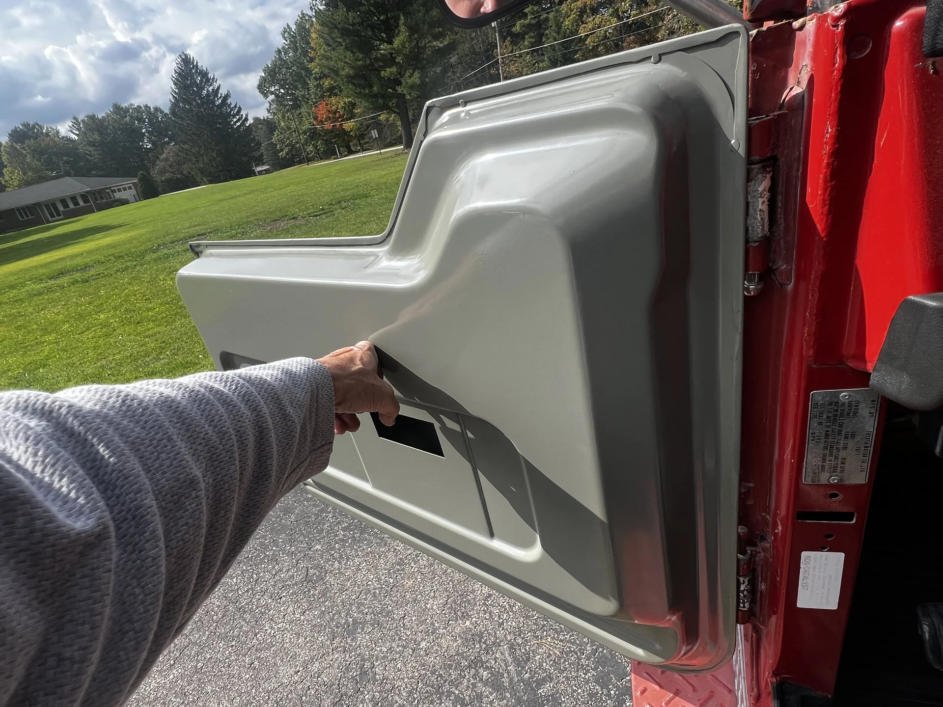

Anyone have any suggestions on where to cut these doors to install the door regulators? Should the black rectangle allow me to reach everything?

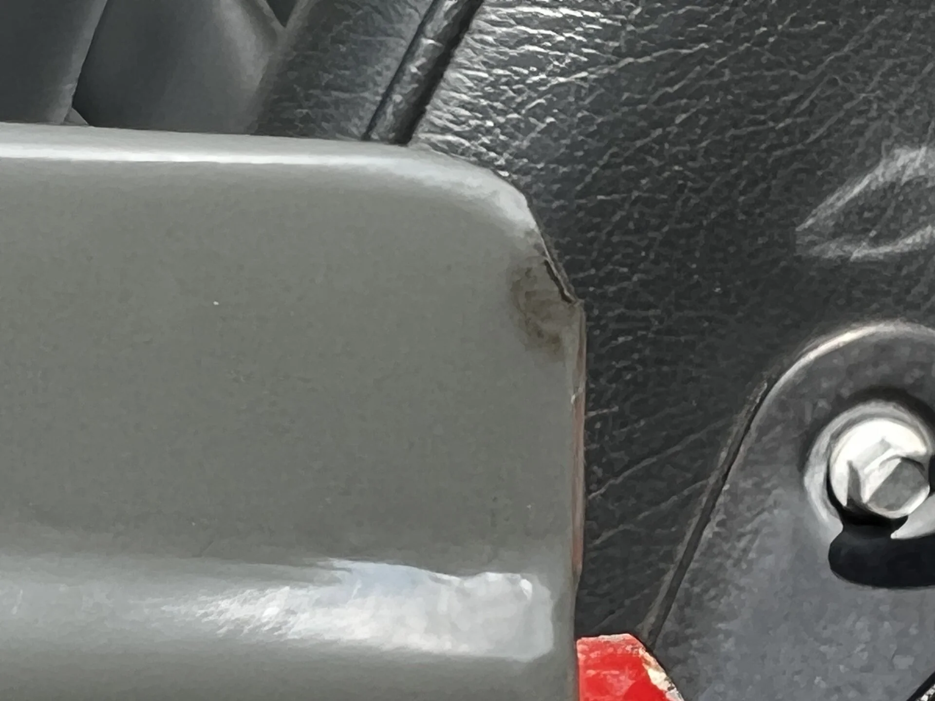

I'm not liking how this inside corner looks and would like to use a file to ease the sharp corner a bit. What would be the best way to fill in this small hole and make this edge smoother? Seam sealer?
Seam sealer is the right idea.
That corner stood out to me immediately in your photos. I’d probably cut/file to how I liked it then JB weld and then seam seal.
The OE doors don’t have much for access so your black rectangle would probably be fine, but I’m not exactly clear what you need to do.
I remember asking this question in another thread. Because the door is cut down to match the back the handle for the latch is lower which would think it requires bending the rod or rods if hooking up the lock too. That still leaves getting the latch mechanism installed and hooked up. While it would be nice with just metal on the inside running without a top a interior panel similar to the 1/75 hard doors would allow a decent excess opening would make installing the latch mechanism a lot easier. Not dealing with an exterior lock but just the latch mechanism is going to be hard enough with just the hole at the handle.
Those look good. One thing that could be better, if the tops of the doors were even with the tub. Not a smooth transition the way they stairstep.

?, if you sit in it with new door how does the flat where arm would rest compare to the top edge of vinyl door ? It looks like it is a tad too high for comfort ?
The top edge of vinyl door is perfect and I was looking at building and arm rest to insert into the top half holders for the vinyl. Would go with these new metal half doors but that arm rest position is critical IMO.
I thought that for a second, but my Bestop doors are also higher and never bothered me.
Check out the pic where I am holding my Bestop door in front of the half door. The flat spot inside is at the same height :)
