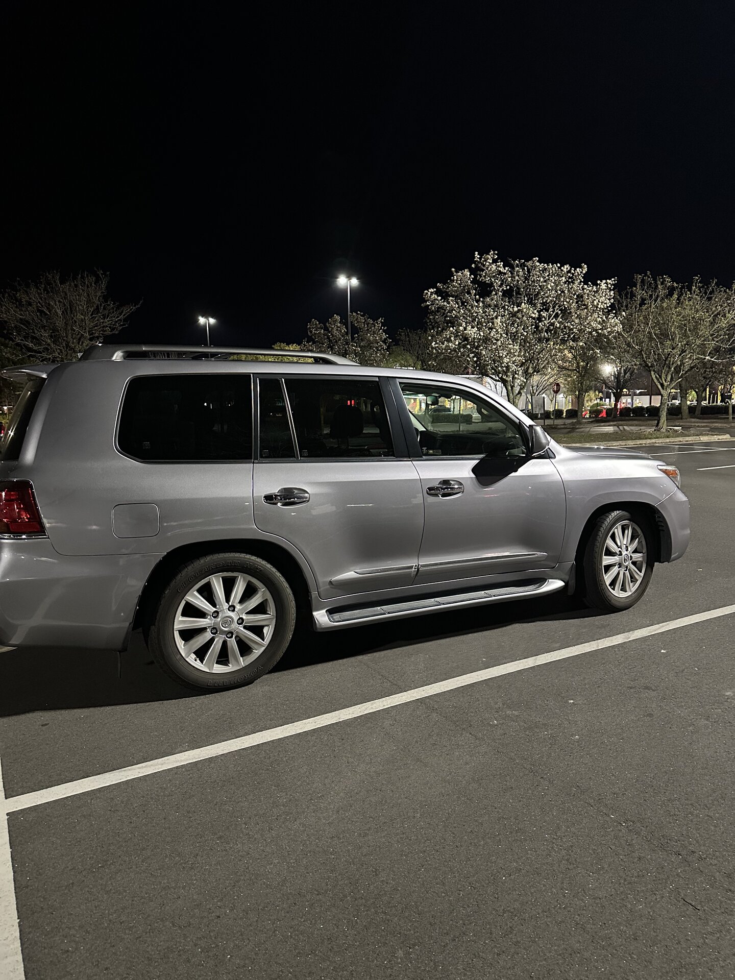

Its so clean though i think im going to keep and do what needs to be done to slow the rust. Again dry climate not much driving and no offroading. What you guys think
Bruh that AHC is clapped or are you in low?
