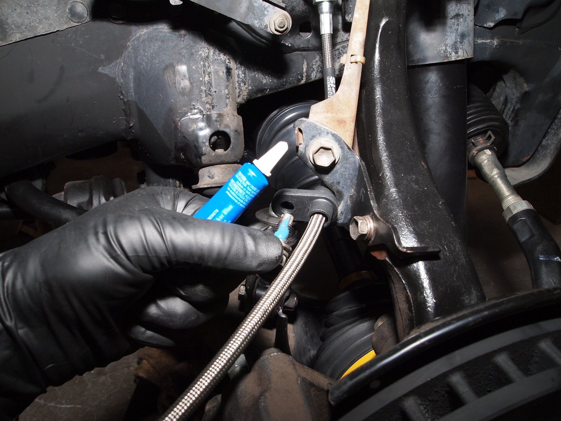

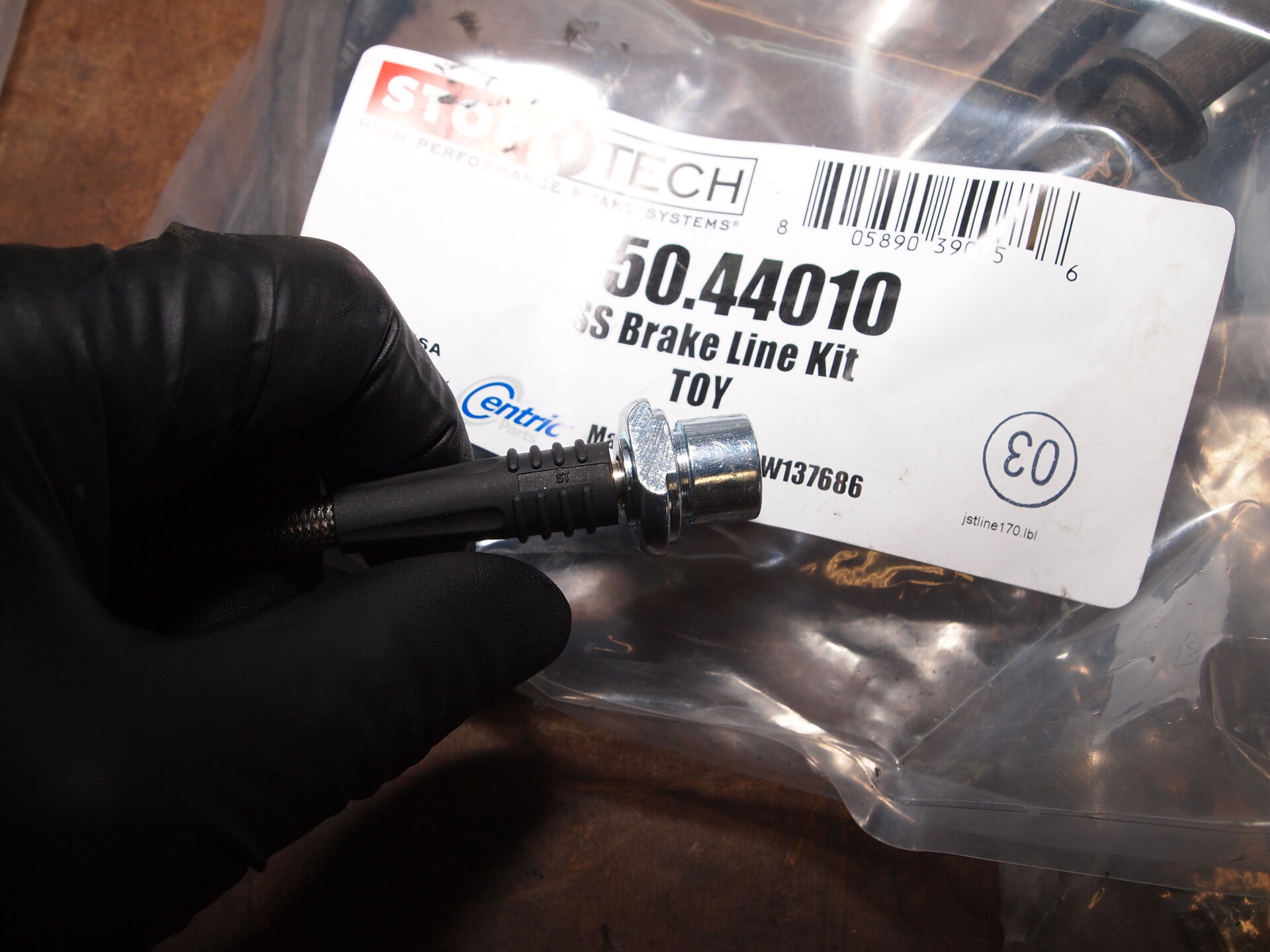

I went back and looked at what issue was. It had to do with coating on tip and designed with floating female head. Two issues. Great care most be taken, to get angle due to float. Second the coated tip, coating is removed during install. Re using not can result in a weeper. Additionally, a small amount of the coating ends up inside line (fluid).
I did like Stop Tech knuckles securing point better. As it's has metal bracket to bolt on knuckle, so can be torqued to spec. The Slee's can not be torque to spec, as it breaks the plastic.
Neither fix line on knuckle. Brake lines slides thought either knuckle bracket. In addition neither have lock pins as noted above. So the brake line with every movement of suspension. Is putting pressure on and off the banjo bolt. This was brought to my attention first by Christo Slee, before I purchased from him. But to date, I've not heard of any, loosening the banjo bolt. But take note. Toyota designed so the banjo bolt, so they never gets any external pressure from movement of suspension.
Look close at the stop-tech male flare, after removal. It's coating was brandished off during install. So I consider, a one time use part. Addition note the angle was not dead on. That's due to floating female flare nut aspect. The floating flare nut spin on line, which adds in aligning to frame bracket lock cuts. But also result in not always seating dead on with hard line flare.

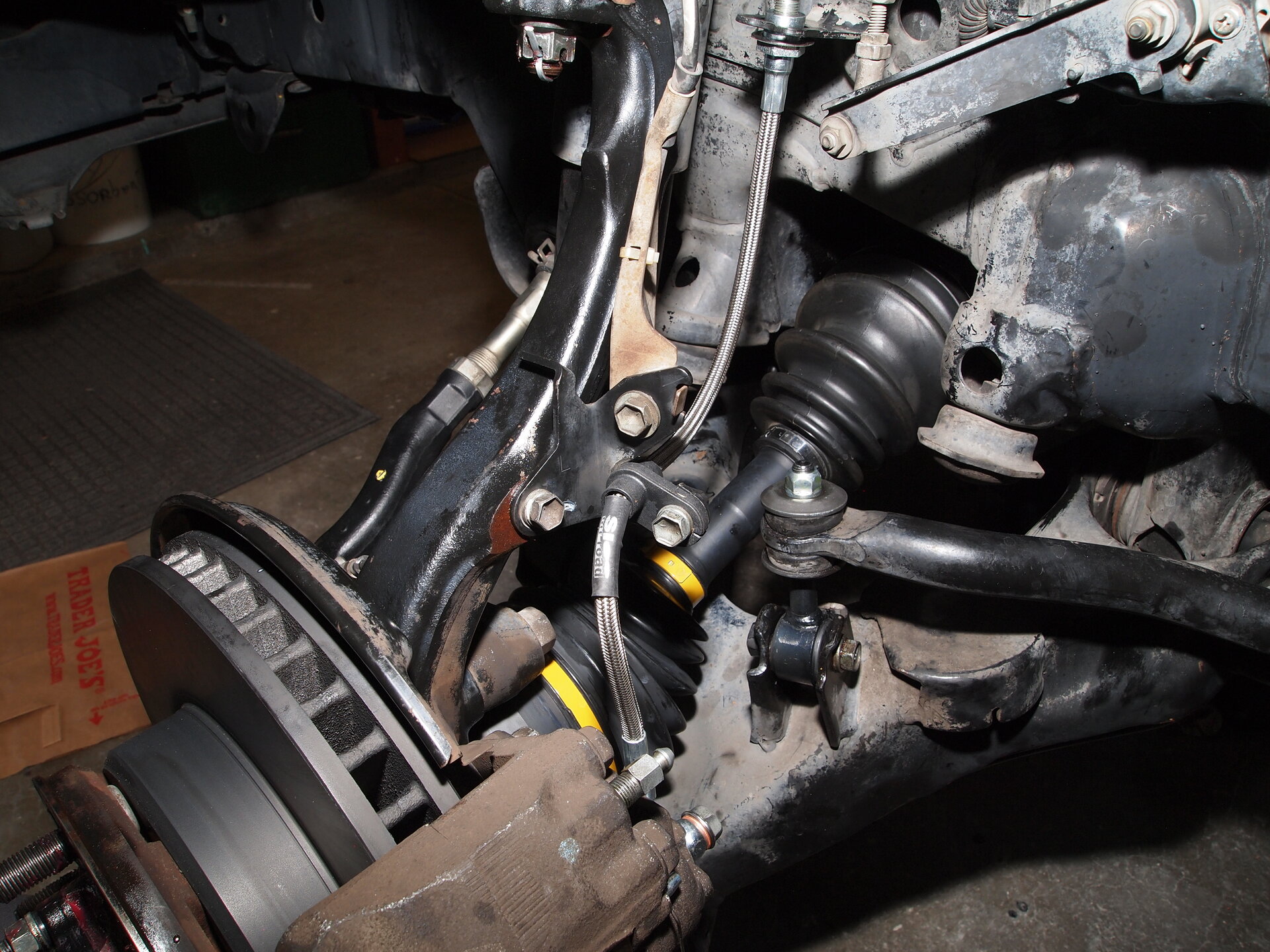

Unlike the OEM flex line. Neither Slee nor StopTech, lock line in knuckle bracket. Unlike OEM, Line sides through as suspension moves.

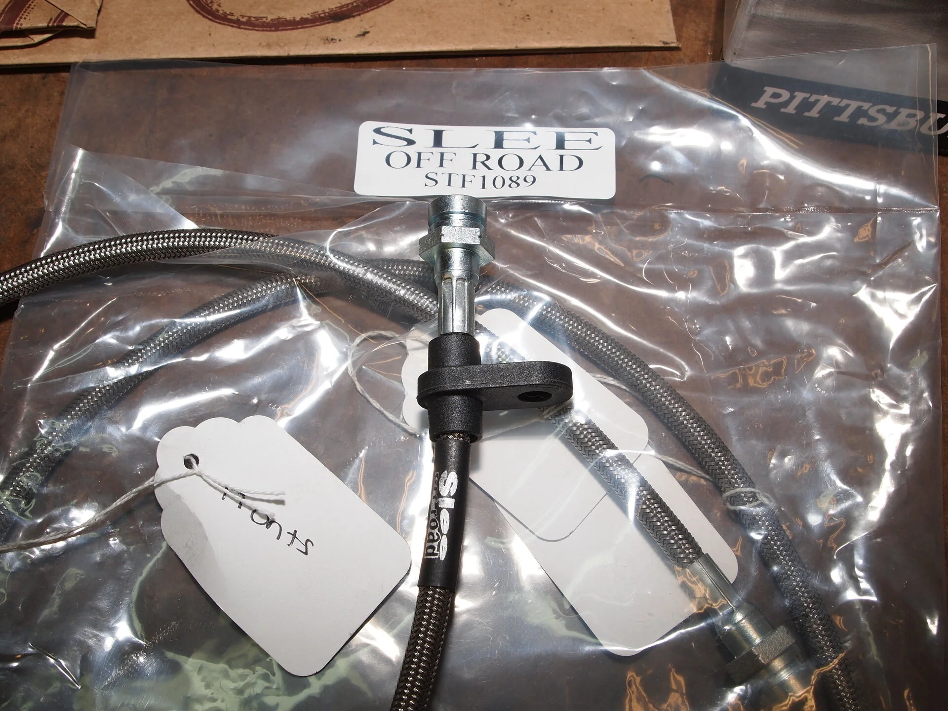

Slee

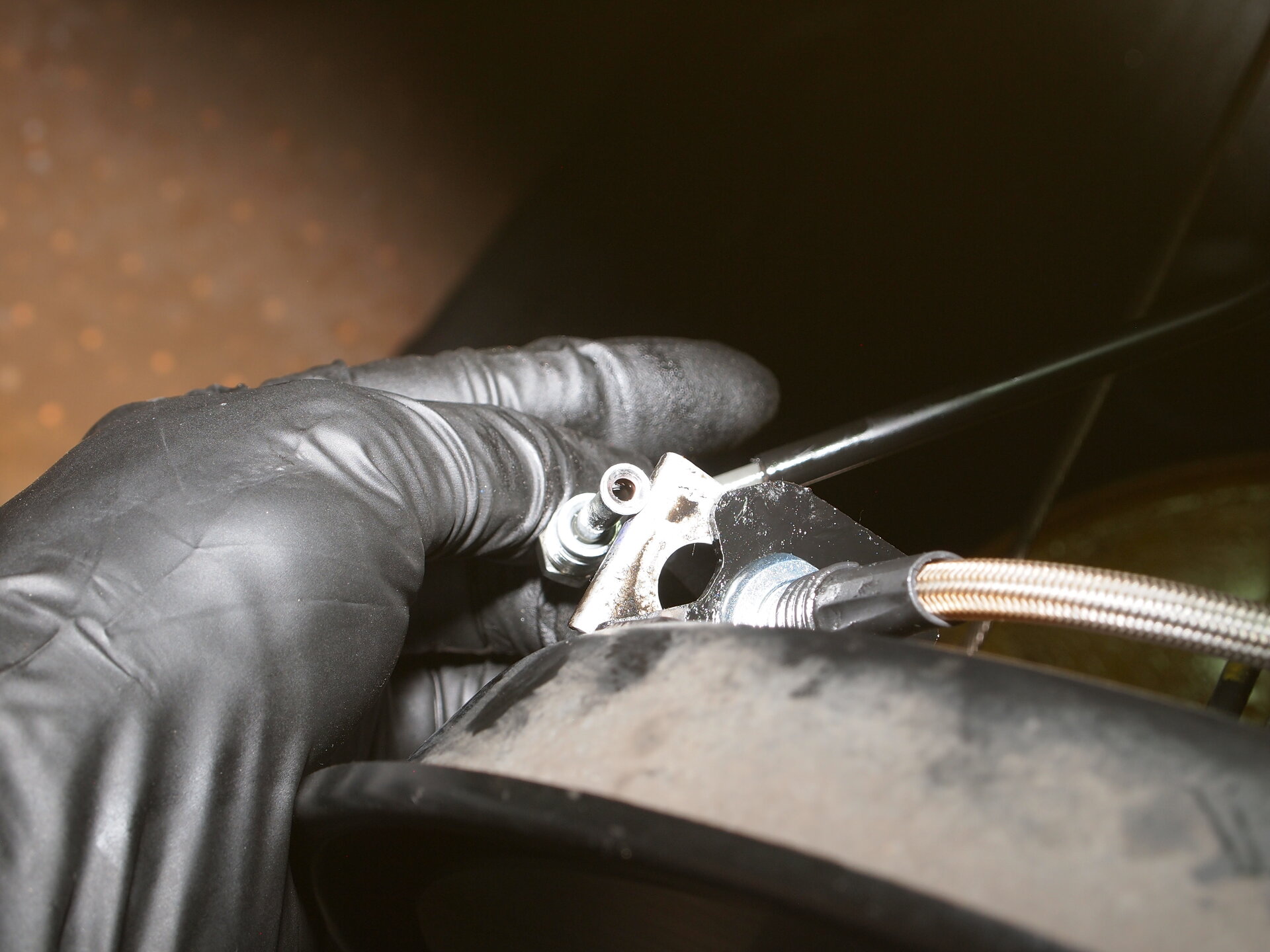

Neither StopTech or Slee lock line on knuckle or have pin locking banjo to caliper.

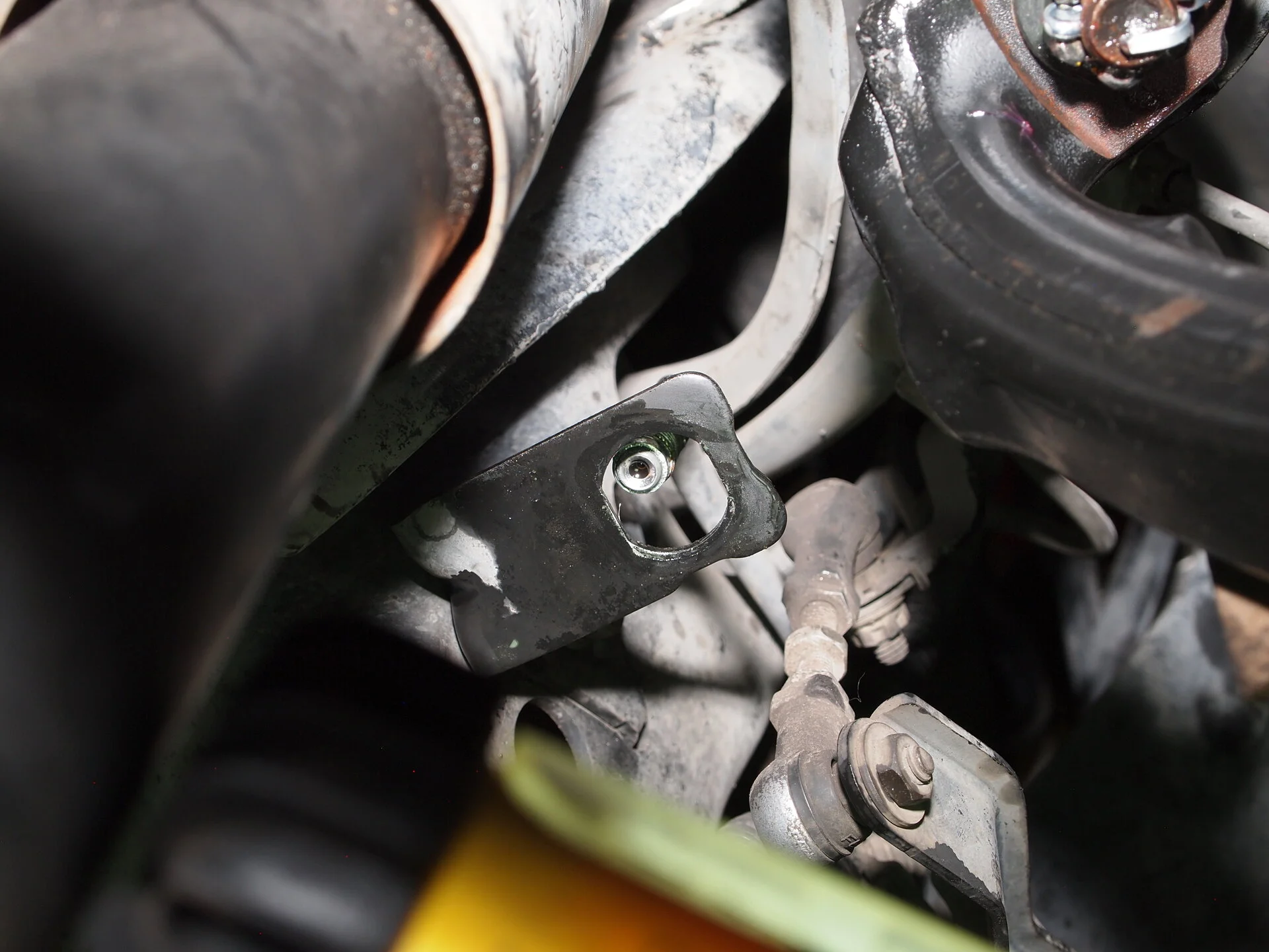

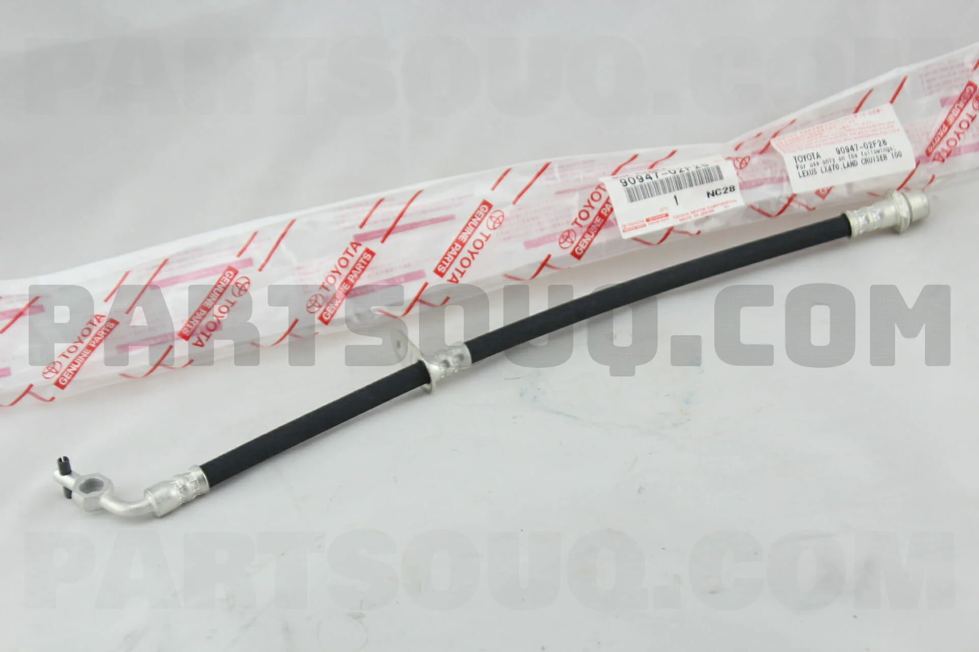

Note OEM all three attachment points clocked. Knuckle bracket clocked and lock on line. Banjo has a pin to lock into caliper.

I prefer the design of the Toyota lines, since they have the Pin that locks them in place.
