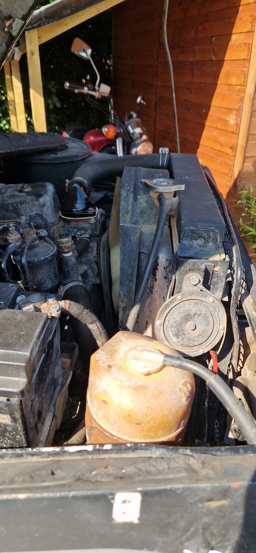

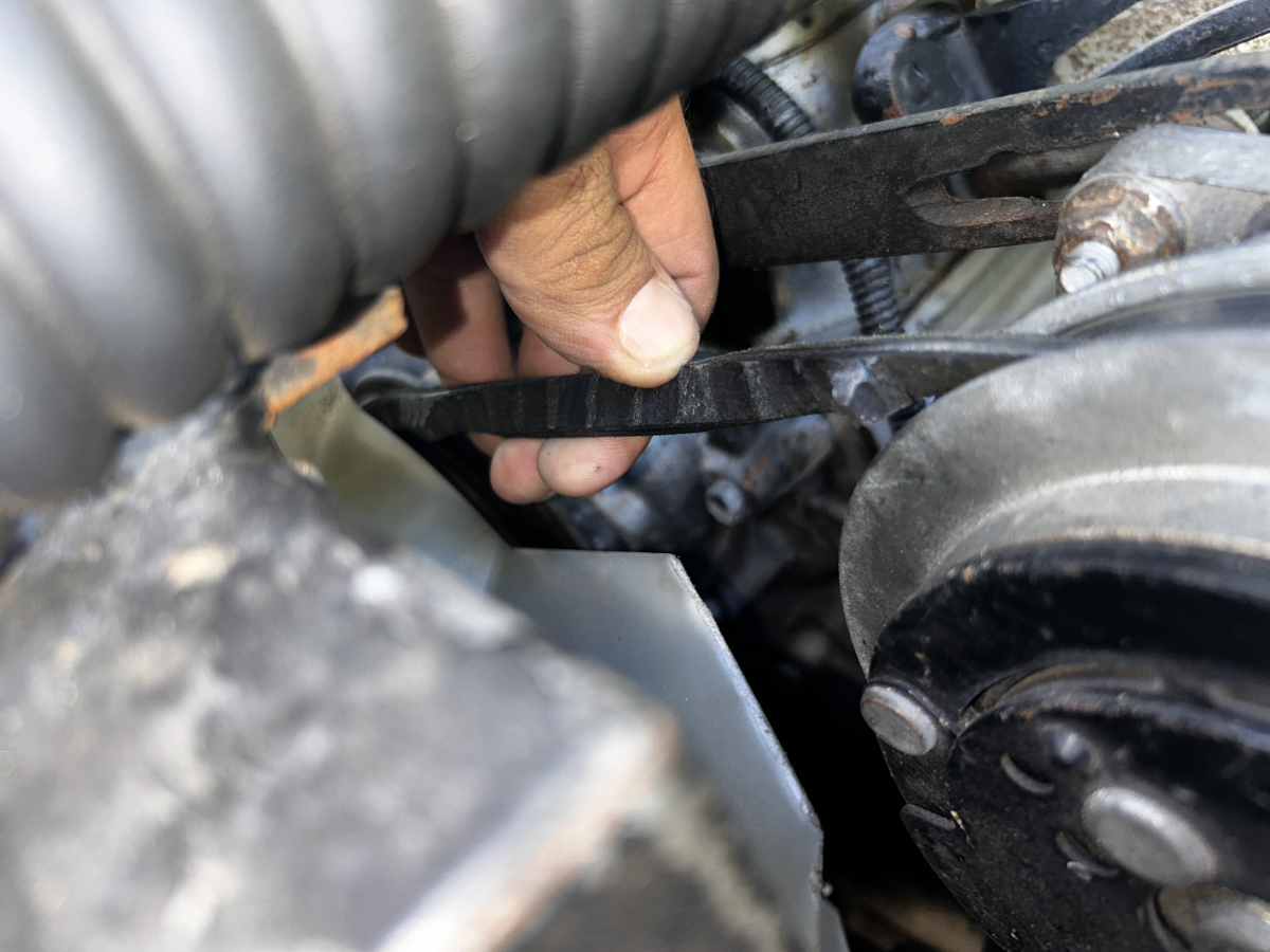

Noticed that the engine belt was really wiggly when running. Stopped the engine and checked it.
The belt is being chewed up really significantly and is at the point of failure. I am thinking this could be due it being too loose. Also, it has "teeth" on the inside. Shouldn't the belt be a solid one? Any ideas?
Also, this belt doesn't seem to tighten too well. Previous owner, my friend, said it threw the belt before while he was driving it, so he measured it with a string and went to a car parts place. I am thinking it may be too long an thus not able to be tightened correctly.

When the ac is switched off, the clutch should disengage and not use any power.
The teeth should be fine; gives more flex, but you need the right length.
Have you measured it with the alternator fully retracted?

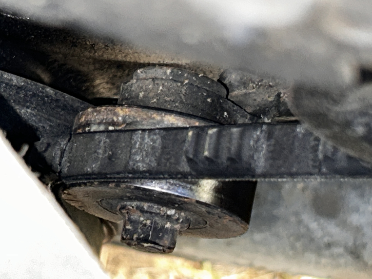

When I was in Roswell, on the way here during my initial trip, I noticed the belt was somewhat loose-jiggling a bit when under power. I Used the AC pump to tighten it. The wiggle went down but it still wasn't taught like I figured it should have been.
I will have to cut this one off and measure it, then compare it with the one I have as a spare.
Will also check the alternator as, now that you mention it, I realize was probably the original way to tighten the belt-since the AC is aftermarket.
Working on replacing the fan belt on the HJ45.

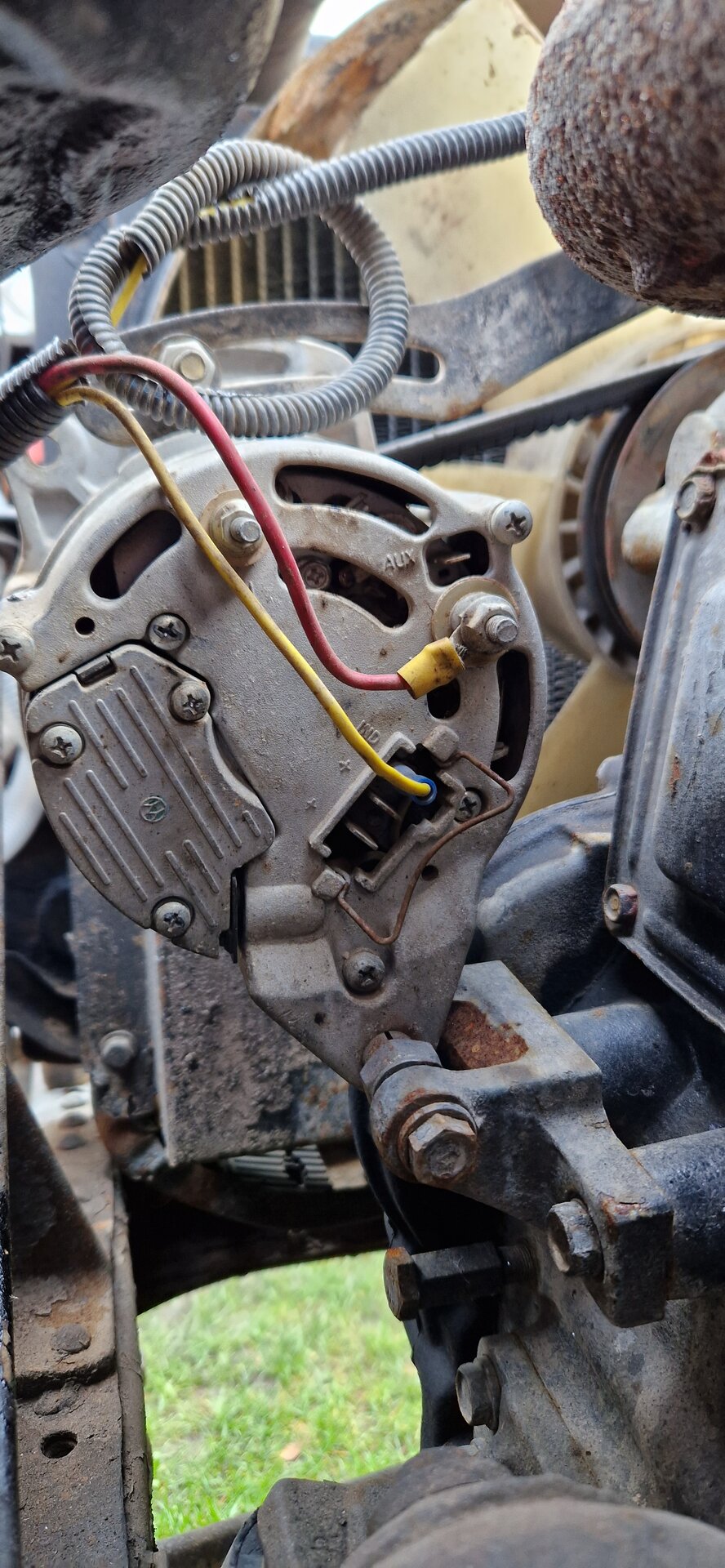

The only adjustment I can see is moving the AC compressor, and this is maybe an inch of movement. The AC compressor is mounted to the alternator, and the alternator moves a little as well, but only along with the AC compressor. The bolt for the alternator pivot-at the bottom-is loose. Not much movement at all.
The brackets for the AC compressor are obviously rigged, but also pretty crappily done, with uneven cuts etc.
Debating whether to remove the AC.
Thought of bypassing it for now, with the original length belt, but then I won't be able to adjust it at all, as the alternator moves along with the AC compressor, but only about a 1/4 inch since its at the bottom of the movement arch. Seems like removing the AC compressor would allow true adjustment.

Looking at the photos above, seems like if I remove the AC compressor, the alternator will only have one point of attachment, since the bracket was likely butchered to make the top ones. Not sure what to do.
Removing the AC compressor will still leave me unable to drive until I can find a bracket for it.
Does anyone know if the OEM bracket has an adjuster?And where to find one?
I guess part of the question is how well aligned is the AC pulley with the others?
Looking at how hacked around it is, I might also be inclined to remove it, especially since the AC gas is already lost (not something you want to purposefully vent into the atmosphere given the climate impact potential).
The stacked washers is obviously a spacer to try and align it. Maybe you can use what you have and fettle it a bit to improve alignment overall in the short term. A steel rule on the pulley faces will help to check.
Maybe you can't make a perfect new bracket without your new shop built, but you can probably do better than what's there.

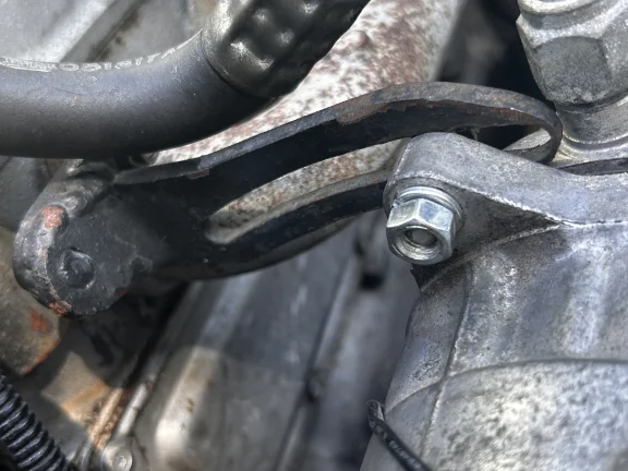

I can see that the adjustment bolt is barely engaged in the nut (3rd pic) for example - you might find a longer one if you choose to keep it.
This is what my adjuster looks like for reference.

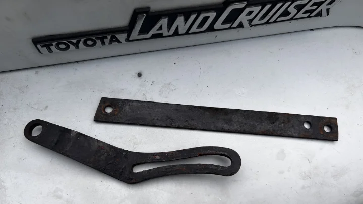

Just remembered!!!
As I was driving through the Great Smoky Mountains a few weeks ago, I heard this loud clanking sound under the HJ-like something metal tumbling. I turned around and found this (the bottom adjustment bracket) sitting on the road:
The top straight bar was in the HJ. I think for the battery hold-down. Not sure.
I thought I had just run over it, from another vehicle, but collected the piece just in case.
Does this look like it could be the bracket for the alternator? It seems to be deformed on the cut, but that can be fixed by heating it up and straightening it.
If it isn't from the HJ, I can likely use it anyway.
