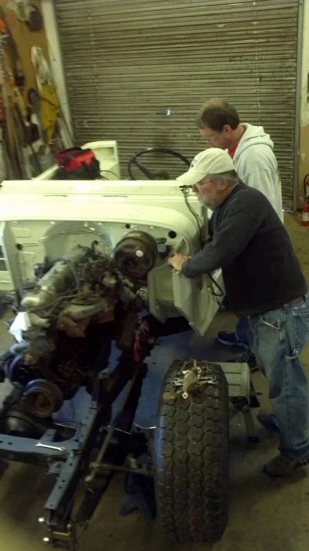

Here is a pic from last Sunday. We got a carb mounted and the throttle linkage hooked up. The fuel tank was cleaned up and is ready for installation, and we got a start on running the fuel lines.
Dr. Ed verified the repairs to the wiring harness will hook-up as needed and will be putting the finishing touches and load testing the harness in preparation for installation in the coming weeks. I've got some homework to do on the instrument panel as we have broken gauges, and rusty faces. Hopefully, I can mix-n-match what we do have to make up one working panel.

Here's pictures from today, January 27th, 2013. You can see this truck is coming together--some new parts donated by the Cruiser community, and others reconditioned for more decades of service.
stainless brakes--hard and soft lines
power steering--mounting the additional brackets
radiator housing, radiator, and new hoses installed
