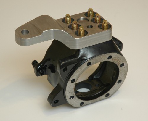

If any one needs a perfect set of knuckles loaded with the birfield I will have a set soon.
Heres whats going on to relace them.:bounce::bounce::bounce2::bounce2:
Heres whats going on to relace them:
What is the difference?
