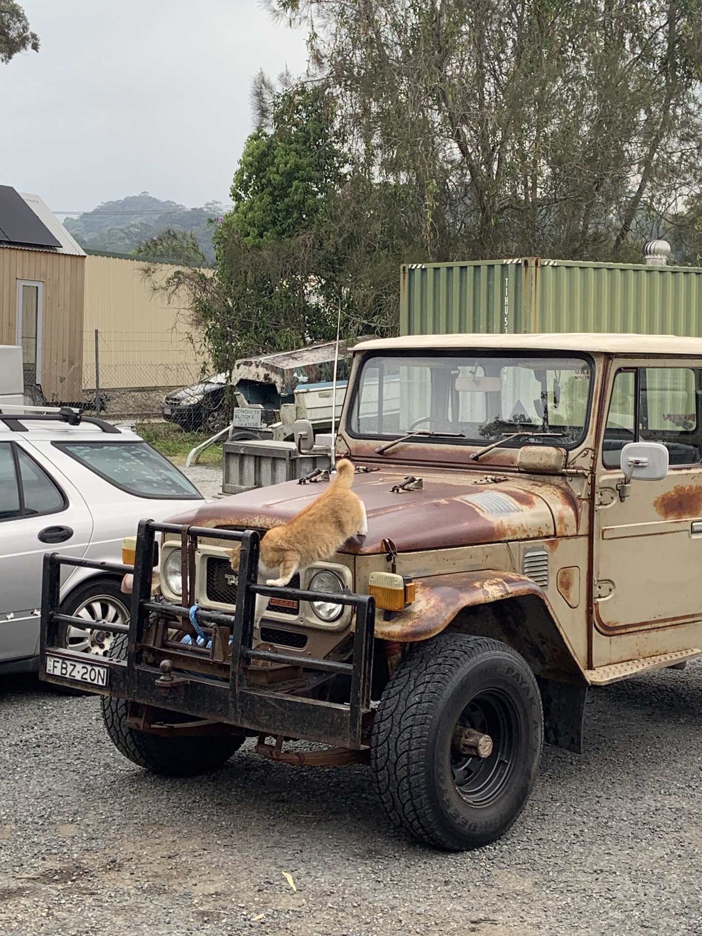

Tyre on the Bonnet did you say?
Difficult to get it up and down there, I don't think the structure will support it (unless you reinforce the hood) and the looks -> well depends.
Get a rack for the back-door and do it in a proper way, means, install a reinforcement inside the cabin to support the additional weight, then you can go even for bigger wheels and a spare canister (ore more).
Isn’t that what the clamps
Are for on the bonnet…..The tyre? Or tire for
You USA fellas lol
Those spring clips are to retain the folded down windscreen.
