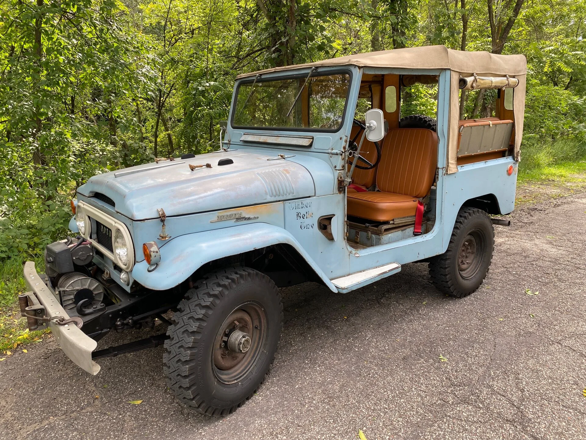

Took Tink out for couple of long runs today. Experiencing a brief, slight hesitation after shifting from 1st to 2nd gear and 2nd to 3rd. The carb sight glass has lots of fuel. The glass fuel filter bowl has fuel in the bottom third of the bowl. Could the fuel slosh aft in the bowl during the acceleration after shifting and cause this hesitation? Any other ideas?
- pop your Dizzy Cap , all that frame pressure washing could have found it's way under the CAP and in the POINTS for sure !
- also , dump in a FULL QT. metal can of SEA-FOAM , i swear by the stuff , if and H2O / moisture creeped inside the tank , that will ZAP IT !
- NAPA is the best place to grab the metal can ......
- also , lastly the patina on the ABOVE OEM Gas Cap tells me the rubber gasket on the flip side could not be sealing well , and may have let stray moisture in ?
- i am totally digging the JDM factory yellow stencil work ! :)

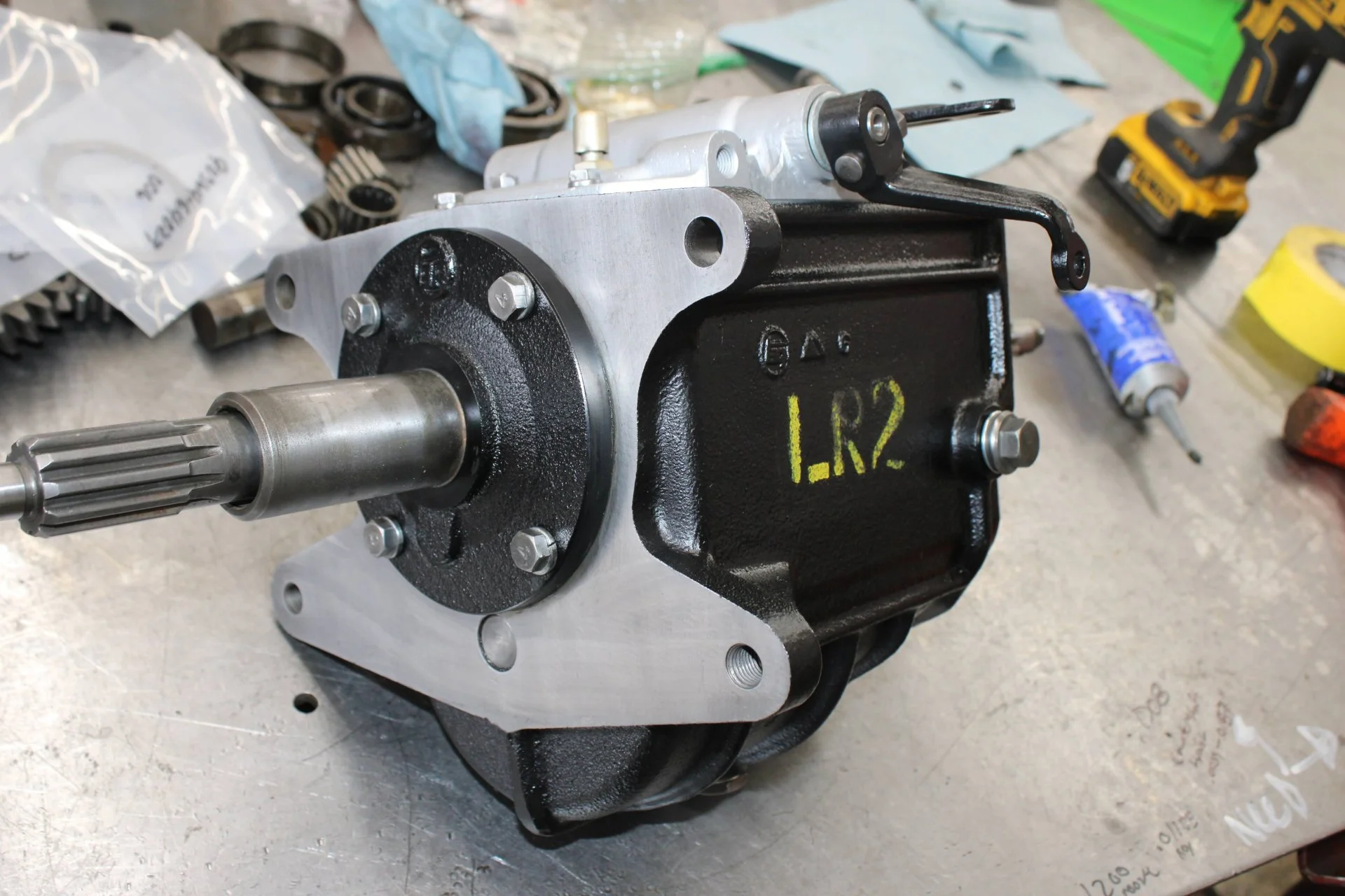

what does LR2 refer to ?

Tried your quick fixes. Popped the rotor cap and didn't see any moisture but left it off for a night. Added a can of SEA-FOAM to the gas. I checked the gas cap and found the seal still in good shape. Yesterday's proving run had less hesitation between 2nd and third gear. If the rain holds off I will go out for another and hopefully with good results.
Not sure on the meaning of LR2, maybe someone can chime in with an answer. I have seen it on other 3-speeds so definitely not a one off factory stencil.

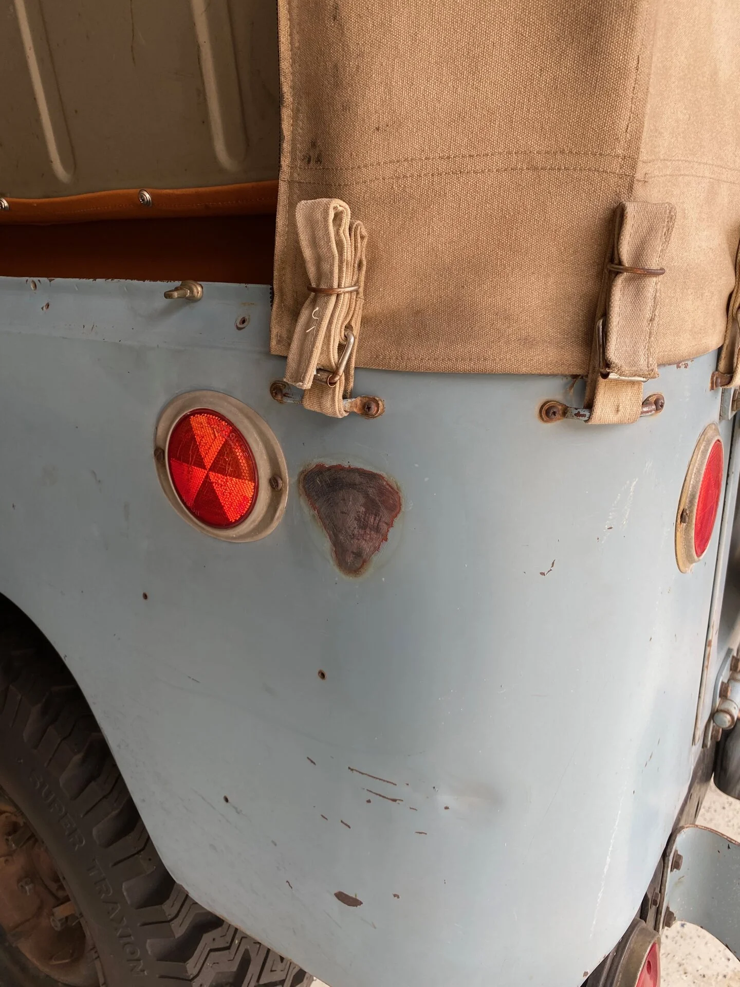

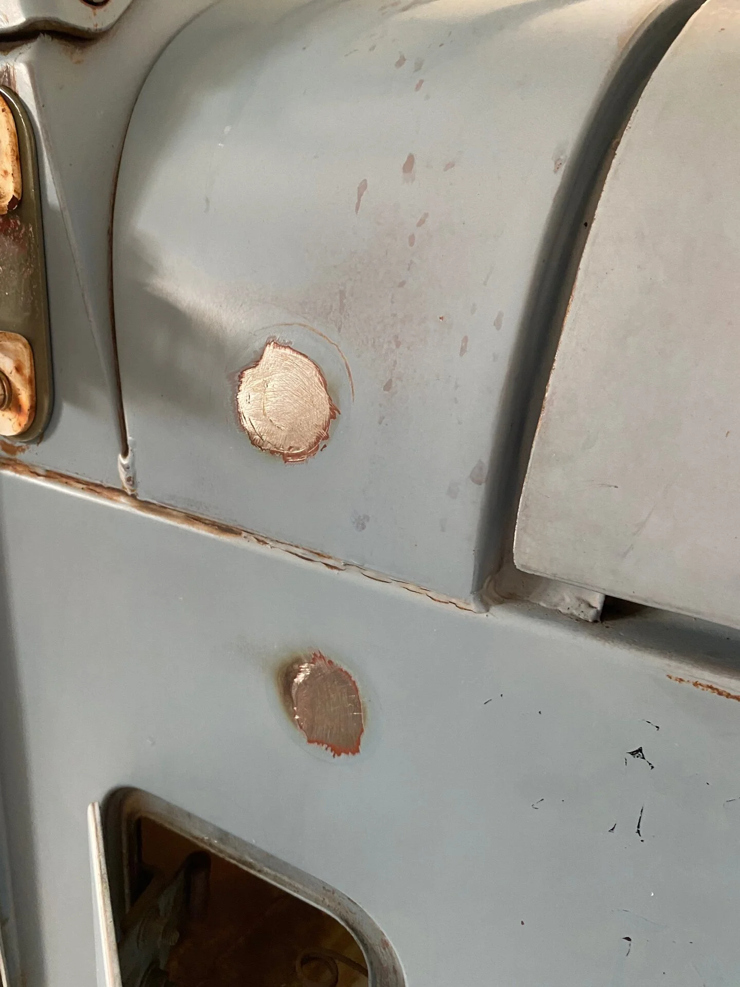

Had Tim TIG weld up 51 holes that POs put in the body. May try and color match some paint but try for some patina to match the rest of the 40.

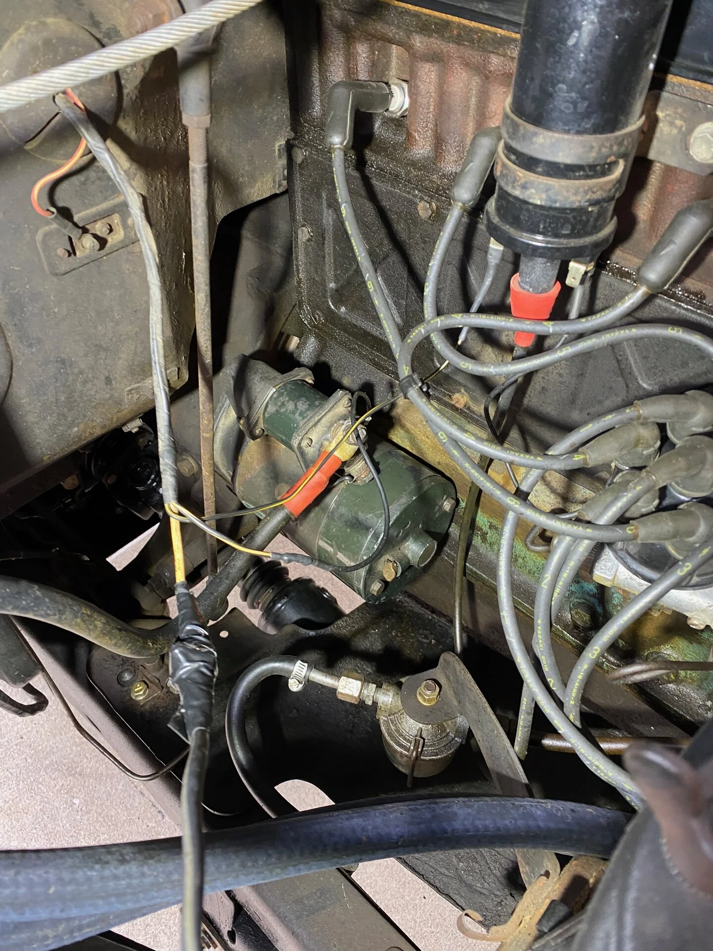

Purchased an original green starter from @65swb45 a few months ago. Dropped it off at Auto Electric Service for a thorough check and refurbishment. The plan is to put it in to replace the newer starter that is in there currently.

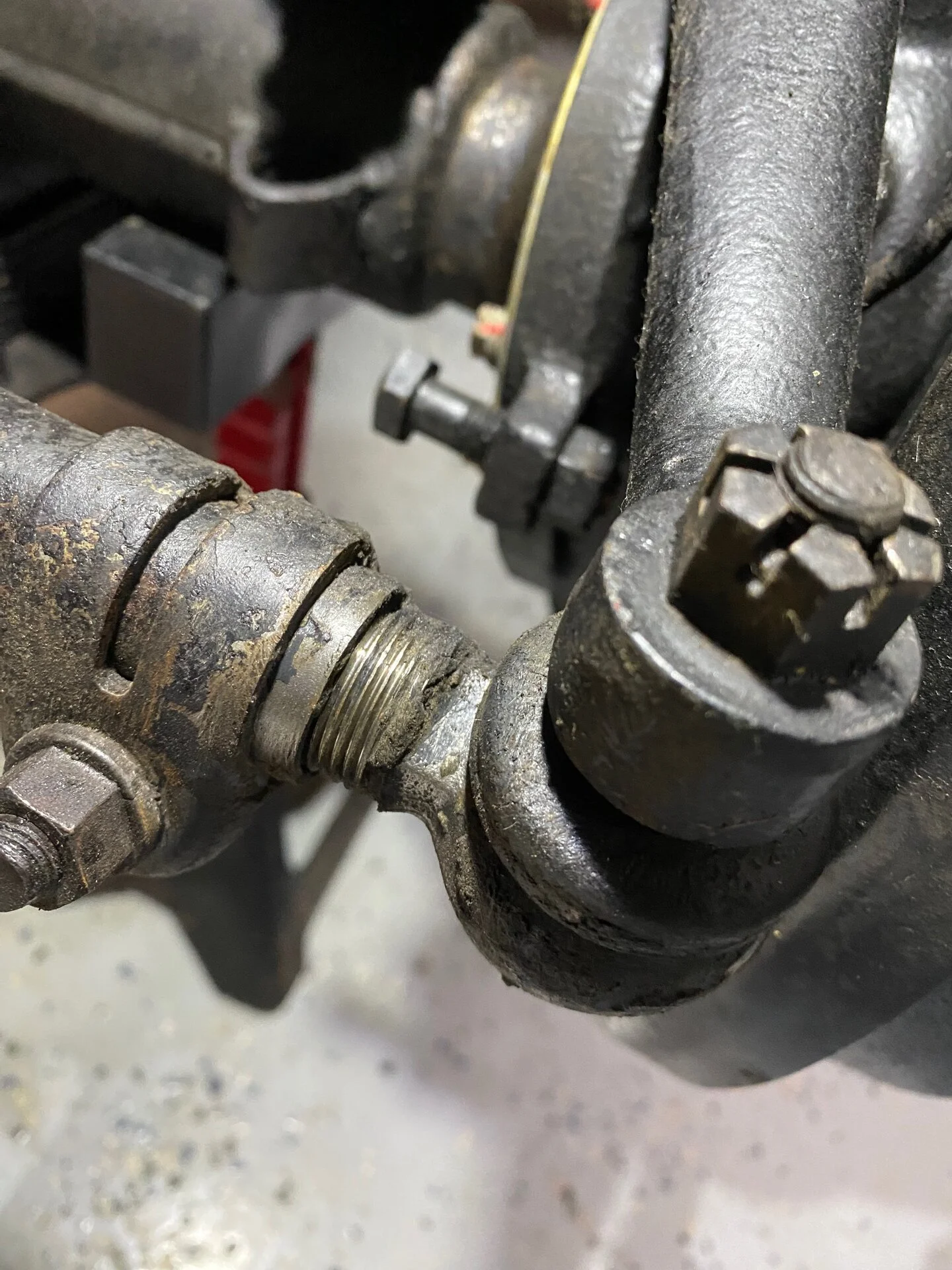

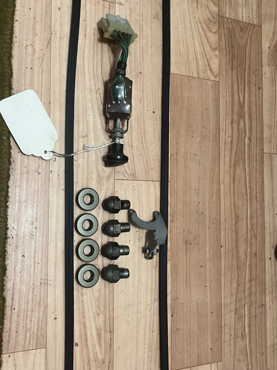

Matt, those castle nuts look different. Did you chuck them already? They may be OE, which was 1.5 coarse pitch in ‘64.
They have other uses on the’64.
Nice to see the starter in a good home. 😊
I think I threw most of them in the tub of parts for the next trip to the plater. :hmm:

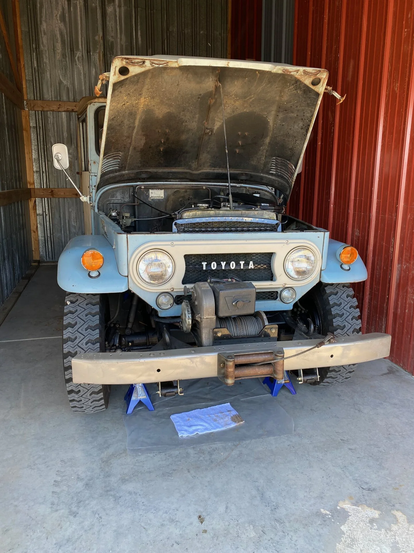

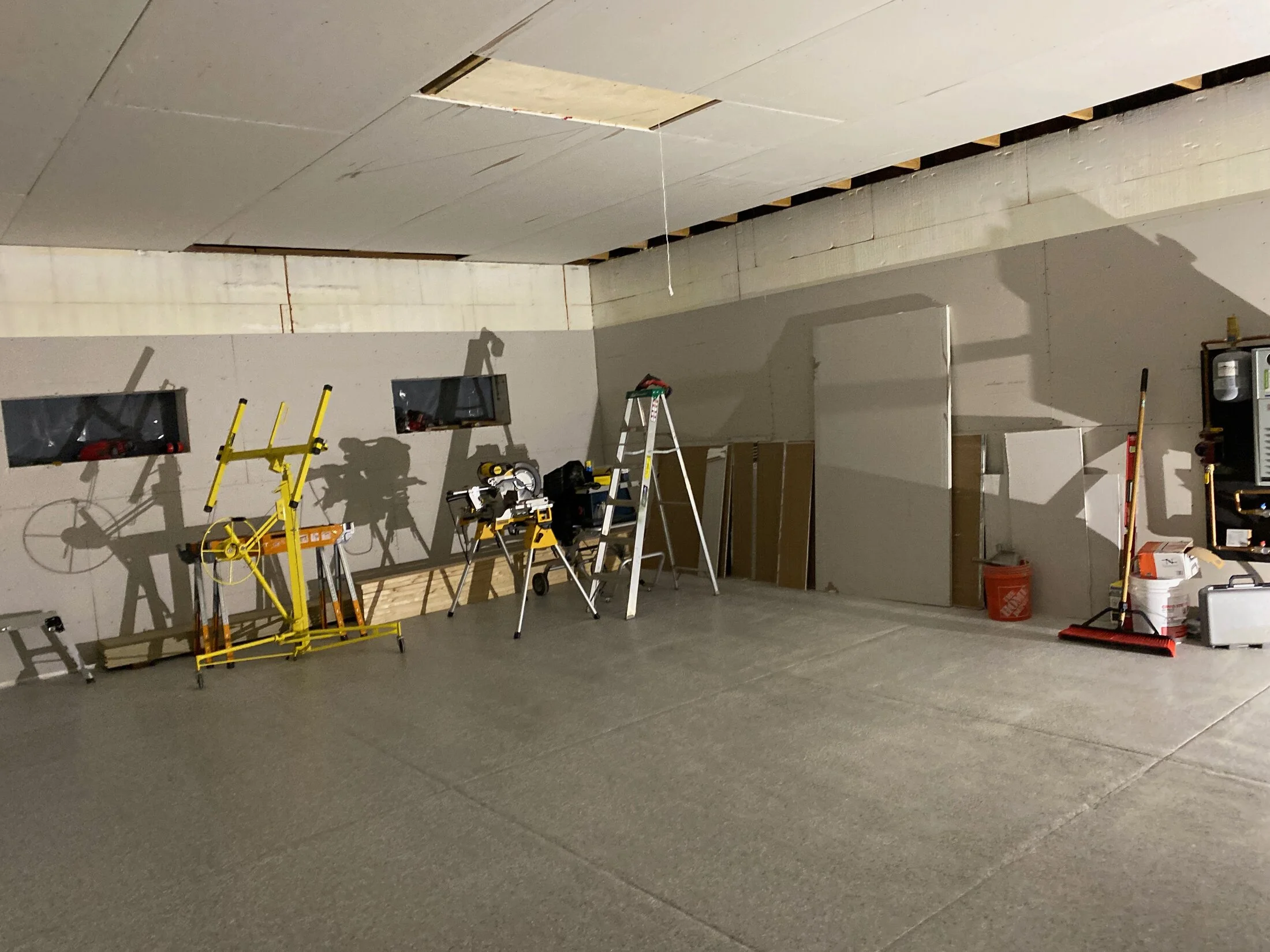

Still a month away from bringing Tink home from storage. Bought a few little items over the winter to install when she is back home. Busy spring and summer building a new detached garage. Shooting for completion over the summer.

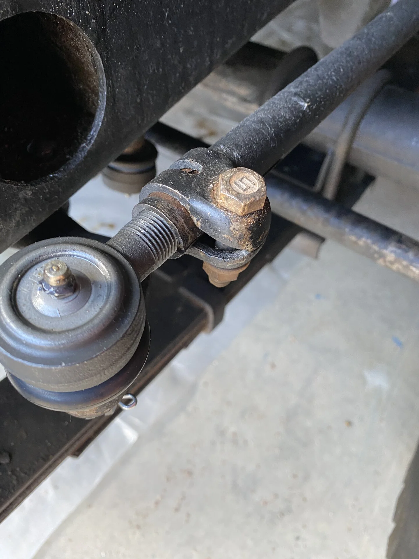

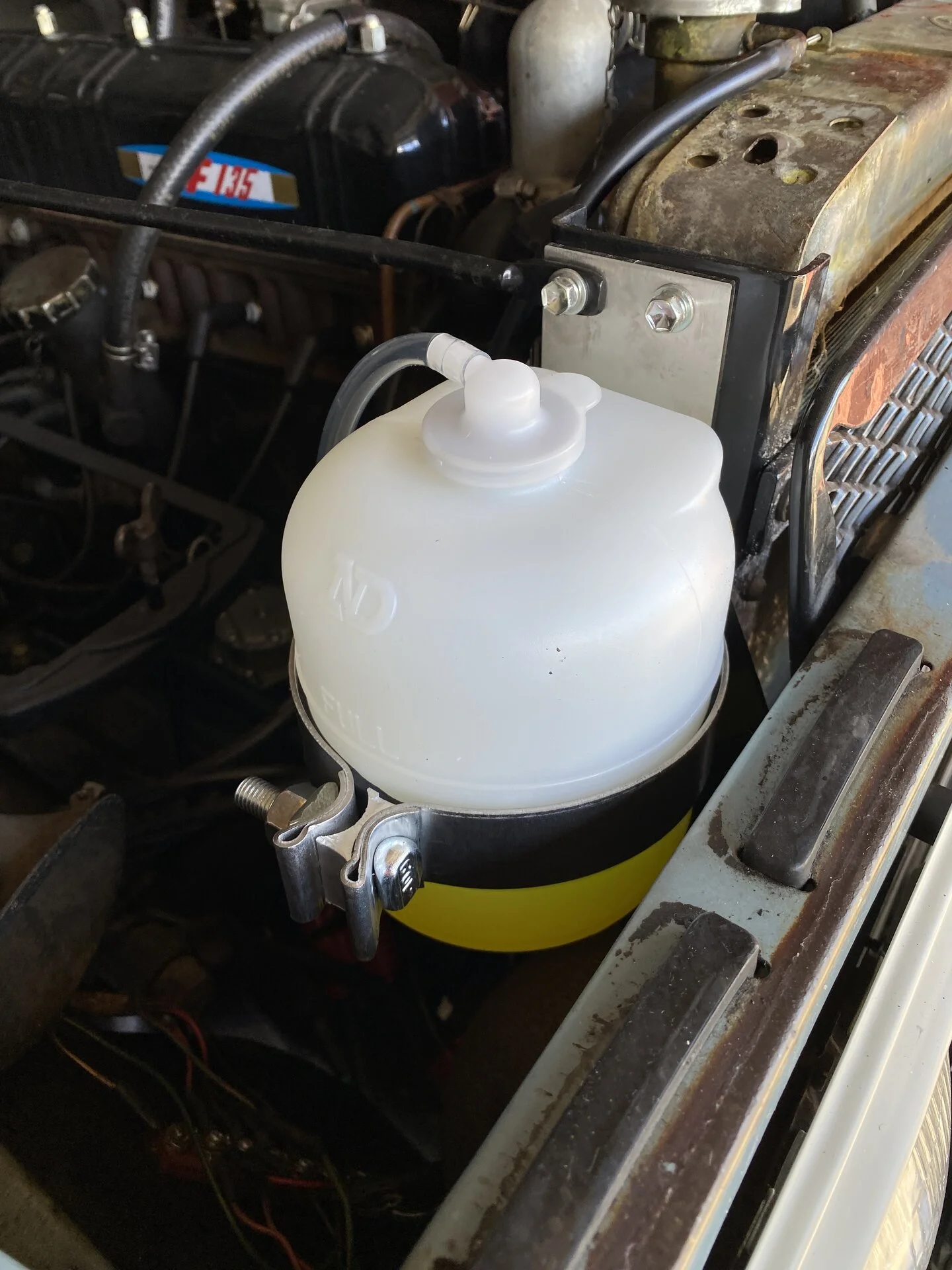

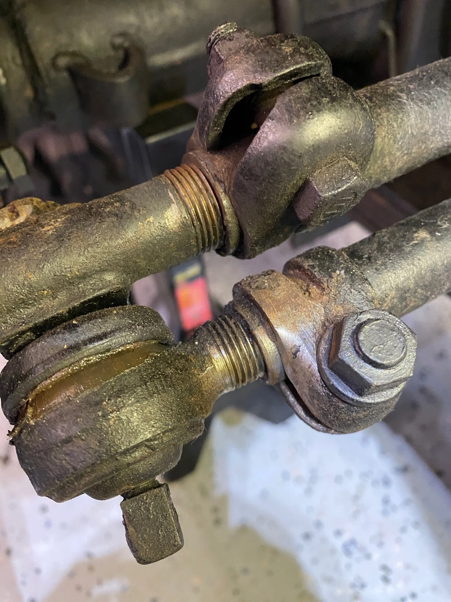

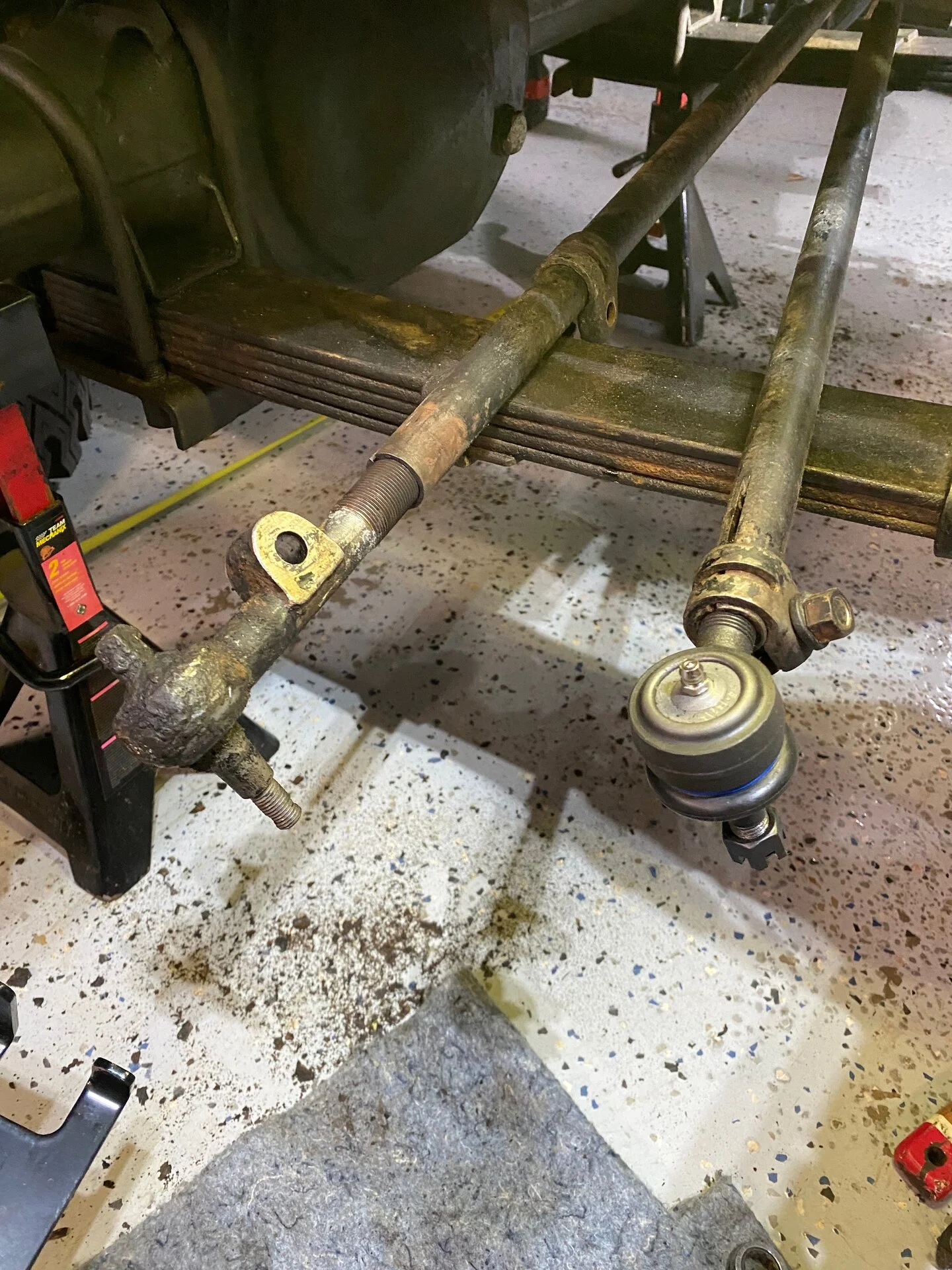

Found an original tie rod end clamp bolt and put a Cruiser Cult/City Racer coolant overflow tank on over the winter. The bottle is a later version but keeps the coolant contained and is easily reversible.

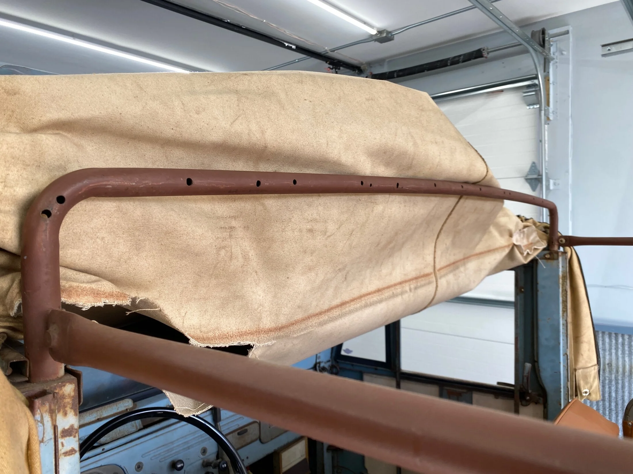

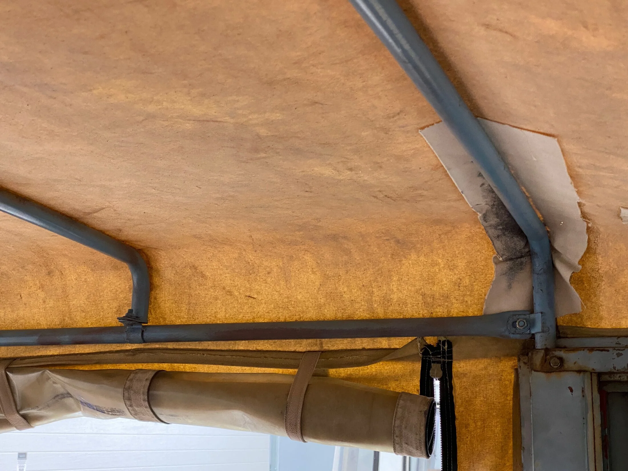

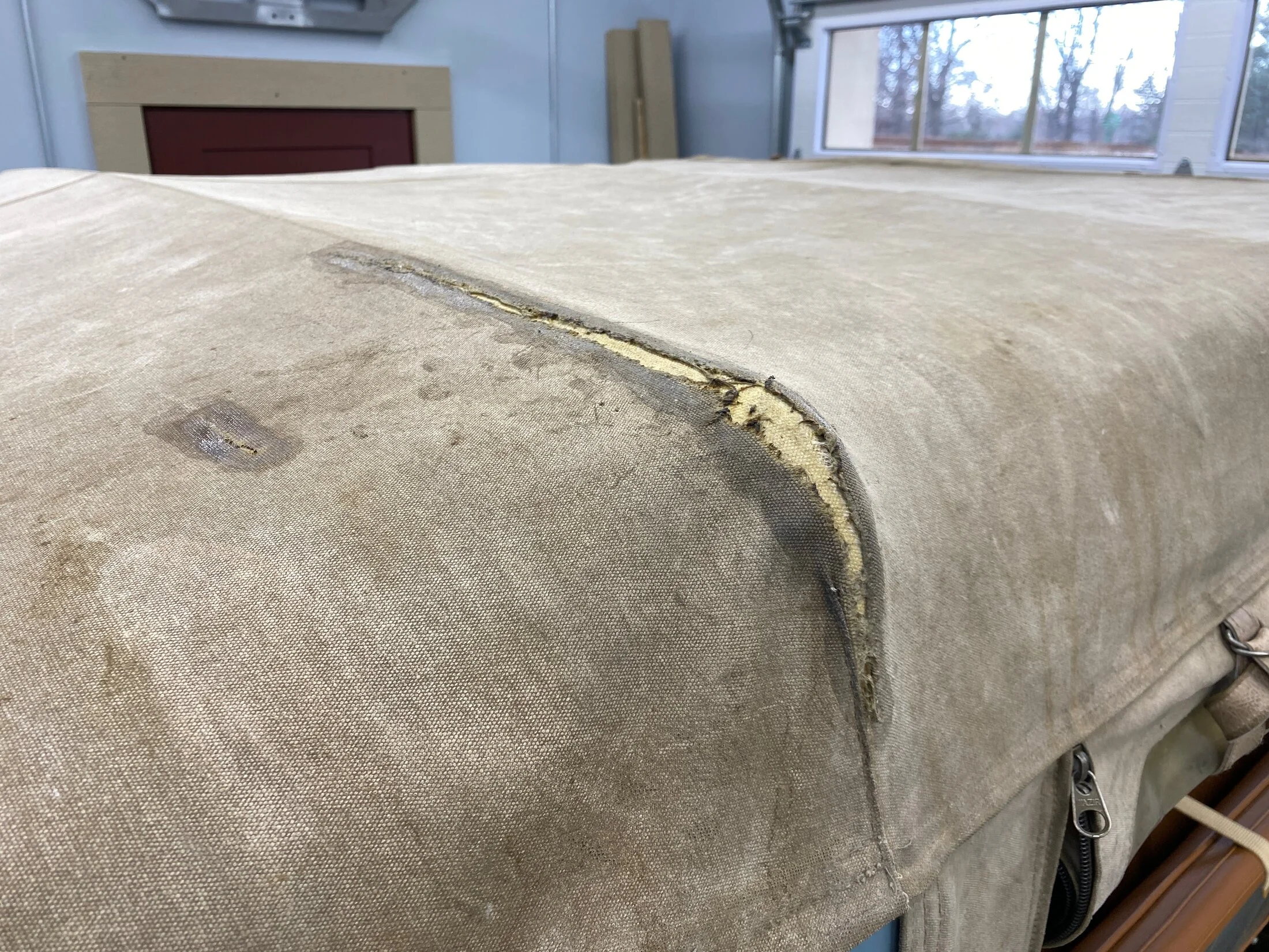

Did a little bit of work on Tink over the winter. Took the top off to do some fabric repairs and fix the 63 holes in the bows. Sprayed some blue on the bows and then wiped some of the paint off with a cloth soaked in thinner to give it a distressed look. Not perfect but it's better than the brown piccolo tubes.

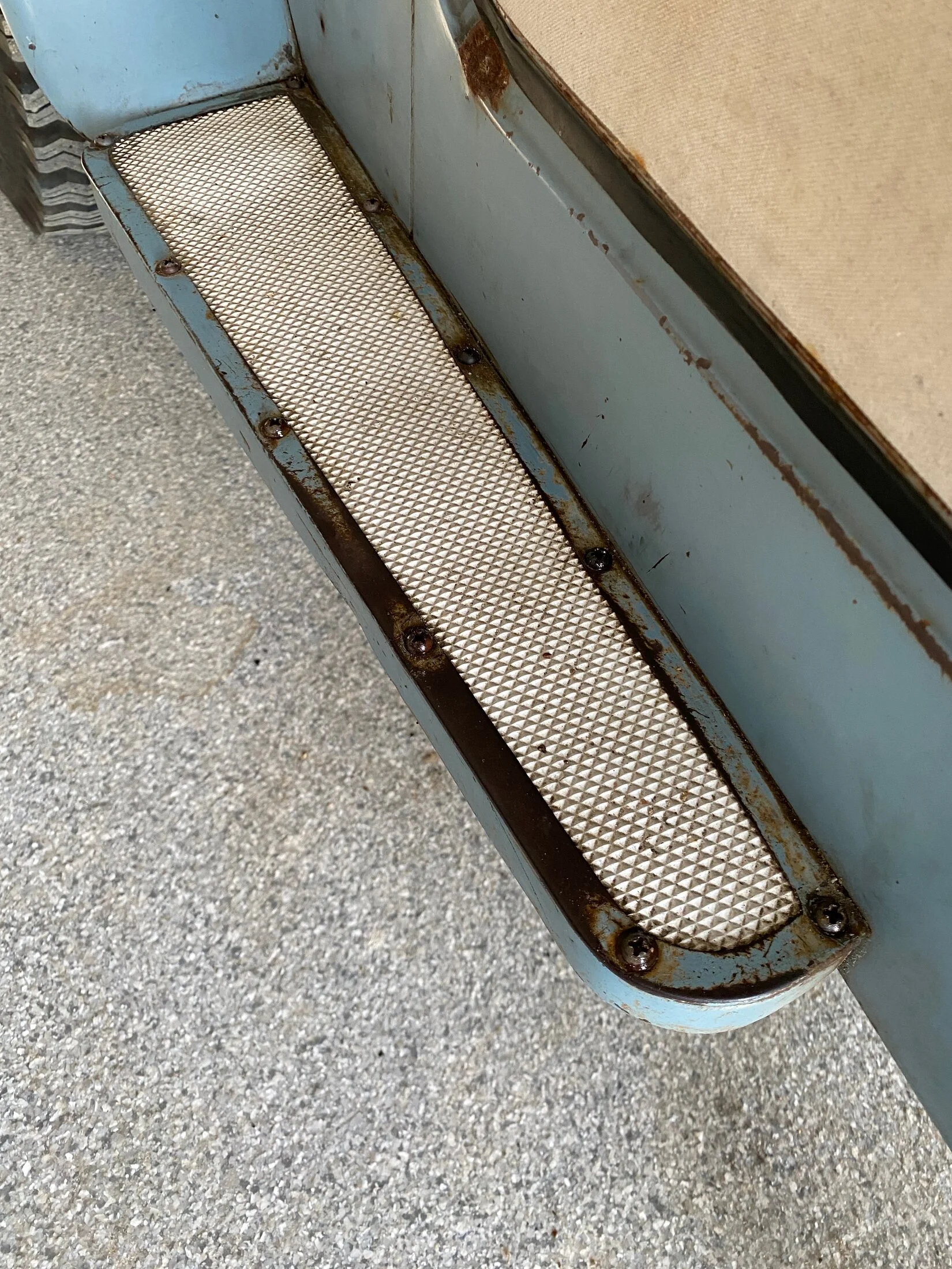

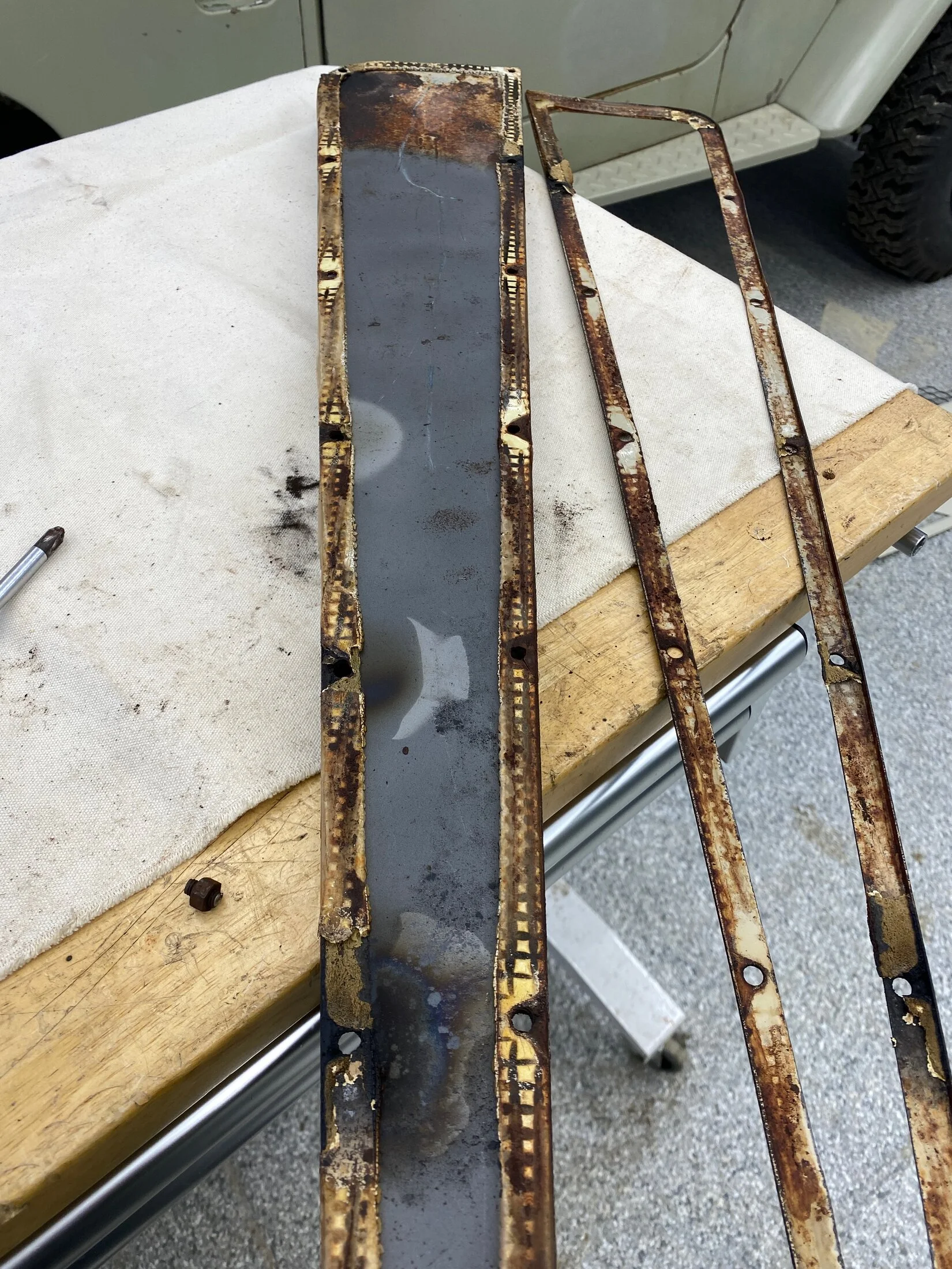

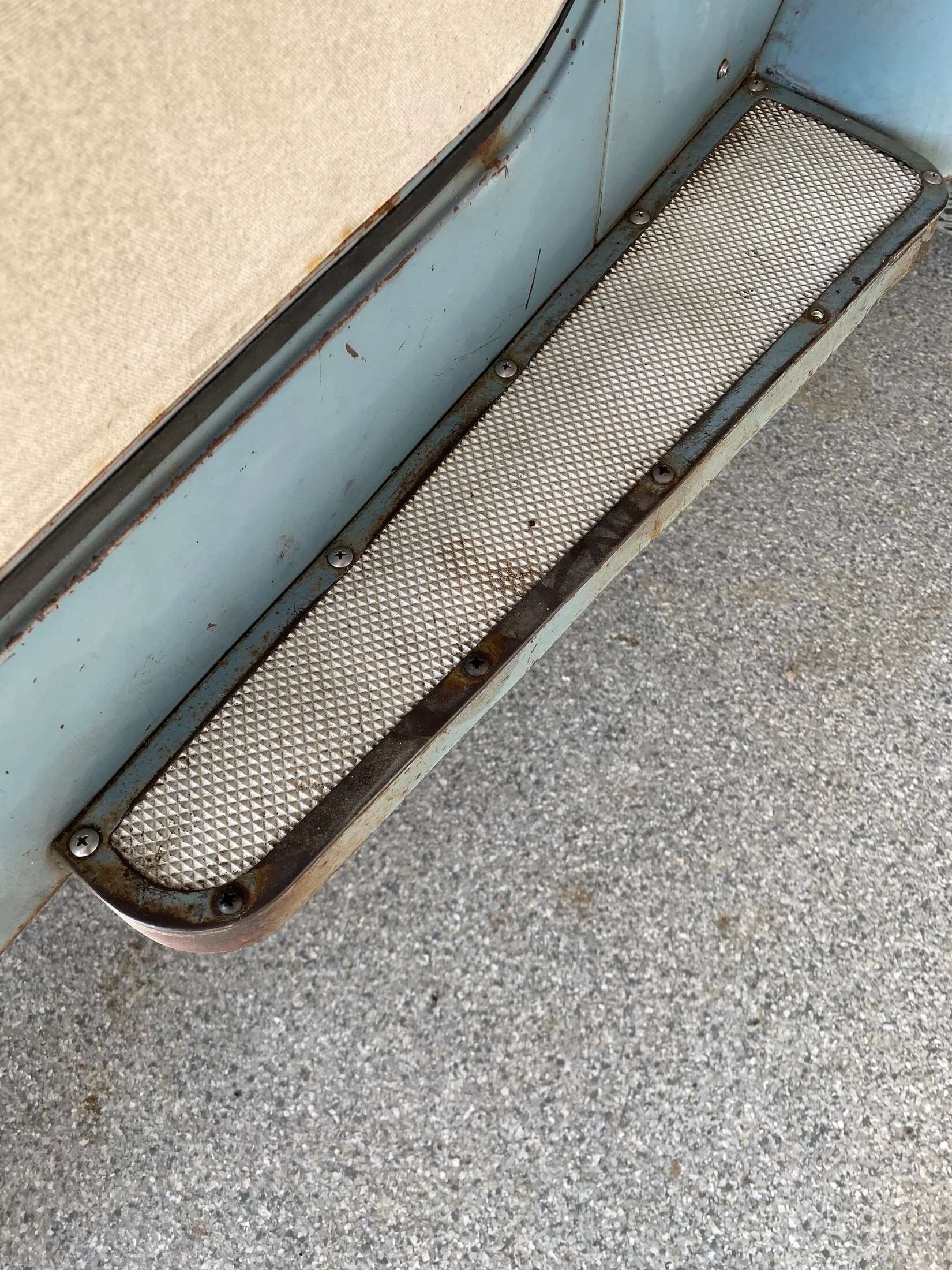

I had some extra running boards sitting in the attic that still had their original nuts and bolts. Decided the bolts would look better on Tink's running boards. Challenging getting the nuts and bolts off without breaking them. A couple of weeks of applying a penetrant and some heat got most of them off unbroken.
I have noticed that this truck has a fairly small number of replacement hardware and that finding originals is kind of fun and challenging. I also like the look of the original hardware. Gotta find 7 more to call this part done and 4 for the fuel filler neck.
