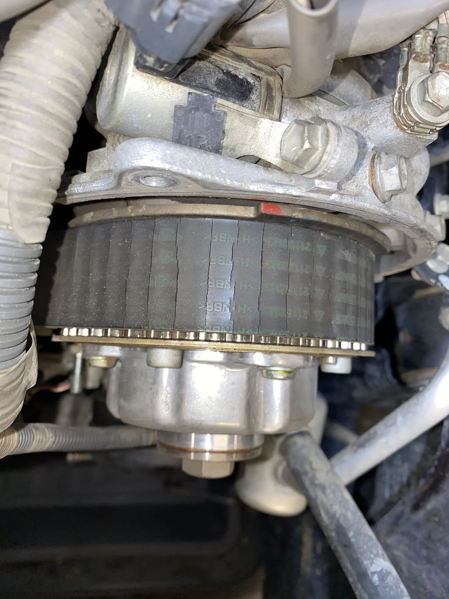

I am currently replacing my original timing belt from 2000 with 125K miles. Thin cracks in the belt. Water pump slightly weeping. Bearings on pulleys a bit rough but nothing alarming.
My point is that its not just the belt that needs the maintenance: WP and other parts need to be changed out.

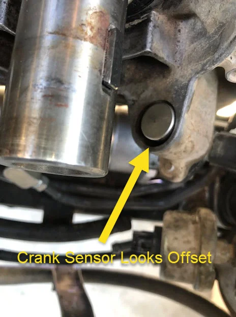

Also, the crank sensor looked crooked/offset, which baffled me.. but apparently this is normal

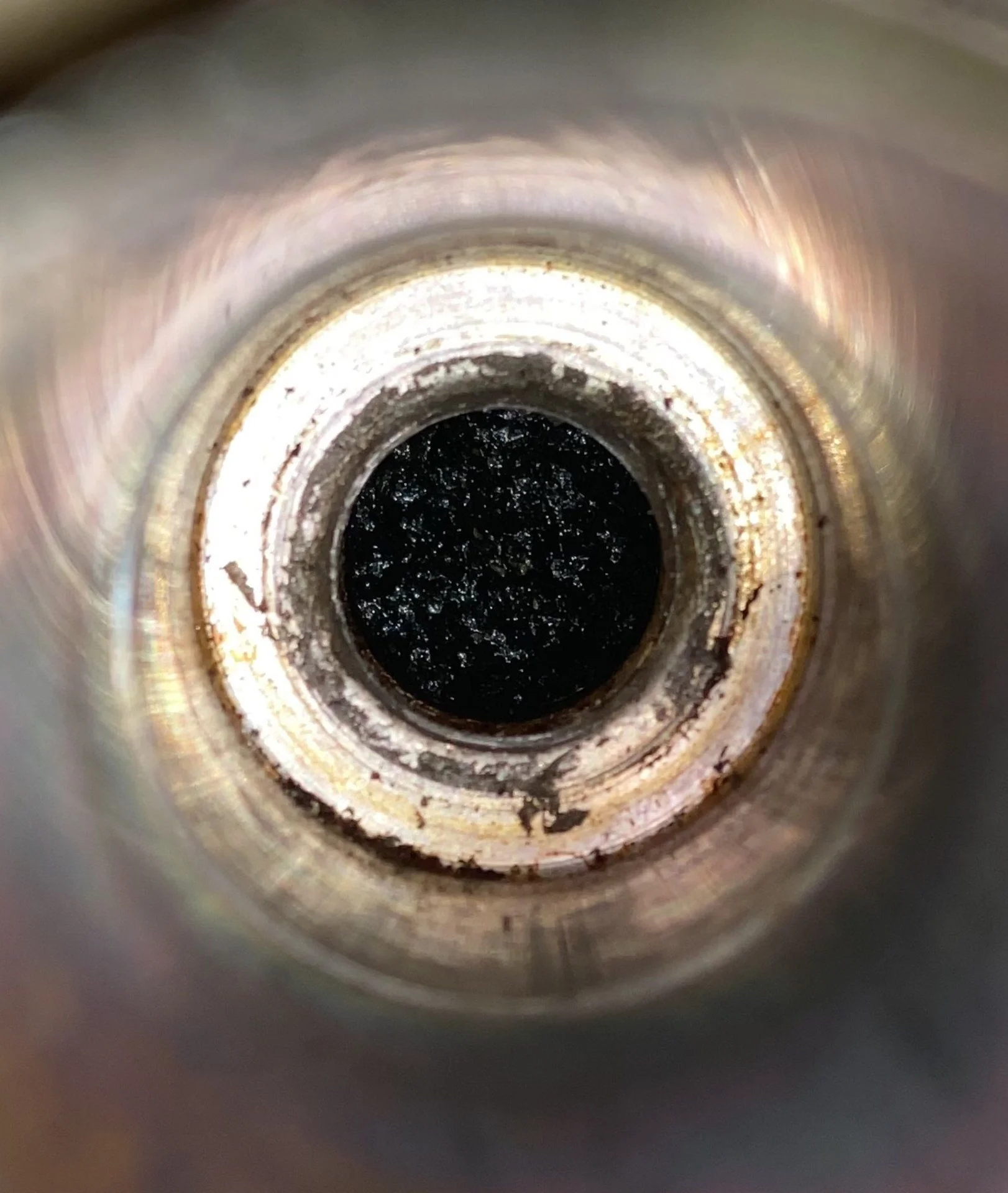

Here's a 2005, where new belt installed. Cam BK2 spun (cam bolt not torqued) shearing knock pin and stop at different degrees as engine started and stop multiple times. I estimated, based on statement of how engine ran each time started, key off then restart. Cam started at 0 degrees (on the mark), 45, 90, 135 and 180 degrees off. Is was run and crank again and again. Yet no interference.

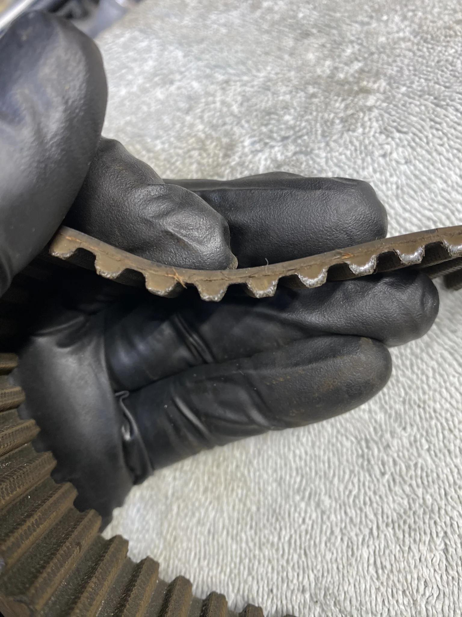

Here's the worst Toyota USA belt, I've seen, and only at 9yr with 109K miles. This Toyota USA belt in a VVT engine for~100K miles in the "ice box" of the nation, Fraser, CO. Where Temps ranges from -43f to +93f. The belt creaked as I turn the crank back and forth (CC & CCW).
The above belt, was replaced at Toyota Dealership at 45K miles. They, as is typically, did not replace pulleys, tensioner or fan bracket. Which I almost always do. But at 45K miles, I probably would not have either. At ~150K they all needed replacing.
View attachment 3706785View attachment 3706786
