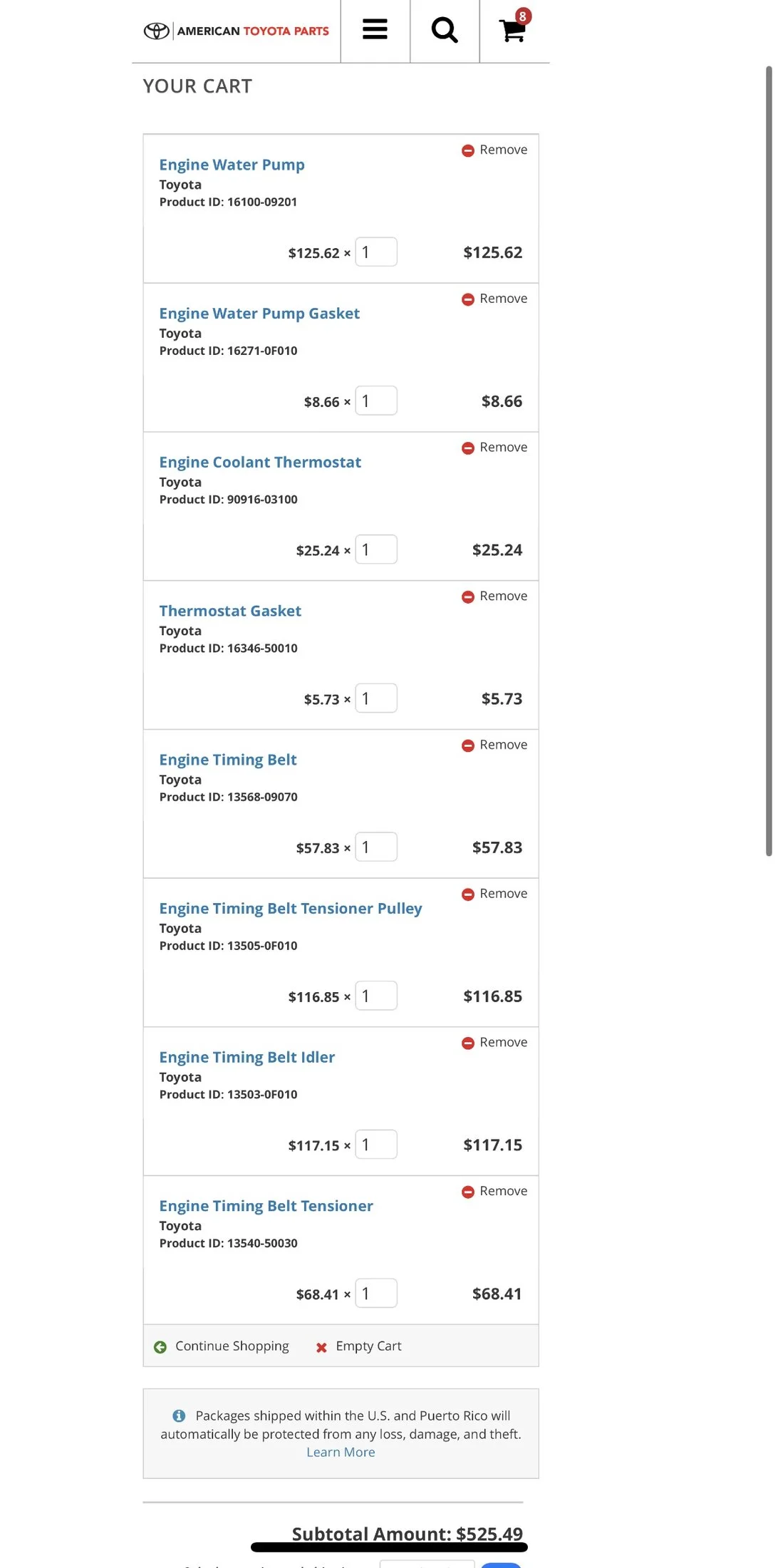

Here is the basic list I used for my 06' LX470. Not sure it is a direct match to your JDM 100 Series.
Water-pump - 16100-09201 (other PN: 16100-59275-83*)
Water-pump Gasket - (*16271-0F010) 16271-50010
O Ring (For Water Inlet Housing) - 96761-35035
Timing Belt - 13568-09070
Idler Sub-Assy, Timing Belt, NO.1 - 13505-0F010
Idler Sub-Assy, Timing Belt, NO.2 - 13503-0F010
Tensioner Assy, Chain, No.1; Tensioner Assy, Timing Belt - 13540-50030
Coolant FIPG Seal Packing 1282B - 08826-00100 - For use on the water inlet housing

The aisin kit isn't even "complete" ... you'll still want the Thermostat, crank seal, cam seals (non-vvt-i engines) serp belt and fan bracket. Possibly radiator and hoses, depending on age/condition obviously.....go on ebay and look up the kits sold by aircabinman, they are genuine and complete minus the fan bracket....
I sourced this list from American Toyota.
Customer decided to go with a kit for half the price of dealer.
