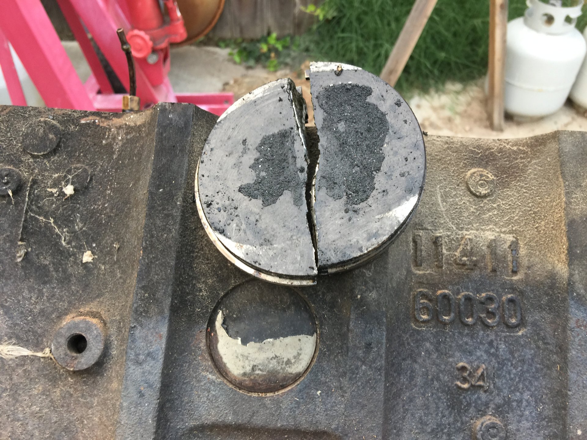

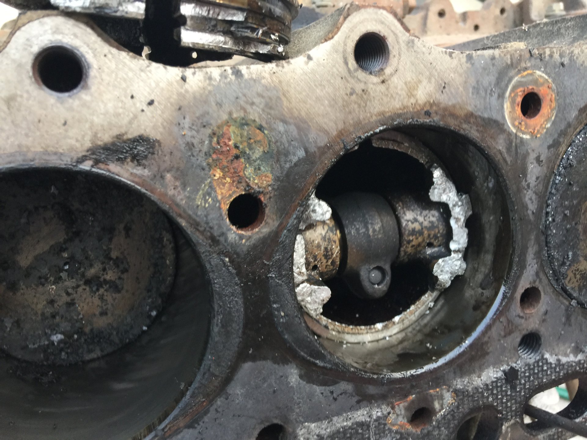

I`ve had some blow-by for the past 3 months or so well actually a lot of blow-by. So I did a compression test and it went #1=132 #2=60 #3=135 #4=137 #5=146 #6=155. So today I stuck a bore scope in to #2 spark plug hole and now I know why so much blow-by.

Exhaust valve in head? if so just get a new head. All the other numbers are good.
I wish that is the top side of the piston you can see part of the top ring. But it still runs good just has lots of blow-by
Thanks for showing that pic. I have a lot of blow-by in my early '63 ('64 1F) but my compression numbers are all really good. Good luck with "fix" or replacement.

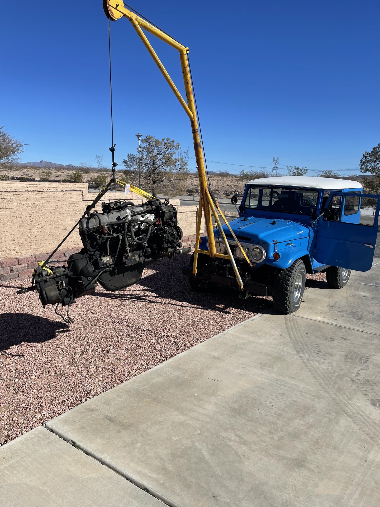

A gin pole is a really useful piece of equipment.
Yes it is. It makes lifting and moving heavy items a little easier.
