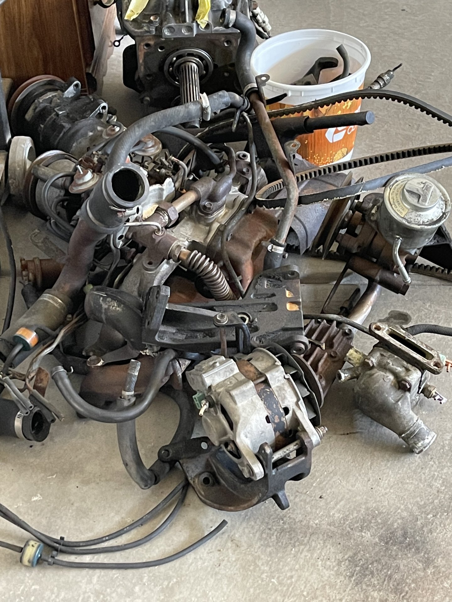

I'm still trying to figure that out but you would need most of these things.
Believe you would also need most the other 60 stuff including the carb with the vacuum port to connect it to, a vacuum advance distributer probably a "gas filter" vacuum fitting on the intake manifold, the violet vacuum fitting on the thermostats housing and about half the spaghetti of how it was in the 60.
Hopefully someone else with more vacuum wizard skills can confirm?

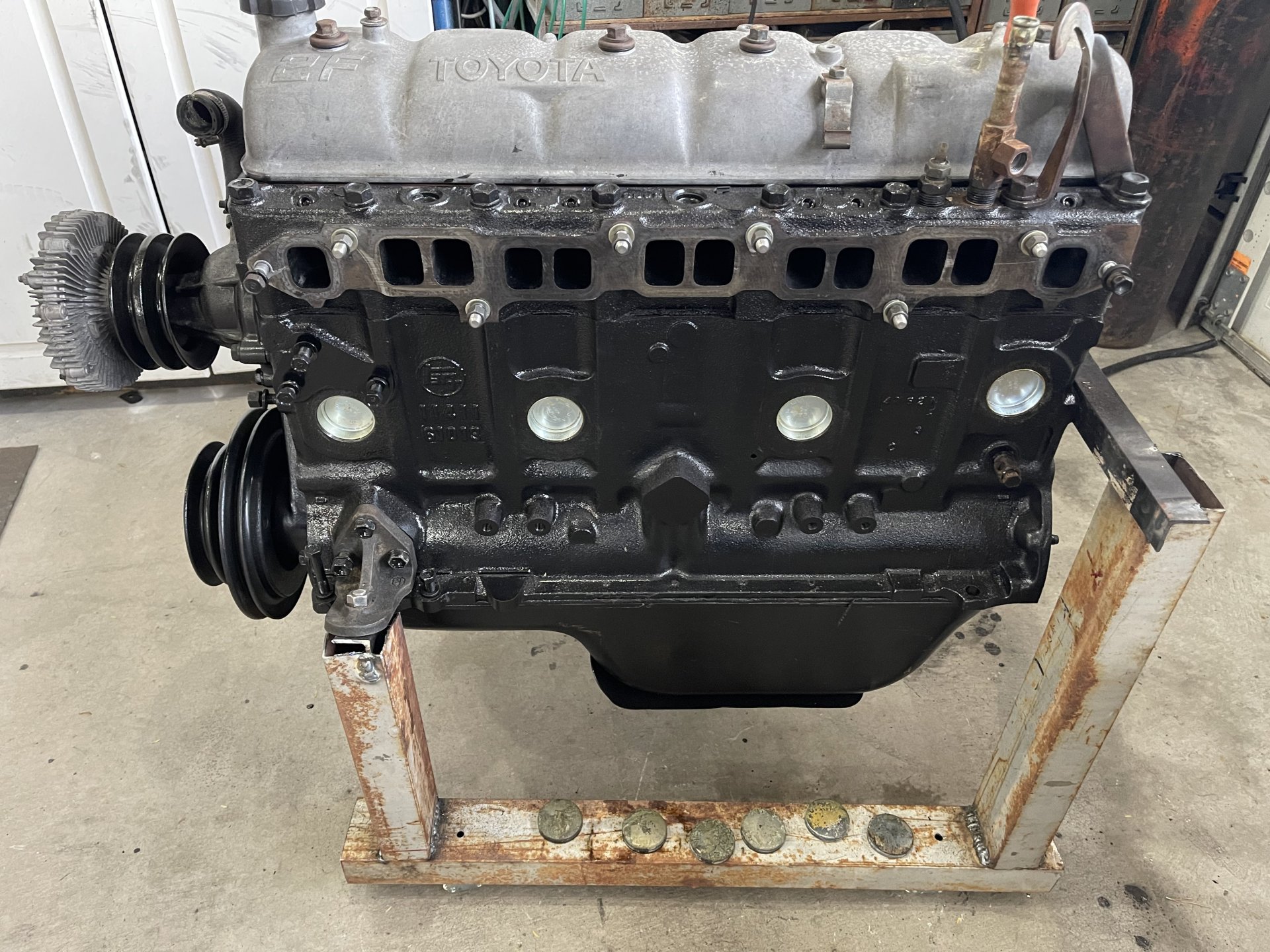

I`ve got it pretty stripped down. Now to finish cleaning and paint and some new freeze plugs & a desmog kit from TLC. I`m going to run the early manifolds and my sniper efi system. It should run pretty good. The valve train is really clean also.
Yea I got a pile with all of that smog pump, carb, vacuum tubes, egr, cooler and stuff, intake/exhaust manifolds, A/C compressor, transmission.
I got some more time today and made a stand and got the freeze plugs changed and stud kit for the early style intake/exhaust manifolds. I was very surprised on how clean the inside of the block and head were the freeze plugs were in great shape also.
Also believe that clutch fan is too long to fit in your 40 without moving the radiator forward are you planning on replacing it with a non clutch fan and water pump?
I`m running a clutch fan now. I actually measured it today and it measures the same as what I have now. So that part should be good.
Engine is looking great! Whats the advantage of using the older intake/exhaust vs the ones that it came with? Also what paint did you use on the block?
Thanks. I don't think there is not really any advantage except that I will be able to use my same linkage setup and the exhaust should be easier to line back up and bolt up. The paint is just an engine paint.
