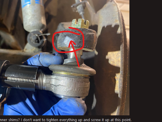

To shim or not to shim...without the shims the ball joints are obviously way too loose. But with the shims they look like they won't snug up. Is that OK? I am worried I won't be able to get the castle nut far enough down to set the cotter pin.
Or do I need thinner shims? I don't want to tighten everything up and screw it up at this point.

Sorry I missed this...After making the measurements, it looks like the inner diameter of the shim or the OD of the new TRE is the issue. The shim fits great in the arm, I could snug it up nearly flush. The thing I am worried about is the tie rod end sucking up enough to clear the cotter pin hole.How much have you actually tightened the TRE and shim? They are a softer material and will "pull" into the steering arm a surprising amount as you torque the tie rod end castle nut. Worst case you grab a file and knock off a little material until it pulls together nicely.
I'd suspect the Tie Rod End and Shim are fine and the hole in your arm is slightly out of round from years of getting smacked with a sledge to pop the end out. The shims will be tight on new tie rod ends and new arms too. We have a taper tool we often use to clean up the roundness of arms.
