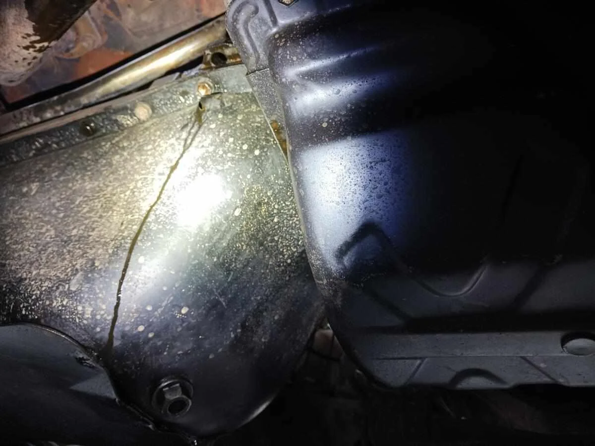

Sent it to the shop, and they sent some photos of what seems to be a hole in the oil pan. Apparently most likely threw out a rod and pierced through the pan on the way out. I don't understand how this happened - I baby the car and drive it very carefully, and I can only assume somehow/sometime that either all the oil got lost or oil pressure got lost. I haven't noted any oil residue below the car in the morning or otherwise, though. Picture below.

Was it overheating before it died? Could be smog pump seized, threw the belt and then waterpump would be no longer pumping. Overheated it and boom.
Anything happen with the gauges prior to this? Your gauges are your alarm bells. Did your temp gauge peg to the hot? Oil pressure drop to nothing? Any warning lights flash on? It'll all be speculation till the engine is torn down and analyzed.
Could have been running rich after the carb rebuild. The oil became saturated with fuel and thinned out causing the rod bearing to fail. That is just a guess based on the recent events you explained. Due to the long stroke on these engines they do not not high RPM's. 3000 RPM is not really high but I keep mine under 3000 when cruising for long periods. Limits me to about 60-65 tops.

Not sure, but that intermittent squeak sounds like an accessory or water pump bearing ready to seize. Perhaps could be a belt, too. So many possibilities for the cause, impossible to know without more info or possibly a teardown.

That sucks.. I always thought something like this usually just happens from negligence or bad maintenance. Never imagined that it would just randomly happen all of a sudden...
How likely do you think that explanation is? Just curious as I'm not sharp enough to assess. RPM wise, I really don't even get to 3krpm, definitely tops.

Appreciate the condolences. I'm just surprised that it came out of seemingly nowhere. Figured there'd be a lot of obvious signs and perhaps some more grace before such a major failure. The car is at K&H Imports in Canoga Park right now. Photo of the hole in the oil pan is from them, they are gearing up to remove the oil pan and investigate further.
