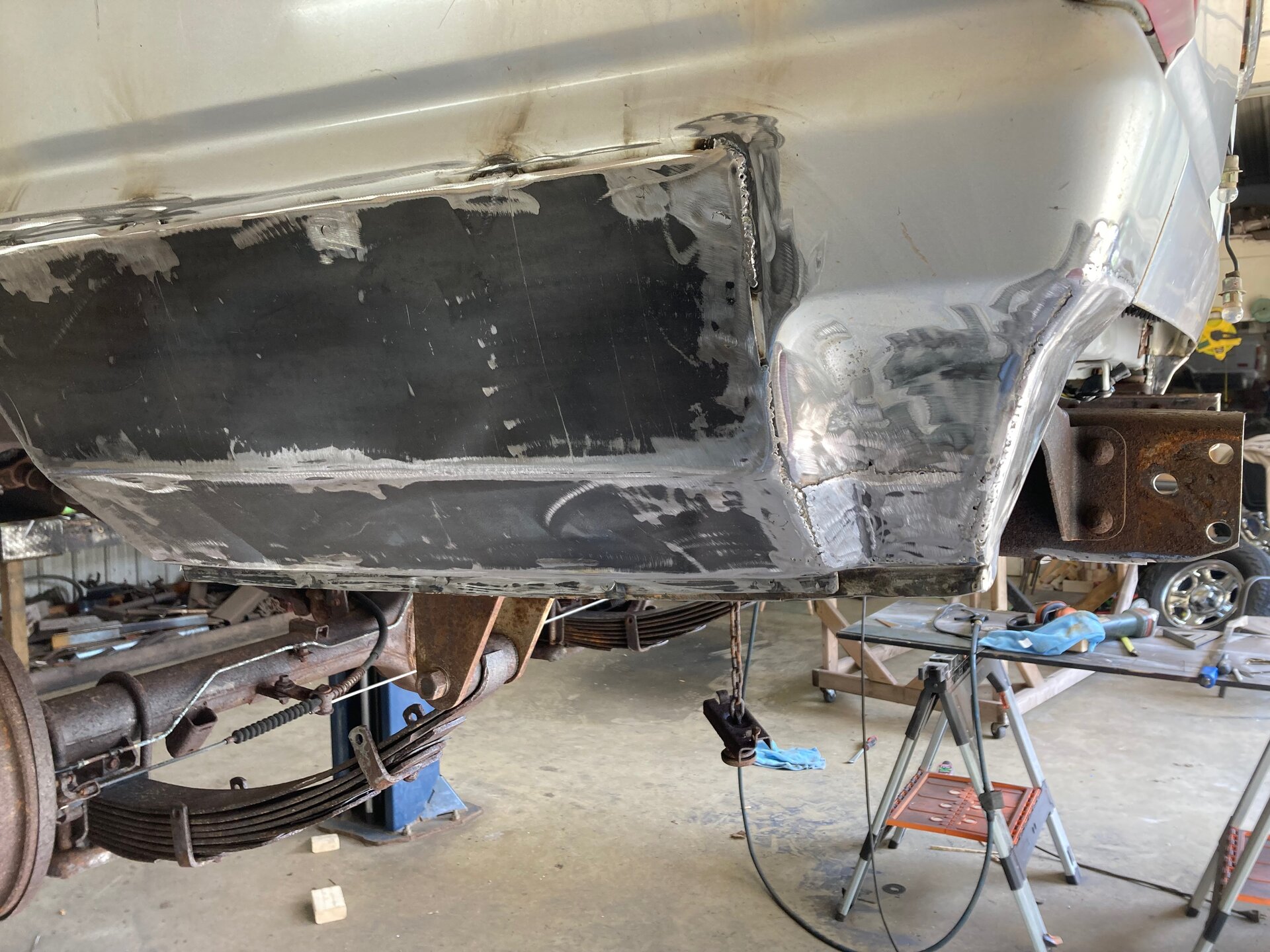

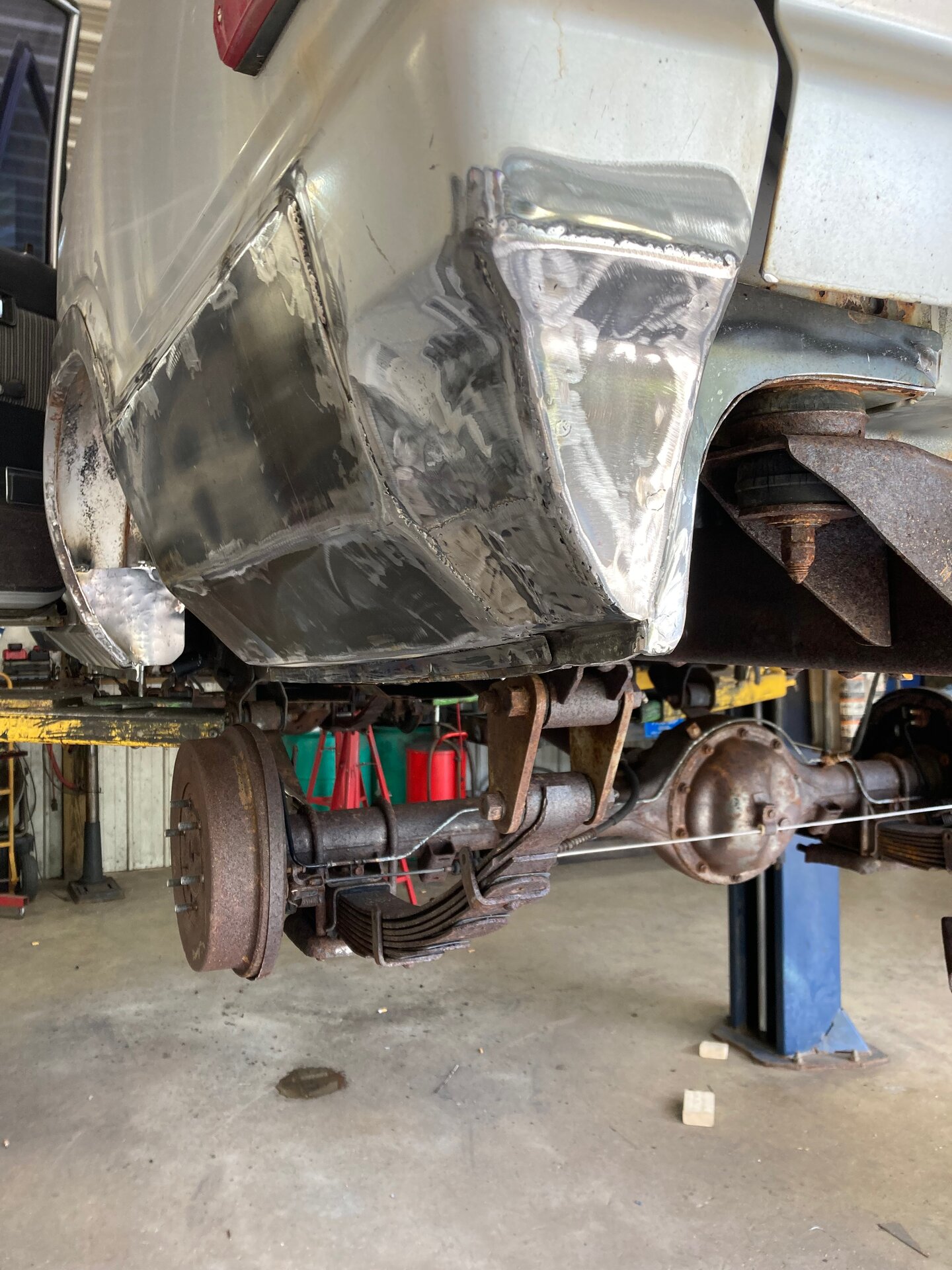

Chicago salt ate up everything that was replaced. I wish I would have taken pictuers before. Here are more pics from mid getting fixed:

Yes, rolled steel. He tried to buy parts, got frustrated and then just started fabricating with what he had in his shop.
It's pretty damn thick, atleast 16.

So I talked to the shop owner. He is going to cut out rust and weld in new steel where needed, sand and paint.
