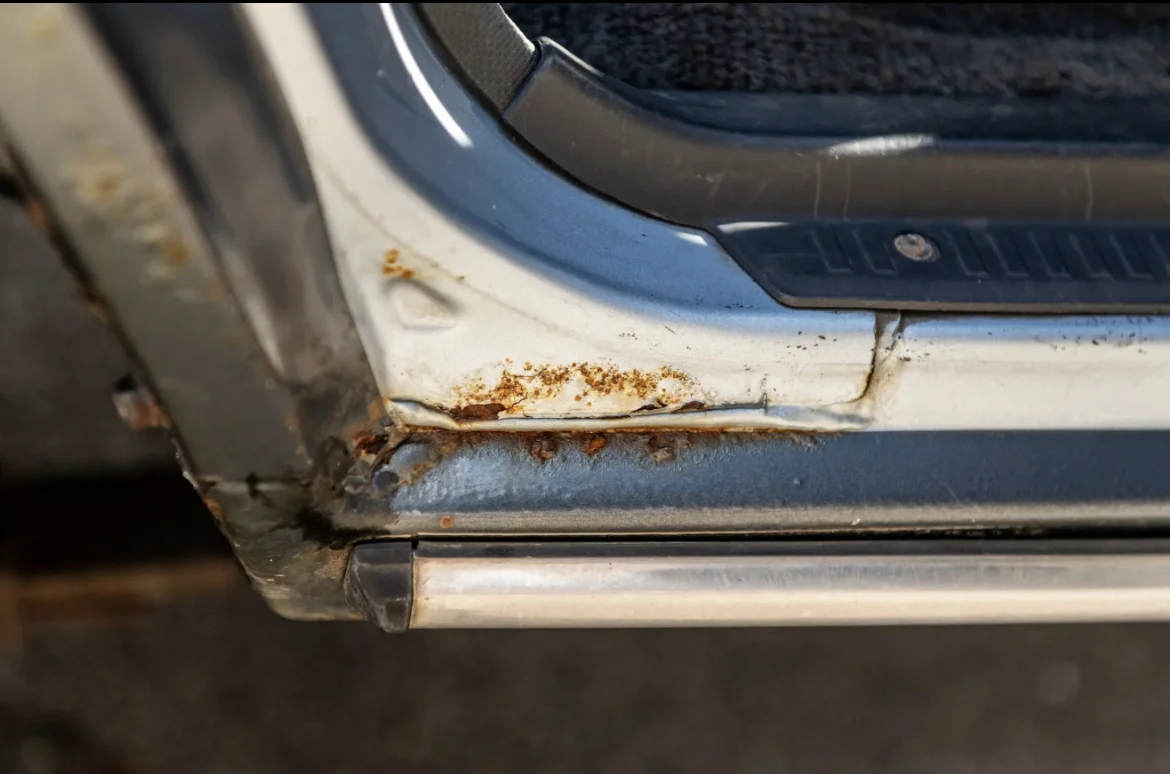

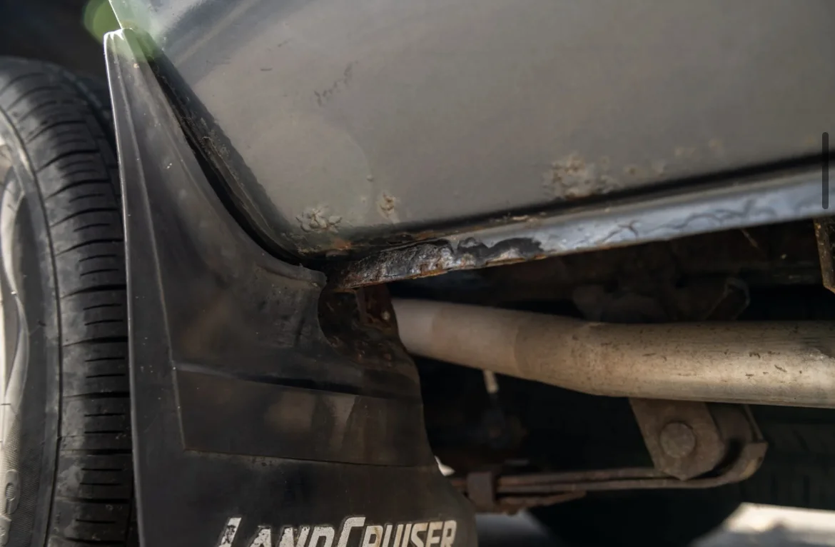

So I live in WV. Most body shops around just want to do collision repair. Others that do renovation have long wait lists (was told 2 years by one person).

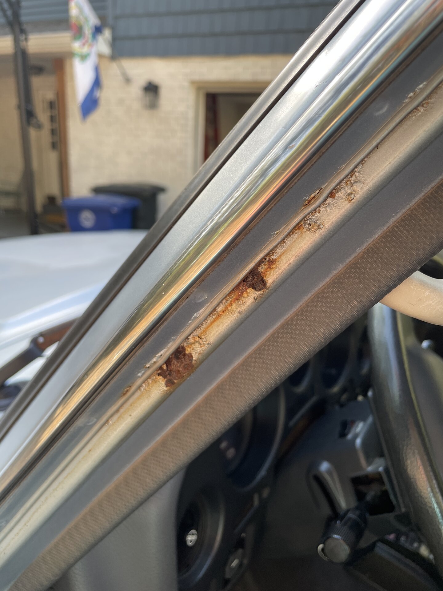

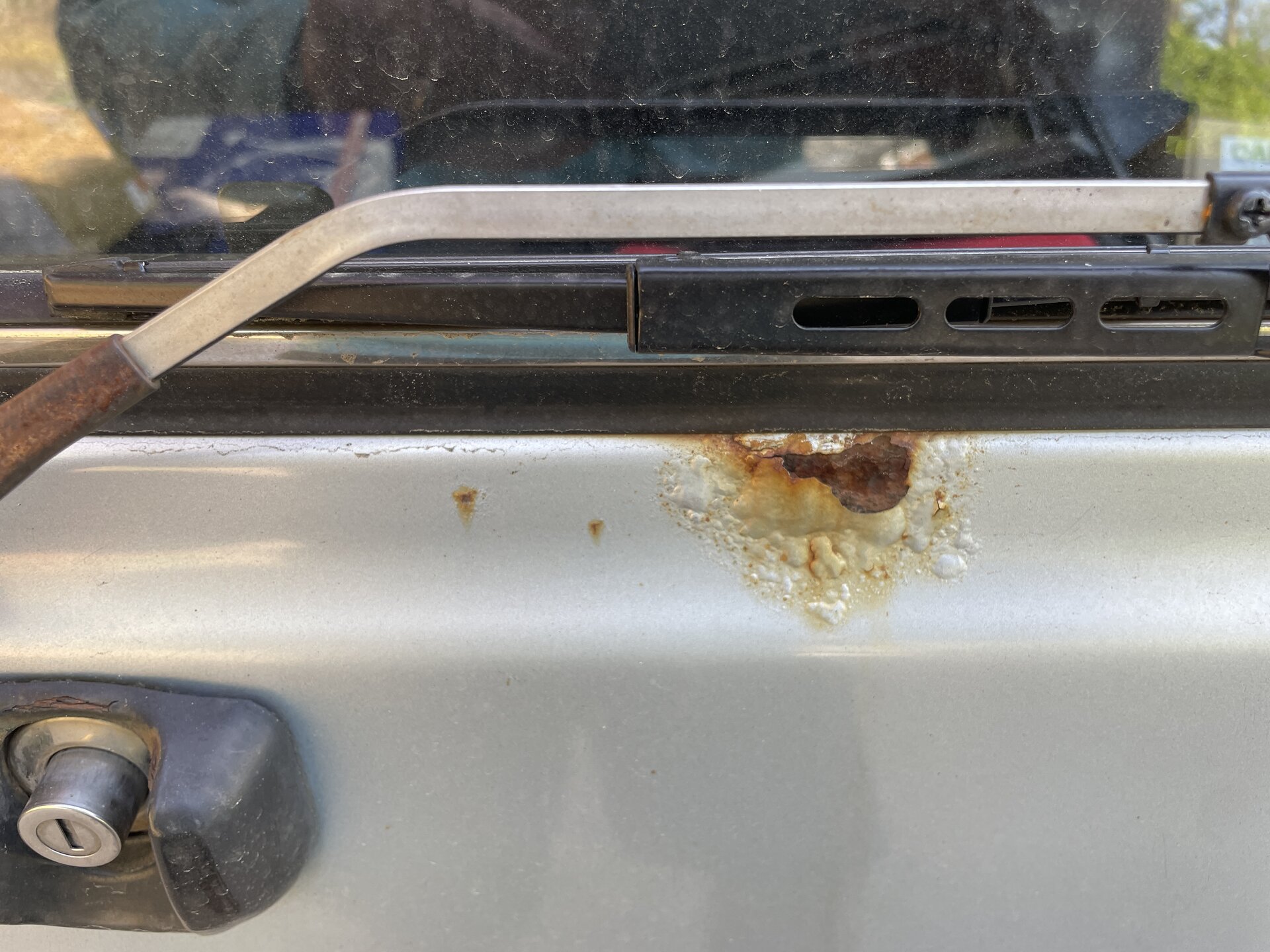

Background, I have a ‘88 FJ 62. Pretty good condition in terms of body, but there are a few areas mostly around the back window and few small areas around back window/doors/ rocker panels that have rust. I want to address the obvious rust and repaint the whole thing, mostly just to help prevent future rust issues (my 11 year old child claimed this cruiser for the future, so I want to preserve it).
Reputable body shop recently got back to me said 10-15K ballpark and they could start next week.
I thought this was a little steep, but am tempted to accept as not everyone wants to do this work.
Anyone have a similar experience they would like to share or any insight on to whether or not this seems reasonable in my case? Are there any good questions I should ask this guy before I entrust this repair to him?
Thanks to all.

the 11yr old has claimed it? :hmm: :hmm: :hmm: :hmm: well damn, put him to work on it:grinpimp: @Jermusom , seriously, what i'm seeing in your pics, that rust repair is doable at home, with the 11 yr olds help:grinpimp: if you dig around in here you'll see guys have repaired much worse in their home shop.

Theres a lot more rust there that you cant see... always

To be fair, some of the rust is in ''Pandora box'' type places, ie the A pillar, the rear panel is easy enough. but for a shop quoting yeah its gonna be spendy.

If you can get the A pillar done by a pro to a good standard, from what I can see the rest can be done easy enough to a decent standard by a ''mate with a mig'' pick the low hanging fruit.

I've cut into a couple of 60 series Cruisers, and just by looking at the photos, I can tell you that there's more rust there than meets the eye. The a-pillar is a tricky spot, as you need to drill out the spot welds that hold on the drip rail. There's bound to be more rust behind that. If you took a screwdriver to the lower rear quarters, it would punch right through in several spots, and you're also looking at some inner quarter work by the looks of it. In my experience, though, the trickiest spot is where the rocker and door sill and wheel arch meet right in front of the rear wheel. There are several layers of steel that overlap in that area, which is part of what makes it so rust-prone. It's also what makes it so time-consuming to fix.
I don't say this to discourage you - it can all be repaired. Aftermarket panels are available that can speed the process. But there may well be more to the repairs than just cutting out the visible rust and welding in new. Sometimes you have to go pretty deep to find solid metal to weld to, and that's where the high dollar price tags come in, sadly.
As diesellibrarian says, the A post is where the fun will really be, to repair it has to be done to a very good standard from a safety point of view, and visually, its in the line of sight.
The sills and the rear quarter, you want the best you can afford, but on a budget, I'd throw the money at the A post, and do a ''good enuff'' repair on sills/quarter, they are low down and not AS structurally important provided the B post is tied in at the bottom.

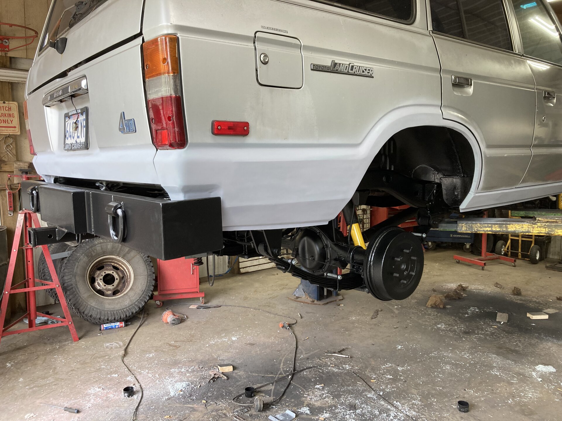

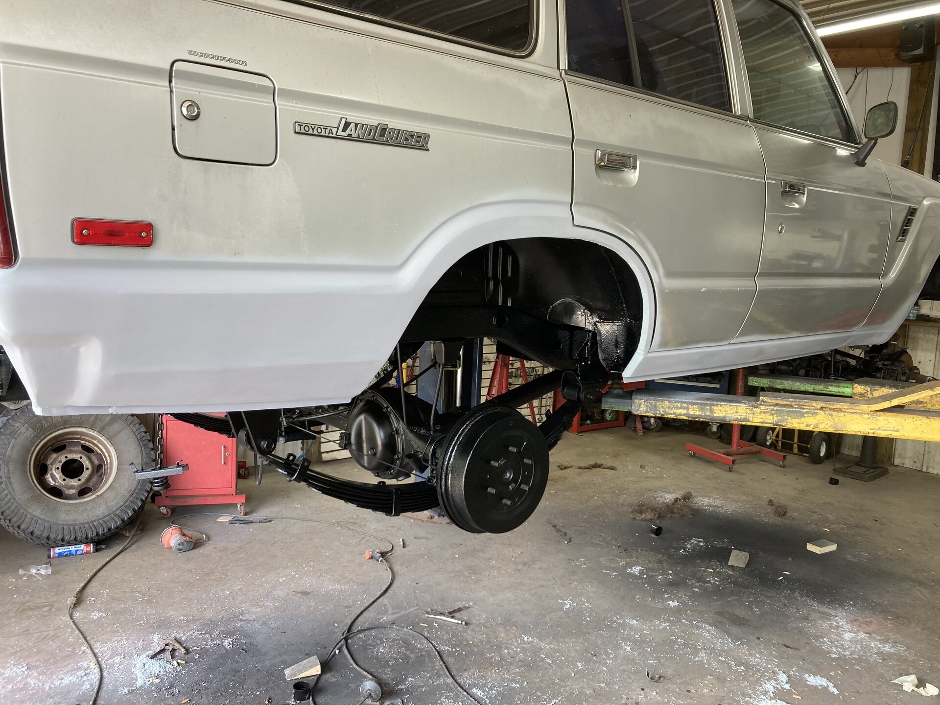

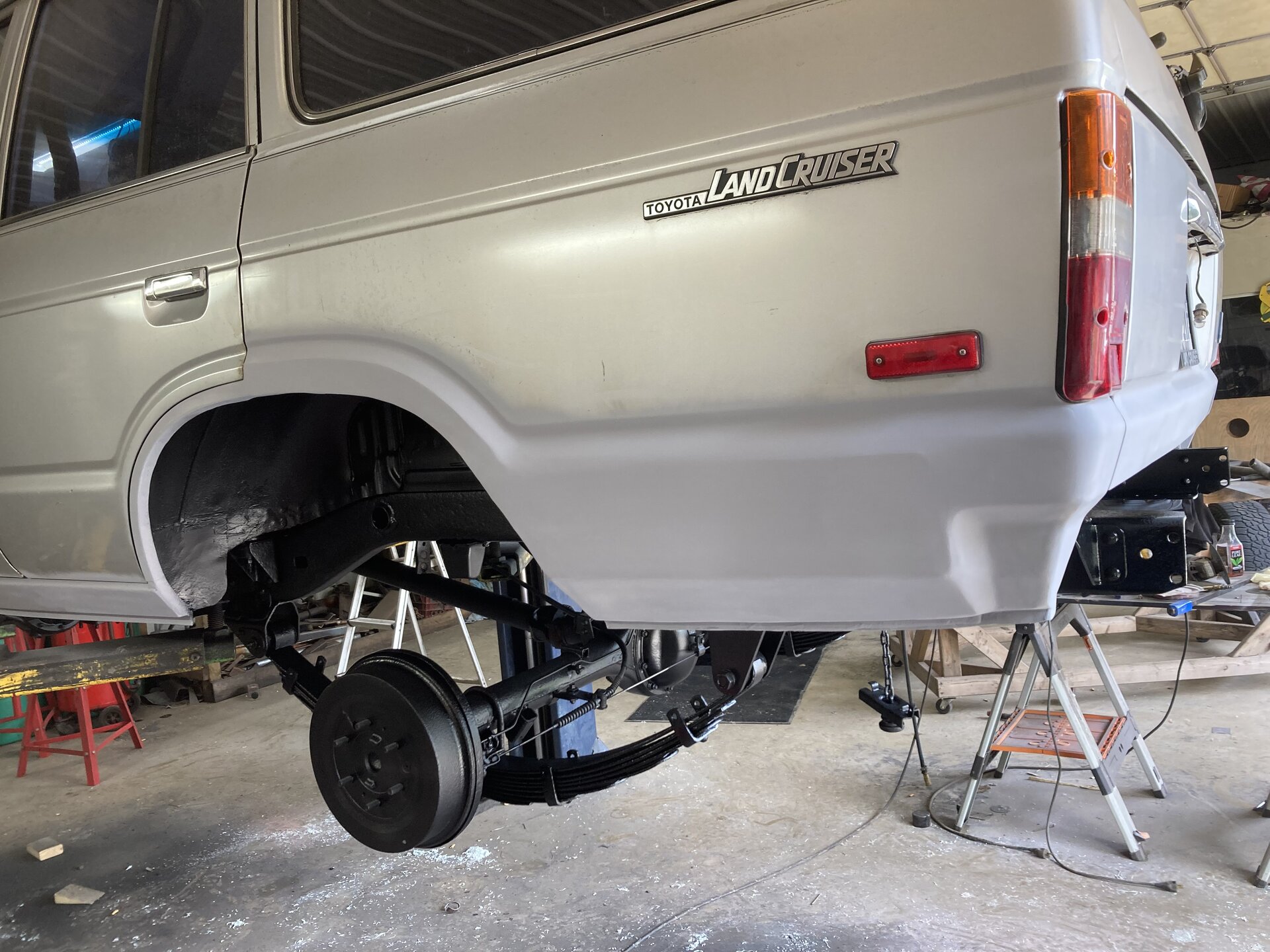

HI guys,
I am in Morgantown and just got the rust off my old 86 fj60. Still need to get her painted.
Dave Henry fabricated everything. He does great work and I am thankful for him. Please let me know if you have any questions
Here are the after pics
