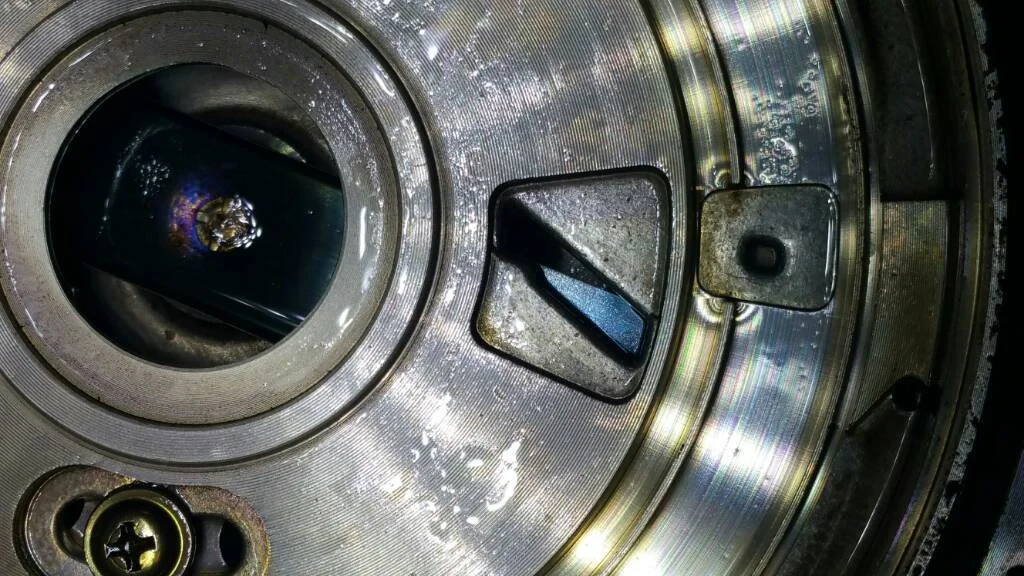

If you got it from Landtank it is probably already "adjusted".
thanks, that is what I thought, I thought maybe there was an external adjustment on it or something......
can anyone tell me what temp an adjusted landtank clutch "should" kick in at? that would be beneficial info to have in future dealings....
No, when you split it open there are two Philips screws. Adjusting those screws and plate adjusts the temp at which the plate opens.
It isn't that simple.
If your radiator water temp is 200 and barely any air is moving through it, that air might be close to 200. At the same rad water temp driving down the freeway with 80mph blasting through it, the air may only be 3*F (arbitrary number) over ambient.
This tendency is why we have a thermostatic fan clutch in the first place. The assumption is that independent of the water temp, if the radiator is working and if the air flowing through the radiator is cool enough, disengage the fan to save fuel and wear&tear. If for any reason the air flowing through the radiator is hot enough, engage the fan.
Not sure. The threads I've seen show them opening at all sorts of temps. I'm doing this mod as we speak and the first hole didn't reach half open till 130f. The slot started opening at 151 and it opened to the notch at 175.
