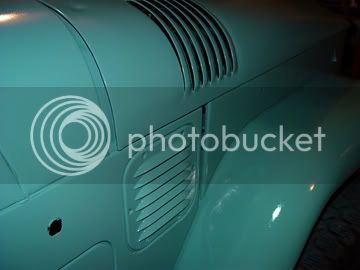

I went with Horizon Blue, this was the color my 40 was originally painted. Unfortunately my digital camera is making the color look turqouise (I swear its Horizon Blue/Horizontal Blue/Valencia Sky Blue). Seemed like they called this color a few different names, the original paint code was like 1208 or something, but I went with the later 808, they all looked pretty similar to me.
Anyhow, all I have left is some airbrush touchup in the small crevises of the window frame, the rear swinging doors and a couple run fixes. Then come the fun job of buffing the hell out of it. All in all I think it came out pretty good, not for someone who never painted a car before. Its funny how the final coat will show every little detail you missed, it really shows all the little rock chips that I didn't see with the primer. Right now its a little too shiny for me, I'm hoping when I use the rubbing compound, it will dull down a little. We'll see.

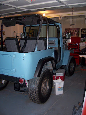

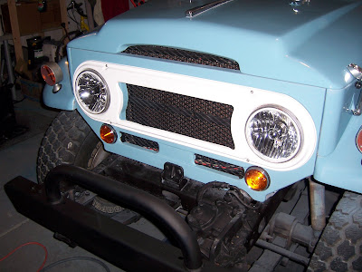

Well, I finally finished all the body painting and polishing. I think I have had all the saning I can take for a while. I installed a bunch of new hardware, new turn signals, new bib lights and a set of roundeyes headlights. The pictures aren't the greatest since my garage is a little *tight*. I'll post some better ones when I roll it out of the garage and take it for its new maiden voyage to the 4x4 swap meet in Puyallup this weekend.
