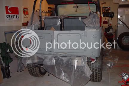

I tried the roll on paint method a few months ago, found out it was extremely difficult with the FJ40 body design, either that or I was just too lazy. So I was just going to rattle can it since I eventually want to take this thing on the trail. Well I went down to NAPA and talked to the paint guy (thye have an auto body and paint section at the NAPA down the street from where I work). He convinced me to buy a HVLP spray gun and to borrow a compressor from work. Anyhow, I'm glad I listened to him because I just spayed a couple coats of 2K primer this weekend at it looks incredible. I fixed some rust pitting I found behind the "Toyota" badge on the rear drivers side too.
A few months ago I had my "then" neighbor do some body work and a coat of primer, well he shot this ugly ass rosy red primer, nothing like have a pink cruiser........ I'm in the process of getting a ready to paint the truck sky blue (original color). I think it will look pretty sharp, plus I can say I did it myself. Hopefully the enamel blue coats goes on as nice as this primer did. All the red marks are glazing puddy, there small chips and stuff from left over paints from the last 40 years. I didn't really want to take it down to metal, just sanding as much as I can and then filling in the other areas.

its hard to say, back in July I had my neighbor strip the black rattle can paint job off, as well as fix some rust and a crunched fender. Then he shot a couple layers of pink primer on it. Although, there were still a lot of chips and dings here and there and he did this all without removing the top and front bib. I also got lazy and tried a roll on paint job, then went to wagner power sprayer with orange paint.....big mistake! Some people experiment with color on their kitchen wall, I chose my FJ40.
So to sand the original enamel off, fill small nicks, sand....sand....and more sanding.....then priming......then sanding runs and more priming probably around 15-20 hours over the last month. BUT.....if I had been using the HVLP spray gun I bought more for the priming (I had bought it originally to just spray the blue finsih and was using Dublicolor Sandable Primer for priming) I would have much much more time. I didn't get a compressor until Thanksgiving (Harbor Freight special). I bought the gun a while before, I was just going to borrow a compressor from work when I needed to do the final paint. I figure I'll do two-three more coats of primer then I'll do the final 3 coats of Sky Blue.
Your project is looking great. Just remember that you must be WAY more careful regarding dust and cleanliness when you paint. Also, I see you are in seattle. If you are planning on spraying in this weather, be sure to have a good heater in your garage. I painted mine in march, with a propane heater, but I didn't give enough time for the truck to heat up so the paint was more prone to runs. Runs are no fun, and wet sanding sucks. That is why I just reminded myself that it is a 4X4 and I don't care if there are flaws I can see from 10 feet.

No kidding, so far I've just done primer, but it went on really easy and it was pretty chilly out. When I did my second coat, I screwed up my rear passenger fender and got some bad runs, I figured it was some laquer thinner left in the gun from when I cleaned it the night before. Who knows, but I sprayed it out for a few seconds, went back to the body and everything was fine.

I bought a gallon of laquer thinner and once I'm done painting, I fill the hopper with it (about 1/3 or so full), put the top back on, swoosh (technical term) it around in there and then spray it out. This does a pretty good job of cleaning it out. This is what the guy at the paint shop told me to do. I don't really clean the nozzle, I probably should though. I figure I shoot enough thinner through that it should be okay.
Thanks Chip! I did a lot of research on all the differnet painting methods. I never used a HVLP gun before, just rattle cans and airbrush (to paint my models with when i was a kid). The HVLP is amazing! The amount of air and paint this thing pushes is awsome! I was really worried about runs too, but so far I haven't had any serious problems. When I shoot the final coat, that could change though. We'll see.
