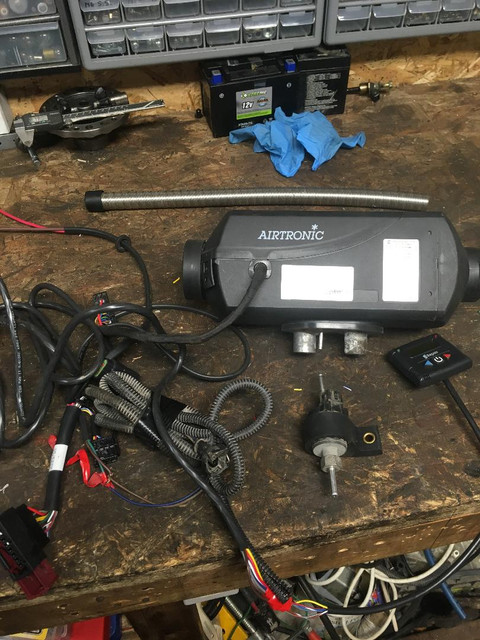

this heater is not made by webasto it is made by ESPAR and preferable angle off the pump installation is angle 15-35 degree
That’s funny, looks identical. Probably is the same part, just different policy depending on company.
I’m way too OCD most of the time.
i also have webasto heater and it is bit different on outside but internal parts and fuel pump r totally different
i like espar better easy and more parts to find and it is really simple made vs webasto some webasto parts you cant even find in usa i must order parts from russia most of time
