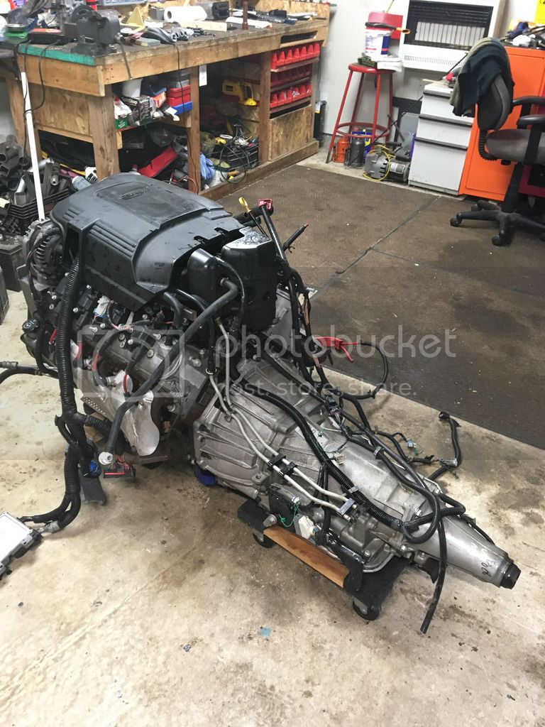

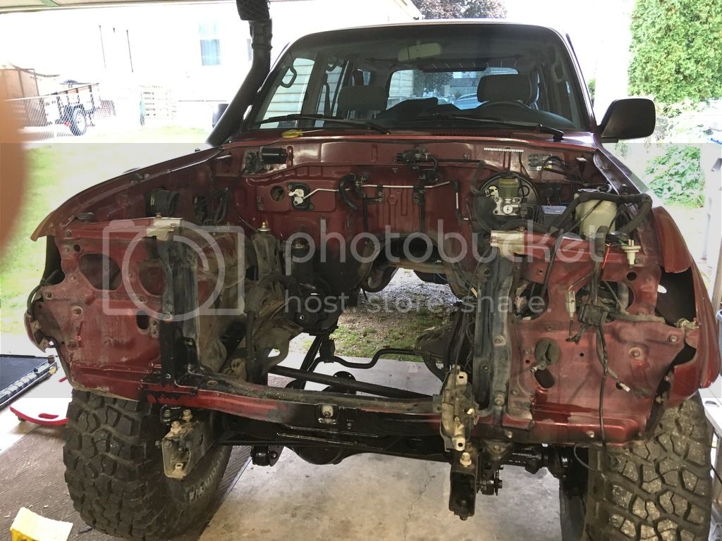

just starting my ls engine swap engine is from 2007 silverado and matching transmission
just finished my standalone wiring harness ,just need to send ECU for programing and that part is done
Nice!
Now the fun part
I seen this truck in person a few months ago. Great guy and cool truck. Good luck with the rest of the project!

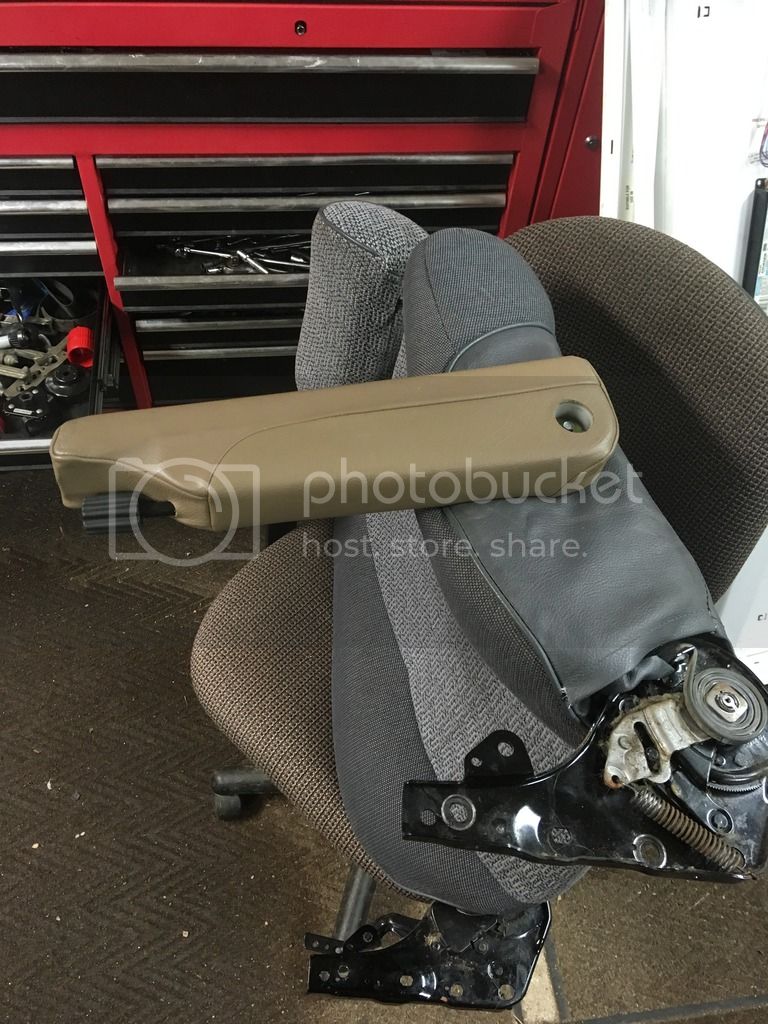

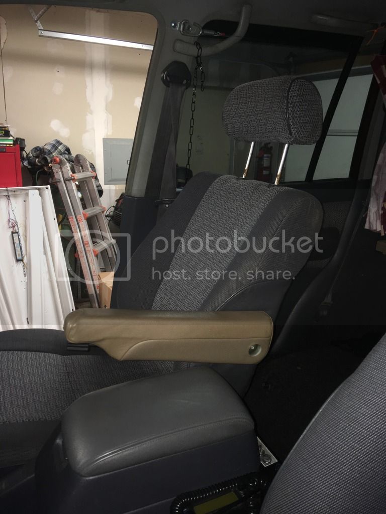

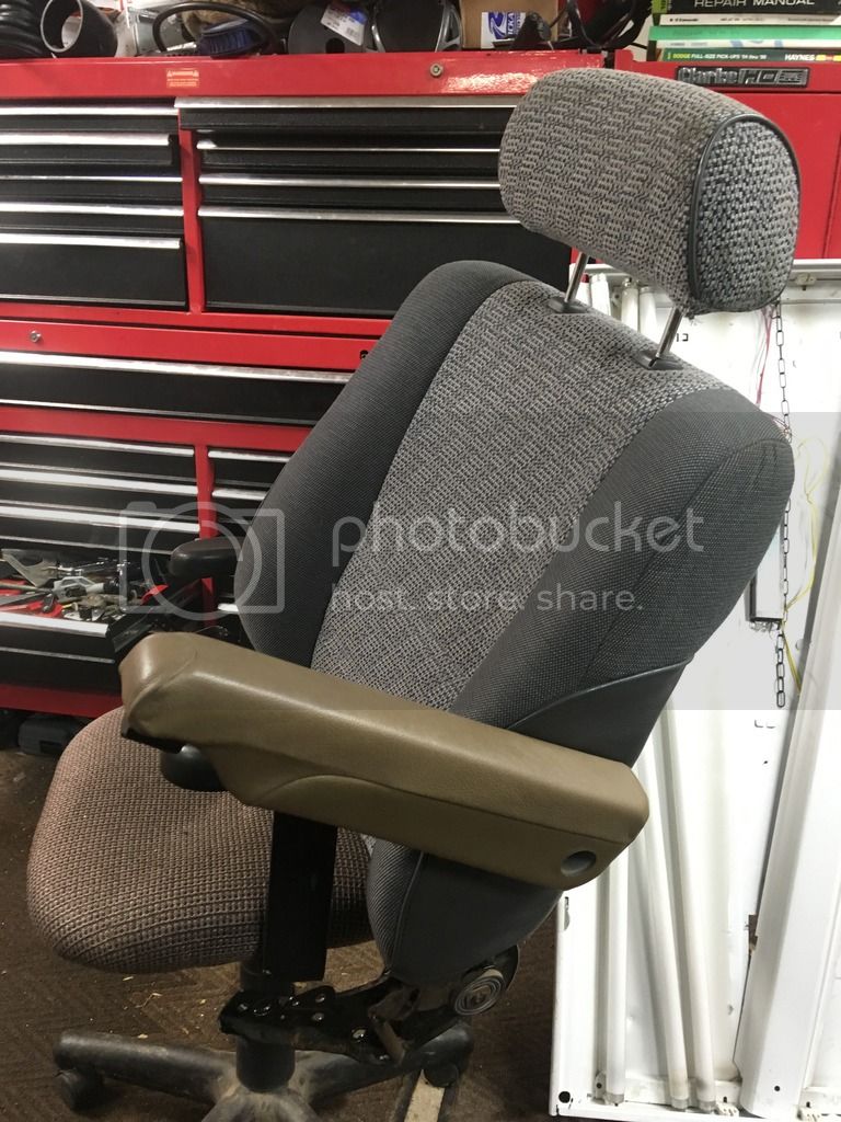

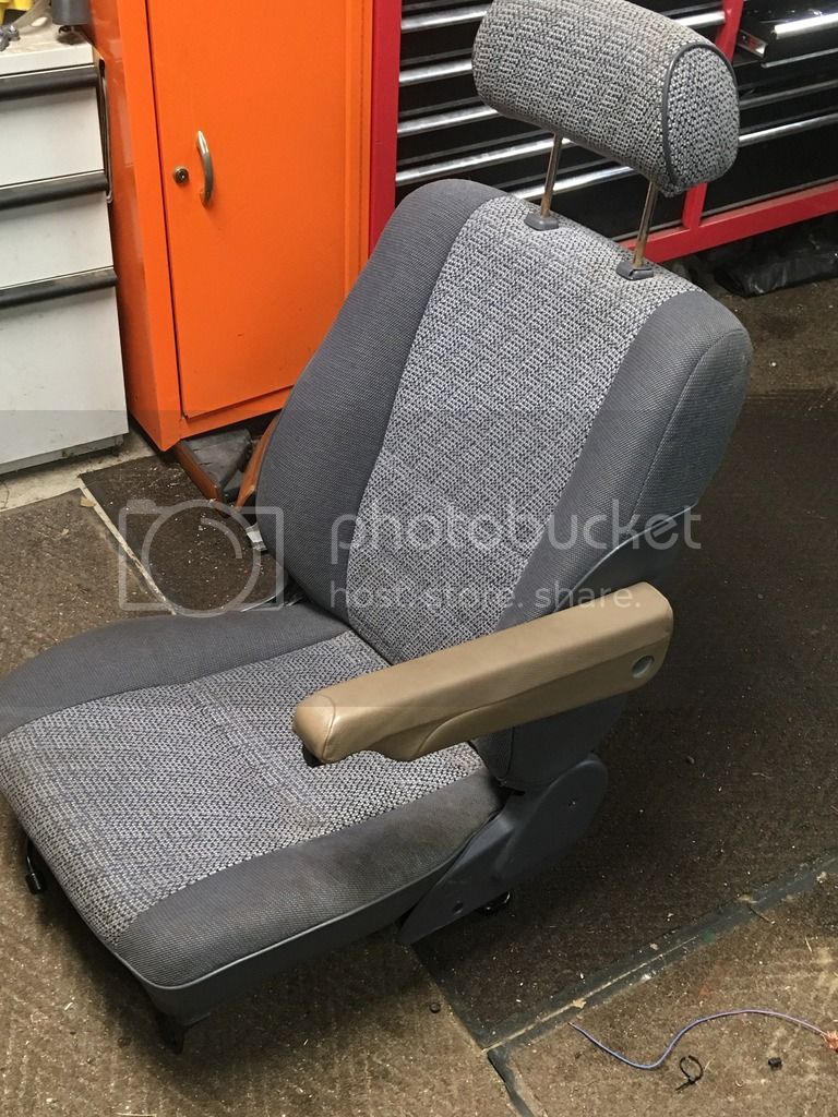

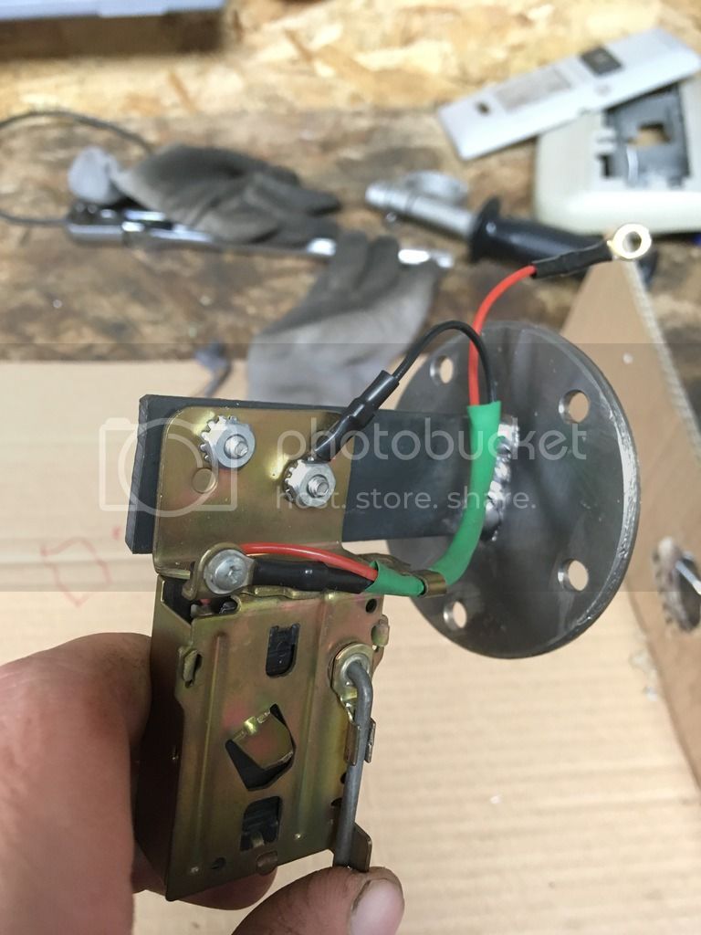

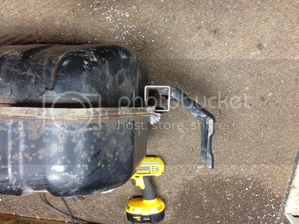

So what was that arm rest out of? A landrover? What year?
It's a good idea.
yes it is off land rover i don't know what year but i believe any year will work all i did , removed armrest bracket off land rover seat picked height and welded it in
i don't like the color but when i find different one all i need to change is the armrest

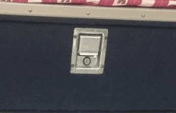

Where did you get this handle?
Can you give link on online shop?
it was already on the box but it is just standard Paddle Handle Locking Latch
just type in google (Paddle Handle Locking Latch) and you will find a lot of options

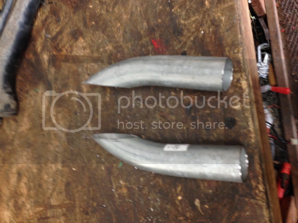

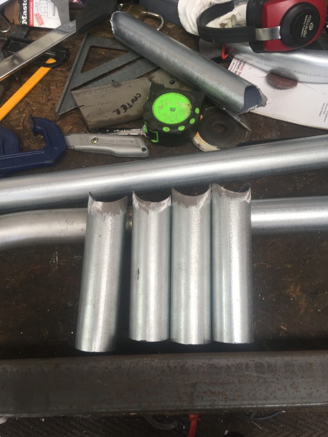

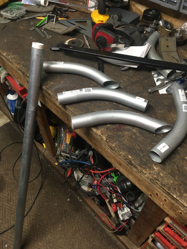

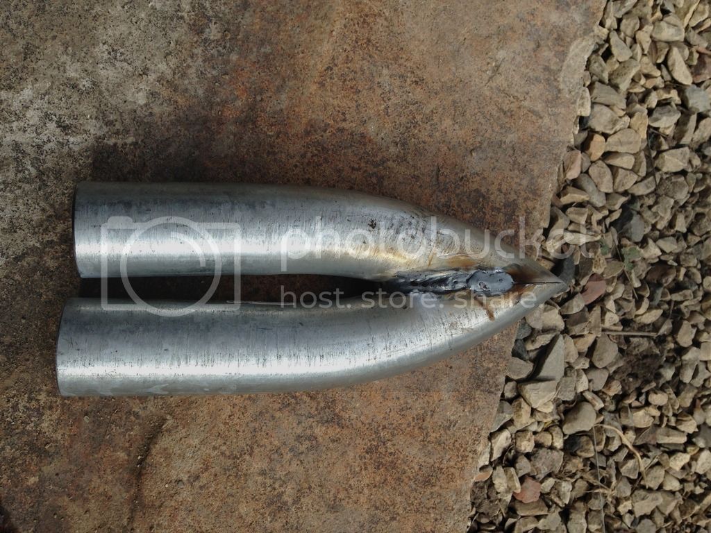

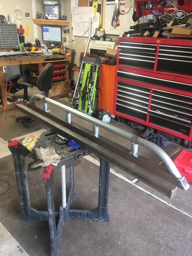

my new edition , homemade steps
[url=https://ibb.co/94s7Xwr][/URL]
[url=https://ibb.co/gV39sDL][/URL]

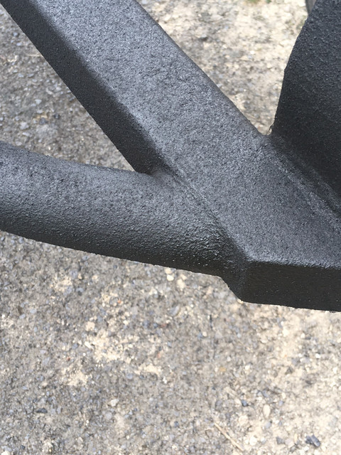

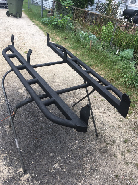

my step is all done , painted with POR 15 and finished with 3M 08864 rubberized coating
My sliders are looking pretty poorly these days. I have had them about 10 years and rocks will do a number on them. How much did you use and how did you apply it?
