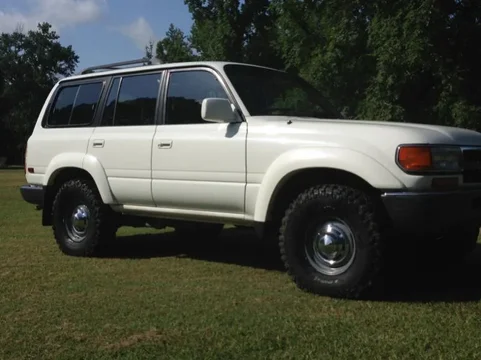

40 series steelies will fit on a 91-92 80 series.
Sent from my iPhone using IH8MUD
Grind the hole?
I think he is talking about grinding the calipers on later (93-97) 80 series as he mentioned earlier in this thread. No grinding needed on the pic I posted.
