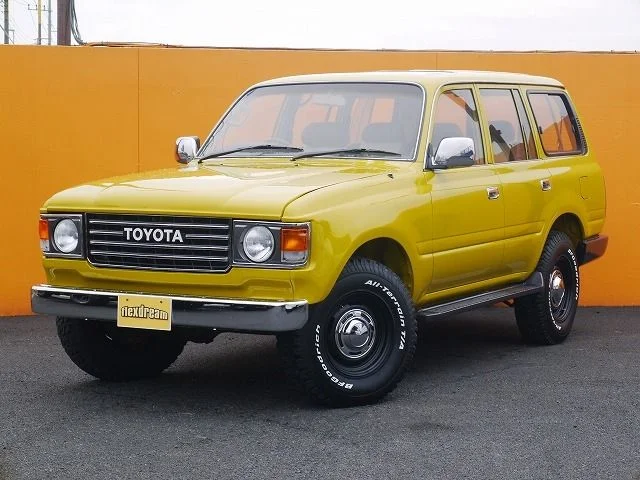

I am thinking that is a 60 fender grafted to an 80 fender. Notice the upper fender body line how it gently slopes down to the lip on the hood and around the top of the corner marker/turn signal
std_ab_ct0087_4-jpg.1000472
See how the 80 fender slopes down much sharper at the top
See how the upper body line is more HOZ ahead of the center of the wheel well
I think this looks much cleaner than the yellow model above

Agreed the green colored one's lines look better. Will you continue on this thread or start a new one?

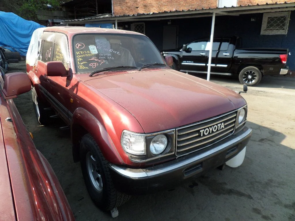

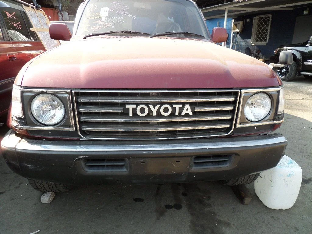

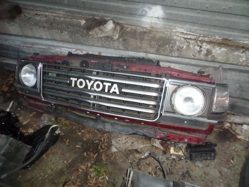

Japanese tuning. This grill and headlights i will install to my Сruiser
View attachment 1001033 View attachment 1001034 View attachment 1001032
So that is a JDM OEM Toyota part? I see the RHD in the pic!

This used car imported in Russia from Japan. Now all used parts of this TLC will be sold for russian cruiser's owners (sorry for my english).
I think, it is 60's grill and 60's the round headlights. And it was installed in 80's/ It's japanese handmade :)
Do you mean that the owner of the TLC will be selling it off for (as) parts? Have the fenders, lights and grill already sold?
Japanese owner sell it to russian used cars parts reseller, car shipped from Japan to Russian Far East, then all parts are distributed throughout the country. Russian business :hillbilly:
Fenders and claerance lamp are standard. But radiator support, grill, round lights and clearance lamp was detached from car and and I bought it.
