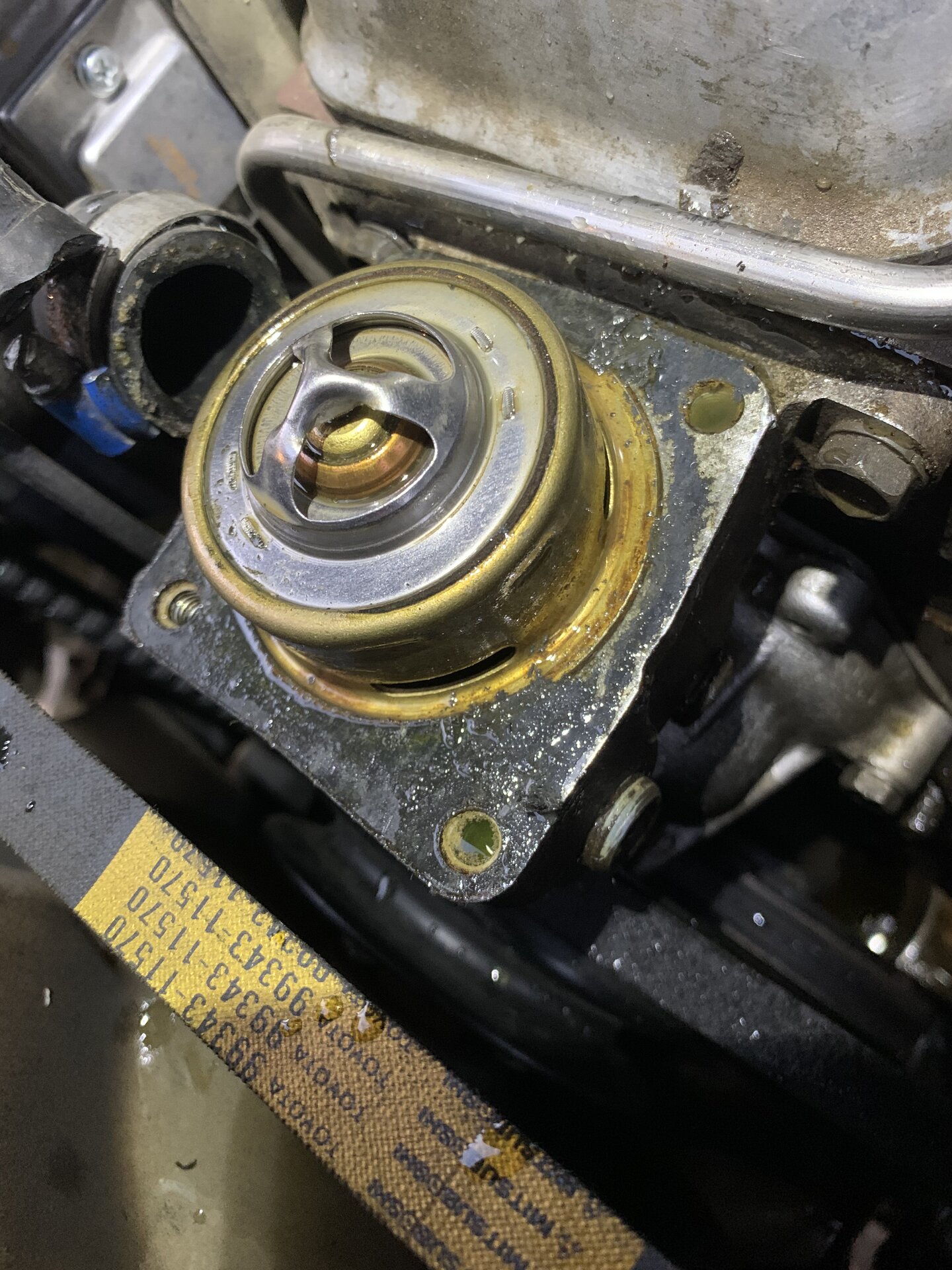

So I armed myself with some beers and got on the internet. What could go wrong? I decided to check the self installed thermostat figuring that I botched the install but it's one if the things on the old girl that doesn't leak so I'm real reluctant to open it up. Curiosity got the better of me so I obtained a lower and upper gasket today and opened it up expecting to find an upside down thermostat. As best that I can tell it's installed correctly. The gasket was on top of the thermostat, kind of holding it down. Is this correct? Does it matter if it's base housing-thermostat-gasket-top housing or base housing-gasket-thermostat-top housing?
The upper gasket was in place but a little out of round. Is this an issue?

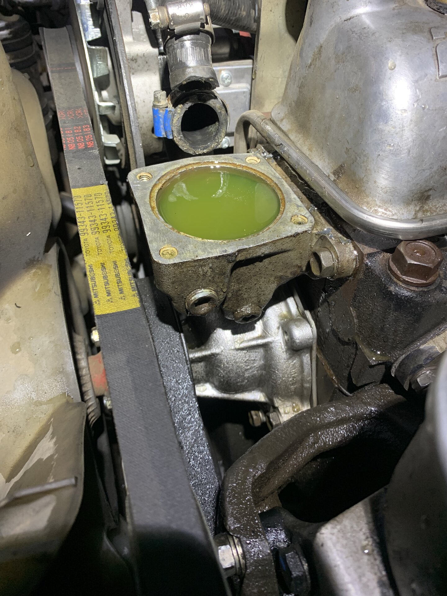

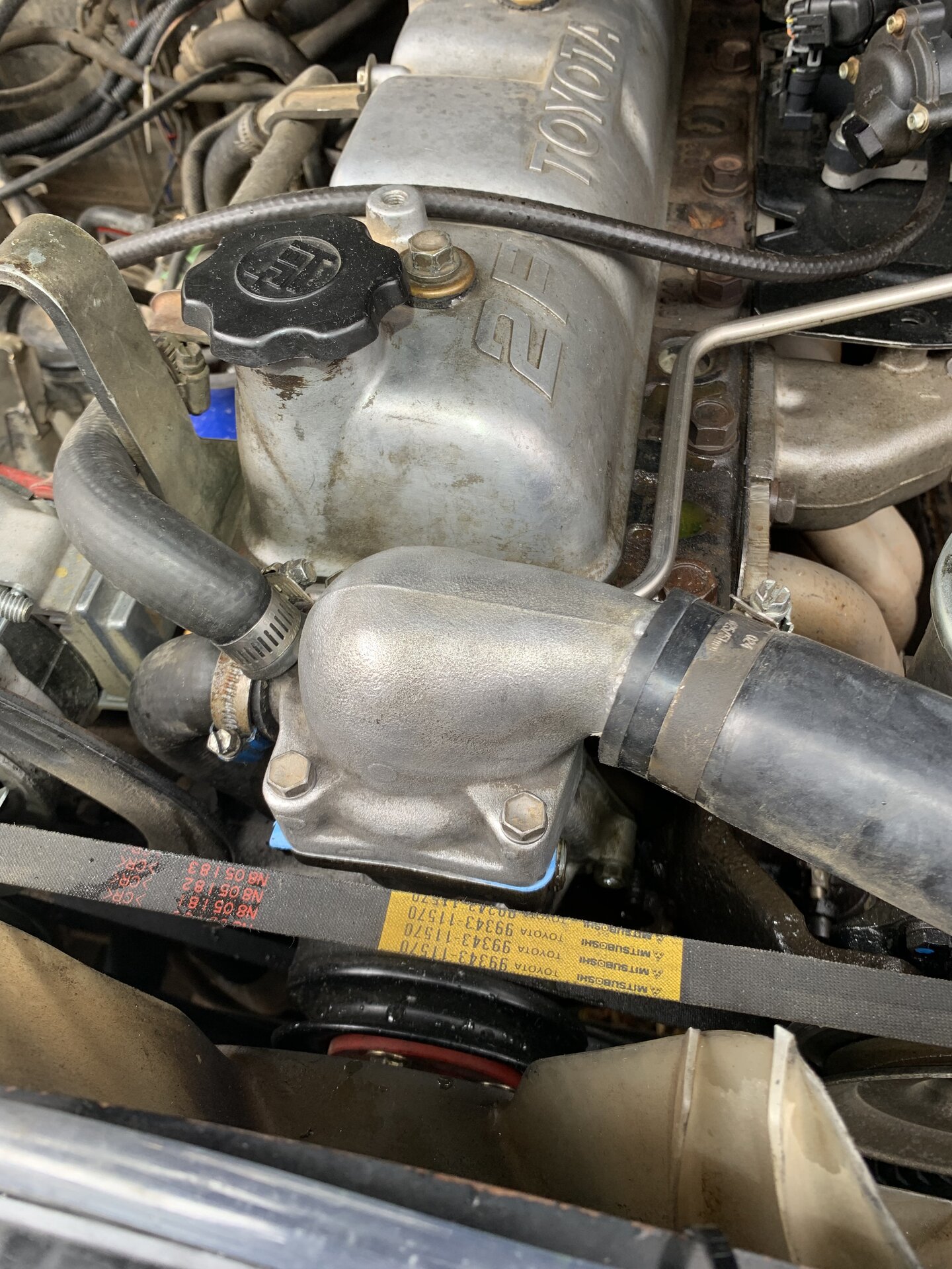

I noticed two plugs on the base housing that are... well pluged. Should the sender for the dash guage be here? As best that I can tell the sender is in the head, drivers side, slightly behind the carb (see pics) is this ok? Am I getting an accurate reading?

typically the thermostat is stamped with the temp when it opens. IE: it'll have a small stamp that says 190 on it or something. The plugs on your housing are caps from where previous vacuum ports were installed. Assuming your vehicle is desmogged. So no, there was no temp sensor installed there. The temp sensor is at the rear of the head on drivers side. It's a single spade type connector.
If the upper round rubber gasket was deformed and not sealing properly it would allow coolant to circumvent the thermostat and could possibly cause your low temp issue. The thermostat is installed correctly.

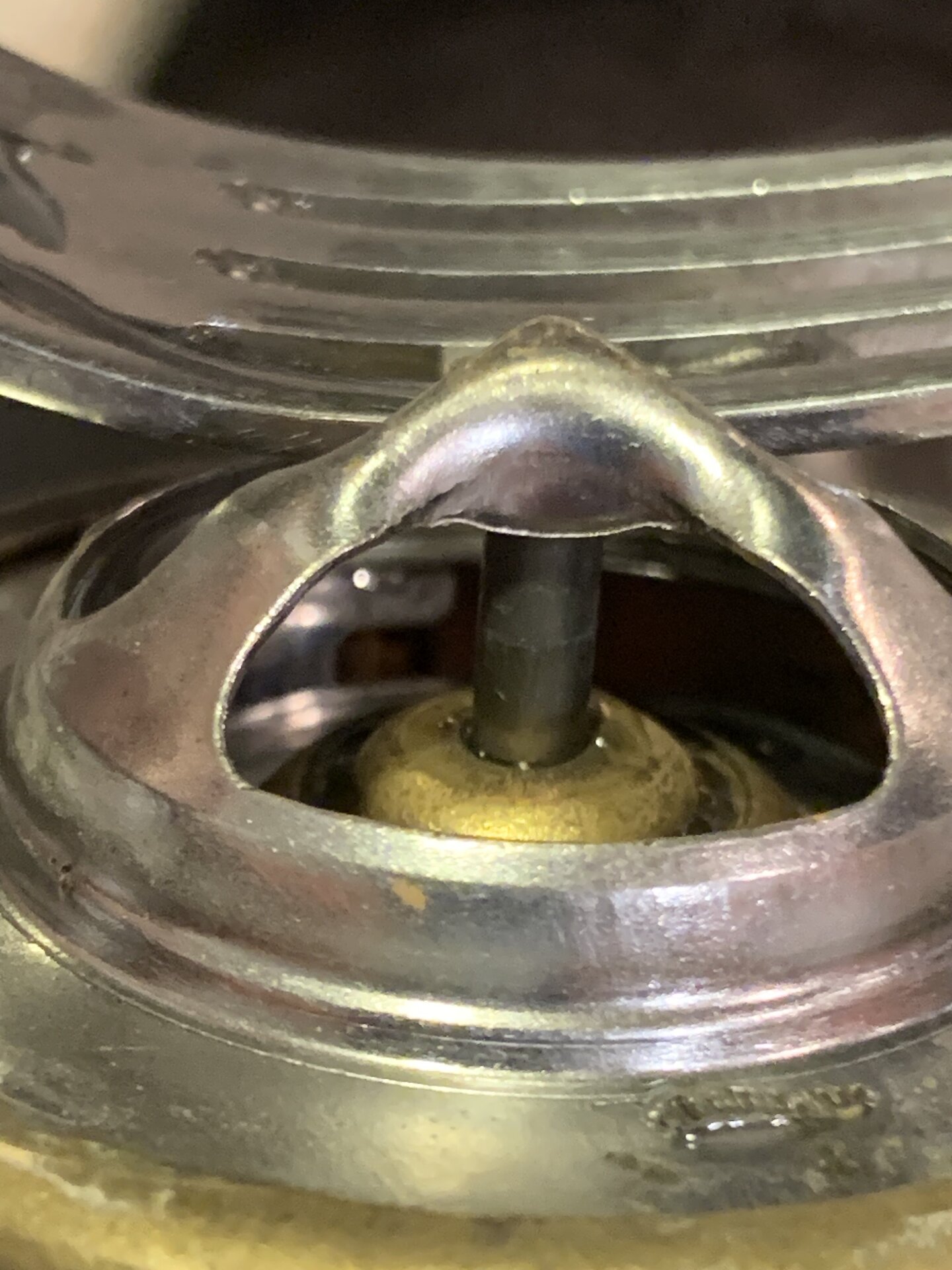

That doesn’t look like the Toyota thermostat. Maybe they’re different now but mine didn’t look like that.
If it’s not a genuine Toyota thermostat — replace it.

The top gasket should be a fiber composite, I have found bits of rubber in the coolant where the PO used a rubber o-ring and it had disintegrated.
That's not an OE or OEM thermostat; it's a Motorad. Motorad is a German OEM but not Toyota. Usually they're pretty good, but may be the wrong temp or possibly defective. One of the Motorad that looks exactly like that is a 160*
Buy the correct 190* OE (OEM is 'TAMA' brand, WST3-88A, but in the US same price as Toyota-boxed).
Thanks for all of the replies. I tested the thermostat on the stove. It's stamped for 180 degrees and opened right in that temp range, less than 10mm. So I cleaned everything up and put it back together. I haven't had much test time yet, my brother got an elk so I helped pack and process. I find it interesting that this is not the Toyota OEM thermostat or top gasket (the old and new are rubber, not fiber composite as @micruz60 stated). I thought I got these from the Toyota dealer the 1st time that I did this job, but my memory is sometimes faulty. This go round I got the gaskets from NAPA as they had them in stock. I'll get some seat time in this week and report back.

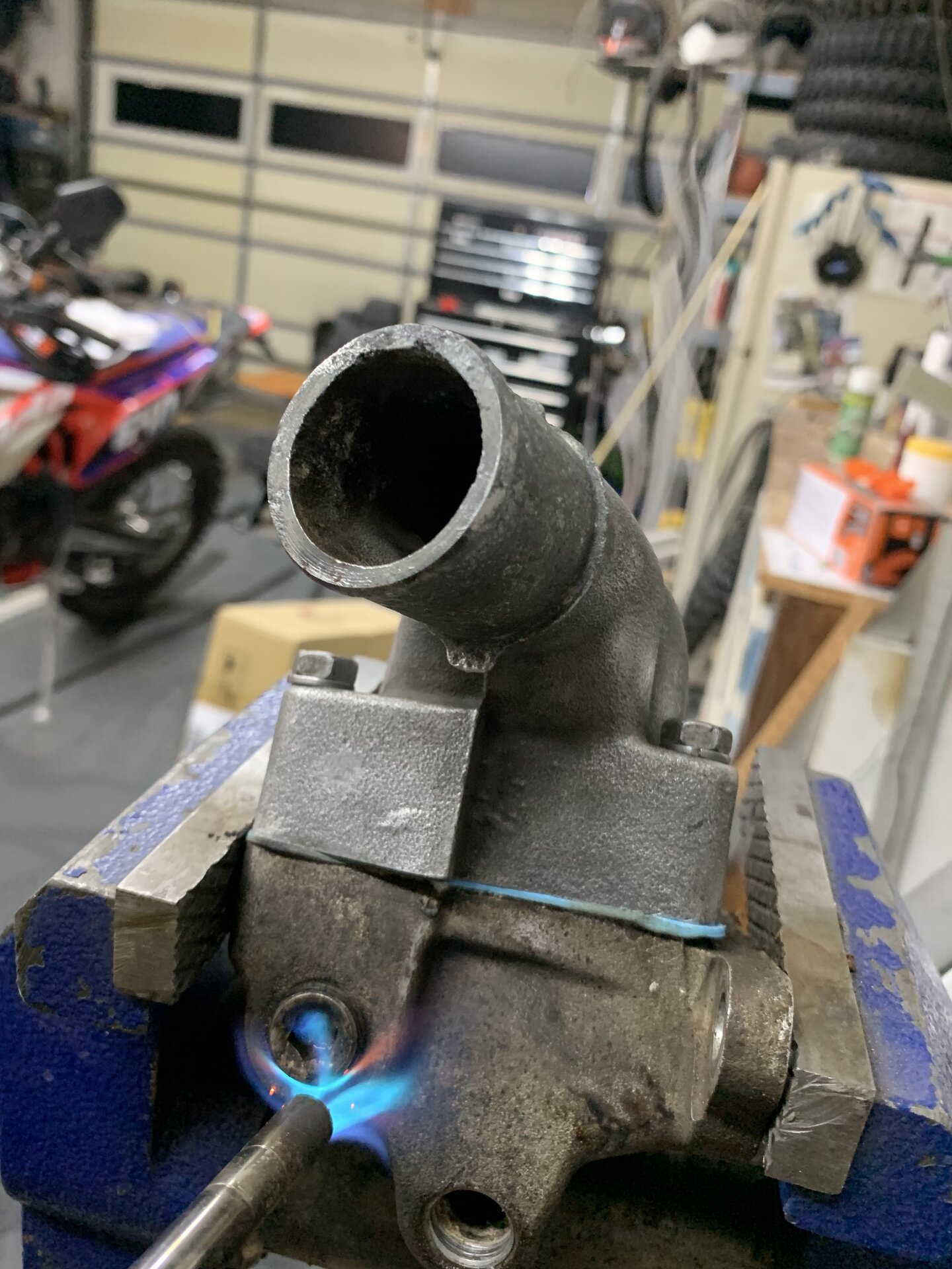

I was worried that I would destroy the lower housing trying to remove the plugs. It looks like it is no longer available from Toyota, I did find this as a last resort OEM Thermostat Housing Kit for '81 to '87 Land Cruiser FJ40 FJ60 with Oil Cooler - https://www.cityracerllc.com/products/oem-thermostat-housing-kit-for-land-cruiser-fj60-fj62
Look like I have something to be thankful for! (Plus the dealer was still open so new gaskets and a thermostat are on their way)
What would you recommend that I use to seal the plugs back up?
