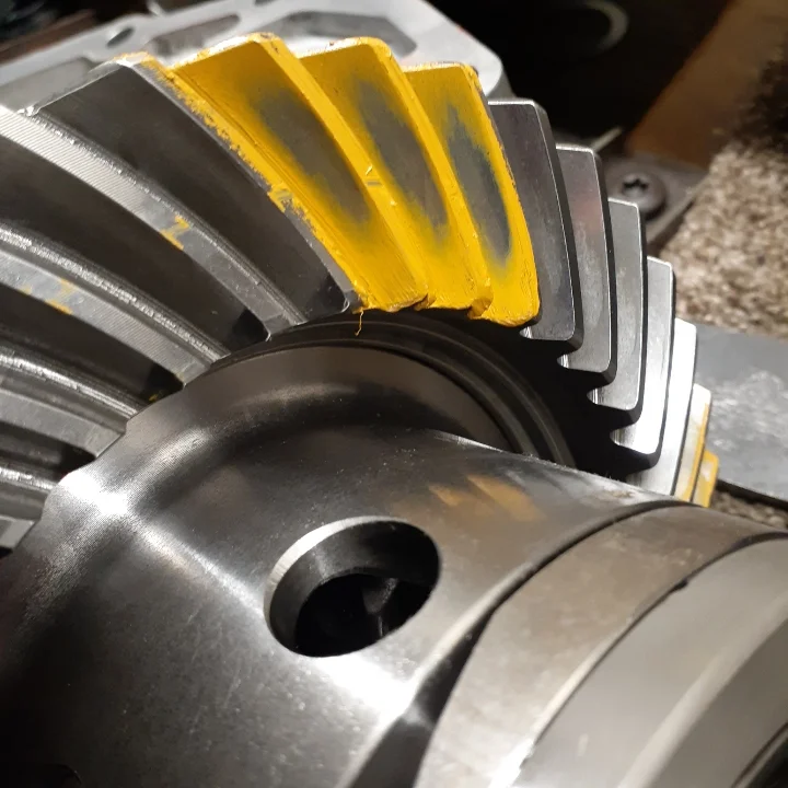

Front ring gear seemed to have picked up some debris in the bolt threads (possibly during REM processing) which required a tap to chase the threads. The threads are actually a 12mm x 1mm which apparently took some some work to find a tap for. Once it was found and the threads were cleared, everything was back on track.

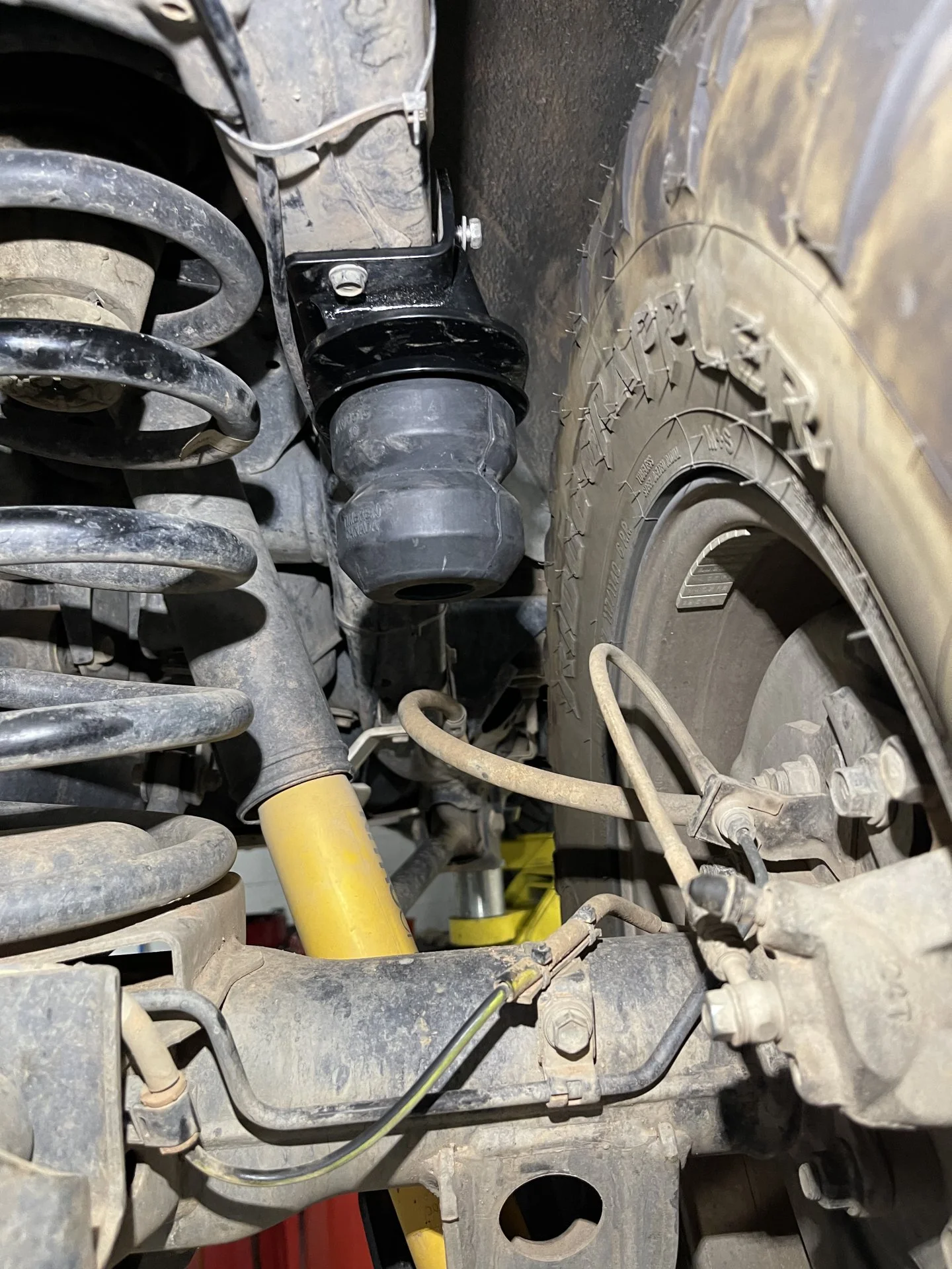

Also installed Timbren Active Offroad bump stops. Haven't really felt like I needed them, but they exist and I was bored/tired of working on my house.

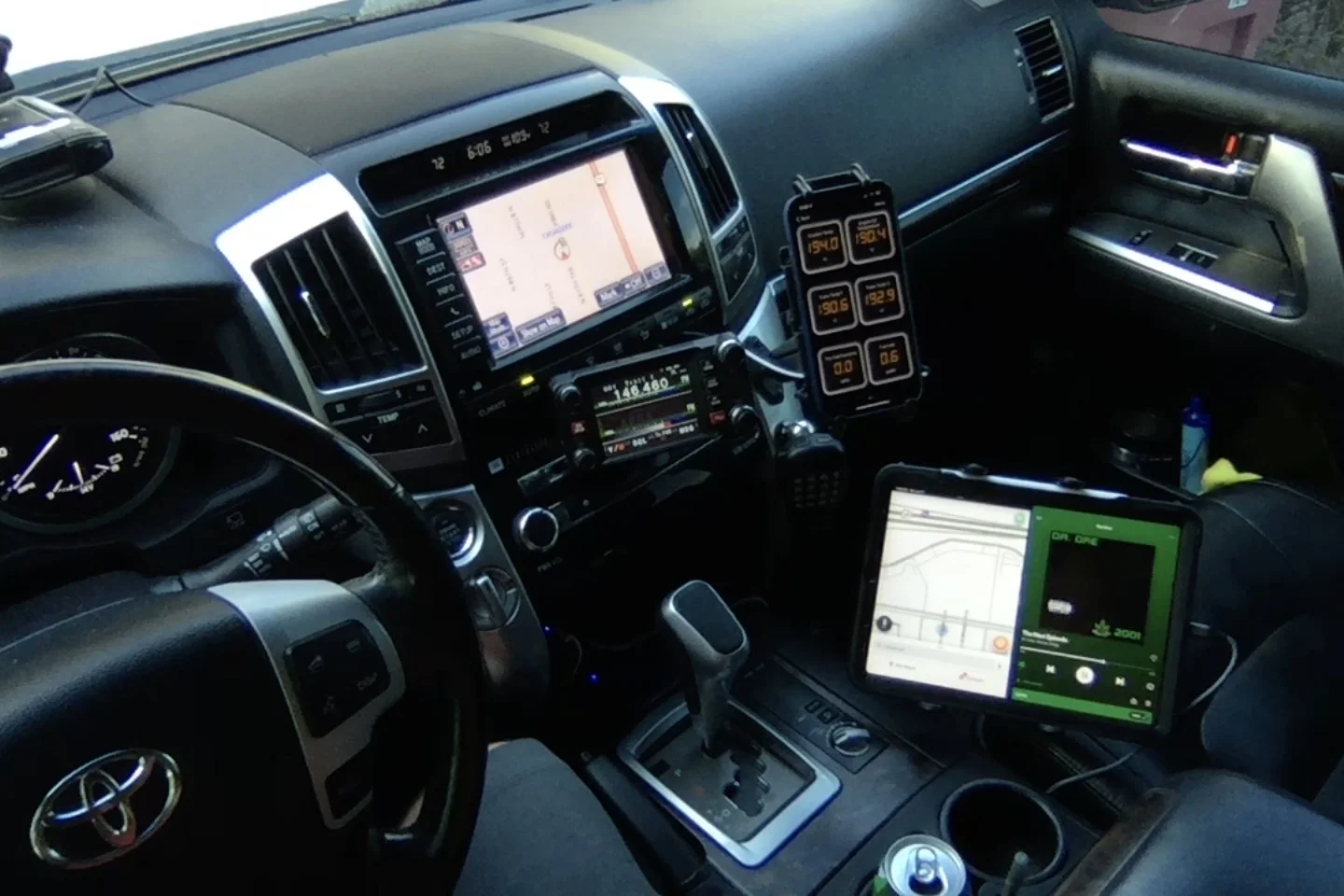

Mounted up the iPad Air (wifi only) and added 4G LTE Hotspot and Bluetooth GPS in support. Running navigation (Waze, Google Maps (with download maps for offline, OnX Offroad (with downloaded maps for trails), entertainment (Spotify mostly) and Garmin PowerSwitch (Lights and Lockers) on iPad. Streaming audio from iPad is delivered over vehicle bluetooth.
This frees up my phone for displaying additional gauges via OBD Fusion and generally making the phone more available for taking photos and other tasks without disrupting navigation, entertainment etc. This is particularly useful on the trail when exiting the vehicle and wanting to have phone handy without having to get everything set back up upon getting back in the vehicle.
Escort Max 360 is also connected via bluetooth to the iPad so alerts are audible over the vehicle audio system and not drowned out by music.
HAM radio is the same setup for the past year-ish having moved from the Icom 5100a to the Yaesu FTM-400XDR for better APRS functions.

Very cool. Any chance you could share another picture or two of how/where you have the Yaesu display mounted to the console? I have been struggling to decide where to mount mine. I have a small section of RAM track mounted above the main screen, but am wondering if there is a more discreet place to put it.
The Yaesu is on a CD slot mount. Works great. LM-200 CD Mount For Yaesu FTM-100 FTM-200 FTM-300 FTM-350 FTM-400 FT-891 - https://www.lidoradio.com/products/lm-200-cd-mount-for-yaesu-ftm-100-ftm-300-ftm-350-ftm-400-ft-891
