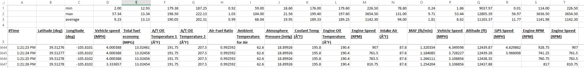

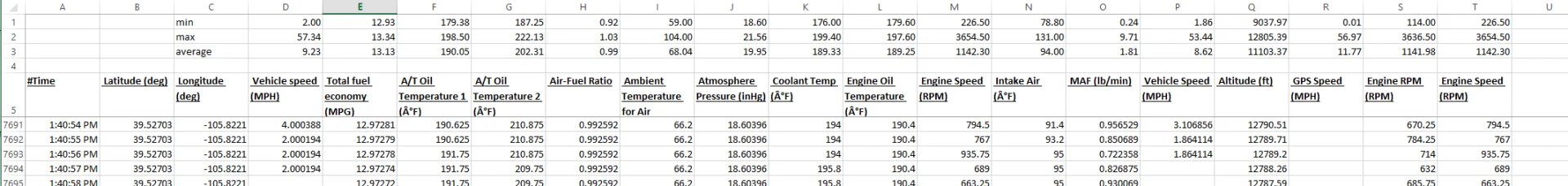

Post-LCDC OBD Fusion Log Upload: Red Cone
I haven't yet done any analysis as I didn't really have any issues, but if anyone wants to dig into the data and provide insights, have at it. I did have some gas boiling on Red Cone, but do not remember exactly where I smelled it or if it was always me I was smelling since I was tail gunning. The truck in front of me was a 62 Series and he was not having the gas boiling issue.

I don't think it's temps. You're just not running that hot, man!
I compiled all your CSV's into one file, removed any "0" values, and then calculated the min/max/average for everything. It's ~9900 lines of data. There's nothing in this data that would concern me. Seriously my A/T 1 temp routinely runs at 215-217 when towing, A/T 2 temp can hit 250F for sustained climbs. Engine oil will get up to 212F regularly when towing, and coolant temps at ~203F. Granted I'm moving so there's a lot of airflow in these cases. But even when you're at the top (I think) the numbers just aren't concerning - they're hardly above idle.
Now that said at rock crawling speeds there's limited airflow across the gas tank. There's also latent heat from the exhaust that we're not accounting for (though it would be cool if fuel temperature was somehow available...) And the pressure within the tank we're not tracking either, but regardless of heat I'm sure the *air* (and vapors) trapped inside the tank will expand a whole lot as you go up in elevation (even if the fuel itself doesn't expand much)
Nicely done collating the data.
I agree, and the data supports that it's not the cooling performance of the vehicle. At least for @TheGrrrrr 's truck.
What stands out to me is the max ambient (104*F) and max intake (131*F) temps. I'm not sure the conditions experienced out there. And while not direct measures, those would suggest the degree of underbody heat radiating sufficient to elevate temperatures all around. The underchassis areas would be that much higher and further heat soaked. Potentially more with under armor.
There was a great thread in the 100-series section where someone put a temp probe in the fuel system. Highest temps that would see ~130*F. Fuel would have deltas of 30-50F over ambient when stock. The intake temps recorded above would suggest fuel heat saturation to that level is possible in slow crawls or idle.
After his extensive heat treatment, including heat shields around the tank, re-routing fuel lines around motor, and others, improved fuel temps to 10-20*F above ambient.
I think the 200-series could benefit from much the same mods.
