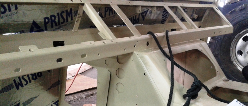

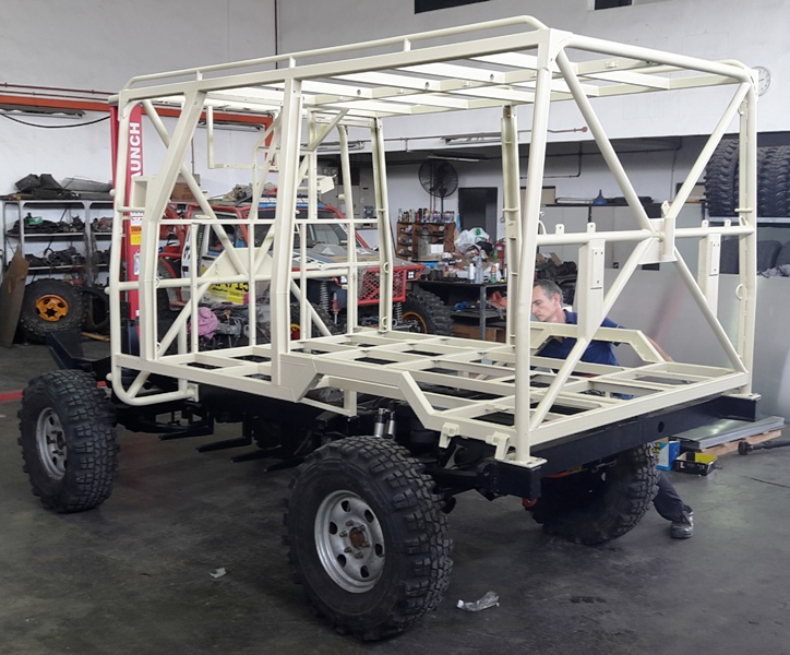

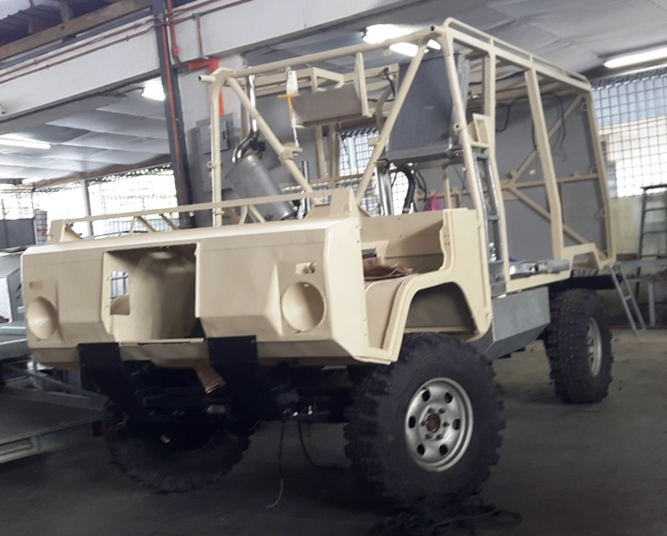

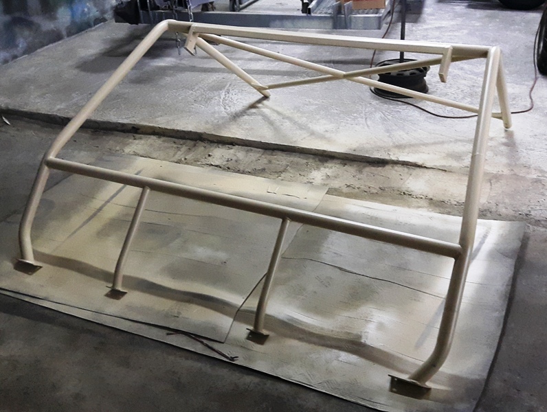

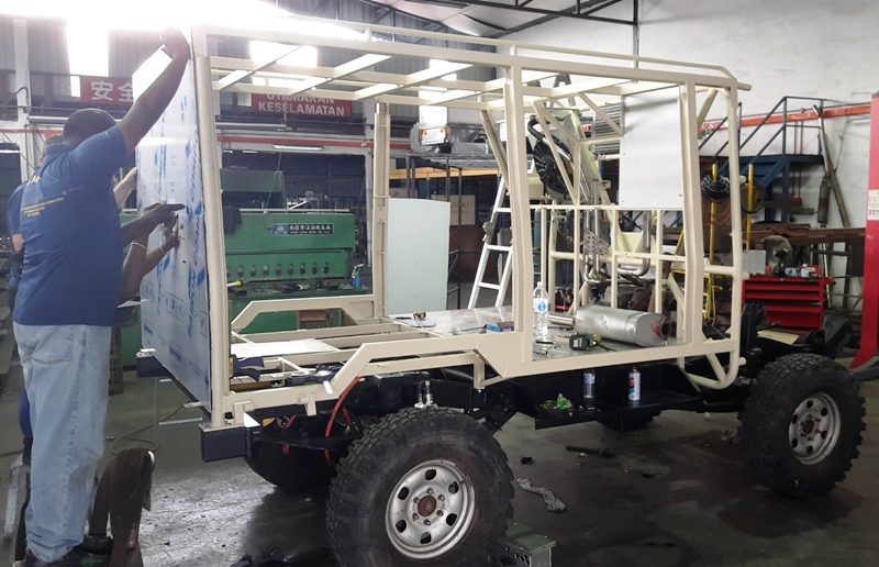

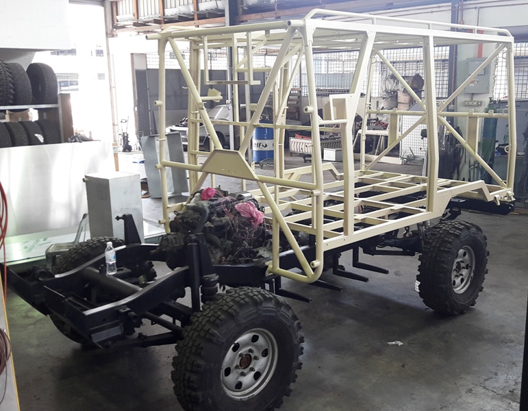

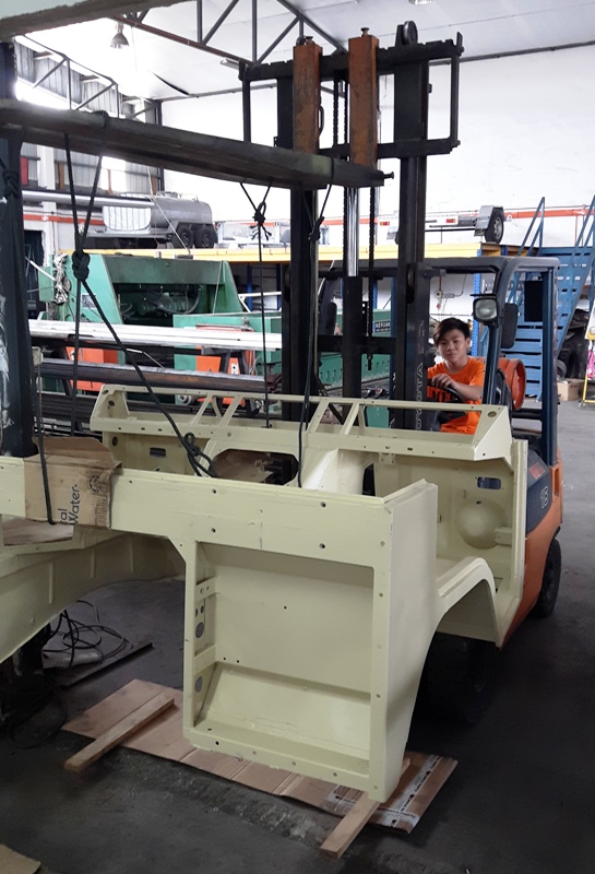

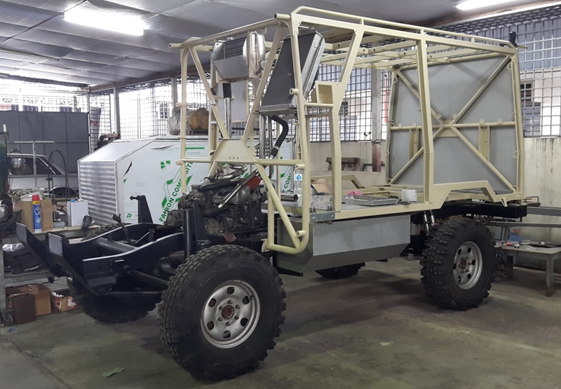

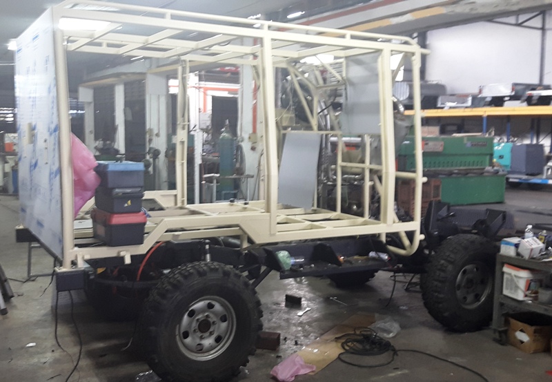

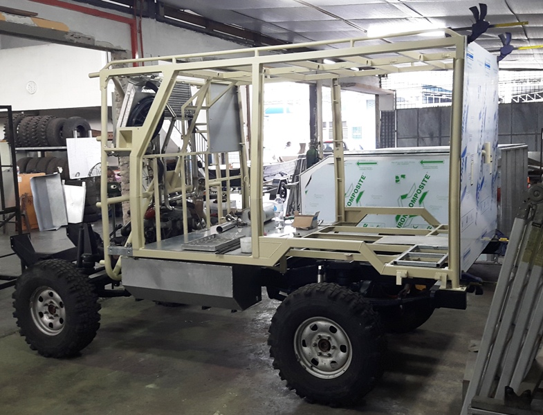

Arrived monday morning to the pleasant sight of the rear cage and all parts painted that I had left the week before.
Brett stuck the engine and gearbox on the forklift and then left for CNY lunch and said you can install and oh yeah learn to drive the forklift lol.
2 hours later I had it all installed but need new gearbox mount bushes.

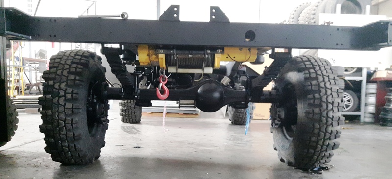

Then started on the 18,500lb winch install. Success again took me about 2 hours plus searching and cleaning up parts areas to get stuff out.

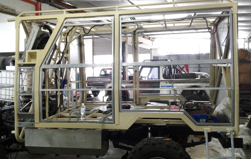

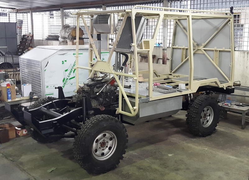

9 February

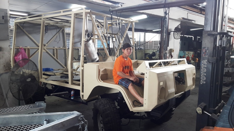

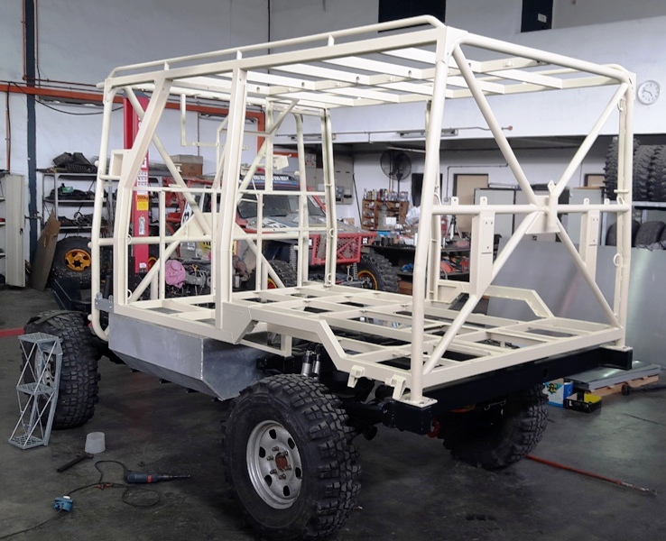

Had assistance from the builder all day and we managed to get the cage installed and bolted down after installing the WARN 12,000lb winch and tightening the 18,00 bolts down correctly.

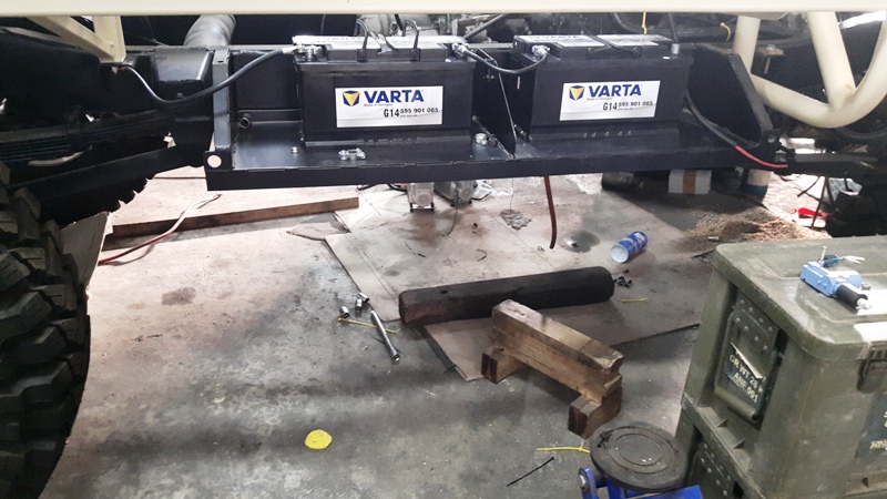

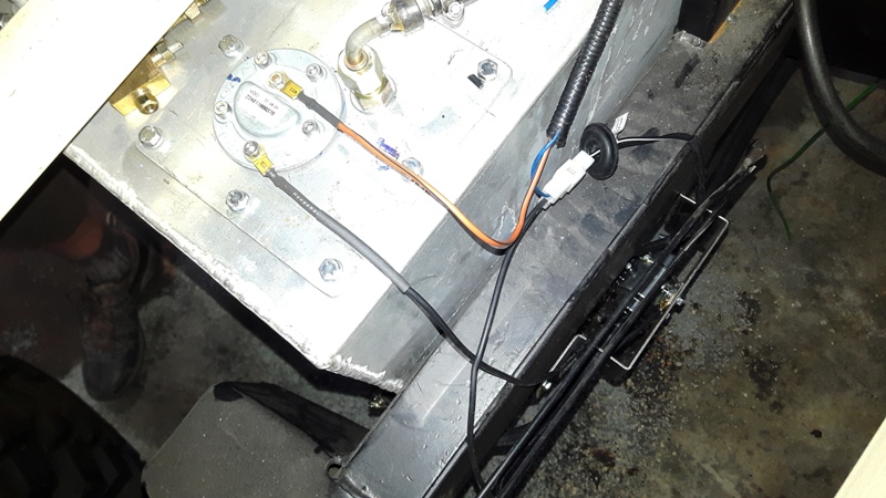

Then dinner time for both of us and we packed up at 5pm after getting the fuel tank reinstalled yet again and the gear change installed and bolted it. A whole pile of parts washed and a list of parts needed to buy.
10 February
Morning starts with washing the dusty parts and yeah playing with the puppy.
And the finl result is washed parts eventually and a half washed puppy

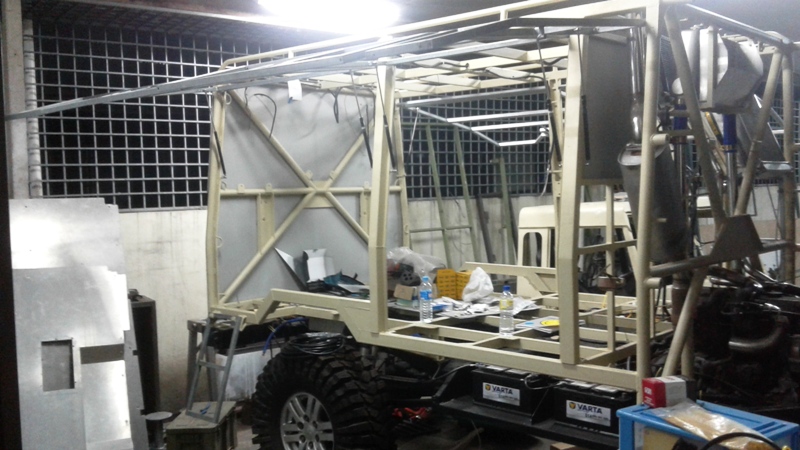

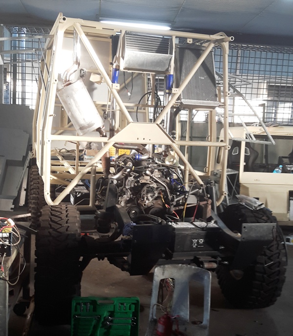

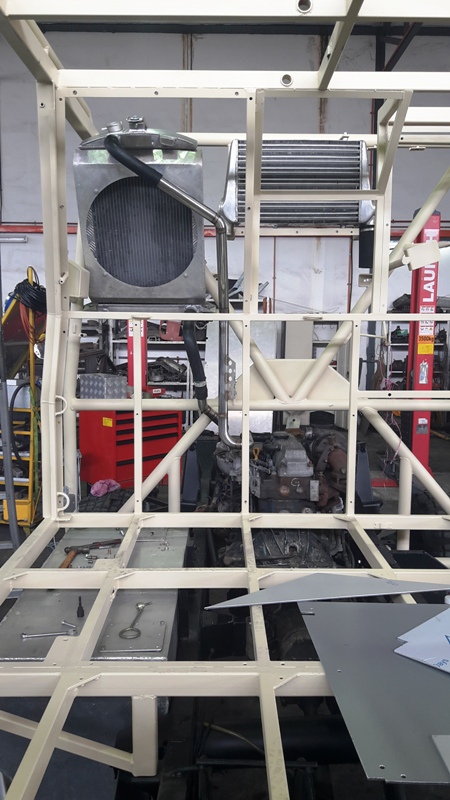

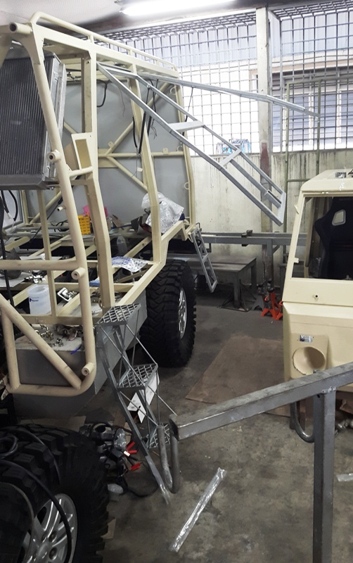

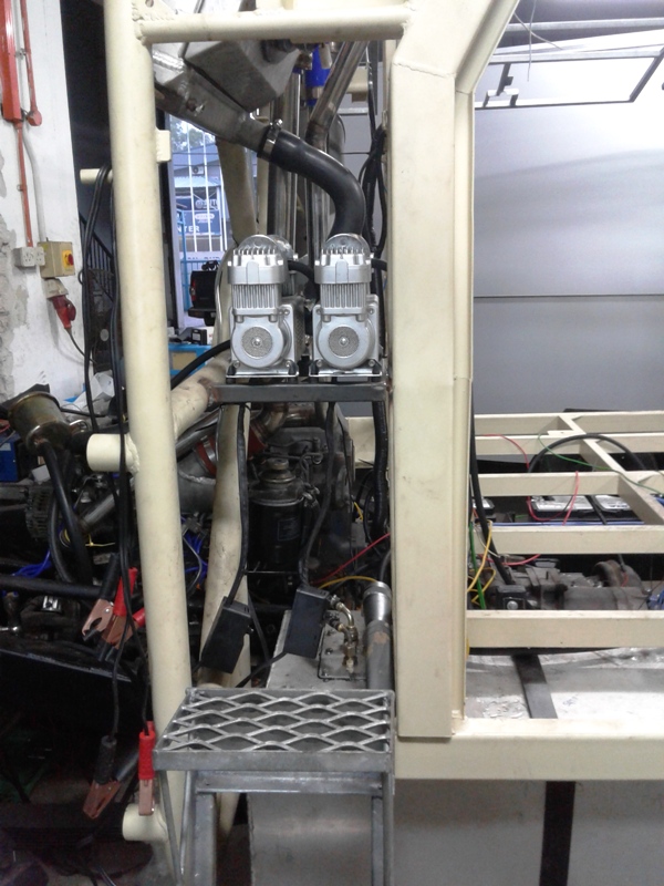

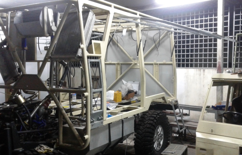

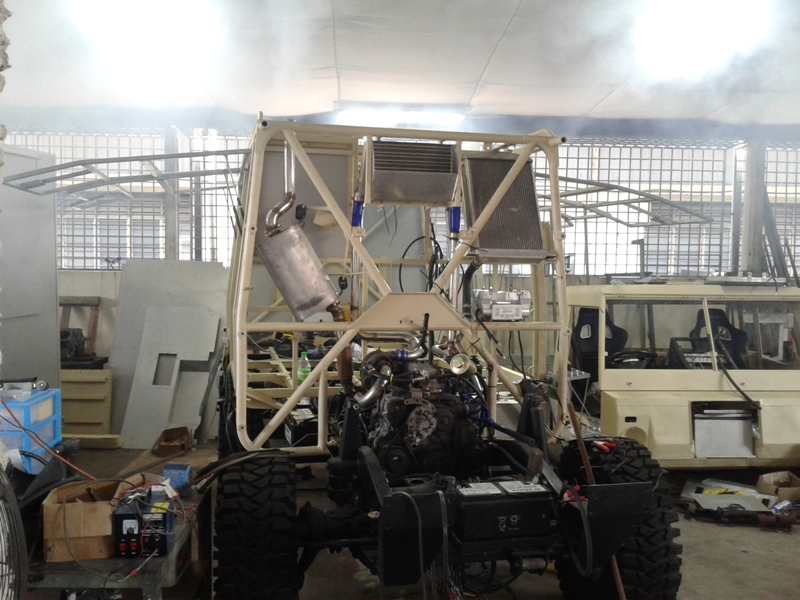

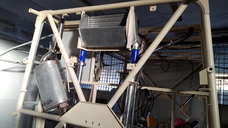

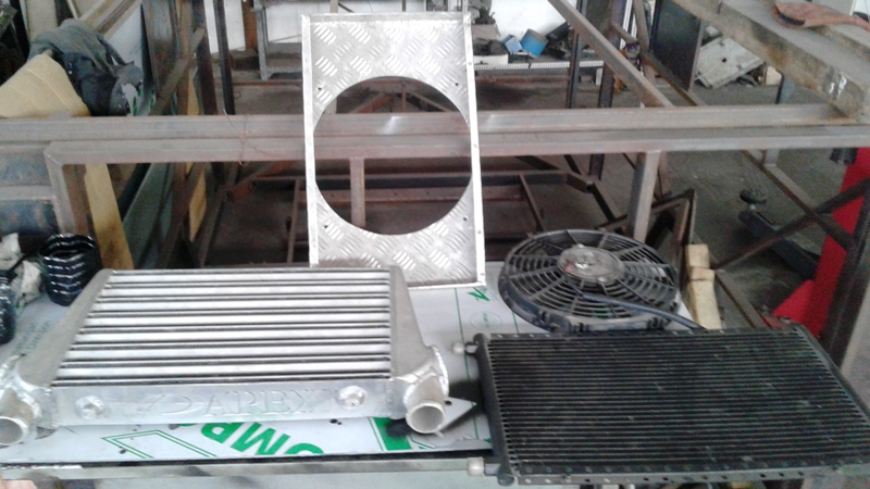

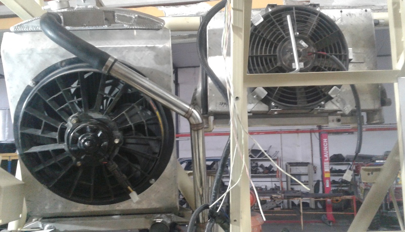

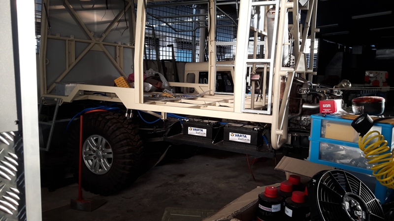

Lunchtime and I have the radiator and the intercooler bolted down everything is connected except hose clamps it all takes time including cleaning out threads etc.

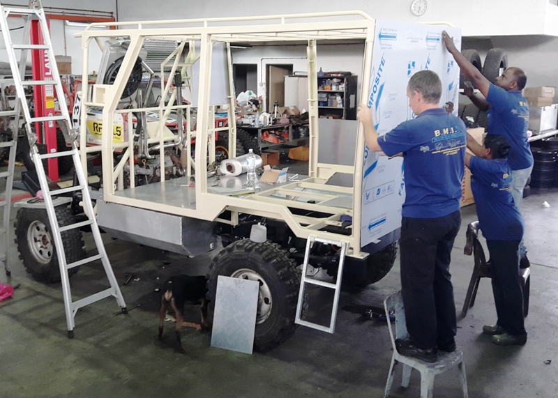

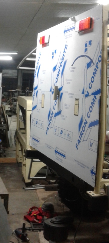

Then late arvo it's all hands on deck to mount the two rear panels while I have been testing that all the front panels are fitting and doing final trimming and I take the second hand 80 Series muffler out for a scrub
At the end of the day what do we have well it's starting to look pretty good. It's time to head off to my chinese mums place and collect wifey for the longg drive home.

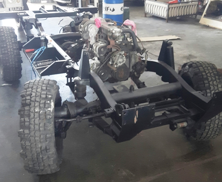

19 February 2016
Friday morning dashed up the 190K to the workshop and arrived just after the workshop opened at 8.10am
Idea was to run arround and get parts etc ready for Saturday and Sunday

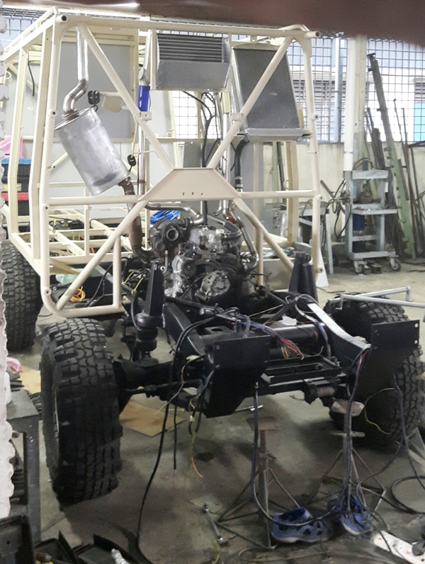

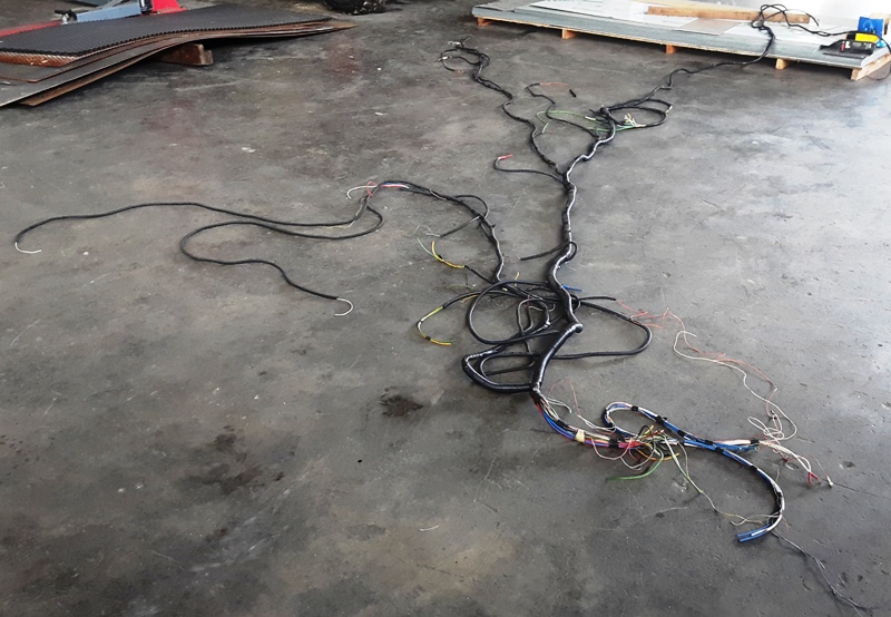

After much running around and forgetting parts I pulled the wiring loom out after shoving the wire eating pupppy outside we layed it out for the morning.
So a the end of Sunday what do we have apart from my employee ringing me and saying my RED truck as funny noises from the rear after they took it offroad. So we pack up early for the 20k run down the road to check it out then another 175k home. Fark TOW TRUCK back to Kuala Lumpur turns out the rear locker
tore itself apart after it was stripped today (Wednesday).
We have a wiring loom sitting in the truck all cable tied up and a few connections done. Rear taillight has a broken bolt and rsuted insides so I need new ones from sweden first.
All the wires hanging out of it. The cabin is not on as there is still issues with the engine area. The 12 alternator took me a day to get it to fit properly and belts fitted inluding 2 trips to the spare parts shop to get them correct.

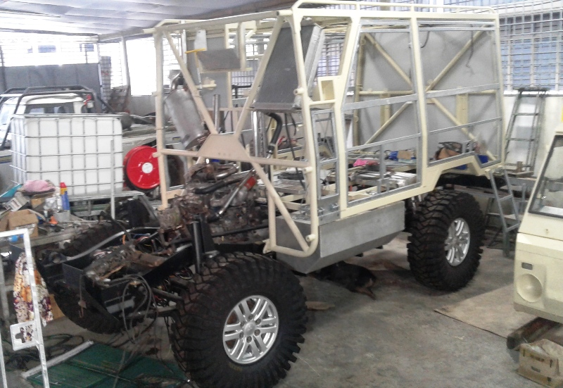

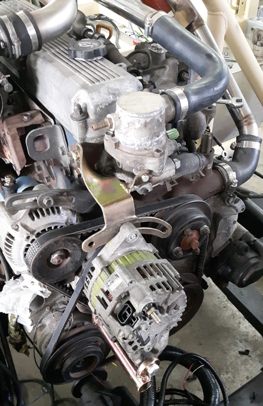

Finally I have the pesky alternator installed after a couple of days effort

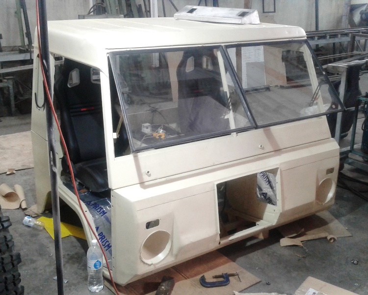

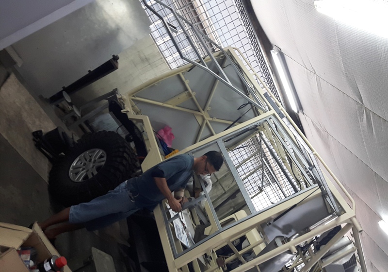

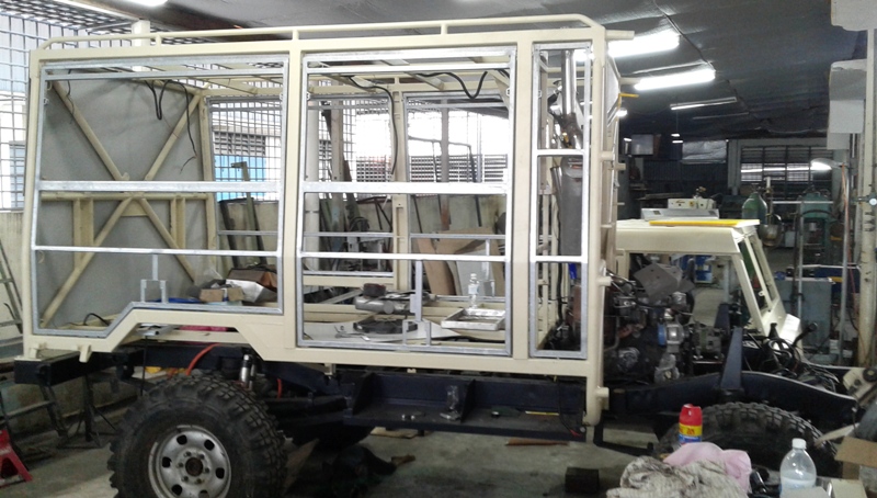

Then it's time to lower the cabin bottom onto the chassis after lunch.
And hey 2 hours later we have it sitting on the chassis

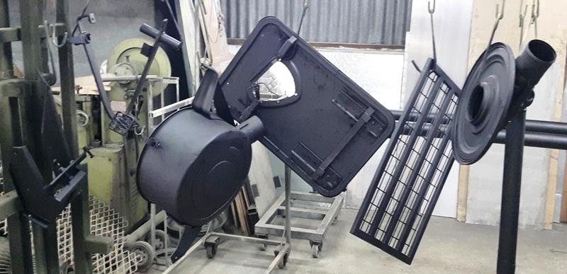

I decide to cleanup the items I have been cleaning up at home and get them painted. Grill, Engine cover, PEdals, Air cleaner, front prop shaft etc
Es gives them a coat of axle undercoat black

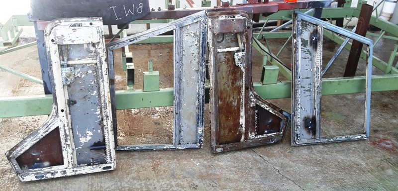

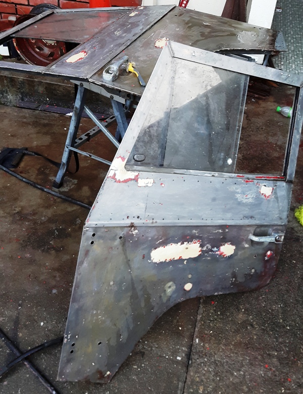

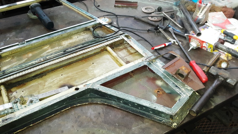

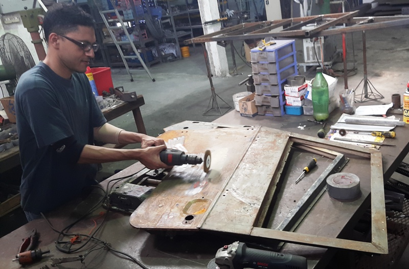

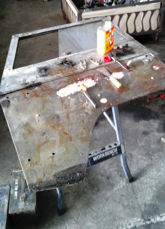

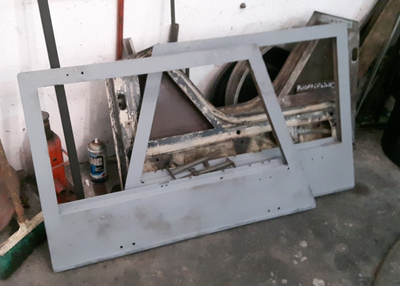

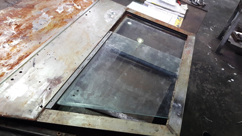

Doors sitting in the ISUZU at home. I am in 2 minds strip the complete outside of the doors or and and add another coat off paint. I decide strip and reunderccoat and top coats as I don't want 6 layers of paint
Doors ready for stripping

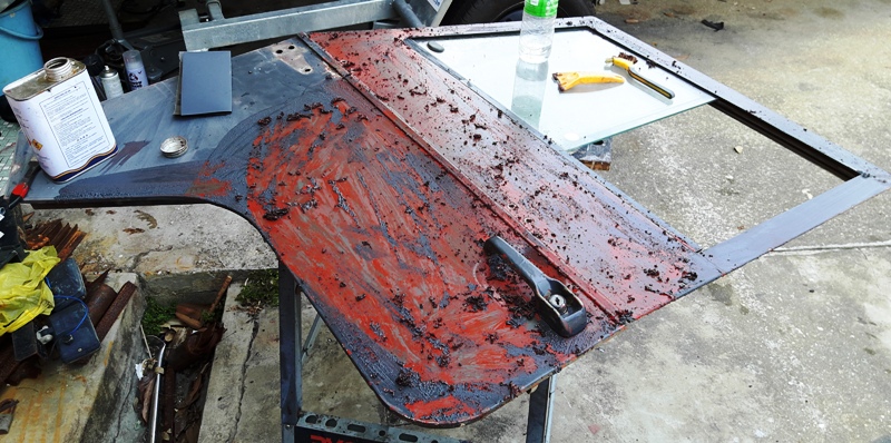

A pair of doors now ready for final sanding and a minor repair and then painting.

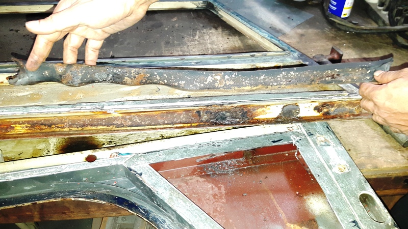

Stripping the paint revealed 2 war wounds from it's days as a RIOT squad truck I assume from the grills. They will be further sanded down as part of the character being left on the truck.
I have a growing list of parts to get or deal with. Tomorrow is the dash parts to the powdercoaters.

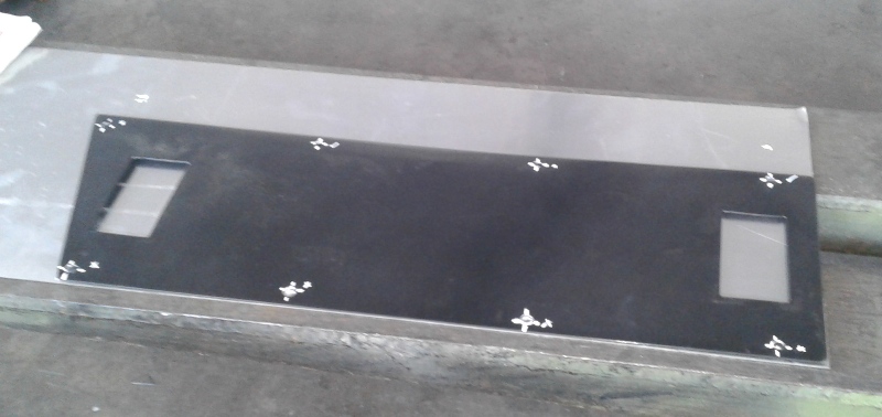

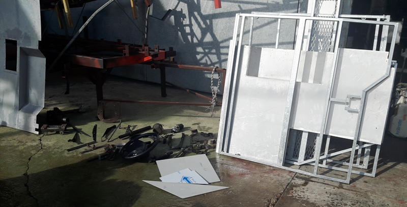

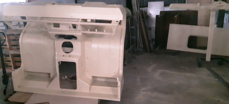

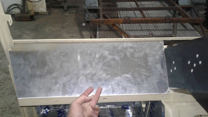

Rob preparing the dimensions for the cutting out of the service hatch panels and the
surprise. They are to be laser cut and prepare in the coming weeks.

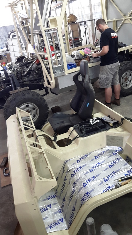

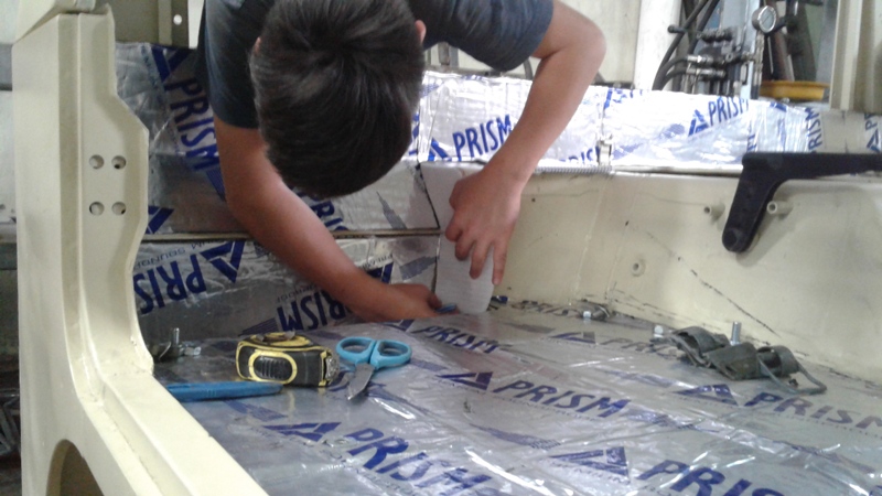

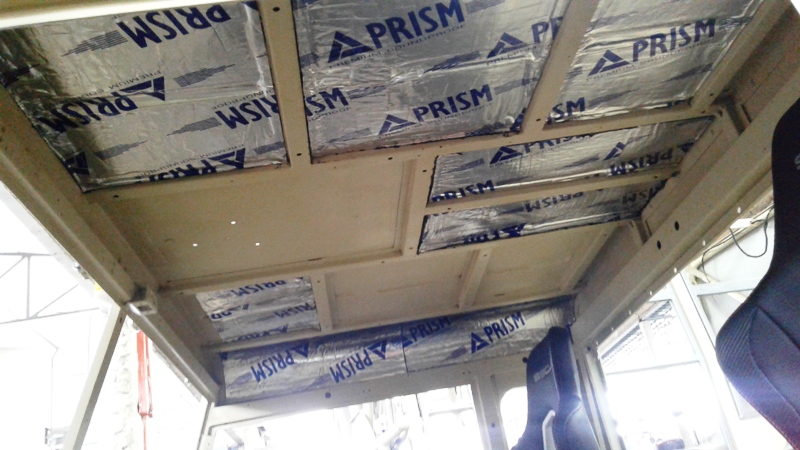

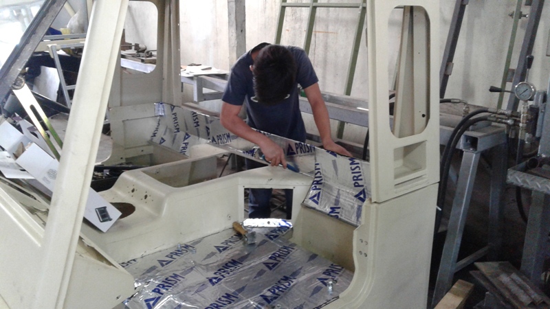

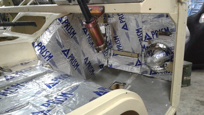

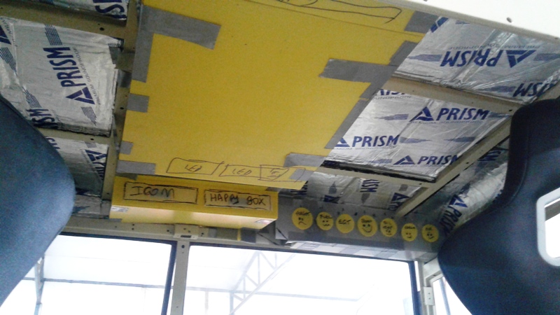

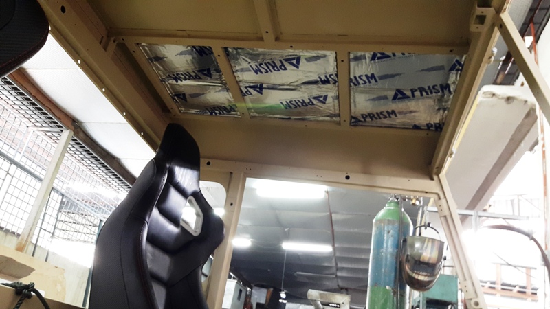

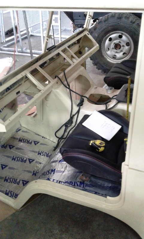

By lunchtime I have quite a bit of the soundproofing done in the cabin.

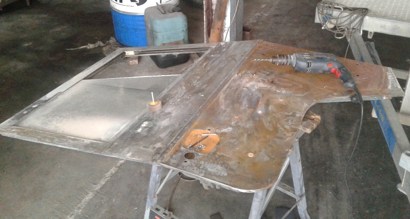

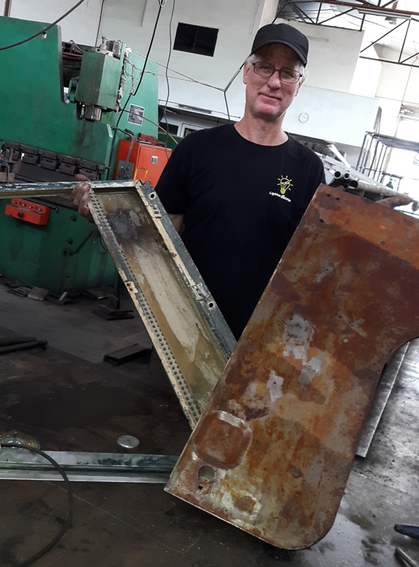

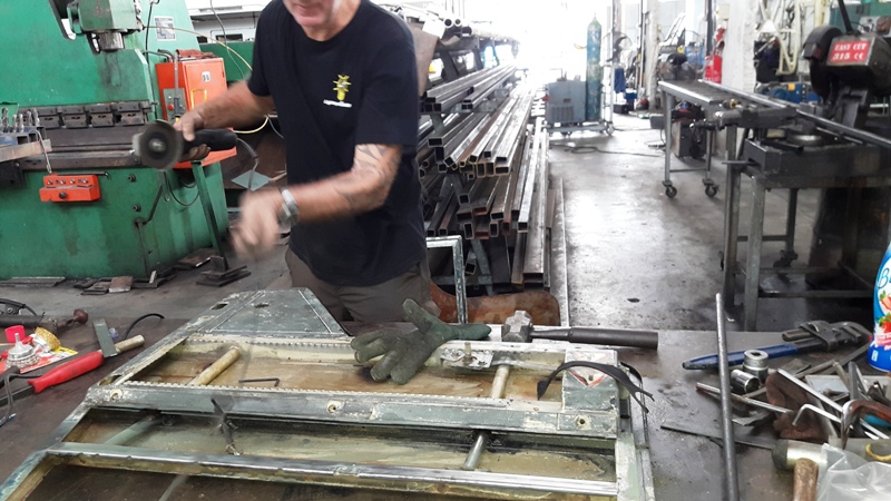

I also apply paint stripper to the one door I have to work on and commence to get rid of the
body filler. The black is the rust converter.
More soundproofing work continued.
I gotta get rid of these holes. ooks like the welder has to come out and I have one more to
fix and the roof needs a repaint we found a istake which needs fixing.

Then I mounted the doors and checked alignment - opps some bending required.
Then I install the front windows again and try and find the seal rubbers cannot.

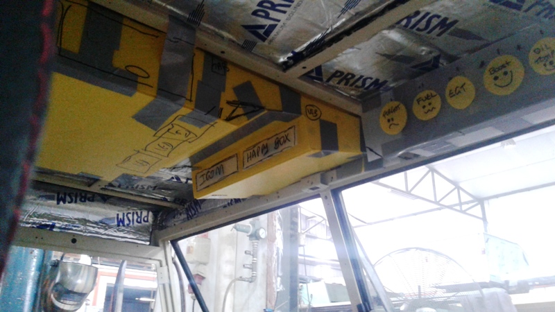

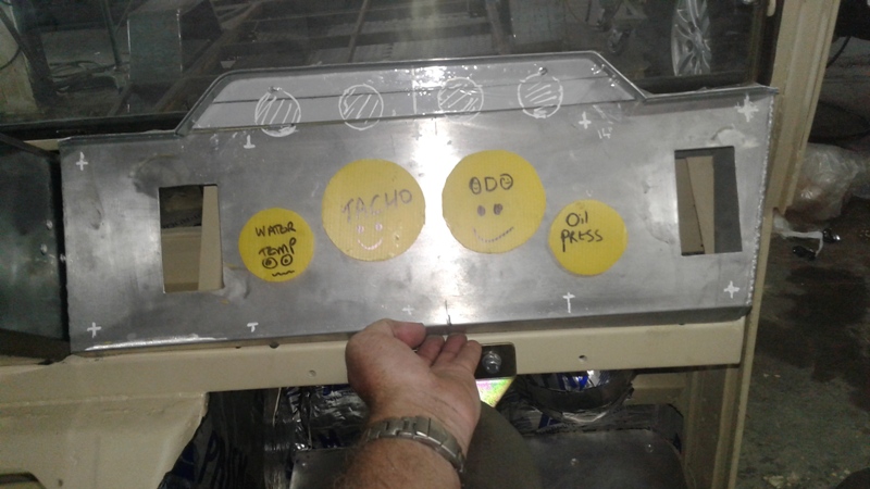

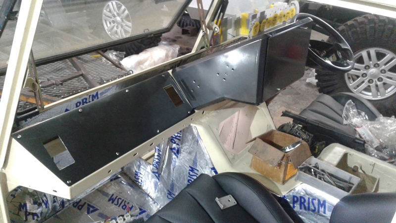

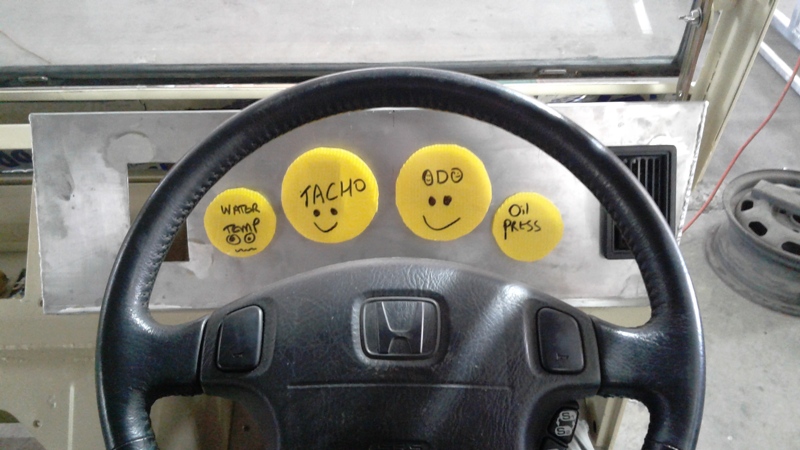

The overhead instrument console is layed out getting it ready to take to Rob to get measured
up to get laser cut.

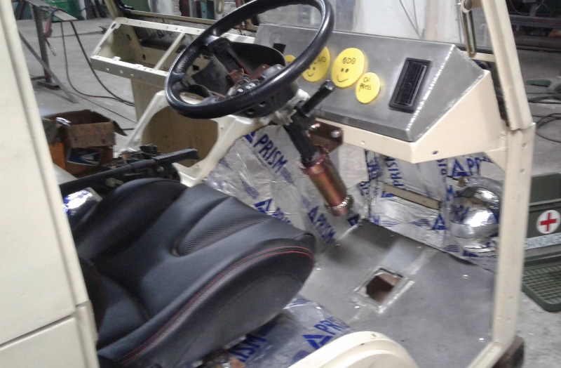

Then it's time to do the console instrument layout check with the new steering wheel. The
console will be remade its not right.
I move onto the overhead console and lay it out until im happy with it. It's also to be
laser cut.

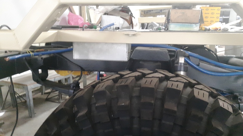

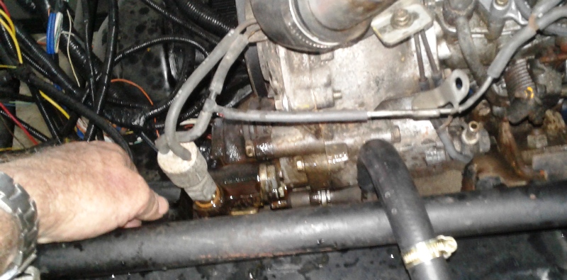

Then the task of fitting the turbo water inlet. Since we had to chop the top of the thermostat
housing off which contained the turbo cooling inlet and outlet taps. We have a donor location
from the left side of the engine unfortunately. Worked it all out another trip to the hydraulic
shop and the same assistant lol.

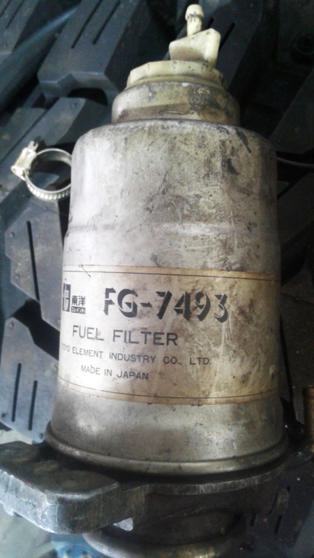

On the way back I drop into a chop shop collect 12 military boxes and 6 special ones. Reveal on
these later and also pickup a diesel filter and housing as this was missing from the engine
when I bought it.

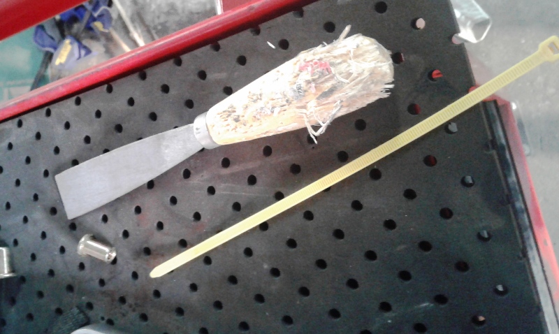

More puppy damage a new scraper destroyed before I even used it.

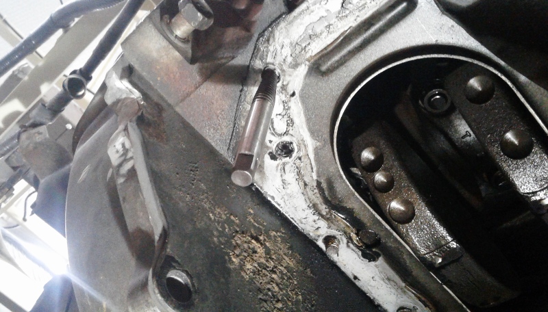

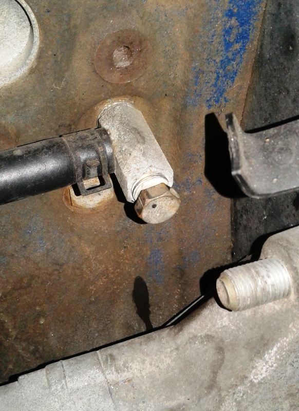

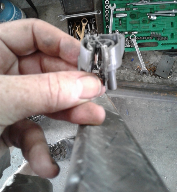

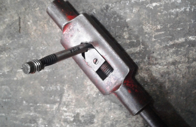

Then the arduous task of removing the broken sump bolt. Drill it out then try and find the
eaziouts I bought in the morning. Searched for ages could not find. In frustration I climb the
office stairs and then spy a pile of rubbish near the Landrover and investigate yes the eazi
out packaging destroyed along with the plastic case.
Recover the eazi outs and finally have the errant bolt out. Victory finally. Now sump can have
the oil temp sender fitted and fit it back.

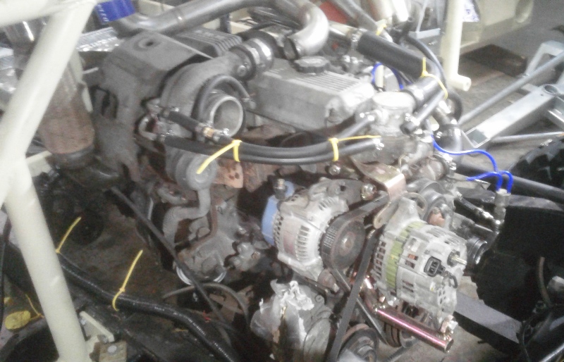

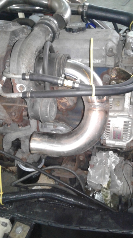

Turbo cooling hoses connected. The turbo shielding needs work. Will install this one and build
another fancier one out of alloy in coming weeks as this one has transport damage.

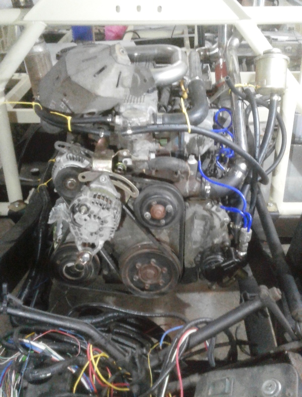

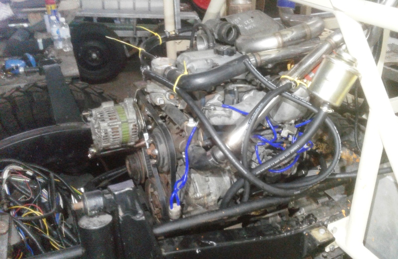

The left side of the engine almost completed change al of the vacccum hoses to new blue silicon
until I ran out more needed. Only 2 pipes need sorting out still. Power teering pump hoses all
connected - mounts to cabin but that may change soon as engine needs to drop out as a complete
unit from the cabin.

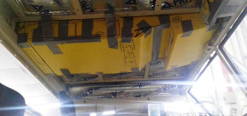

Today's goal is to finish the soundproofing in the cabin and then move on to whatever is left.
First install the last turbo cooling pipe adapter for the 10mm to 8mm tubes.
My helper today is little Jo.
We both tackle the soundproofing until we realise we are out with 1-2 sheets needed. The little cabin has consumed 8 sheets. So we move onto the doors and remove the door handles ready for powdercoating.
Then the puppy decides he wants lots of attention from Joe
Seats are fixed up after we realise a base is not screwed in corretly.

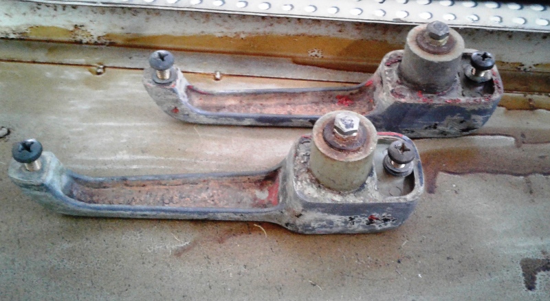

Then the doorhandles are stripped with the wire wheel.
End of the day we have 90% of the soundproofing done.

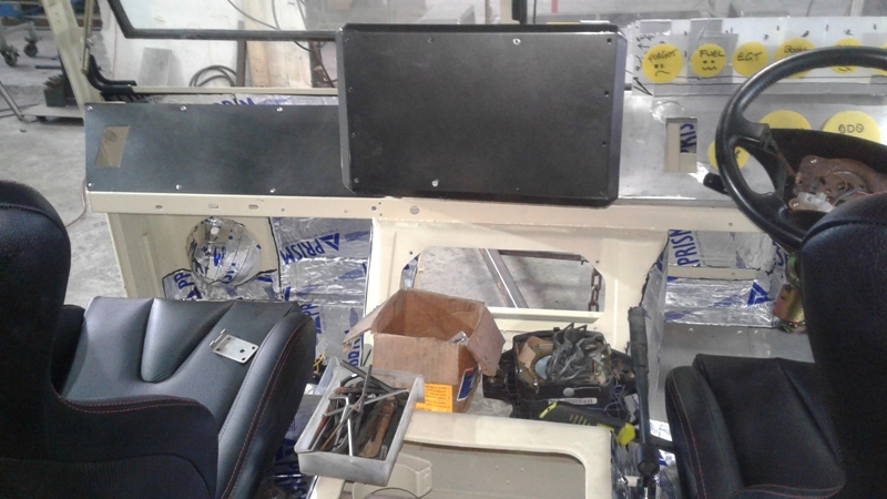

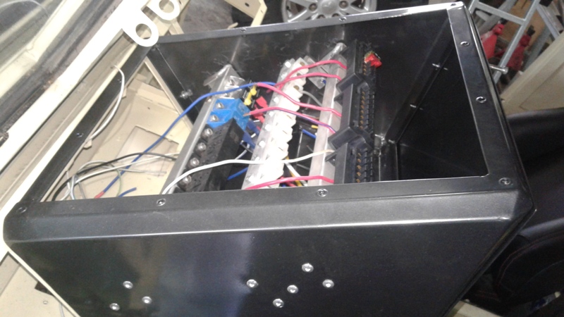

Fit the powdercoated left side of the dash but the bolt holes don't line up looks like I gottaa make another an oversight it's 30 mm too low so there is a gap between the dash and the window frame.

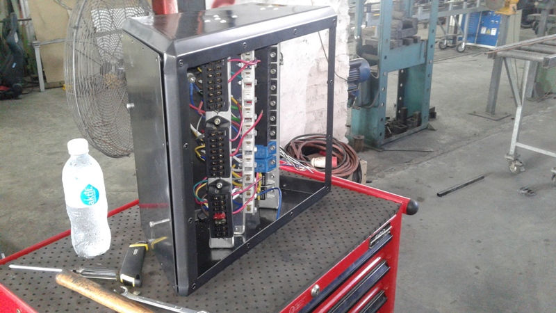

Then I fit the centre console for a fit before putting in the fuse box and wiring.

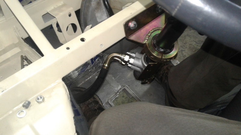

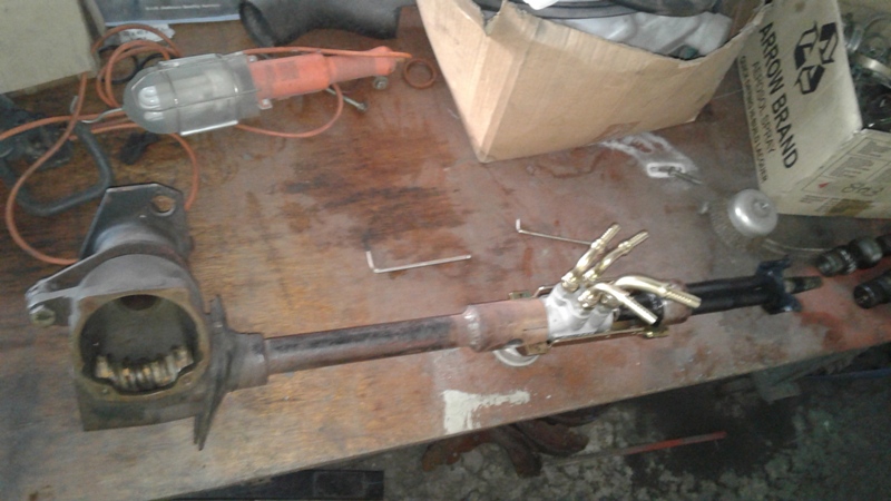

Then it's time to put the new power steering together for a dry fit as I try to round up the parts. Takes me a while to figure it out. Then I have 3 parts still to find. Find them when Brett turn up later on Saturday evening in a box I would have not looked in lol. Dry fit completed.
Then I pull out of the parts boxes a much needed bonus a 180degree bend and it fits the turbo bonus.

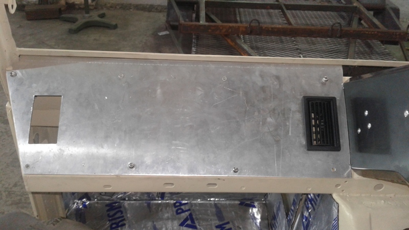

Remaking panel time. The errant panel being recut.
Fit the fuse box's and wiring to the centre console.
After lunch its fitted to the cabin
Then I look at the right side of the dash and decide mods are needed fo the warning lights.
Remaking time 20 minutes later I have the rough shape ready.

Power steering fit test damn the 90deg fittings have to go and be replaced by straight ones.

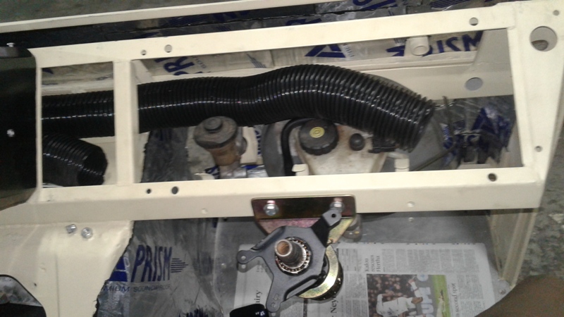

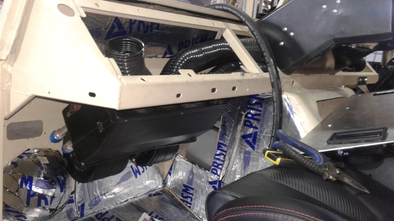

First job create a J bracket to hold the blower as curently it HANGS by 2 brackets. Yeah
someone did not finish the blower stuff off properly. Takes me all arvo to create this as I not want to drill a hole in the front of the CABIN as that was the easy way to create a rust hole later. So it take 4 hours of stuffing around just after 5pm I have a nasty bracket made up ready to paint.
Painted and drill 2 holes up under the dash mount the 2 RIVNUTs and then it all bolts together and the blower hoses also fit however we will need to put the window wiper arms in there is no room. So I will have to make up 2 Y joints for the drivers side to provide more space for the wiper kit. The blower doen't shake so the design holds up.
The hoses in place ready for the air conditioning contractor to finish off.

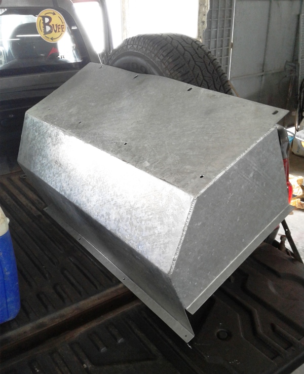

Morning no breakfast woke up too late. Faactory is opened for me 8.30am 9.00am I come back from breakfast to start.

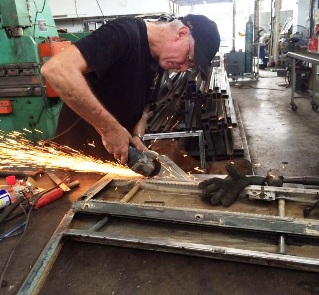

Todays task make these 4 pieces into one joined unit and bolted to the service hatch. Intercooler, Air cond condenser and the shroud and the fan.
The fan has nothing its bare. So 10 brackets (and 10 round down bolts made up) need to be made and fit the shroud to the air cond condenser and the condenser to the intercooler.
I finish about 5pm and bolting it down the FAN Breaks damn, falling off a few months back and hitting Pete on the head then the floor cracked it. Now I gotta order a new one.

Centre console will be ready and as also will the speaker brackets along with the service hatch panels all of the above being lazer cut.

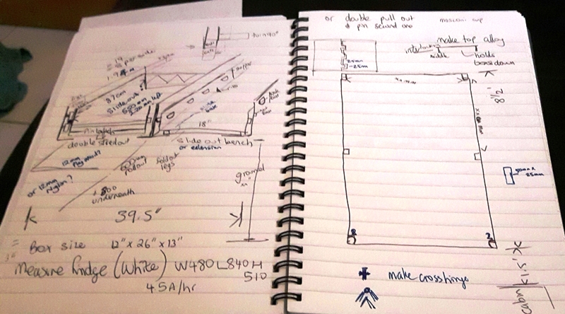

doodled the fridge and campin kitchen slideouts all I need is a couple of dimensions to finish it and get it lazer cut and then construct it.

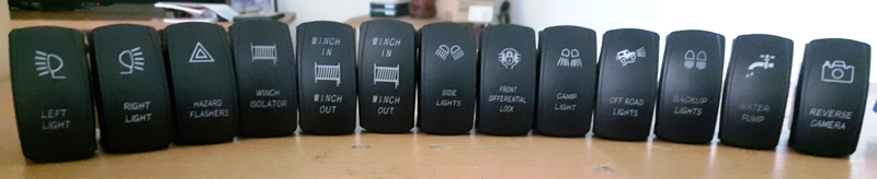

Then I managed to purchase the first batch of switches I need for the switch panel.
The doodled slide out panels plan. Test bearings etc have been obtained so I can test measurements and bolt/nut configurattions.

I work on mounting the diesel filter to a new location on the motor with a new alloy bracket and then fix up the hoses to the fuel pump, breather hose and fuel return connect the sender unit and we hunt down batteries to collect Monday.
For the last hour I pull the doors and start sanding them down and seeing how to pull the windows out and fill the engine with oil and top up the radiator.

Monday first job run off to the battery shop and hydraulic shop. Come back 2pm witht he stuff I need and then realise I forgot battery terminals. The day is wasted when I return at 4.30pm only time to setup a a small amount of the work needed to get the engine started before the 6pm cutoff.
All I got done was to tighten the fuel tank fittings up and then get the batteries into place and started to connect them up. Now I gotta make square rubber gaskets for the fuel tank covers
Batteries connected except the posative wire.
So what was done. Doors attacked yet again, Fuel tank ready to go just fuel pump to weld in brackets and connect up. Gearbox mounts. Doors holding up by themselves.

Joy works on the doors sand first and we fill the separattion tubes full of WD40 so we can attempt door splitting later today.

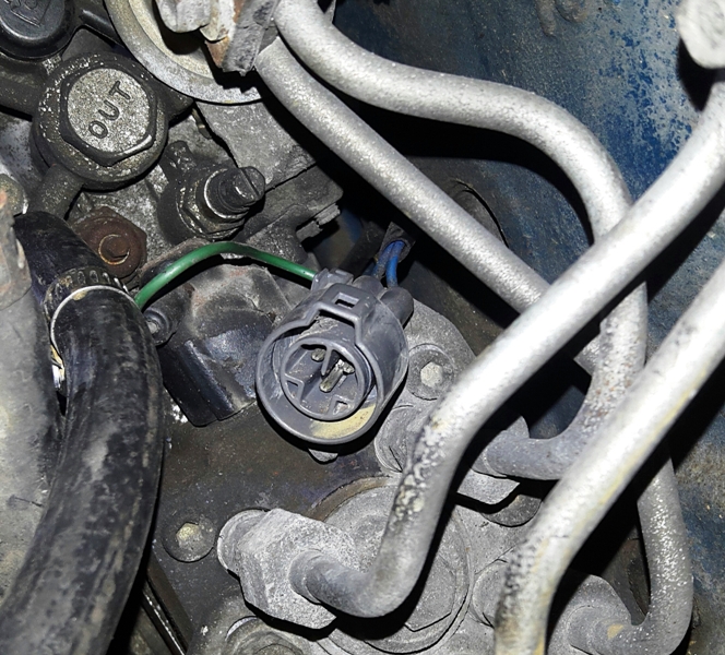

Stupid PLUG for the Injector pump.
We fill the tank with DIESEL. NO NO NO everyone forgot the bottom BUNG which is impossible to see is missing, 10 litres of diesel runs all over the floor and $50rm of KITTY litter needed to soak it up. Another item to get from the hydraulic shop next saturday.

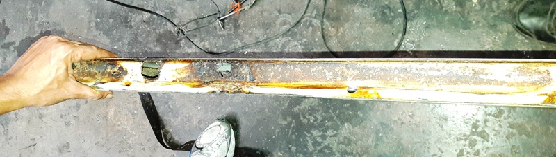

We work on the doors by 10.15 we have one door split. Its a lot of work. A Bar the right size to slip up inside the tube gentle tapping to push the inside tube up and we have to cut one tube out to get to the inside tube and lots of WD40.
Then I decide I need to cut the panel open to see how much rust is inside the panel. Sure enough my guess is correct. I will make a cover panel up later to replace the cut out panel. Anyone else with a VOlvo should look at doing this also. Rust converter and undercoat etc will be needed on rebuild to prevent a reocccurance.
The cutout panel hmmmmmmm perfect.
We go to lunch and cannot find the puppy to lock him out so leave him in the Factory. Bad move. Return to a bag of 500 cable ties all over the floor. New VOlvo Fan dragged on the floor. My tool box sponge ripped up on the floor. Damn a mess to cleanup.
The rust is revealed the rubber strip between the 2 door halves keeps moisture causing a lot of rust.
And more rust.
The naughty puppy.
The wiring of the fuel tank is completed as is the hose connecctions all ready to go with some minor wire protection needed to be installed next weekend.
Then time to connecct the front 12v battery up
Then back to the final door and we have to cut the panel out to enable splitting of the door.
Wow it works the second door is soon apart and I give the bare metal a quite galvanise undercoat to protect it. However I had to also cut the outside tube out to accomplish the door split.
Then we worked on laying the 2 sets of winch cables from the rear winches to the batteries. Winch controller (Albrights) will be connected next weekend.
The intercooler is finally now connected - only the fan is left to connect next weekend.
Due next week. Centre top console. Speaker panels. Brackets for the intercooler and air cond condensor. Panels for the service hatch doors. The test panel looks awesome.
Injector Pump plug
Reconnect the repaired radiator.
Test startup
replace the engine water with coolant
Bolt the fuel tank down

One day trip up to the Volvo. Starts bad and 2+hours drive for the 190K doesn't help I arrive 10am and with my list of bolts to buy head off. I realise someone has installed the BUNG in the fuel tank. But everything is closed the wife informs me it's the Kings birthday everything is shut.
Everything has gone wrong today. The centre console and other parts from the laser cutting have failed as the shop ran out of steel lol. No plugs for the injector pump still. The weekend is a bust.
Back to the workshop so I start working on the winch cabling then I realie I have left the terminal lugs in KL curses. 2 hours later I have finished getting the WARN winch cables layed out and cut to proper lengths. The winch controller box is tight and I redrill one hole to stop the cables having severe bends. Now next weekend I can crimp the cable ends and connect up the WARN winch and start on the T-MAX.
I work on the doors stripping more paint pressure wash them down and leave out in the sun for a repeat cycle.
Brett turns up and fixes up the radiator leak. Then we turn to whats left to start the engine very little next weekend if the plug turns up I can start it.
Once started the CABIn can be installed provided:
- The rear window frame is installed.
- The air compessors are installed
- The fuel filter new brackets are added to the roll cage
The doors drying in the sun after pressure washing.
The winch controller box with the WARN cables layed out. Grommets and crimping to be done next weekend.
The location of the winch controller box close to the winches.
Radiator remounted and bolted in just in time for 6.30pm lockup of workshop.

Sunday I get a spare 2 hours and the finish stripping 3 of the 4 door halves.

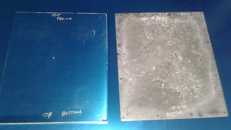

First the doors are in Kuala Lumpur in a shop being repaired. I picked the right shop they had a old DODGE pickup a mustang and a fiat 500 in their all being restored. No idea when I get them back.
After last weeks screw up where the gate was locked when I got there. The LAZER cutters screwed up no one panel ready. Rob was down there supervising and rung me wanting to pull his hair out. They had bent the overhead console wrong and the guy was trying to flatten it again. Rob got pissed and told then to recut the panels so we missed the Friday night delivery date they promised. They are not getting any more business from us.

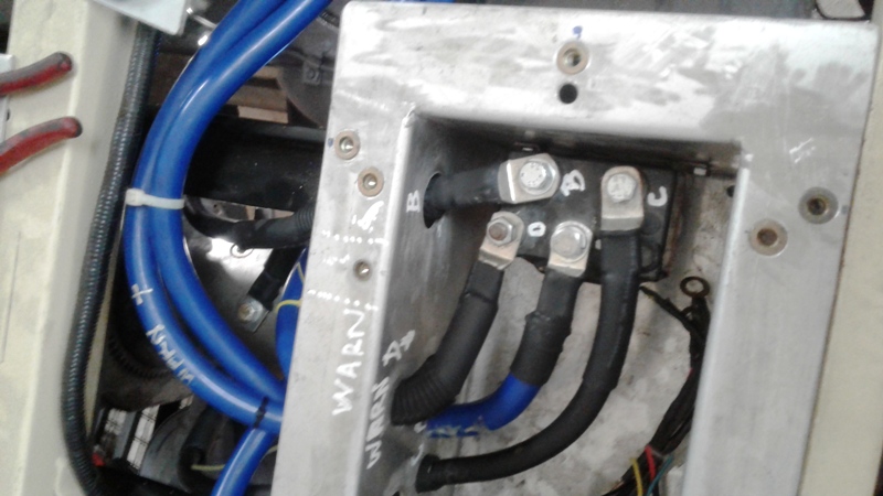

Then its onto the WARN cables on the contoller box - 3 hours later it's wired in and it makes a noise when I hook the battery up. One WARN M12000 converted to 24 volts. Next is the T-MAX then I realise I did not pint out the wiring diagram. I finish one side of the fuel tank sender and pump sealed up. I have a small leak from the fuel tank bung sigh.
Still got the nylon cable protectors to add and the albright to pin in next weekend.
So I go time I have till 9.30pm tonight in the shop. So I fit the new top LED tail lights. And work out ssomeone has tossed the bottom tail lights brackets and the police protector grills sigh so I design ones to be lazer cut and bent.

Refill the radiator and discover the new radiator cap does not fit the radiator is USA made it needs a big cap.
Fit the fuel filter in its new location. However, it needs grinding a the filter will not come out.
Make up wires for the Injector Pump and make earth wire for engine and fit the starter motor wire and check everything 3 times. including jacking the car up and checking it's in neutral. Clean the tuck all loose bolts etc cleaned off it. Seal up the second fuel tank lid and it ready to go almost. I check and find the IP signal wire and finally hear the CLUNK as the IP ses hello.

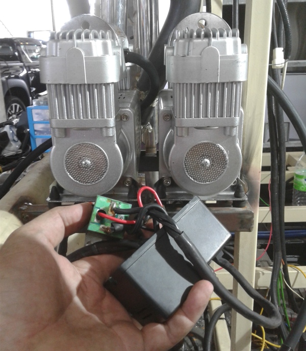

Fit the compressors and damn one will not work looks like wiring issue. Need to still fit something to stop them rocking too much will get the shop to work it out.
1 hour to lockup and I run out get more fuel and the tank now has 55 litres in it and is only still not 30% full lol.
30 mins to lockup. Test the starter contact. Connect the starter wire. Turn the engine over it turns so I do again longer each time and run it about 20 seconds. Then I prime the filter and try but still it will not fire. Home time load up the fuel tank cover ready for etch priming back in KL.
Home time 6.00pm happy bit sad it did not start. The cabin can go on on next Sunday now

First I work on geting the engine started. First I decide stuff the plug and deftly cut it with the angle grinder and rewire it.
Reprime the fuel filter filling hoses manually check all my jury rigged loom and at 11.30 I'm ready for a start we rig up a oil pressure switch and roll the enggine over until we have oil pressure. Then we start it first time it fires up run for a few seconds and stop - try again run it longer. It smokes white smoke pouring out of the exhaust into the workshop.
After lunch first we deide to look at the stupid compressor pull the control box apart find the short. Low Export quality China s*** work. hen we retest and it works OMG. The shrink wrap not shrunk it's all loose. The wiring soldered to the RELAY. No isue we will cut it all off and start the wiring again
