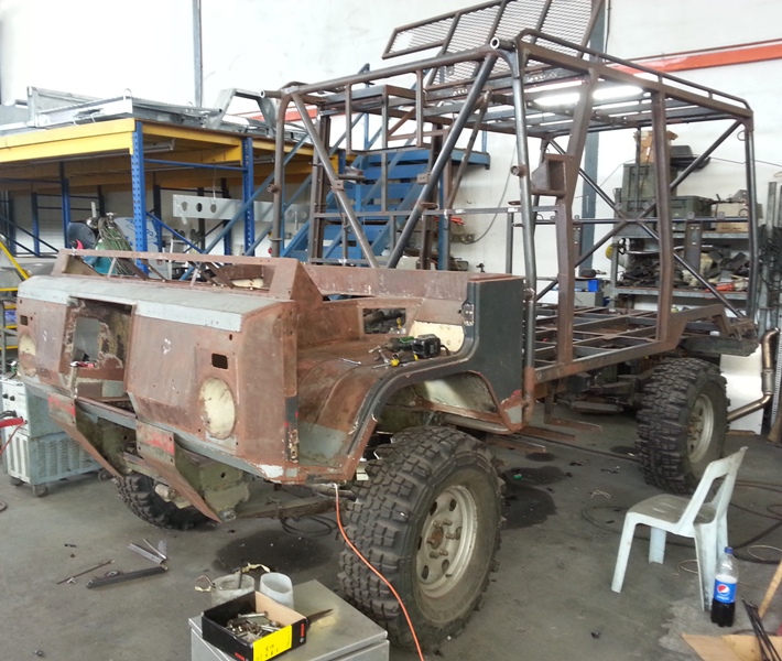

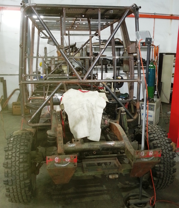

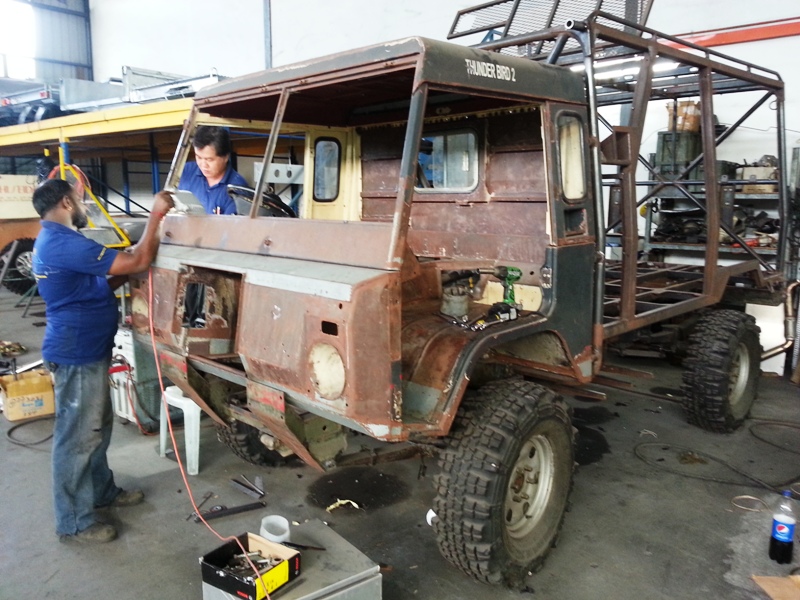

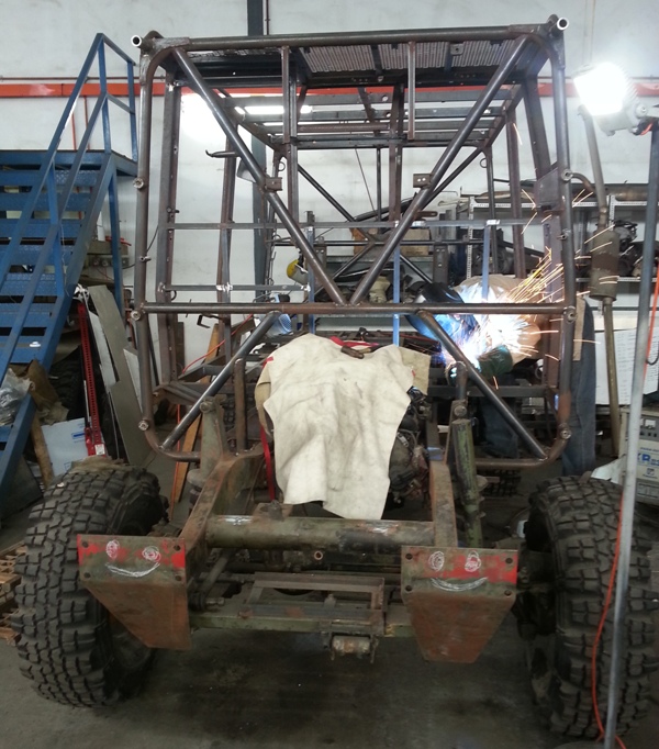

Finished up the top hatch locking tabs. Welded in the tie downs points and finished the fold down steps locking pins.

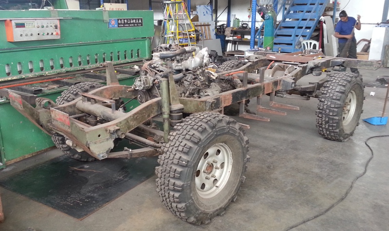

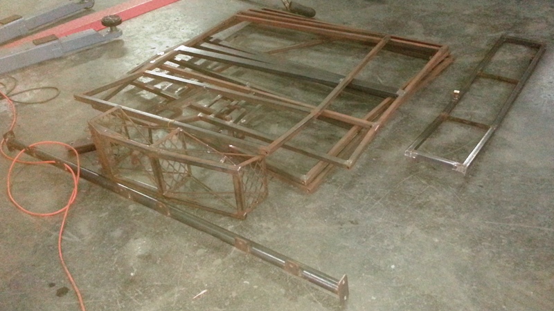

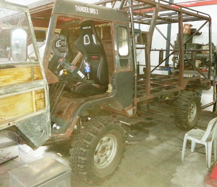

Then it was the time for the strip. All the bolts are undone 8 to go in the morning to lift the rear out.

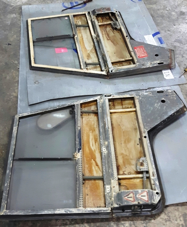

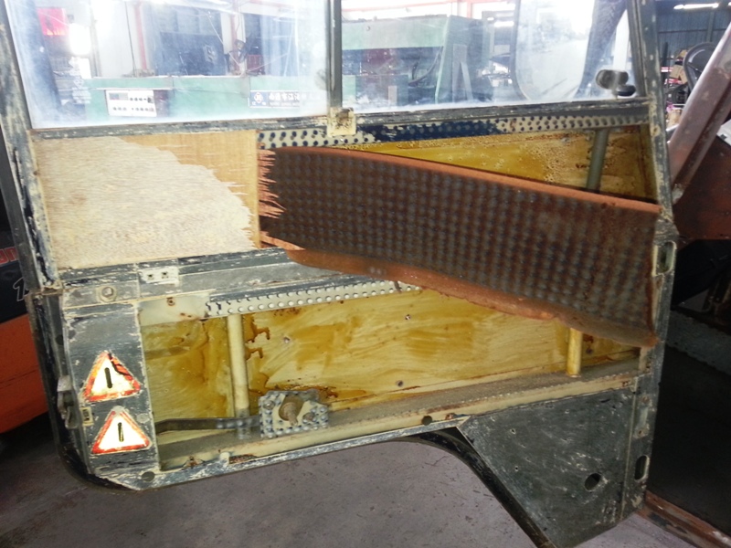

The doors have an internal rust issue to be dealt with

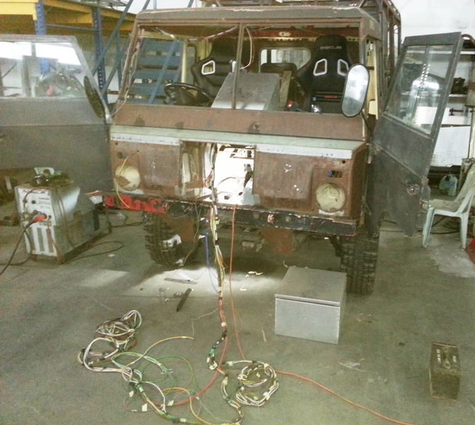

Front cage off and the wiring loom stripped and labelled.
All the doors frames etc removed
Side view
Tomorrow the LIFT off.

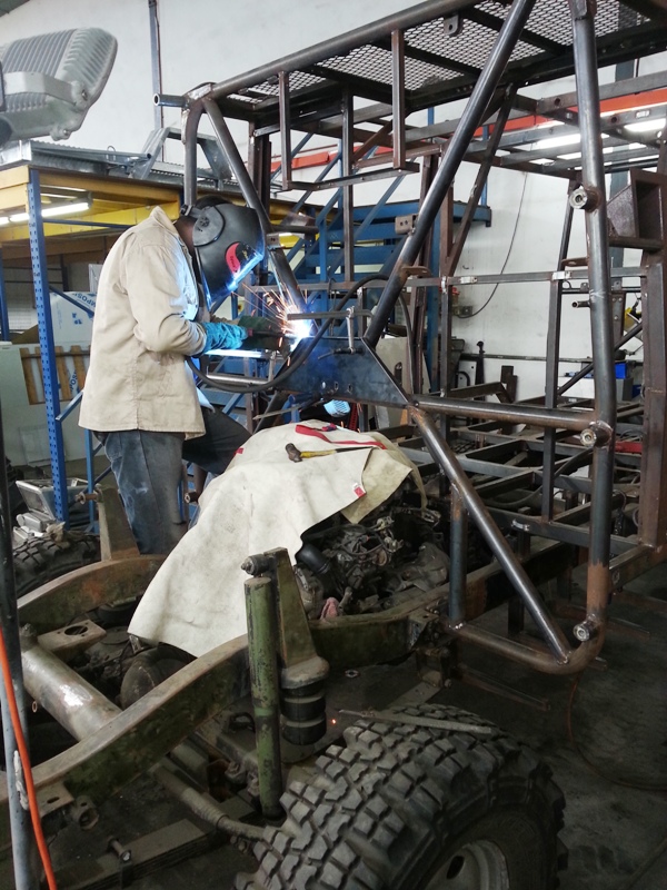

5 September 2014

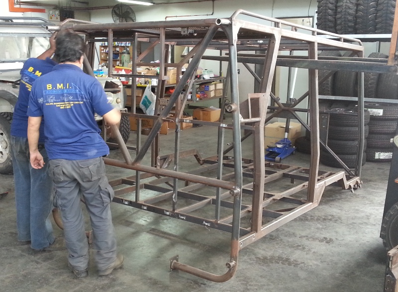

Continuing the stripping today all stripped and all touchup welding done and then we discovered that 2 braces had been missed on the rear body and the 6 contact points with the cabin needed more work.
Damn fit the cage back on and redo the welds took us an hour to fit it properly to effect the repair.
Time for home to repair the busted CV joint on the mighty troopy they had one set of welds left to do.
Monday finish the remaining touchups on the body
Tuesday off to the paint shop for the sandblasting and undercoat.

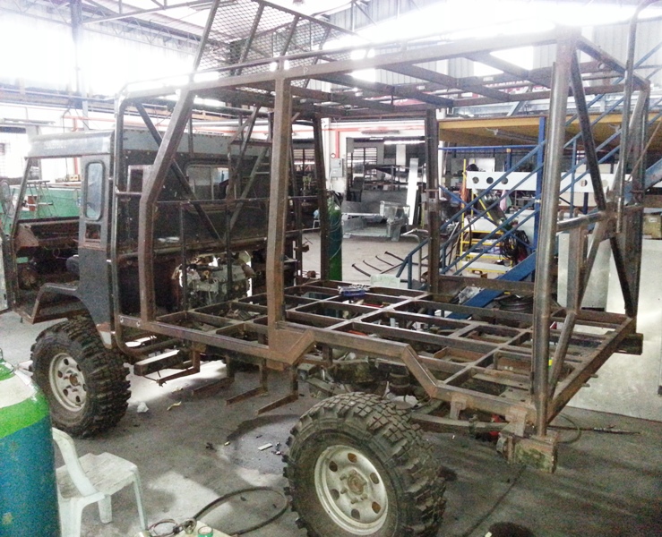

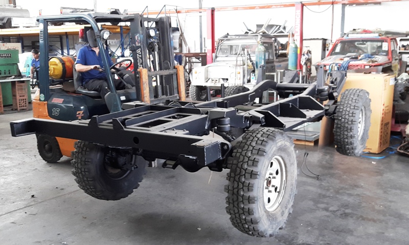

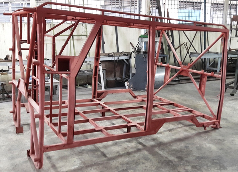

Chassis has been painted black

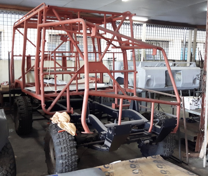

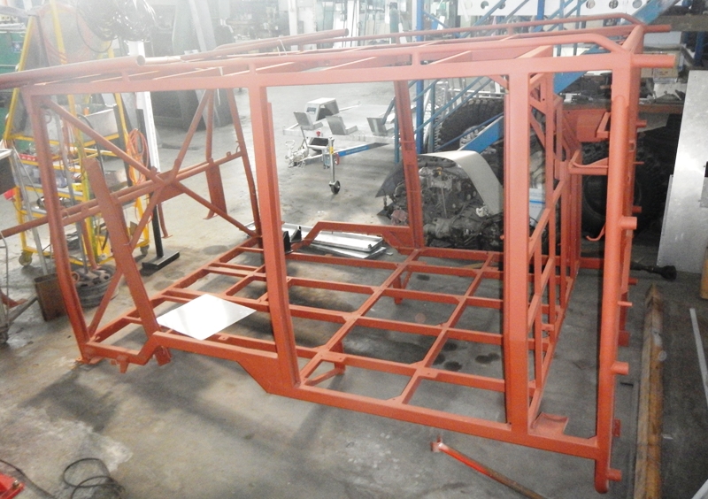

Rear cabin frame has been sandblasted and undercoated

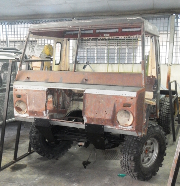

Front Cabin is to be split and sent to a sandblaster who uses softer blasting material not steel pellets like was used for the Rear Frame.
Chassis painted - sorry about the pellet etc on top but no time to move it.
The Cabin with more touchup brazing done.
THe rear cabin frame all undercoated

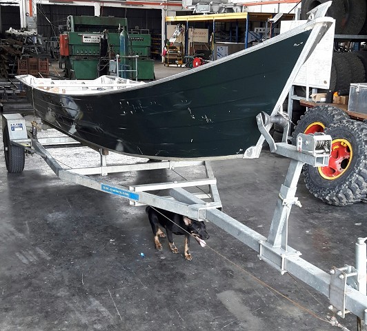

So Saturday took the trusty Isuzu and attached the boat and trailer, had a swiush breakfast and then headed to the workshop 190K away. Fark me holiday traffic and 3.5 hours later.
Reversed the trailer in for the addition of rollers to combat the issues on steep boat ramps and a dry pull out and to make it 3 feet shorter. No the dog is not the trailer tow dog. He is also still deciding whether to rebuild the new fuel tank/seat which has leaked again 3 weeks after the boat shop repaired it looks like the did mig welding and not tig on the fuel tank so its split - YIKES!

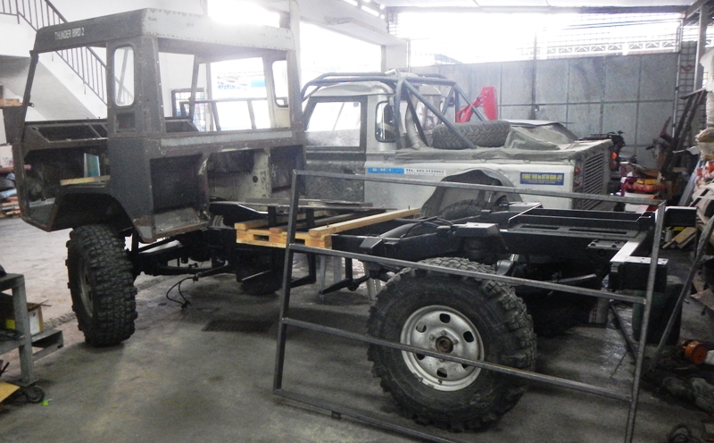

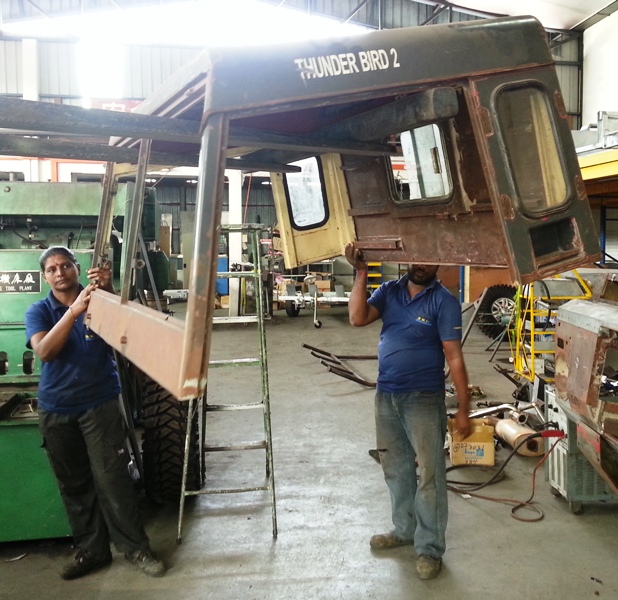

Good news cabin split in two and removed from chassis to do the touch up welding send putty work.
So next week almost ready for painting.

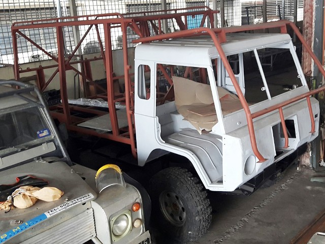

2 Feb 2016

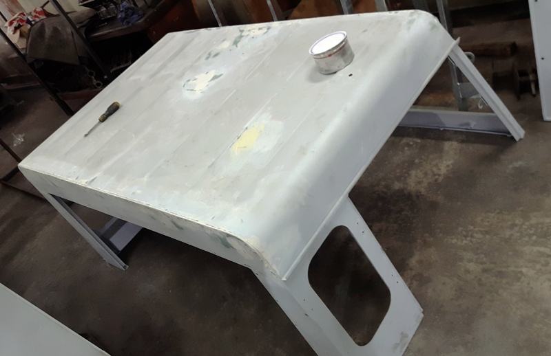

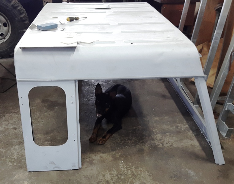

I rung for a progress report and got told none so I asked why he said no staff to do the body work. So being years since I prepped a body I volunteered to do my own vehicle.
Monday wa a pub holiday and they offered me the workshop for Sunday and they would help me Monday.

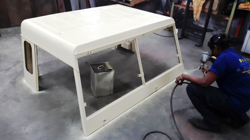

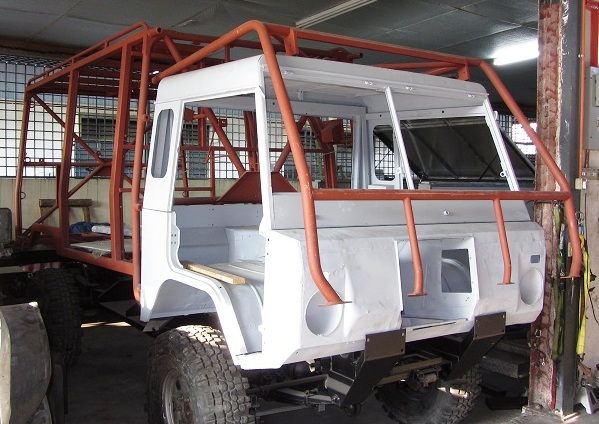

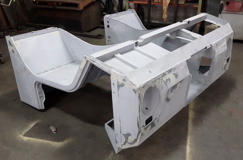

So Sunday morning 9am im 190k away from home at the workshop. I start had a quick look at the Cabin and did a quick plan of attack. All day I played with small amounts of body filler. By the end of the day the cabin wac starting to look close to being ready for paint. Original dents etc were left alone
The frame as Sunday morning
My companion while I did the top of the cabin was the workshop new guarddog the cazy happy 7month old mongrel
The rear panel is a bit of a mess but its been decided its original we leave it.
Filling the repair work from the patches added to the roof.
Oh yeah the pooch likes ICE as its over 34c here at present

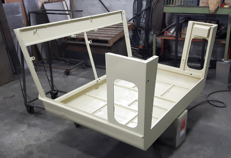

Preparing the paint
Inside of the cabin top painted

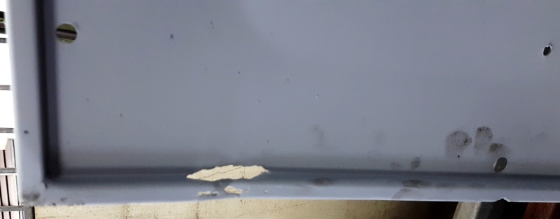

We sat this here this morning ready to paint then we realised the sealant we added at lunchtime took 24 hours to cure our mistake for not picking it up yesterday
So after 2.5 days work of pure hard work in the heat I have made a lot of progress.
Early this evening we moved stuff around to enable the rear cage to be painted.
Rear cage 2/4 sanded tomorrow they can finish it and paint it

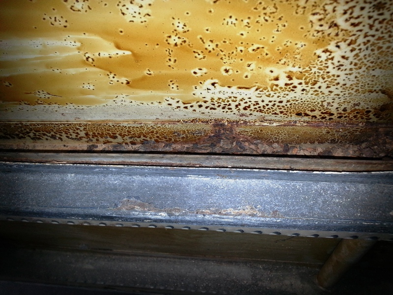

The doors are being taken apart a there is a small rust issue in the top/bottom join area.
3rd coat on the top of the cabin.
