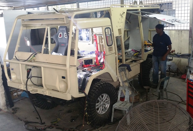

One week on the Volvo coming first we move the cabin ready for a trial fit sometime this week. The whole crew is available to work on the Volvo all week. So I'm calling it the big rush week.

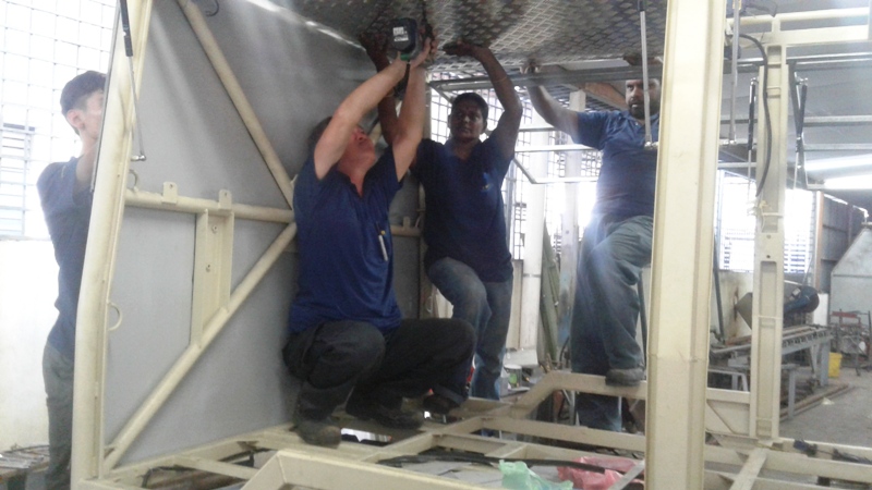

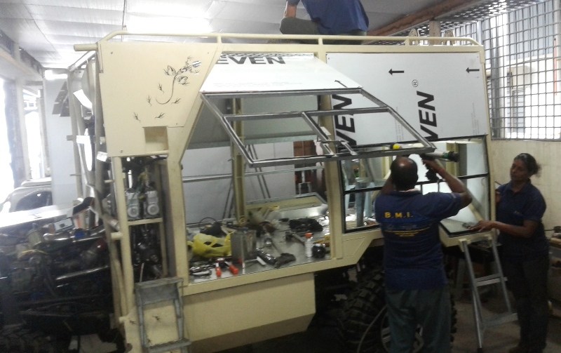

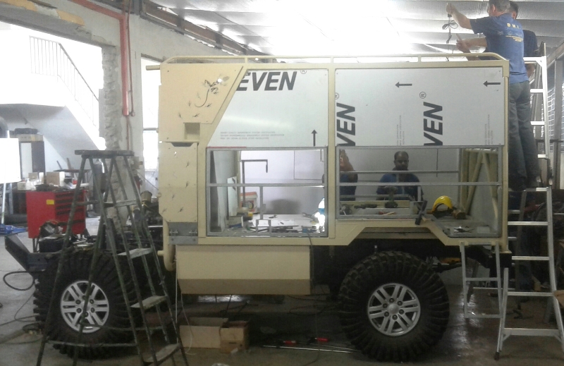

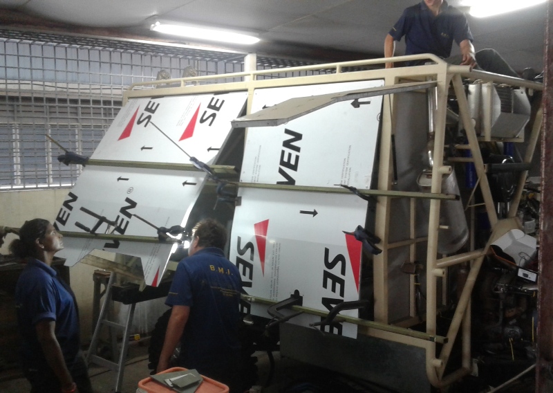

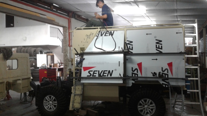

All hands on deck to install the ceiling.
Poor Yap trying to figue out how to do the front ceiling.
Mr Brown jumps up to assist and supervise
End of Day 1 of thhe big rush we have the roof done

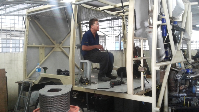

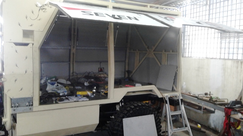

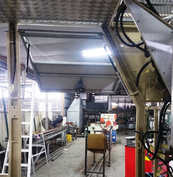

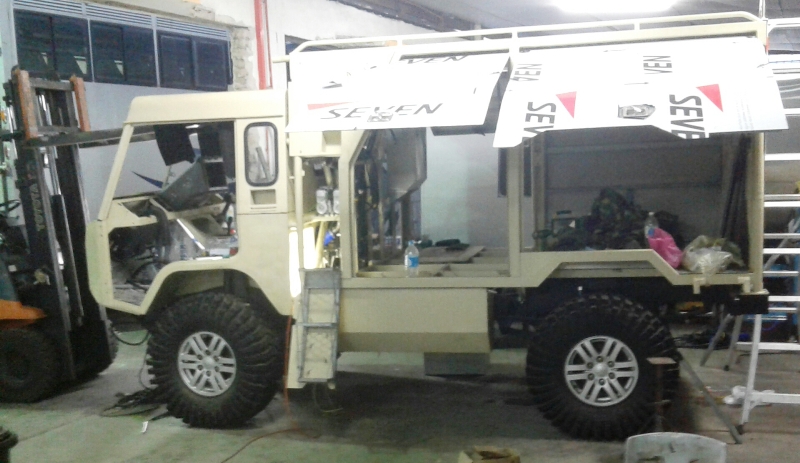

By the middle of the afernoon all the top removeable panels are completed except one which is being remade in the morning
I work on the front cabin panels getting them all to be removeable correctly for easy access.

The end result of last nights gluing session is shade awesome, but oh and we need new gas stuts damn the 400M one's are not strong enough I need 600N the doors start to drop down a little.

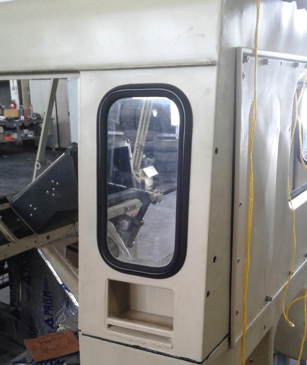

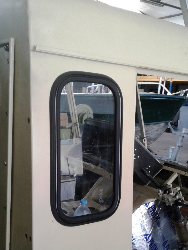

Next is the windows I fit the 2 side windows and give them a clean they come out smick.

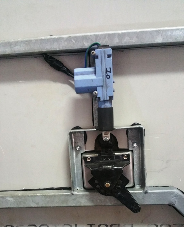

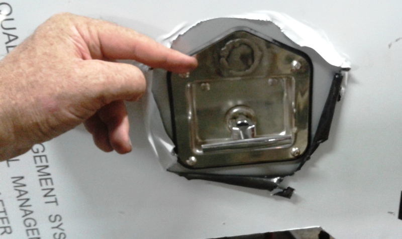

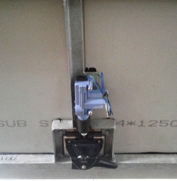

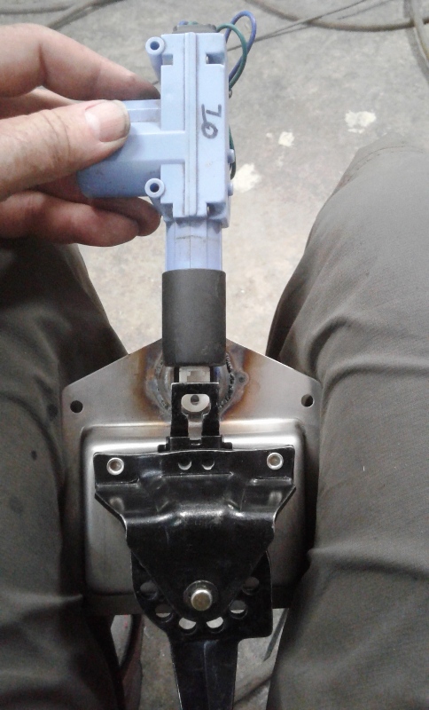

Now the locks. Yap starts to modify the locks to accommodate the central locking while I clean out the holes for the locks to fit in.
Next week this will be ready to install and test out wow a 36 year old truck with Cental locking lol. The welded up keyhole is getting something special made up to hide the welded up hole.

So the end of the week we have thrown some 268 hours at it but missed the big goal of putting the cabin on.

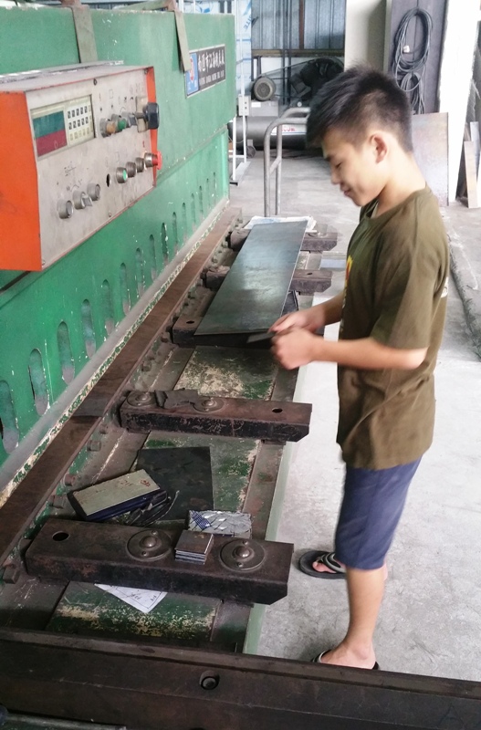

Came back and had one panel almost finished and then the guillotine chopped to much off trying to trim 1mm off SOB. Down tools and we go to lunch and then I head back to Kuala Lumpur for a couple of days.

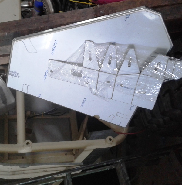

Day 7 of the big rush and I'm picking up parts for the Volvo from the laser cutters. I have to wait for one part to be cut out as they do not wanna bend it. It's ok we will bend it you just cut it. I wait 1 hour. Then sorting out my work permit yet again. Eventually I arrive at Ipoh 1.30pm.

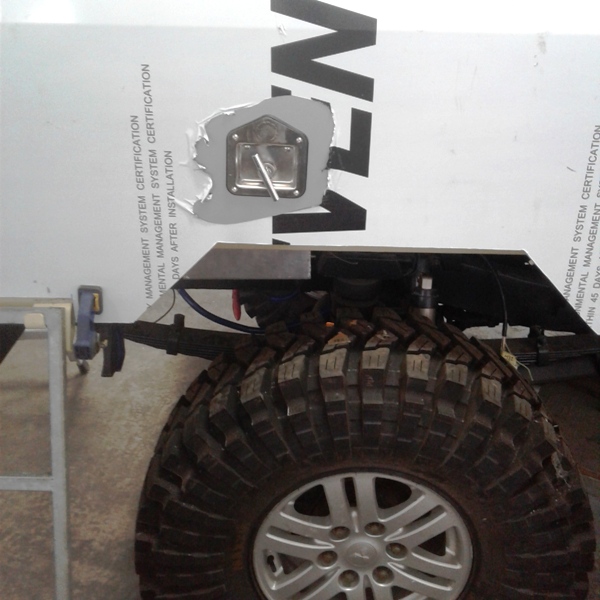

The door locks are now fited
Cental locking also ready for wiring.

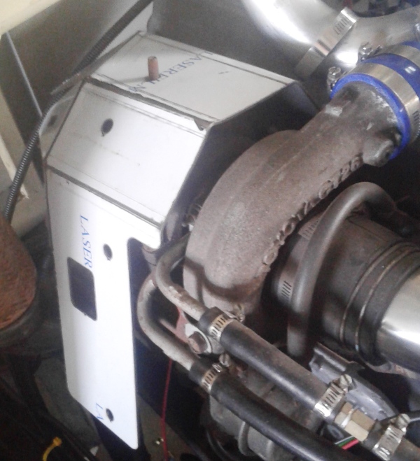

The exhaust heat shield and the turbo sheild waiting to be installed.

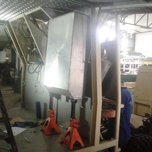

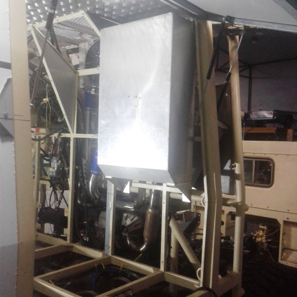

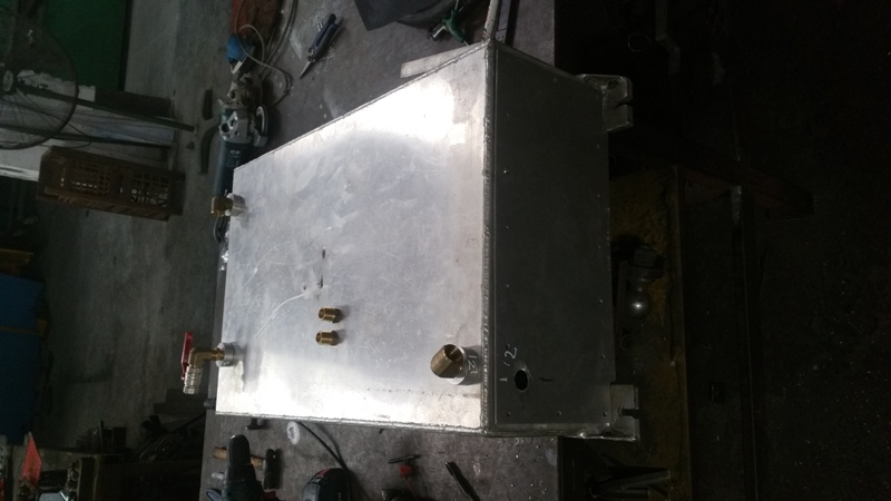

I started on the watertank install and had a few issues which have taken a day to sort out.
Brett started bending up the turbo heat shield.
Only the turbo heat shield is needed to allow the cabin to be put on tomorrow.

I work on the Water tank repair/fit - 6mm spacers are welded to the rear of the tank to cater for the unexpected BUMP.

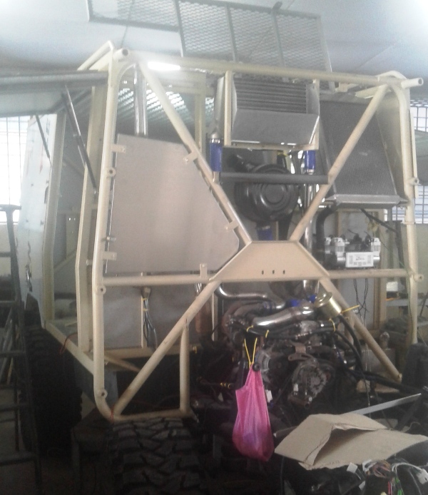

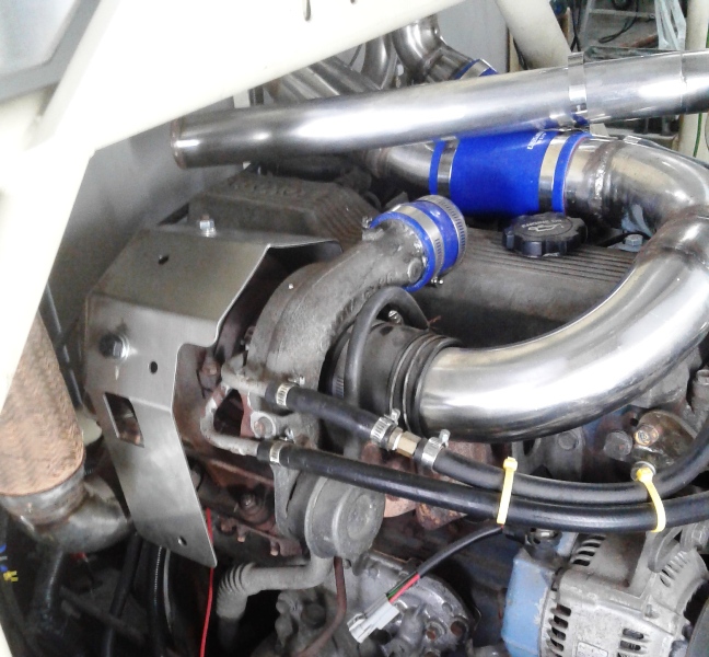

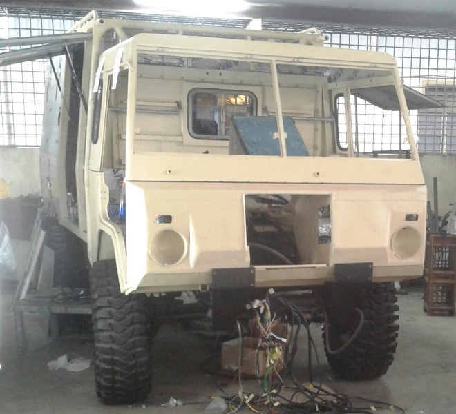

Brett finishes the welding and leaves me the job of fitting the turbo shield. 2 hours later and a few unusual fixes to fit it and getting late in the day the turbo shield is bolted in.

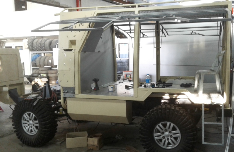

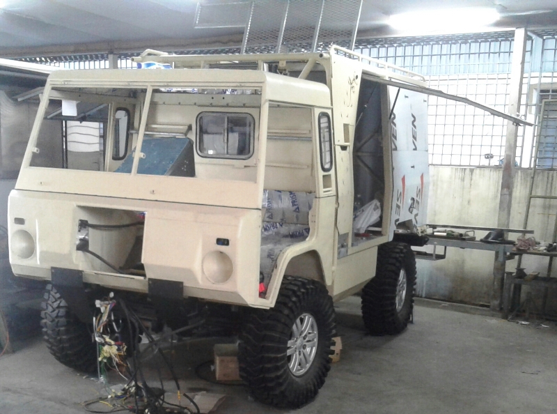

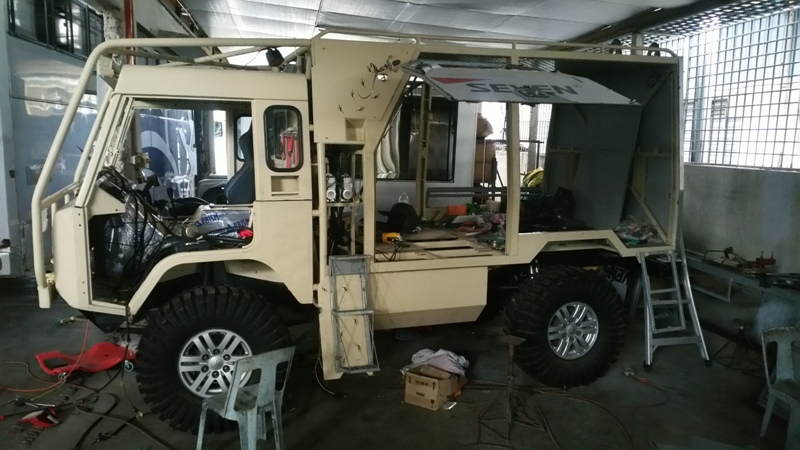

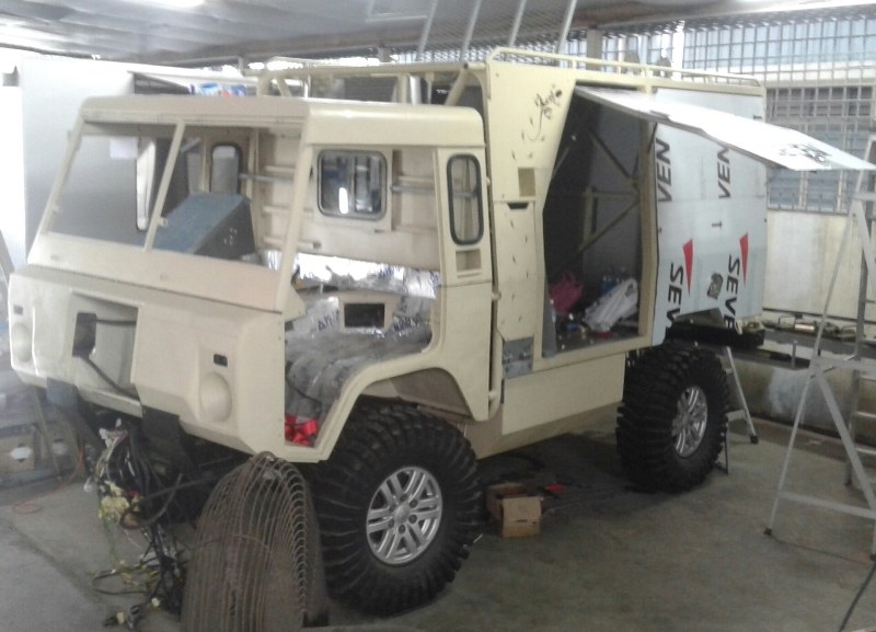

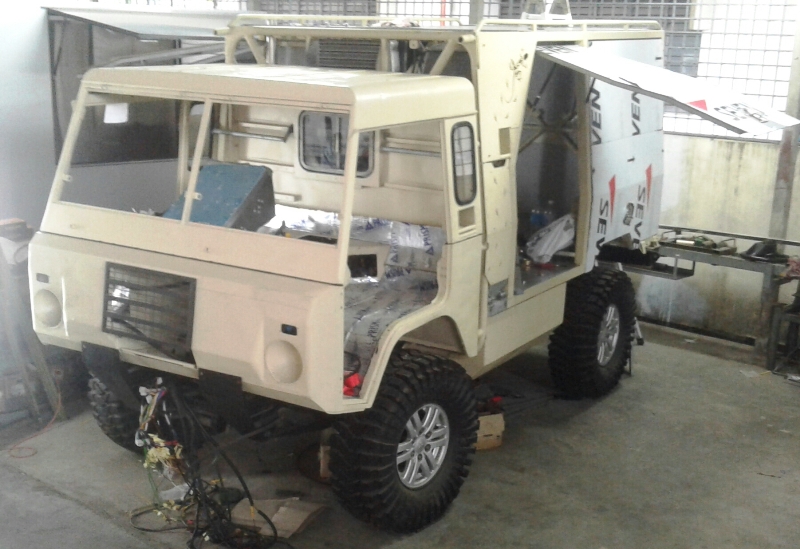

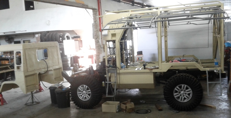

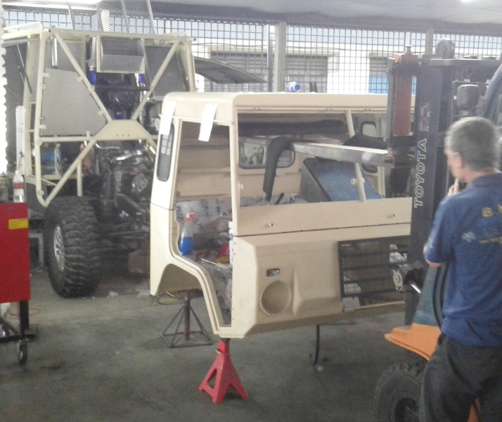

Quickly we setup for the cabin move

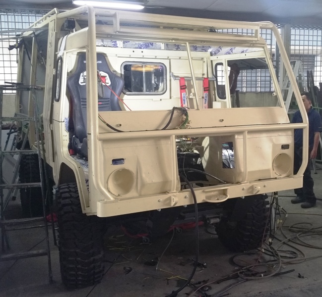

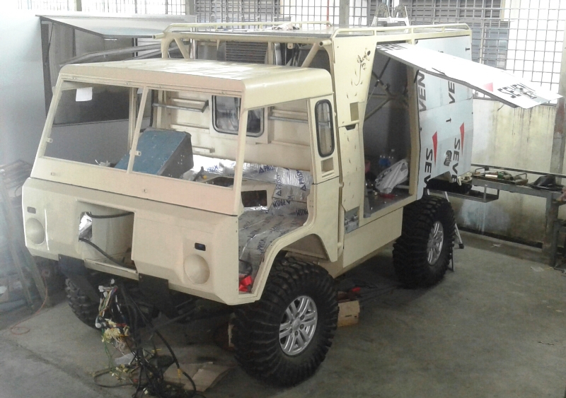

15 minutes later we have mission success the weeks goal is achieved. But it will have to be lifted off Monday morning to fix up the harness sea belt mounts at the rear of the cabin. However everything else is all ok as we do the fit inspection.
She looks great better than I could have imagined. People ask when is the top coat going on. Thats it Ford Creamy White (or Desert storm base paint colour - hehe)
Had to have a pic with the grill in.

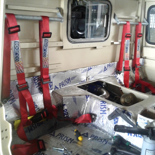

But ended up getting the harness seat belts fitted. Inspection of the cabin shows it needs to come off as a few of the rollcage holes are a little out.

Worked on the water tank slotted the top bolt holes to make it easier to fit - hey prestto it was much easier to install. Now need to do the filler taps and the outlet taps sometime next week.

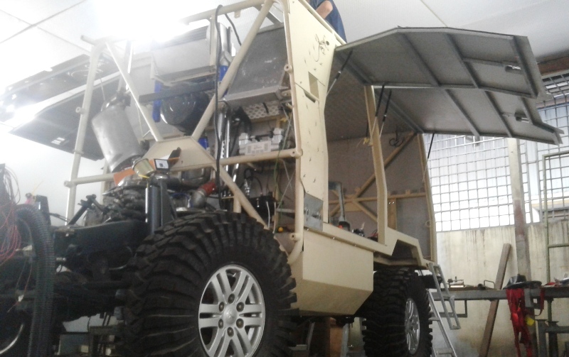

Removed the cabin ready for tomorrows work marked all the holes to be trimmed. Removed the air cleaner a we are now attaching the air cleaner bracket and the supports for the harness seat belts together.
19 December 2016
Day 13 of the big rush.
Cleaned up the holes with the air tools.

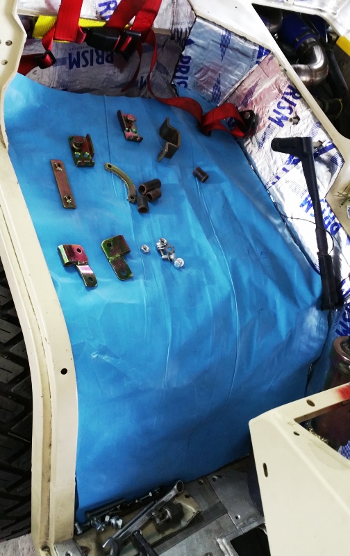

Then we we mounted the cabin. Marked the position of the harness brackets and made up the tubes and welded them to the air cleaner bracket. Bolted down the 4 bolts of the cabin. 8 to go to the rollcage sstill.

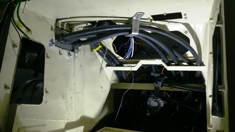

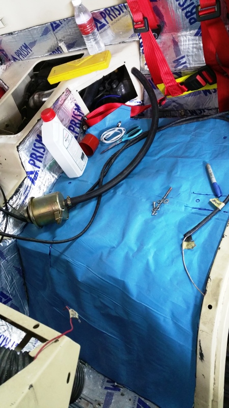

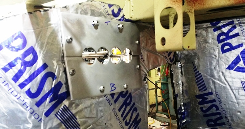

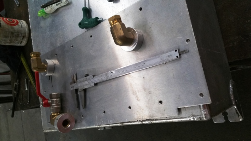

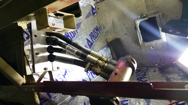

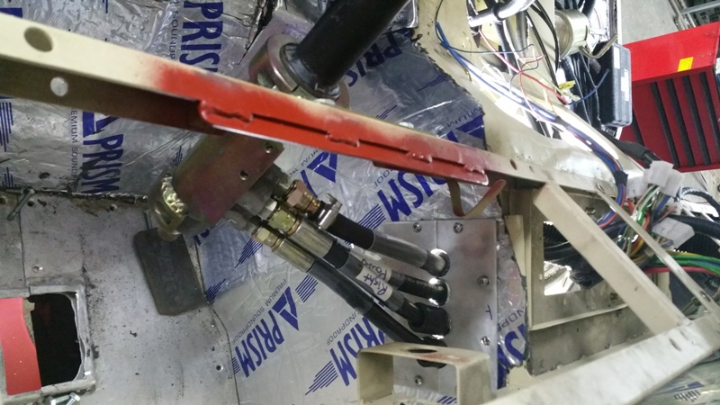

I work on creating the nice entry of the 4 power steering hoses into the cabin LEFT, RIGHT, POWER and RETURN .
Day 1
Remove the brake and booster and the clutch cylinders . We cut and brace the dash.
Cut the hole for the hoses and start the plate from 4mm alloy.
Day 2 then assist with the wiring of the central locking putting the wiring internally in the door frame.

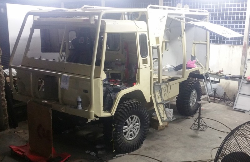

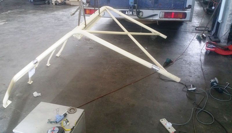

5.15pm we have glued down the rear cabin alloy valance. Day work is over no wait the horse float is out we can get to the front roll cage. Pick it up and install it slowly. The horse float is reversed back in as we finish. The truck is complete no more large parts remain to be bolted down.
The roll cage looks good in the new colours.
The 4 hole plate which is giving me grief

Day 3 of the little rush. Brett takes me down to the hydraulic shop we ercut hoses to length and clamp up the end etc for the power steering. So afternoon I start off labelling the power steering hoses at both ends with clear shrink wrap.
The water tank is ready to be tapped up, However we have decided to make one out of stainless steel instead.
I make a bracket to hold the power steering hoses up high under the cabin
Now it's almost completed.

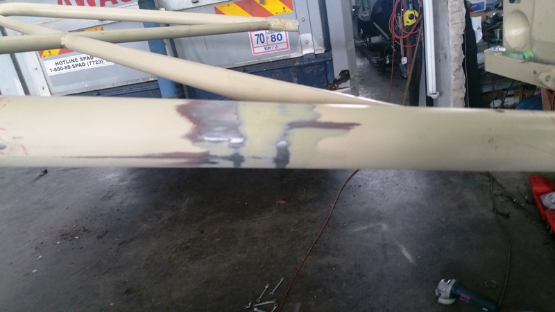

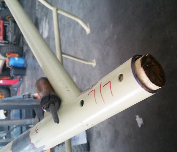

Does not start well a walk in the rain to breakfasst then picked up and taken to the workshop we decide to bolt down the front roll cage. Hmm it will not the top bolts do not line up I confirm with Brett I have to trim 7mm of the right side top and 1mm form the left side due to the welds stopping the tubes sliding in and we also need to clean up the joins they look awful and some scraps and water damage. It's decided off it comes.

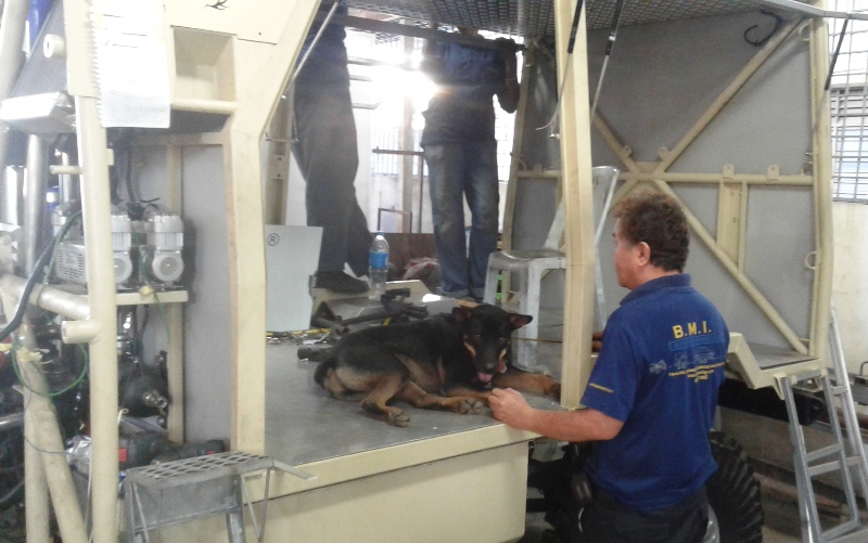

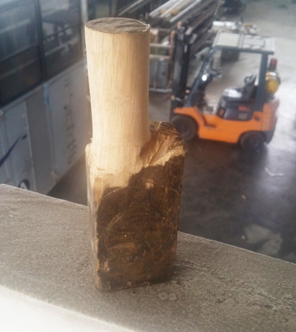

Making the plug to seal the top tubes from a piece of 4*2 that the guard puppy chewed up,
Then fitting with sealant
Then fixing the welds and the grinding mistakes from removing a cross joint gone wrong.

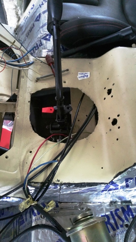

Then we check the gear lever to see if it'ss working. It is but we discover 4 wires we had missed from the loom. Damn!!!!!!!!
Now we have the issue of the ugly hole from some beaver who called themselves a workshop from the previous owner to deal with also this will burn vauable time. The deadline is 5/March/2017 my birthday.
Home time I have the front roll cage sanded, filled and undercoated and repainted it looks smick and I cut the ends off correctly an verify with a vernier ruler. The roll cage fits as I fit it myself with the forklift and a bit of string. It bolts in 10 bolts of the 14. The last 4 well I missed thats 6mm hole with a 8mm thread. Needs to be fixed also.

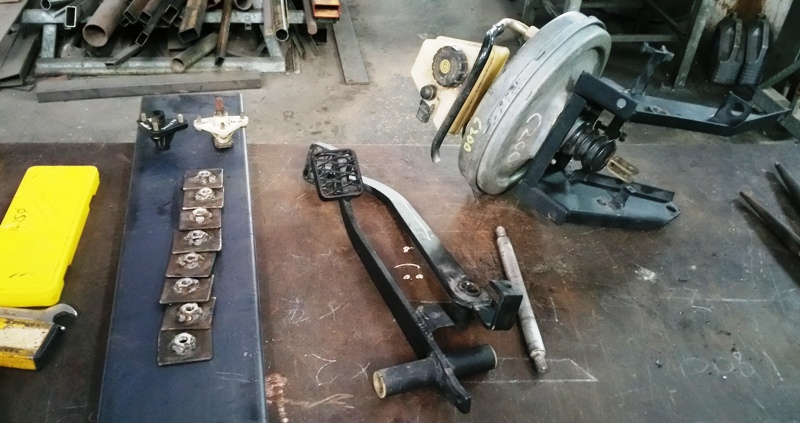

First time for Joe make 8 2" Square plates with a nut attached for the underneath of the seats so there is no chance of seat mount bolts pulling through in an emergency. So guillotine lessonss under strict adult supervision.
My job searching for nutz an bolts and missing wipers part. I fluke the end of the steering lock nut. One WF nut left that we that at the bolt shop by taking the whole steering assembly to the bolt shop.

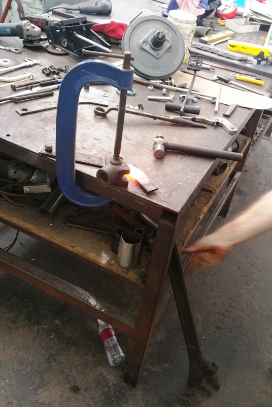

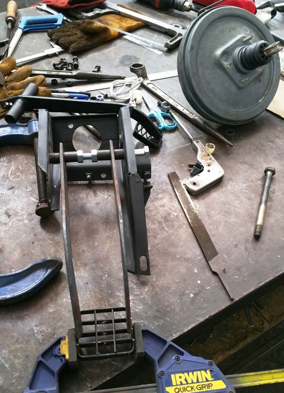

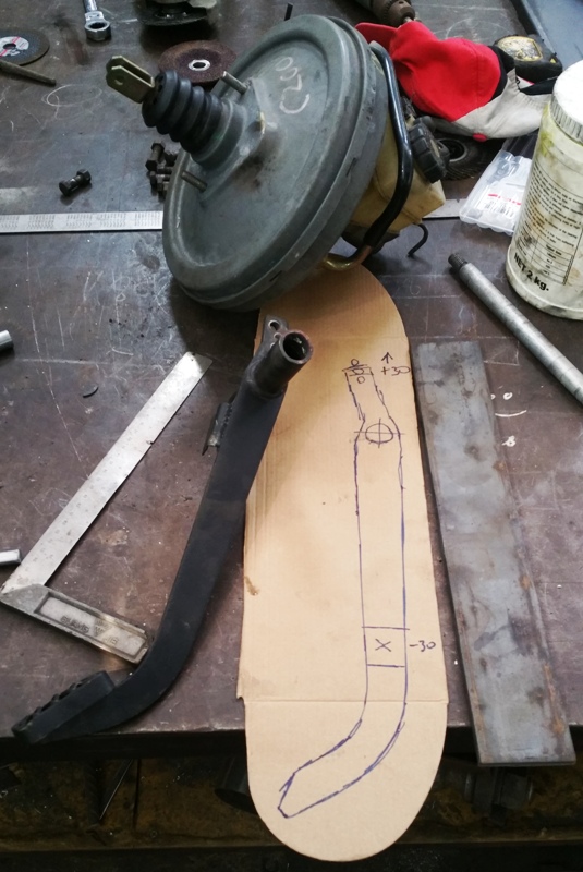

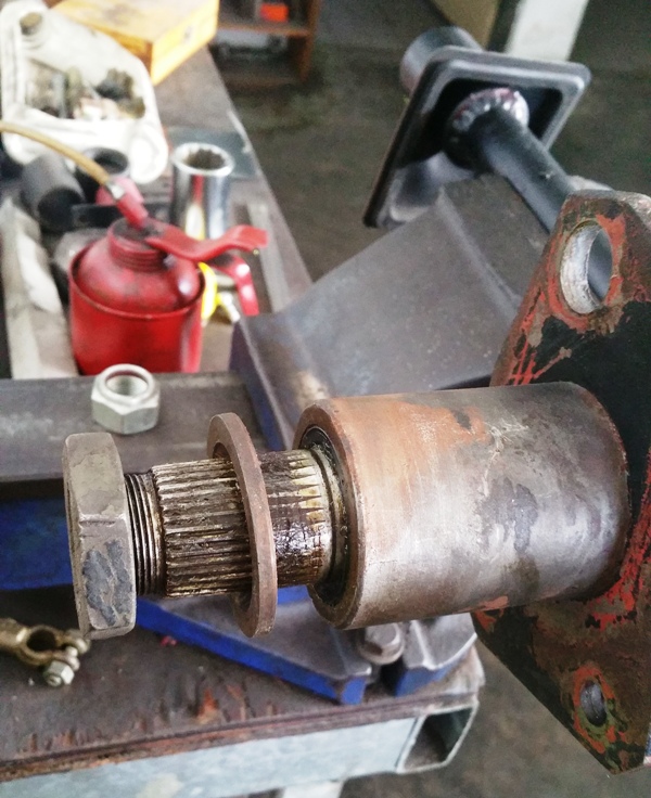

Then its time for the pedal assemby it does not go well. The master cylinder bolt hole does not line up with the brake pedal.
End of the day what do we have pedal assembly not working. Seat bolt down points done without turning on the argon gas damn. Pedal assembly failed. Steering ready waiting for pedals to be installed.
8 January 2017
It's decided after measuring the pedal travel and position etc that the pedal axle needs to be 30mm lower to give 40mm of travel and match up to the lower position of the master cylinder.
The two part pedal is made.
Then I make the bottom of the pedal and the bushes from solid bar and drill them out. They will be welded up Monday as we do not have a long enough 14mm bolt in the workshop but it's now ready to go.
