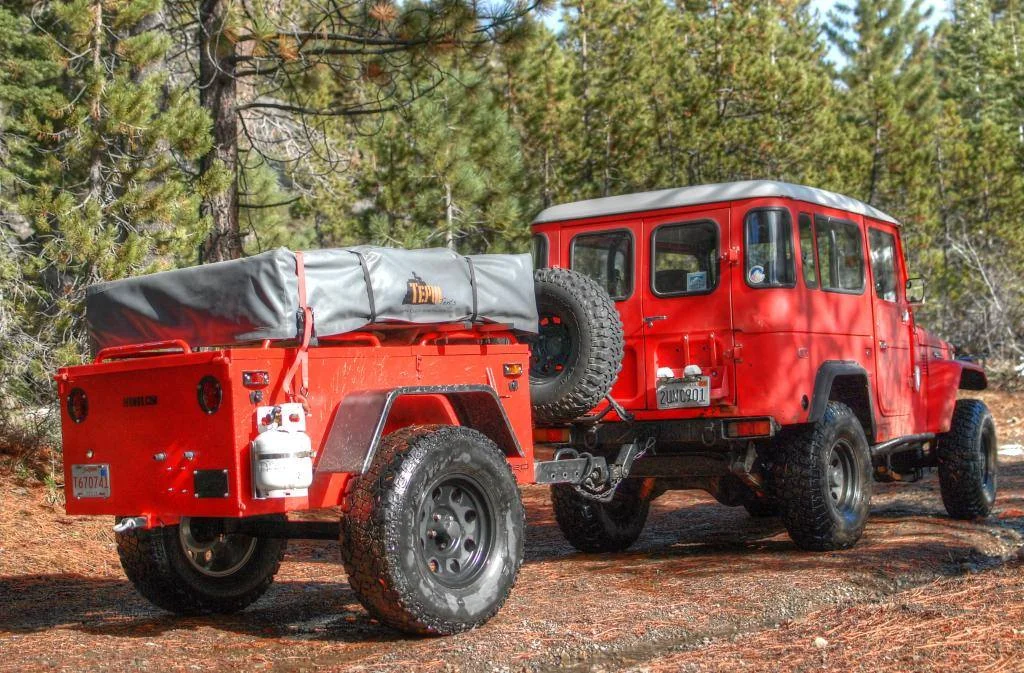

I built my expedition trailer from 2 FJ40 tubs. It is a pop up and features a queen size bed, 21 gallon water tank, dual swing out tire carriers, slide out kitchen and gear storage trays, roof rack, plumbed for hot and cold water at the faucet and propane to the stove and lantern mast. Additional slide out platform for BBQ. Also has a shower, and rotating lunet coupler.
