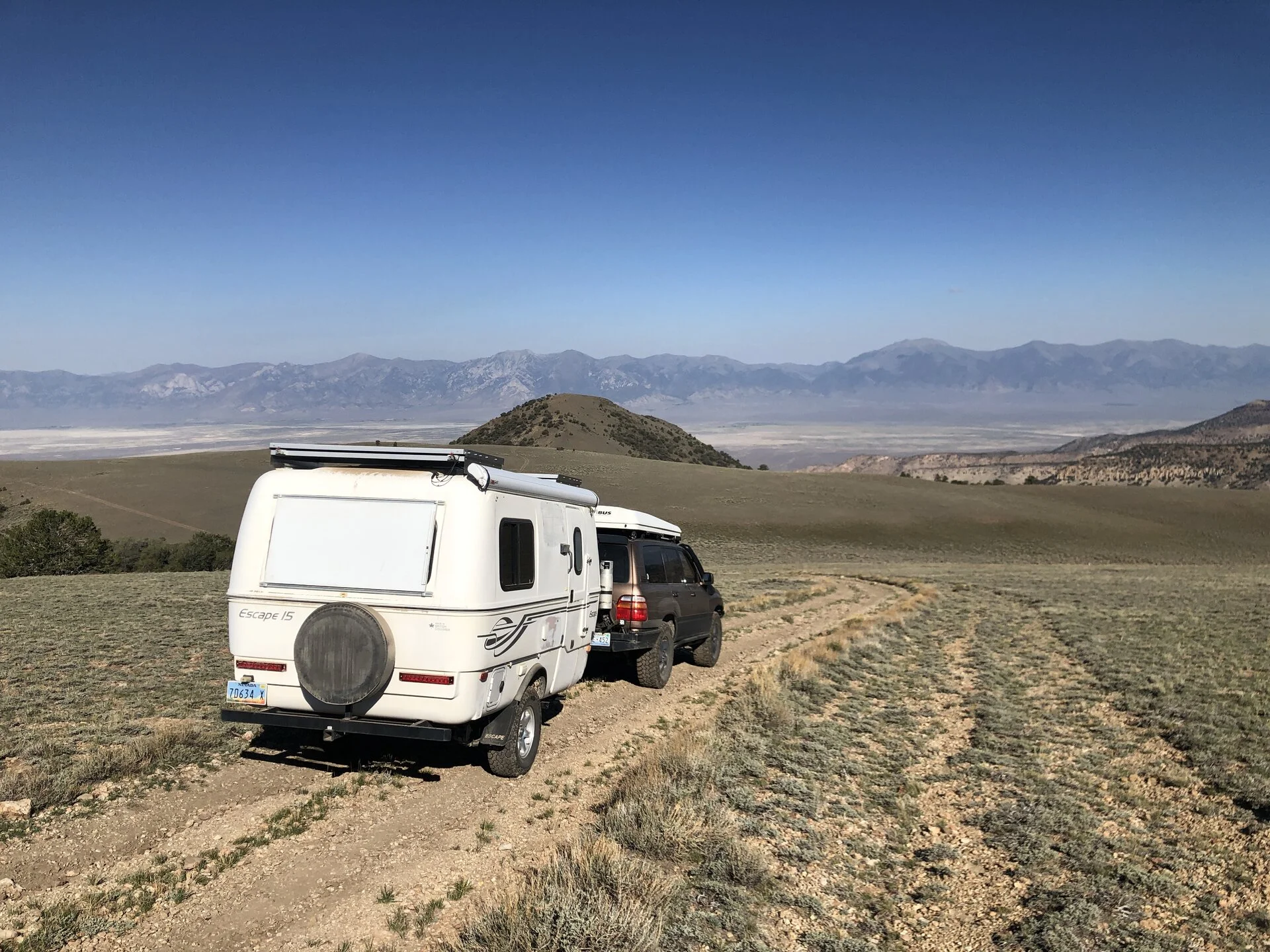

Apart of a short foray out into the middle of Nevada last summer we got to push, er pull, the little Escape 15A a little harder. As you can imagine it certainly has its limitations but given its plusses and minuses, its really nice to be able to have mostly full features and protection from wind & rain.
What size tires did you end up with on the escape?

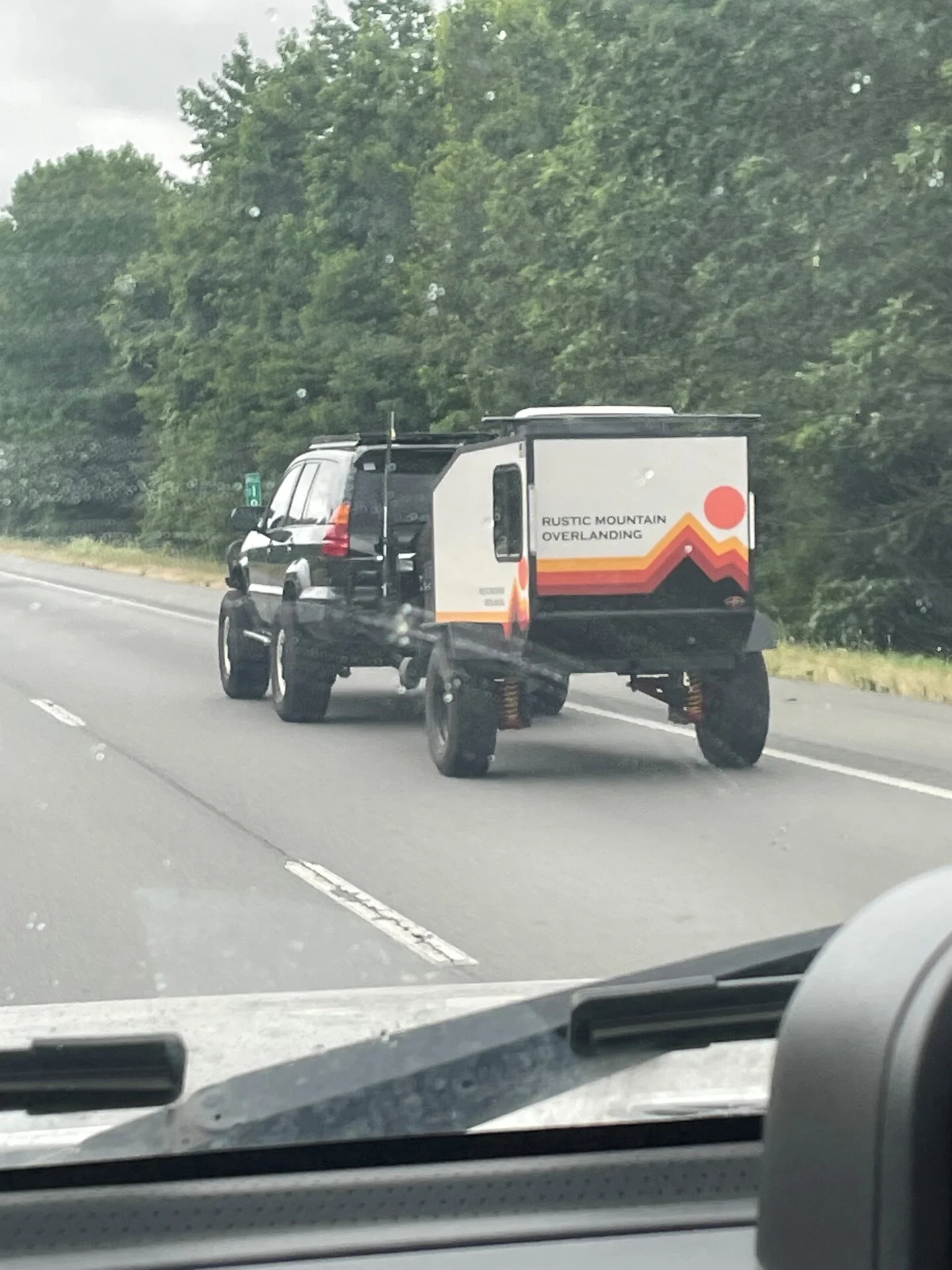

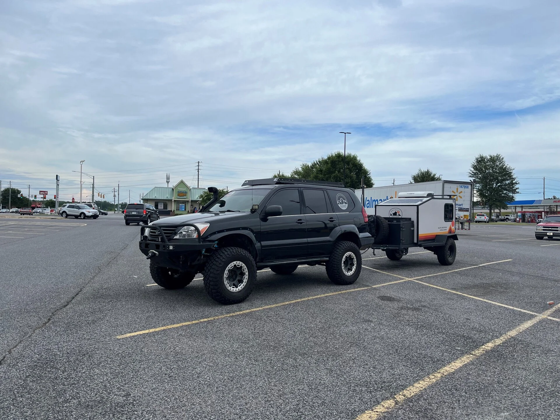

Prototype 2021 Rustic Mountain Overlanding Yakka 48. Based off the frame of the RMO Patrol trailer with Cruiser Master independent suspension and DO35 hitch option. Dometic RTX 1000 12v AC powered off a Renogy 200aH battery, with solar and Redarc charging systems. 46x84 on the interior.
Prototype 2021 Rustic Mountain Overlanding Yakka 48. Based off the frame of the RMO Patrol trailer with Cruiser Master independent suspension and DO35 hitch option. Dometic RTX 1000 12v AC powered off a Renogy 200aH battery, with solar and Redarc charging systems. 46x84 on the interior.View attachment 3275802
I like that. I almost built one very similar before I built mine.
