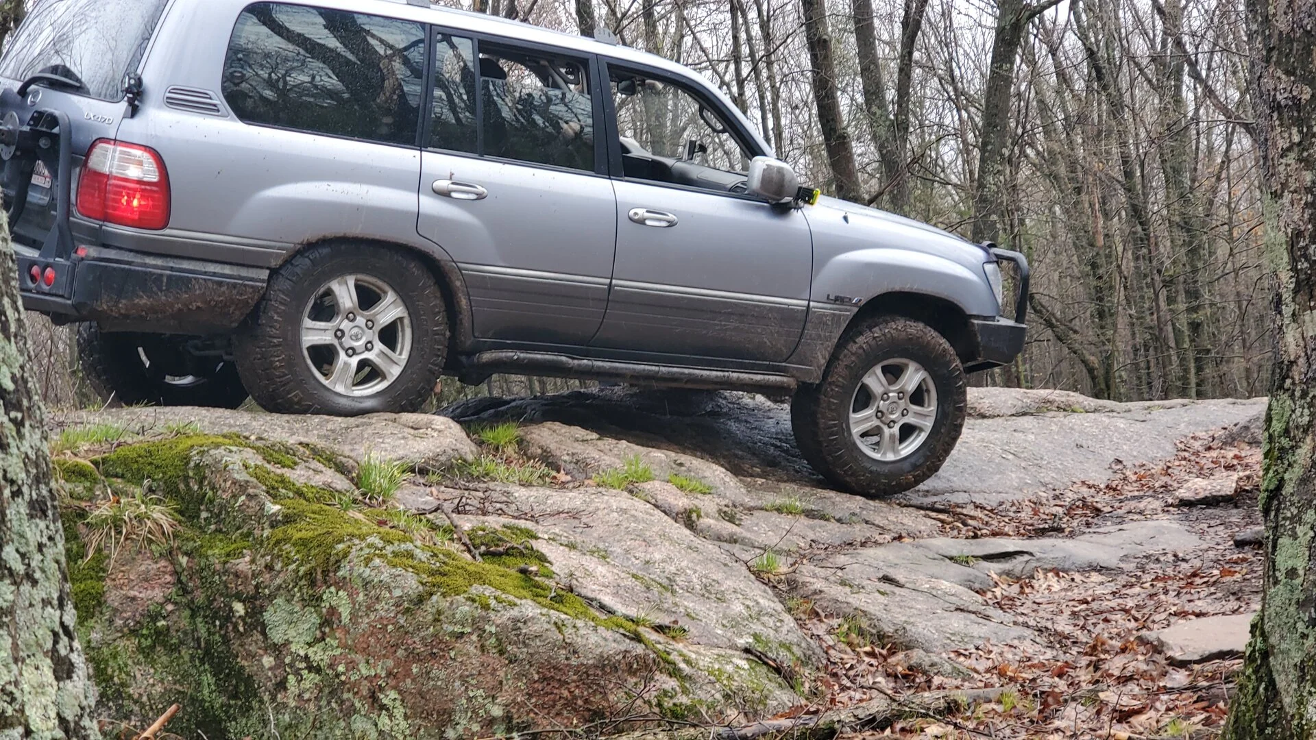

At one point I nearly tipped over the truck on a steep rock. Luckily we stopped just in time and had a friend hang off on the side to act as counter weight while I slowly backed up.

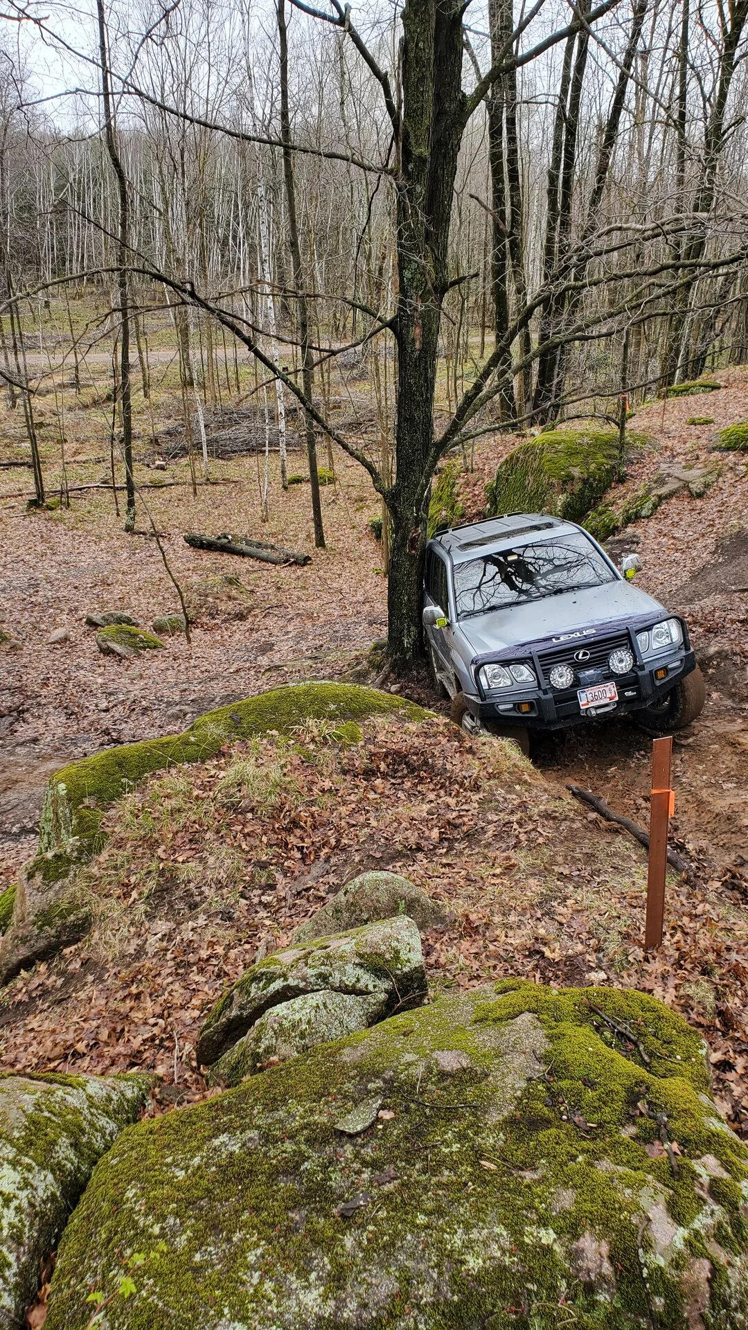

Ended up denting the right rear quarter panel slightly while trying to go up a very muddy and off camber climb. Had a friend pull my truck from the driver side to get me off the tree while I winched myself up!
