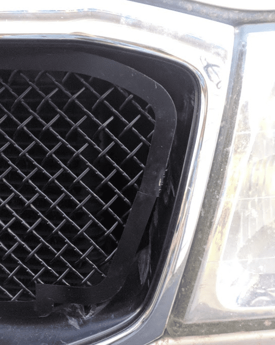

I've got lots more to share and talk about but time is tight at the day job right now, so will address the corners real quick.
YES they look like $h!t right now:
The reasons is that I had envisioned the grill sitting farther back in the plastic trim, which was the profile I tried to match. As I finally had a piece in there though, that wasn't working as well or looking as good so I moved it forward to where you see it. As mentioned in last post I know I have at least 2 iterations of sheet metal before done: I'm 80% of the way there now with this alpha, next beta unit will be 98%, then couple final tiny tweaks and check it again on the production #1 unit. Assuming ti is good then I release for full production.
Remember this is the 'new product development' thread where I share all the ugly secrets of NPD with you, warts and all ;)
Anyone that's seen my KISS Drawers know the quality level I hold myself to and you can rest assured this grill will be no less than my best:rainbow:

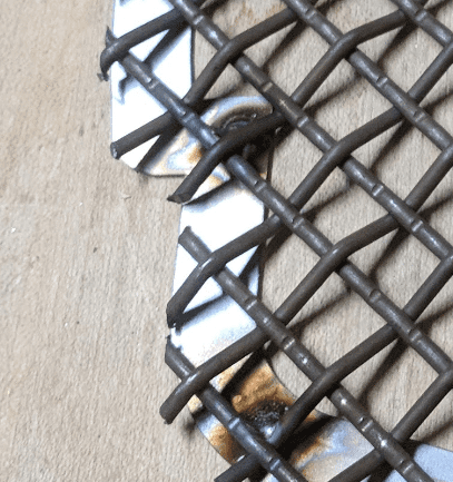

@White Stripe thank you for your opinion, and @ScubaJon answered part of it. I was also asked why it doesn't use a solid wire like @Luke111 posted on page 1, so in the interests of sharing the process with everyone, here y'all go.
THE SURROUND
Short answer: designed for producing at scale
Long answer: When the wire is cut on a plasma table, you can not realistically start every time at the same place in the wire, you start on the sheet. So that means if the mesh had a 90 degree corner it might sometimes be on a place where the wires cross, other times just on one wire, and others it might be in space. What THAT in turn means is that as you cut the profile some places may cut cleanly on a place where the wires cross, and others may cut through them, and on a corner that might mean a piece has nothing to attach to and falls out. Sort of like here on the proto:
Without something to 'trim' the edges it's not going to look very clean with little pieces missing on some and not on others.
(and for those wondering why am I not using fully welded woven wire, where there's a weld at every 'cross', it's because I can't find any in this diamond configuration, just rectangles which looks dumb for a grill)
So what to do for that surround? Before I answer that you also have to think about how you're going to build 20 of them that install the same for every customer, every batch.
One method is as @Luke111 pointed out, a thick wire stock around the edge, with tabs cut and welded on.
That works, for sure on a one-off, but hand welding can be variable, and welder time costs money (I don't weld yet), two strikes against it. Every customer grill from Toyota is the same, so ideally every grill from LSO is the same too, ensuring consistent fit. If a guy is doing that by hand he is either slowing down in a jig he built, bending the wire by hand, and making sure they are consistent (more time = more cost) or he is busting them out to keep time & cost down (but then quality will suffer).
Cutting the surround on a laser and allowing the welder to tack to the back of that allows him freedom to go fast - if he shifts the mesh a little from one to the next it won't impact the final product. This keeps welding cost down, but adds some to the sheet metal - net reduction tho, and better manufacturability & consistency.
Finally, answering @White Stripe, running the surround trim 'flat' would be (within my and my suppliers capabilities) impossible. That plastic is concave. convex, curving, slanting, and generally all over the place. Any attempt to match that with flat stock would involve tons of fitment compromises - I don't even want to contemplate it.
So that leads us to what you see in the alpha proto above, a 1/2" surround. In the next, 'the beta', I plan to go from 1/2" to 1/4" wide but increase the sheet metal thickness several steps to maintain rigidity and reduce warping during welding (offset by manually bending back into position = more labor cost). We'll see how that looks and decide thin or thick.
So there you go, some of the design considerations being balanced by the manufacturing and cost considerations, as I promised I would share with you.
