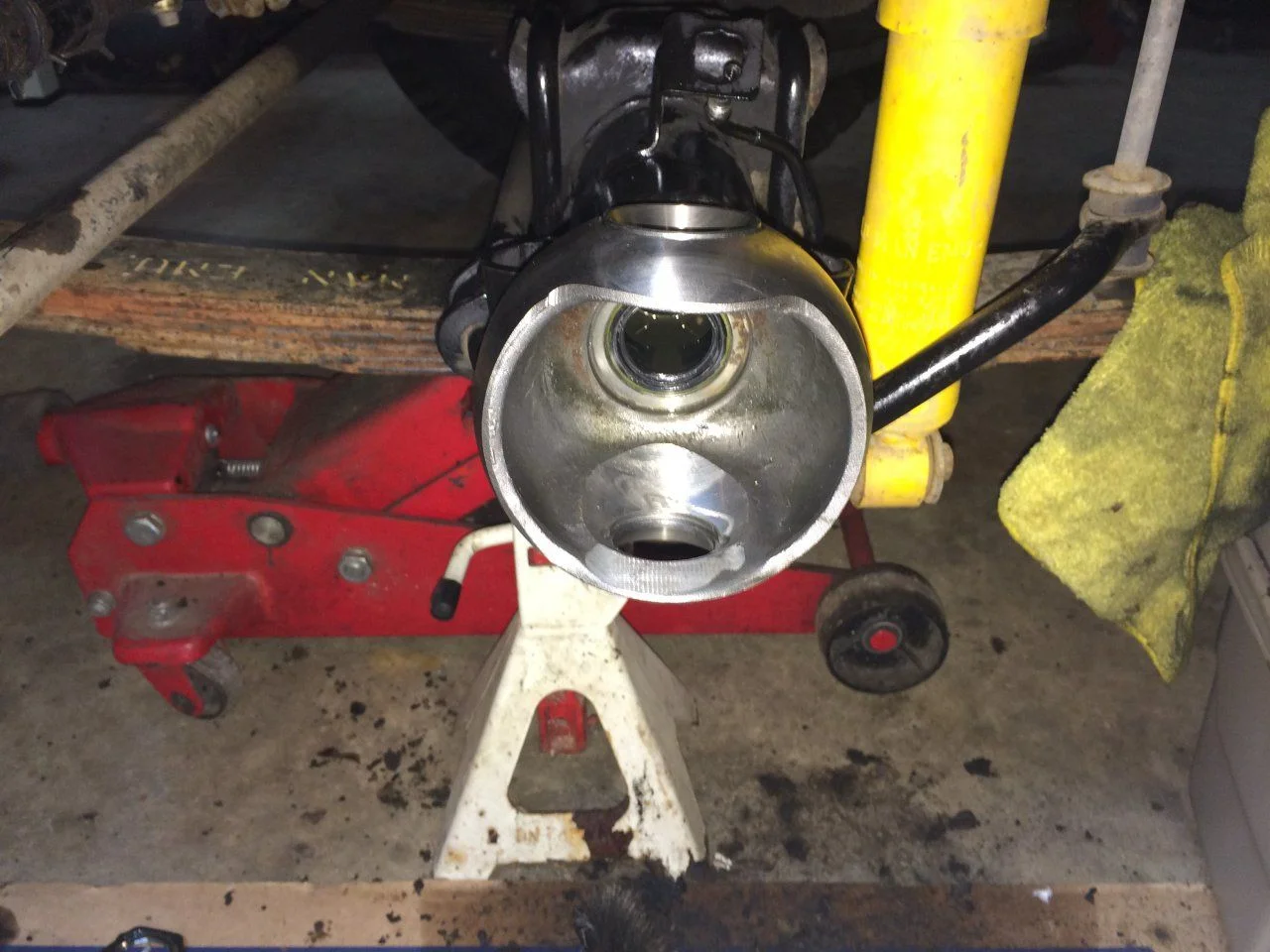

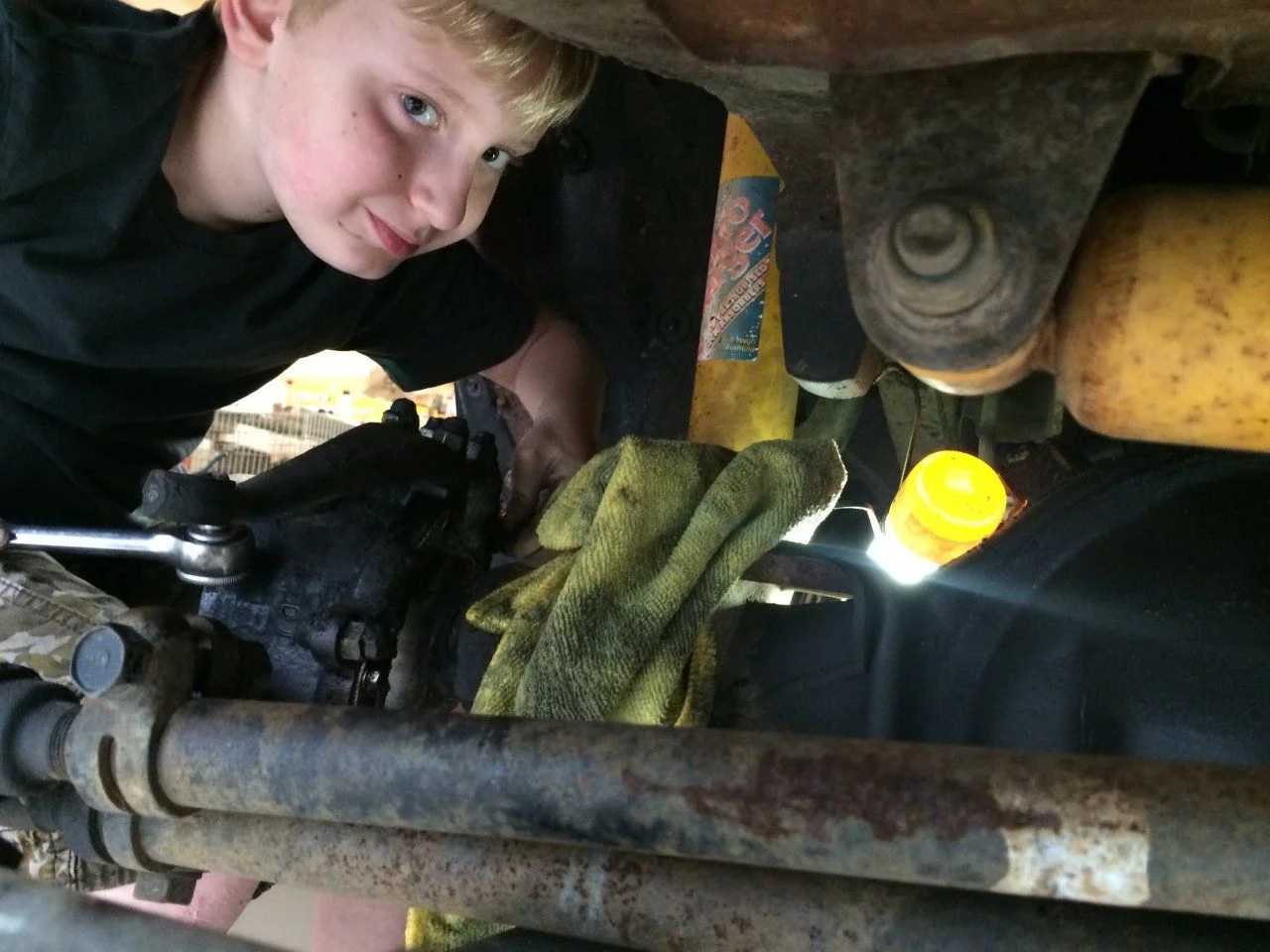

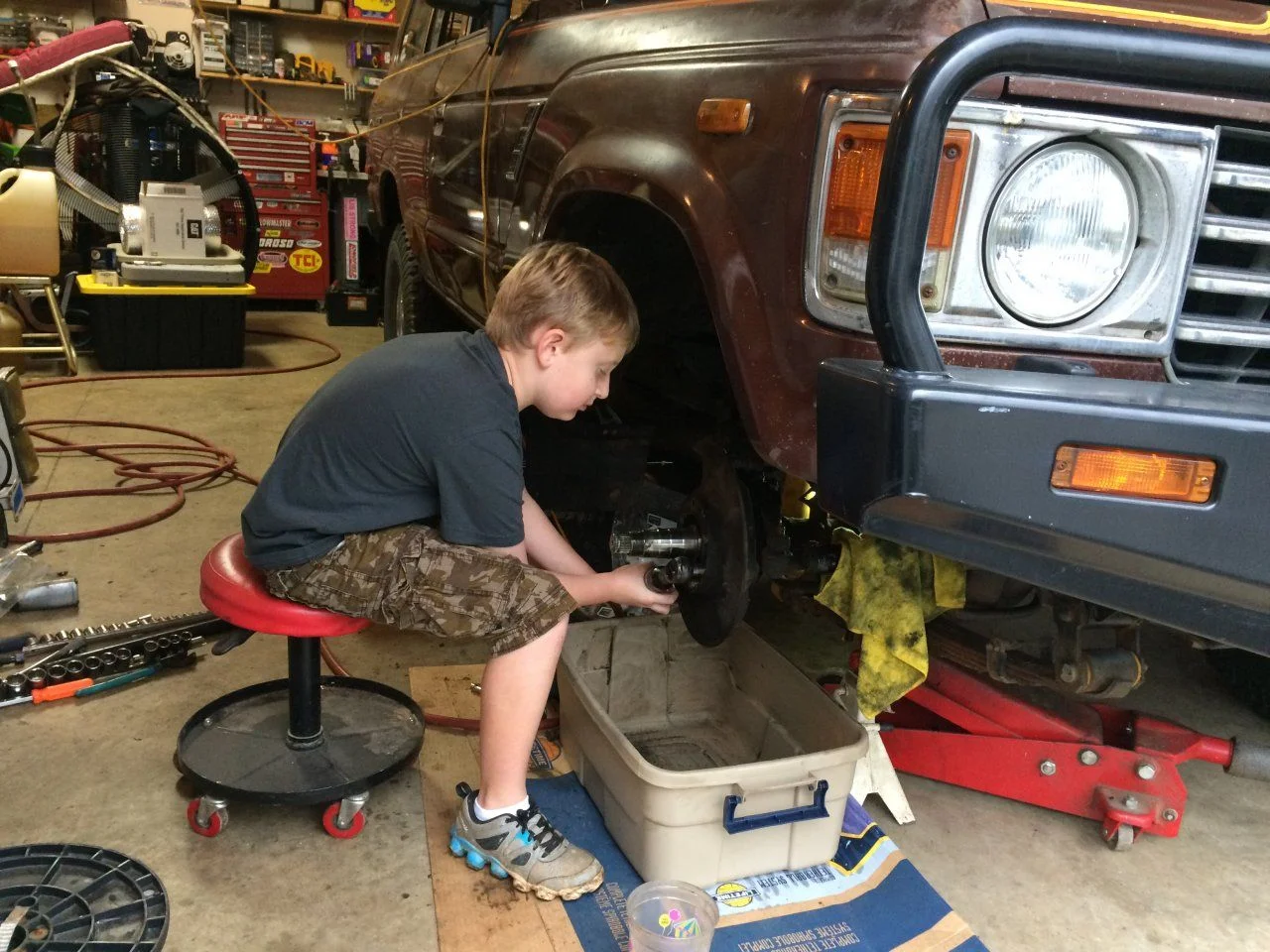

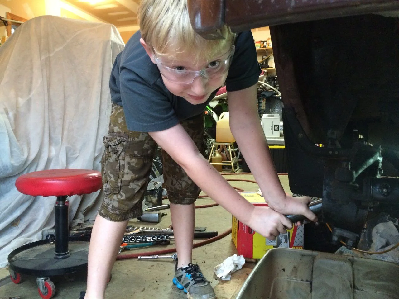

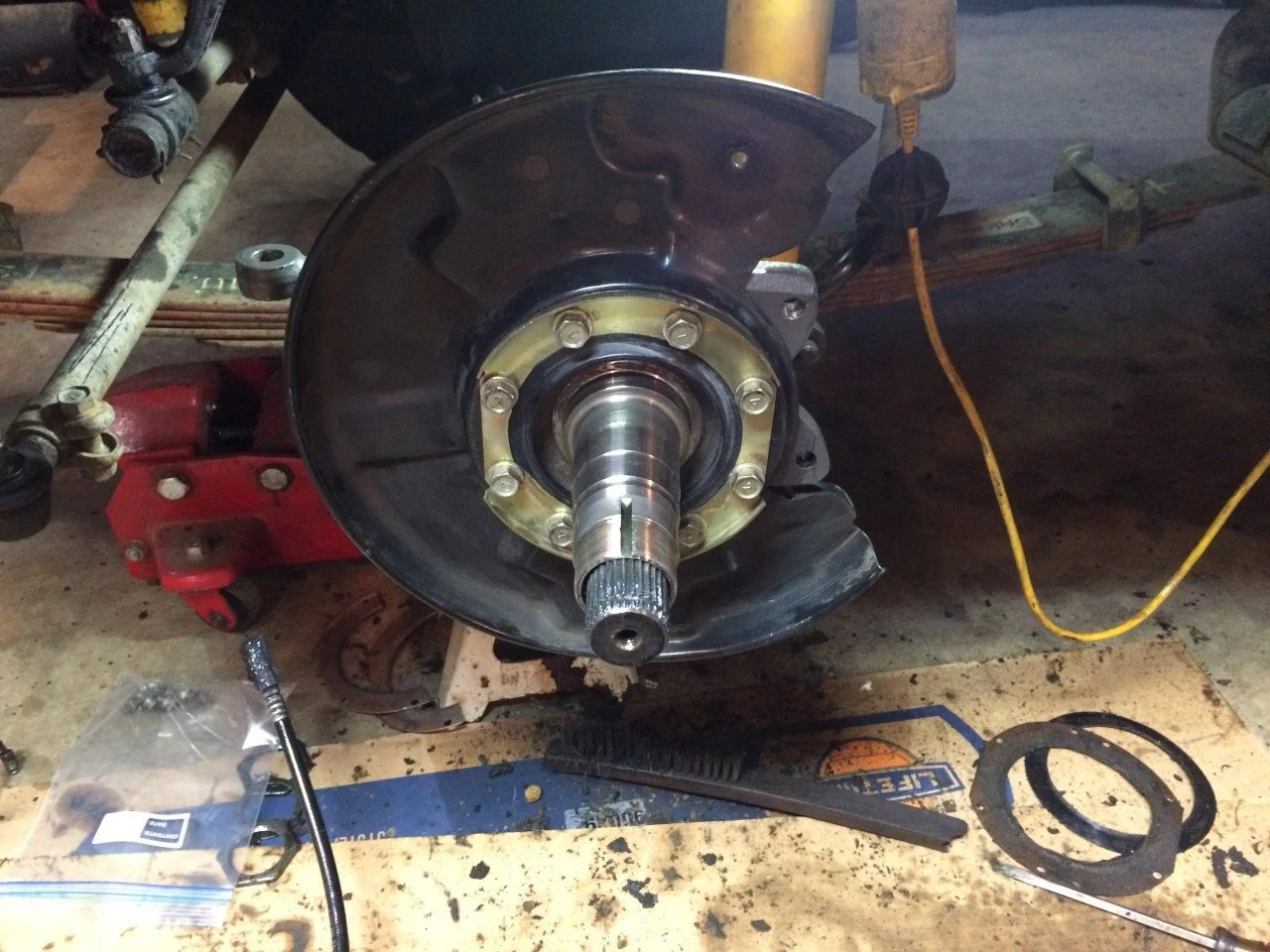

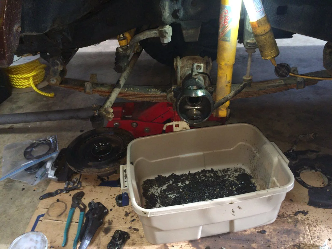

The Turdle got fresh knuckles over the holidays. My son, Nathan assisted me. I found all the bearings to be in good shape (but replaced them anyway) however, the inner seals were leaking very badly and the slurry of goo inside the knuckles and hubs was phenomenal. Hopefully these new seals will keep things clean going forward.
I have an iphone video of Nathan pulling the short side axle out but Mud does not recognize a .mov file. Not sure how to convert it. It was nice just sitting back and letting Nate do the grunt work. I'm definitely looking forward to more supervision and less actual work in the years to come!

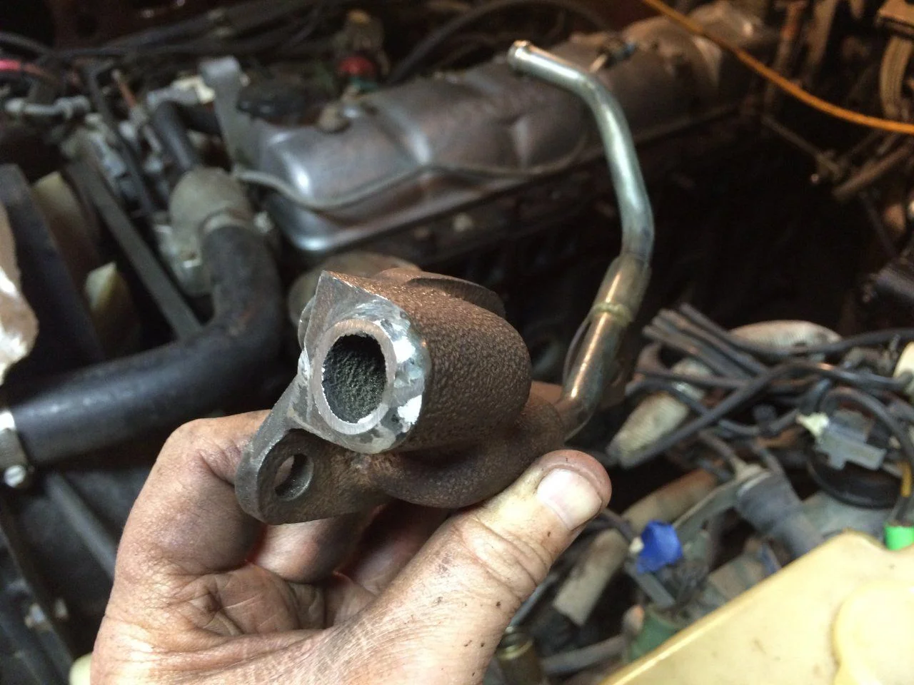

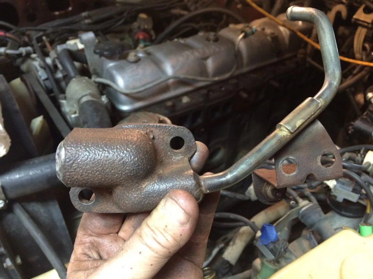

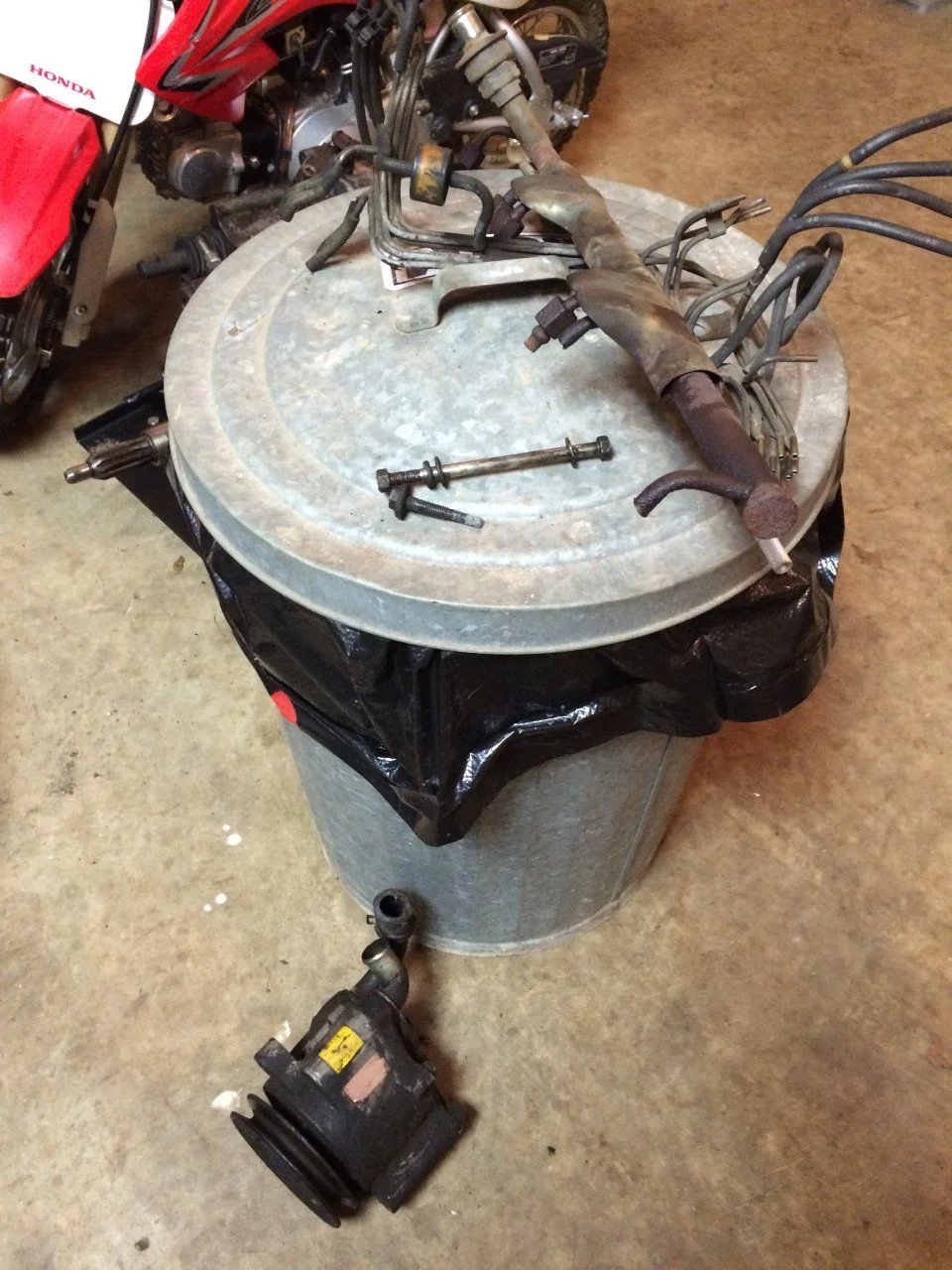

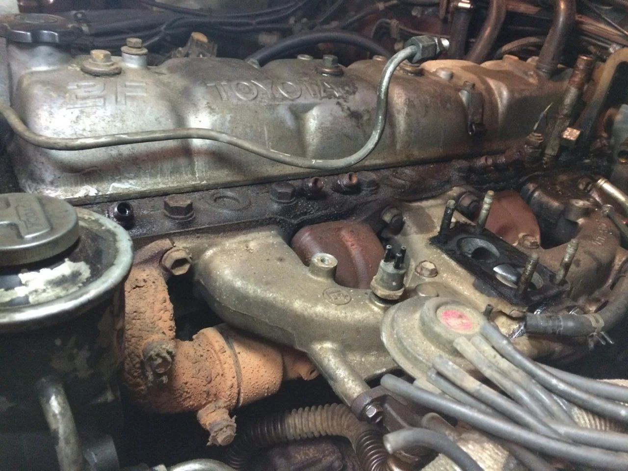

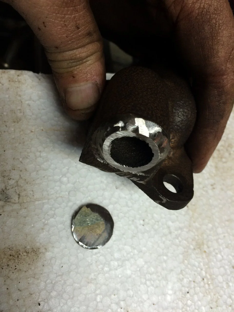

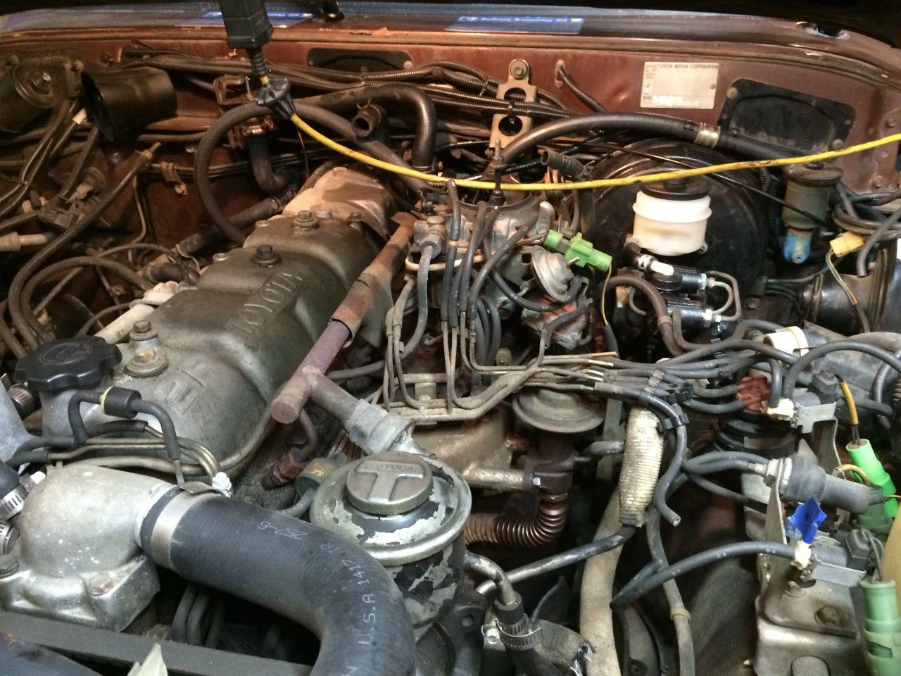

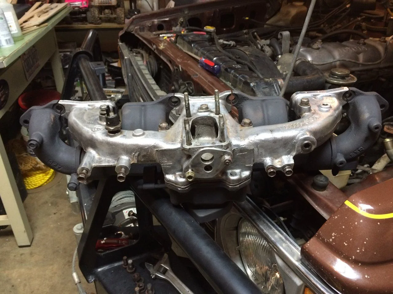

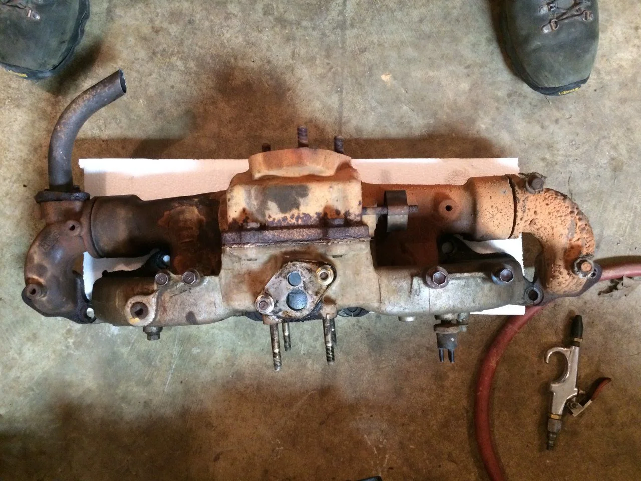

I am attempting a desmog on the Turdle. There was an exhaust leak where the EGR tube meets up to the exhaust manifold which made an annoying ticking sound. Also, the truck was running lean and had a tendency to cut off at stoplights. I determined that there was a leak at the intake/exhaust gasket where it meets with the head. Having to pull the manifolds to fix these issues, it only made sense to go ahead and de-smog at the same time. I think it was a good decision. I doubt if I could have removed the EGR components without destroying them anyway. Here are a few pics of what I've done so far:
