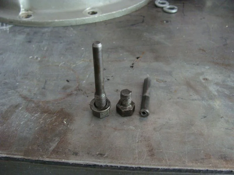

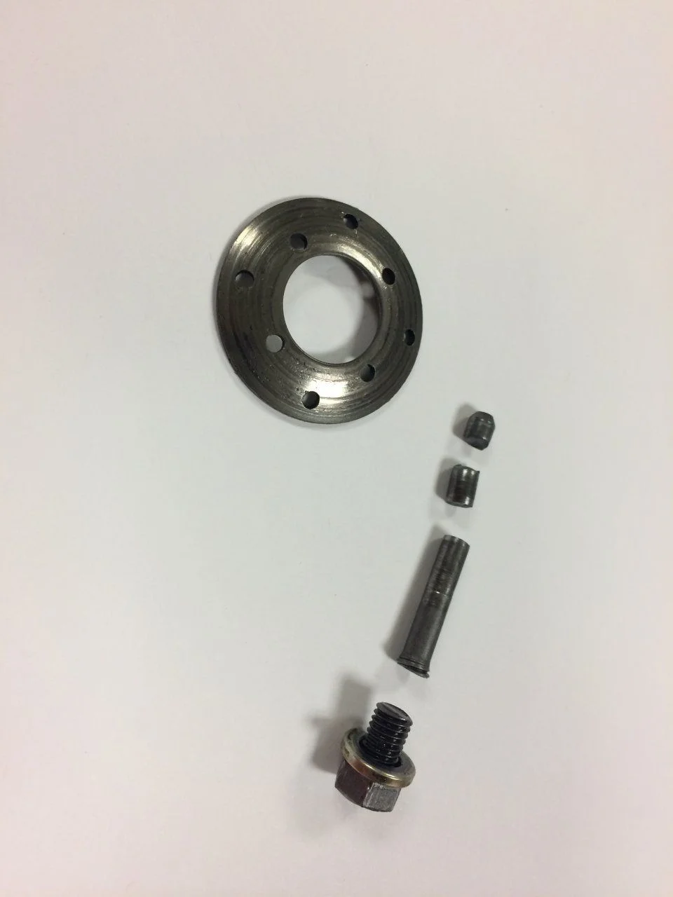

I've replaced both the brake master cylinder and the booster on the Turdle. Before testing it out I decided to give the front brake pads a check to make sure they still had some life. They were down to 1/16th! I also found that the inside of the backing plates on both sides were covered with gear oil. It looks like a knuckle rebuild is in my immediate future. This truck is just full of surprises... Another kick in the teeth came when I pulled the rear drums again just to make sure there were no leaks there after unclogging the vent tube. Rear passenger caliper is leaking just a smidge and the driver's side axle seal is still weeping. Over the past couple of weeks I have been collecting parts for a knuckle rebuild as well as for a refresh of my rear axle seals, brake cylinders and shoes. I finally got everything together and last night began the task of freshening up the rear end. To re-do the seals, you have to pull the diff cover and pull the C-clips in order to pull the axle shafts and backing plates to allow access. Things were going great last night until the Ninja Turdle smacked me down with another mighty blow. The pin that locates the cross shaft for the spider gears was broken off inside the carrier. Ugh! After about two hours of pain, suffering, cursing and overall disgust, here's what I ended up with.
Four pieces! The damn pin was broken in four pieces. When I pulled the cross shaft and spiders out I found only one of the spiders had the shim behind it. The other one was MIA. The extra slop due to the missing shim is probably what shattered the pin but you know what? It drove just fine. No strange noises or anything. The spider gears don't see a whole lot of action anyway unless you do a peg-legged burnout or spin one tire really hard in the mud while the other is still. I'm going to ride by the local Toy store and see if I can get another pin and another bushing. This truck is killing me...and I still haven't run a full tank of gas through it.

Sucks that the pin was shattered. Missing a thrust washer on the spider would allow the axle shaft to move a bit more, which may be contributing to your seal leakage.
Johnny, I know the spiders do come into play when you make a turn but my assumption is that they don't have to spin very fast in that situation. They are mostly just rotating slowly back and forth and not under a huge amount of stress. I'm impressed that there was not alot of wear with that thrust washer missing. The amount of particles in the bottom of the diff and on the drain plug magnet was in the range of what I would consider "normal." Glad I found it before it got bad.

Thanks, Jim but I've got it all buttoned back up now. I got a new pin from Toyota and a thrust washer cup from SOR. Fishing out all those broken pieces was a huge PITA. I have had to put the Turdle on hold for a few days. The Crockpot had a busted radiator (which I just replaced) and my wife's LX470 needs brakes next. After that I'm going to do the knuckles and front brakes on the Turdle. Hopefully then I'll get some windshield time. So far I've only logged 178 miles on it and I bought it back in July!
