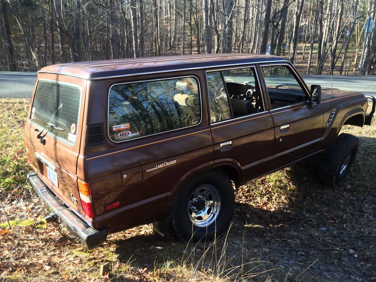

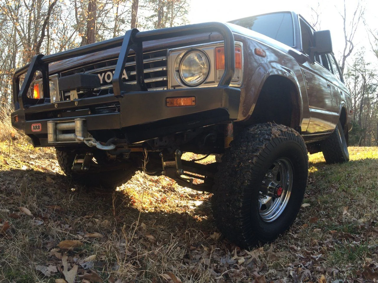

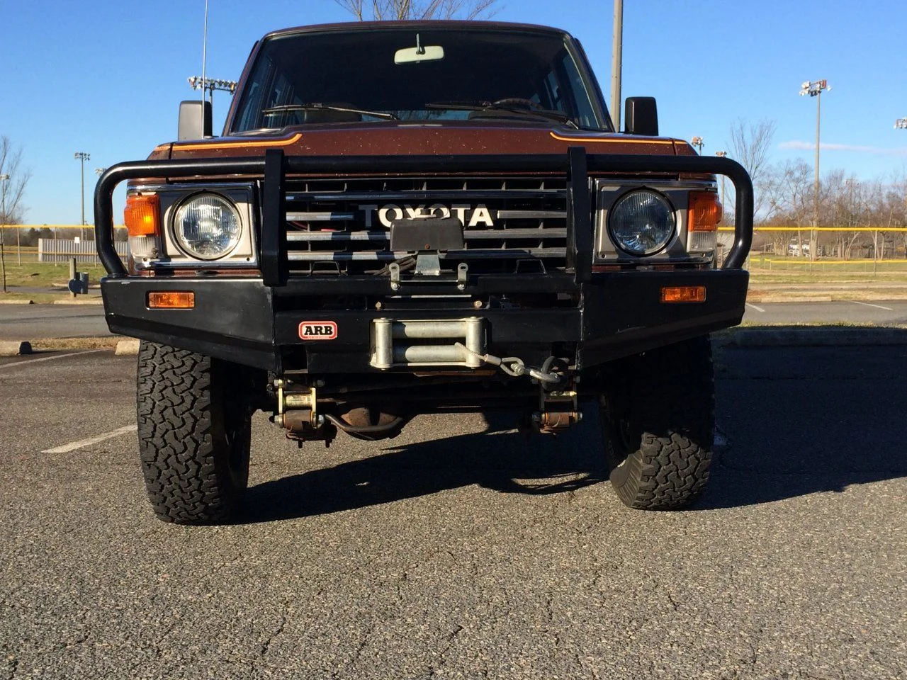

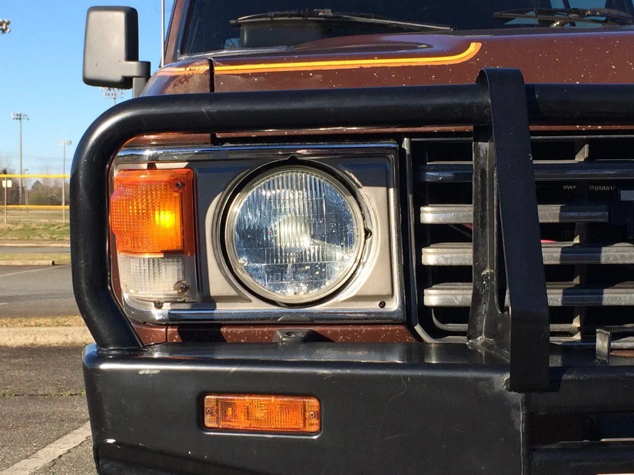

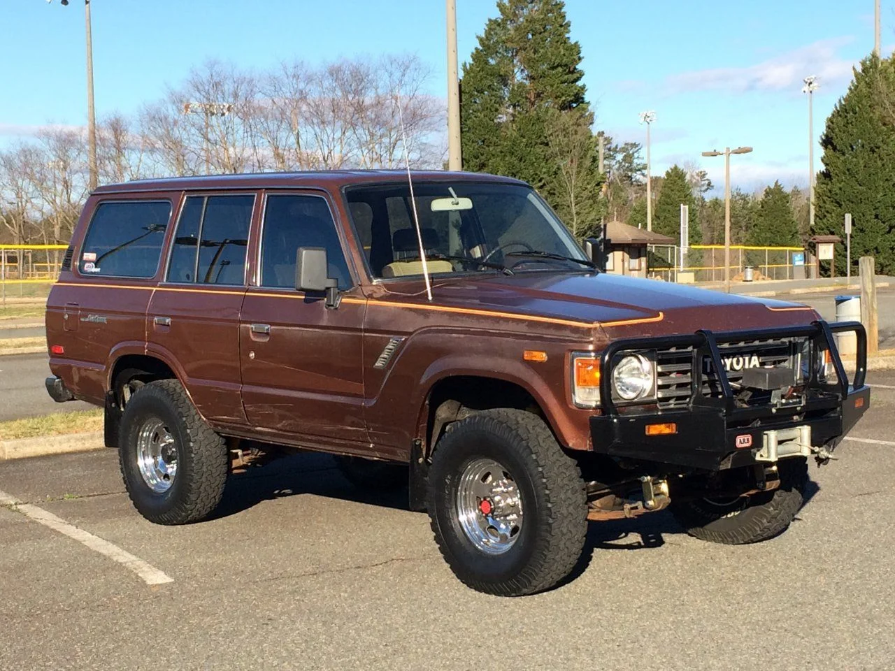

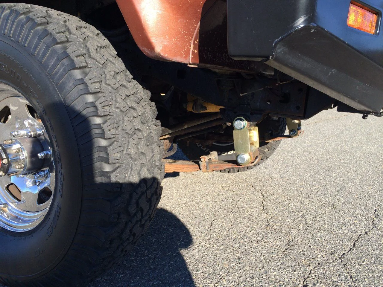

The Turdle always had the stinkbug look. In an effort to level things out a bit I replaced the OEM front shackles with a set of slightly longer ones from CCOT. Here are a couple of pics as she sits now. Also, I added a couple of pics of the newly-painted headlight bezels.
Turdle poser ditch flex:

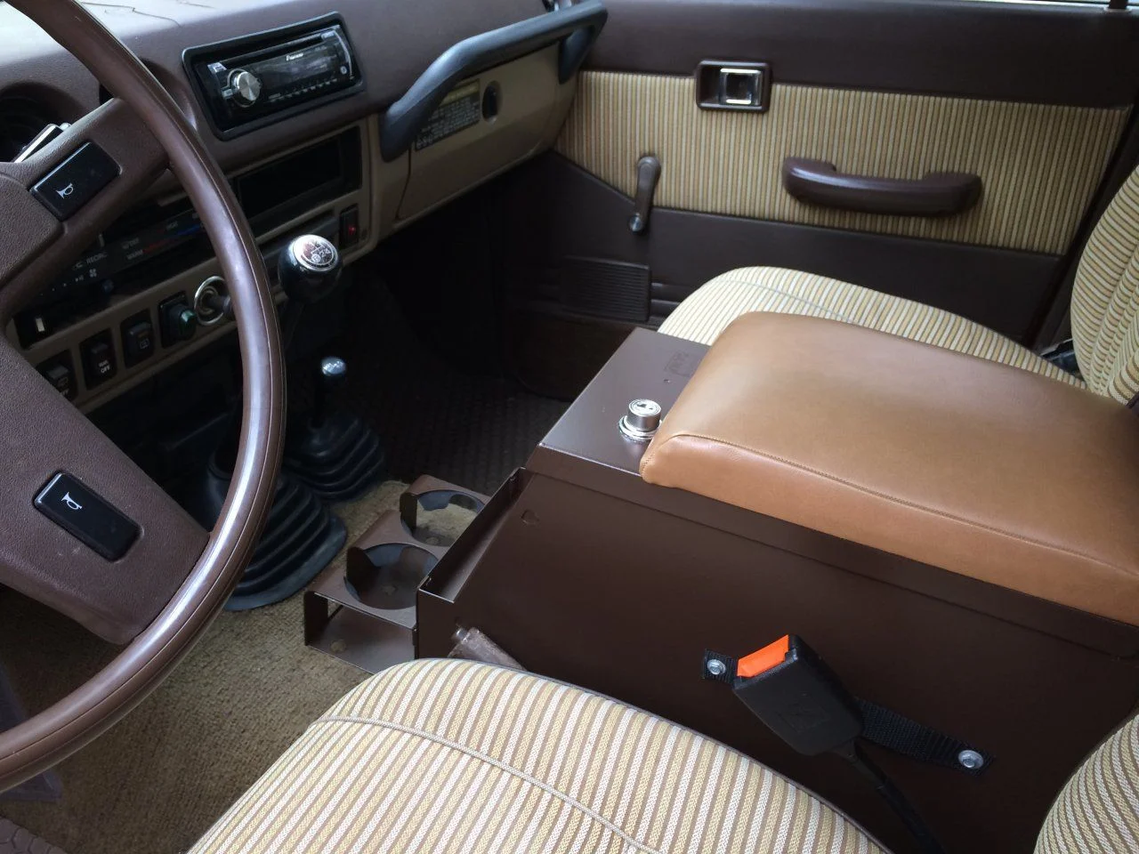

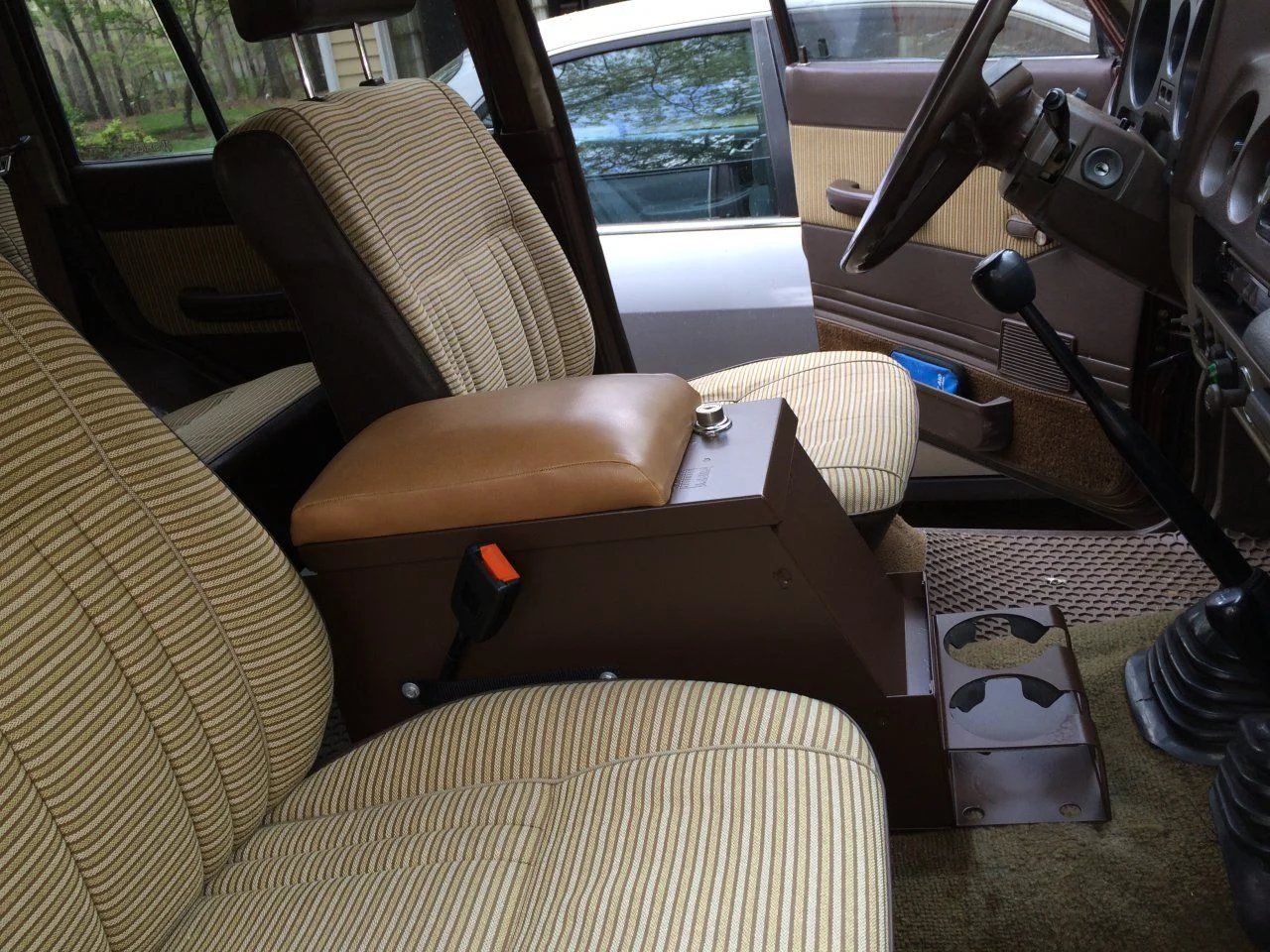

This week I decided to do something about the mismatched Tuffy console. The standard tan Tuffy color is a caramel color. The majority of the Turdle's interior is either dark brown or tan so the console really stuck out like a sore thumb. Here's what it looked like before:
Thanks to my friend George @joyRidaz for suggesting that I try this paint for my console re-do:
After stripping the hardware off the Tuffy and a quick scuff and clean up, I shot it with the rattle can brown. Here's what it looks like now:
My OCD likes the new color much better! One of these days I will have to do something about the cracked dash. It never ends....
Yeah, I'm going to copy that too. The last one I tried wasn't very close of a match :lol:
Looks great, and not amazingly that color interior from the 80s is coming back, seeing more and more on high end European flighty cars.

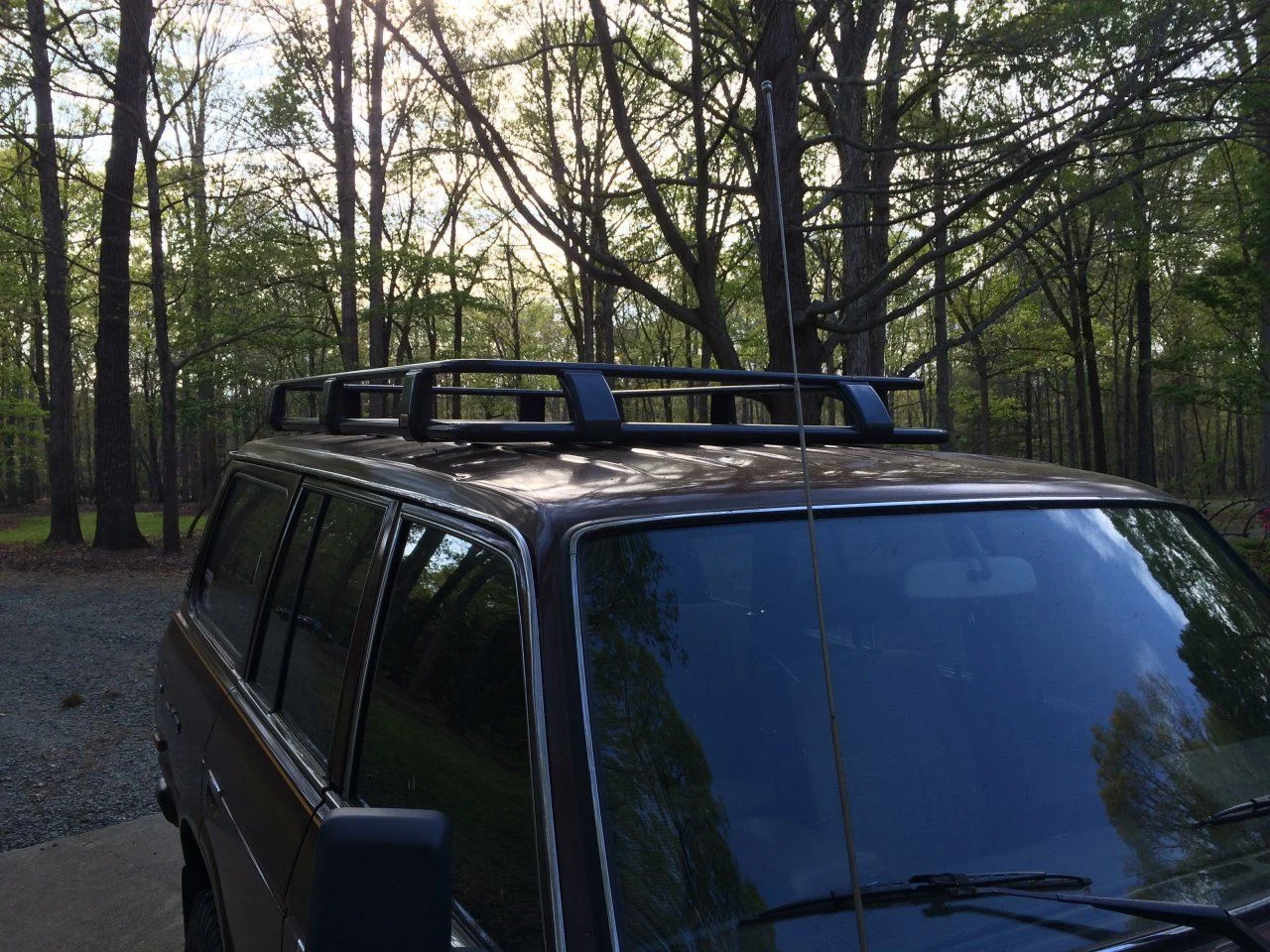

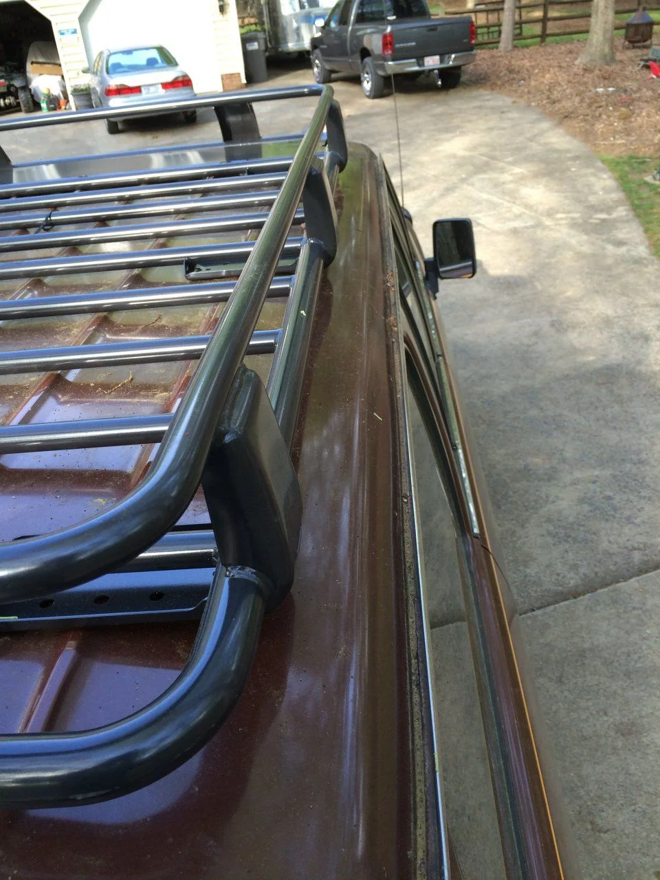

I've been wanting to install a roof rack on the Turd from day one. My buddy Eric @forrest5000 just happened to have an ARB rack or two...or five for sale. Problem is the racks he has are for the 100 series 'cruiser. They are quite a bit narrower than the typical rack for the 60/80 series. I have seen a roof rack completely ripped off the top of a 60 on the trails. If the rack is as wide as the truck and if you are in a tight off-camber position the rack becomes very vulnerable to side and rear corner impact from trees leaning into the trail. My thinking is that running a narrower rack would partially eliminate this problem (with the exception of the brackets). I told Eric I would give the 100 series ARB a try to see what it would look like and to see if I could get it to fit the 60. I knew some bracket fab would be in order. I just laid the rack on top (no brackets) to see how it was going to look.
I bet you could buy some from Trail Taylor, @reevesci, or maybe Gamiviti.
I did buy six gutter clamps from Trail Tailor @reevesci. Beautiful pieces by the way. I decided not to have him make a custom set of longer clamps to reach over to the narrow rack. Instead I am planning on fabbing some extension brackets to make up the extra couple of inches. I'll post pics as I get that part done.

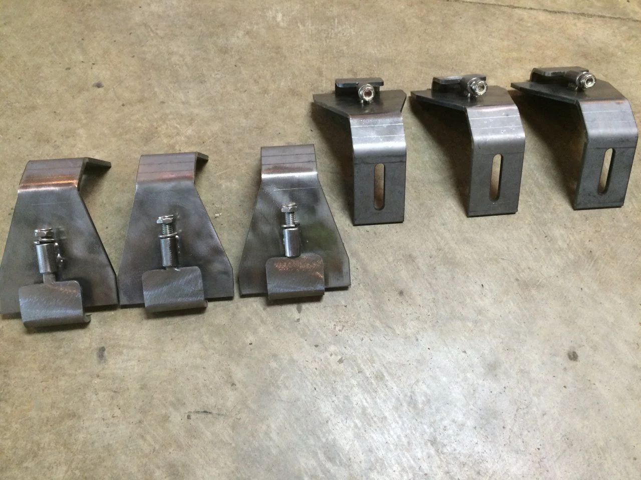

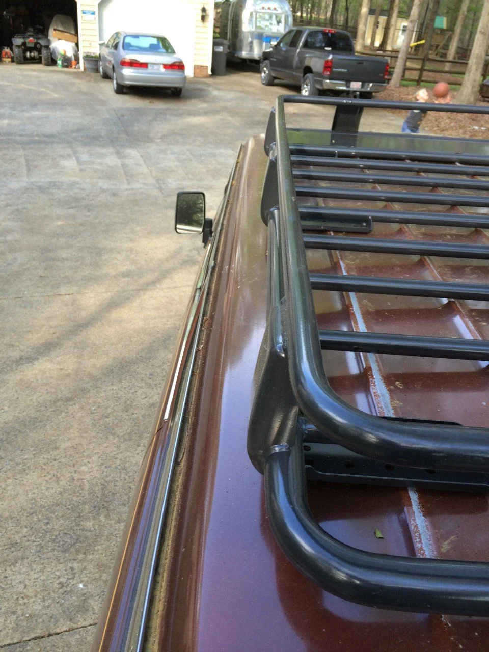

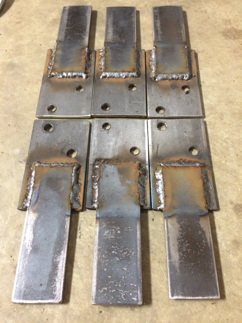

Last night I welded up the extension brackets to mount the ARB rack. As I mentioned earlier, I purchased six gutter clamps from Trail Tailor. These brackets I made will extend from the TT clamps toward the center of the truck to the narrow 100 series ARB rack.
The TT Clamps are very sturdy and well made.
My extension brackets consist of a piece of 3" flat stock drilled to mount to the bottom of the ARB, welded to a piece of 2" flat stock that will extend over and pick up the TT clamp.
Here's how my extensions will meet up with the TT clamp.

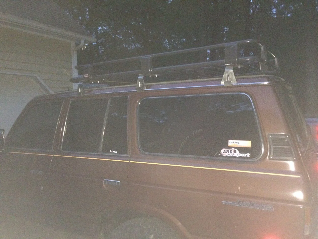

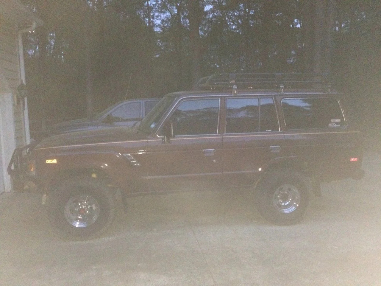

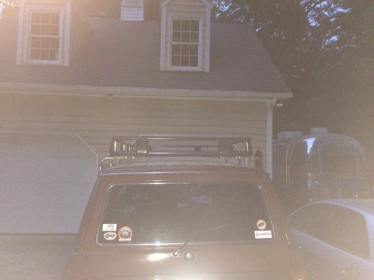

I mounted the clamps on the gutters of the Turd and mounted my extensions on the rack. Sat the rack up on the clamps to see how everything will work out. It got late. My pics were taken in the dark so they are not great. I'll post more later. It looks like I need to trim about an inch from each extension. Then I will drill the extensions to accept a bolt and nut to attach to the TT clamps. I plan to prime and paint the clamps and extensions. I am thinking of plasti-dipping the clamp mounting points (using the type of plasti-dip that you dip tool handles in) to keep them from scratching the paint on the gutters.
Turned out well Dave :beer:
Cut fuel tubing in half for under the feet?
I like that idea, Stan. A whole lot easier than Plasti-dip!
