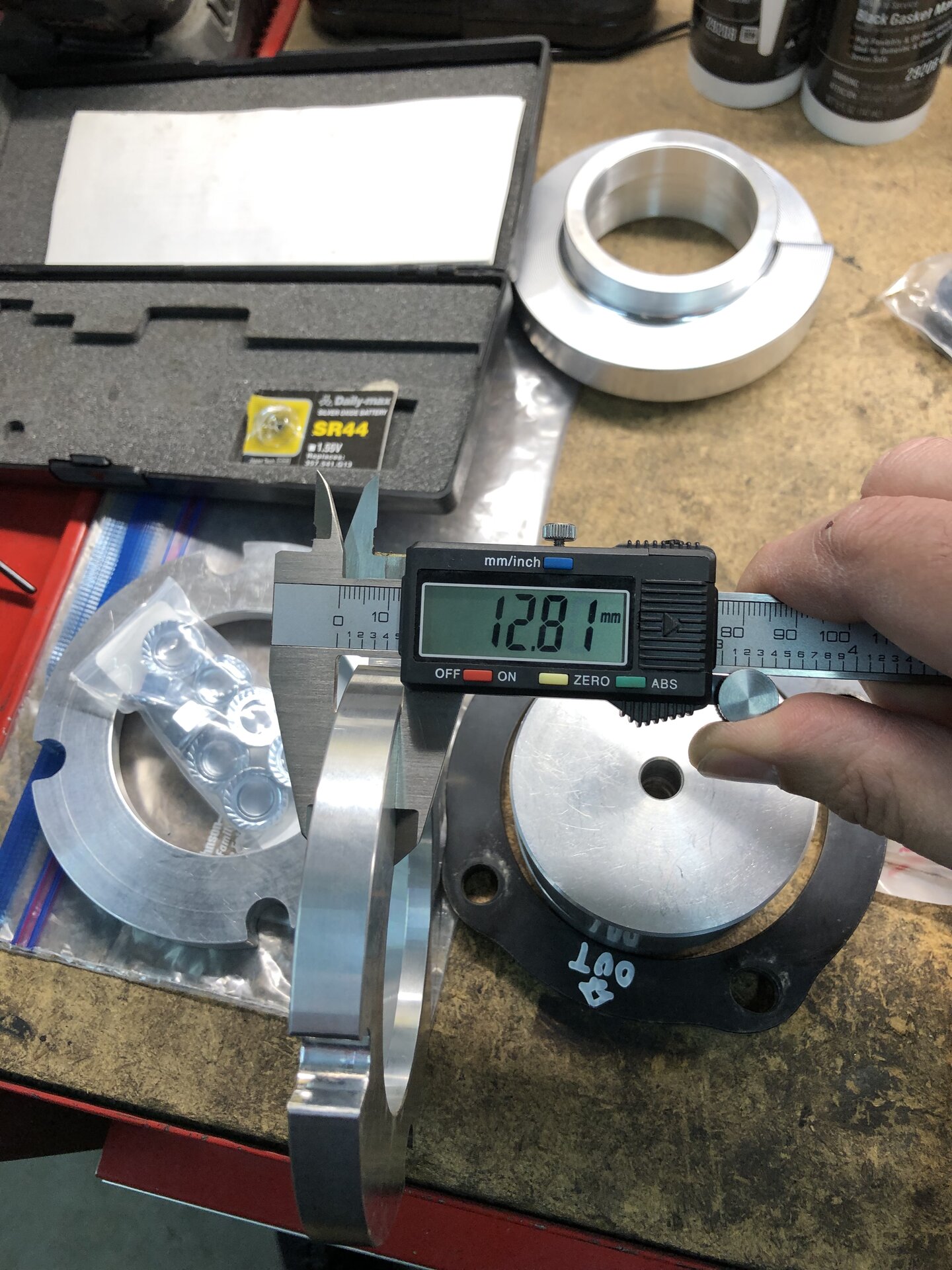

- Preload - in regards to AHC, both in coil and above coil spacers are going to contribute to pre-load of the coil spring. That's because neutral height is governed by the AHC system rather than falling on the coilovers to find equilibrium.
- It's kind of...interesting that the Wescott above coil spacer is not solid? I'm not sure the stud mount is designed for play there. You'll get some weird noises through the chassis as the stud threads saw against the bucket mount if it's allowed to compress there. I would mount it tightly and not assume it should compress.
This is the only Westcott above coil spacer in the kit I received. Solid aluminum…
Or are you referring to the fact that it doesn’t extend around the outside of the studs but stays floating around inside them?

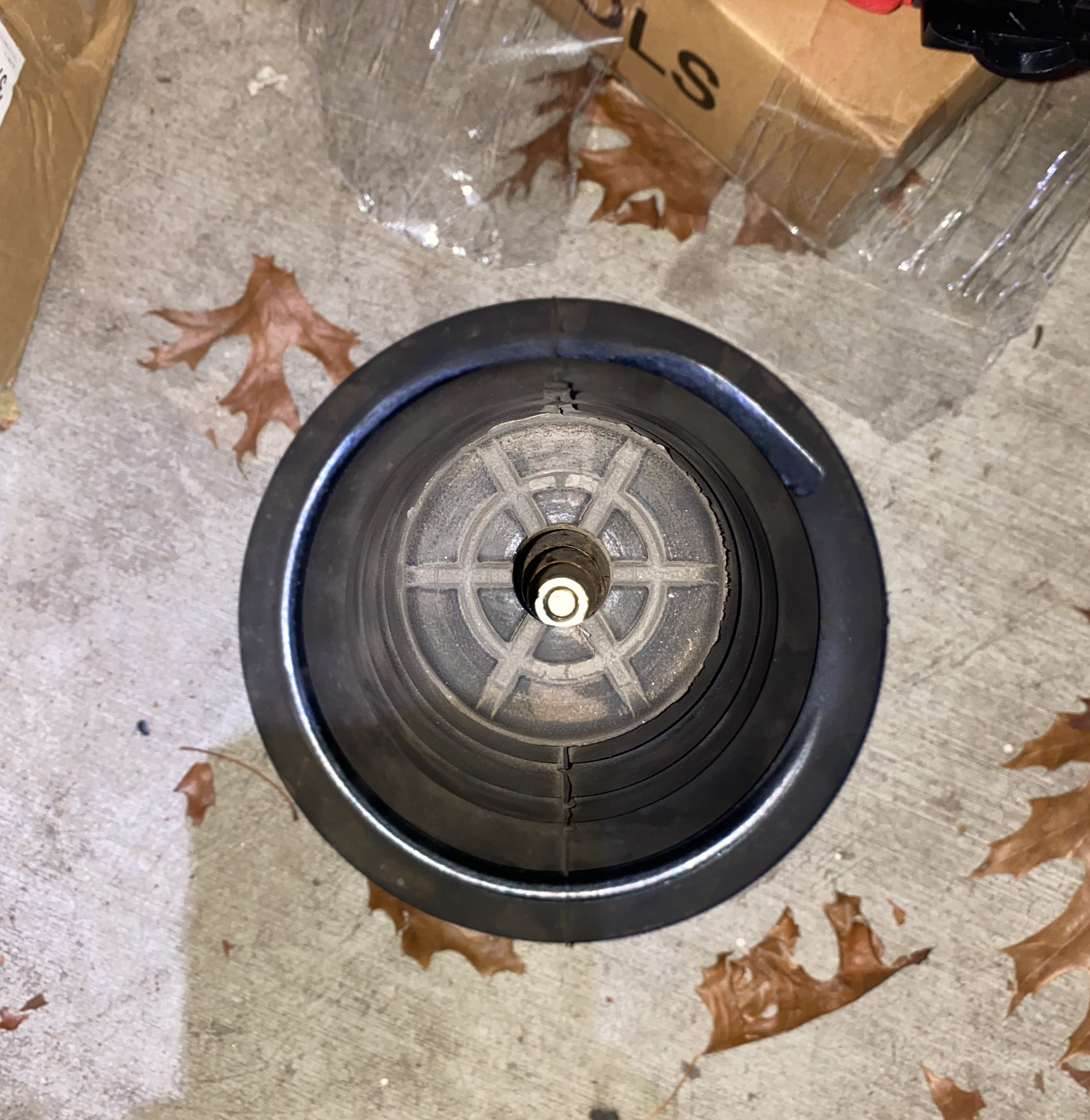

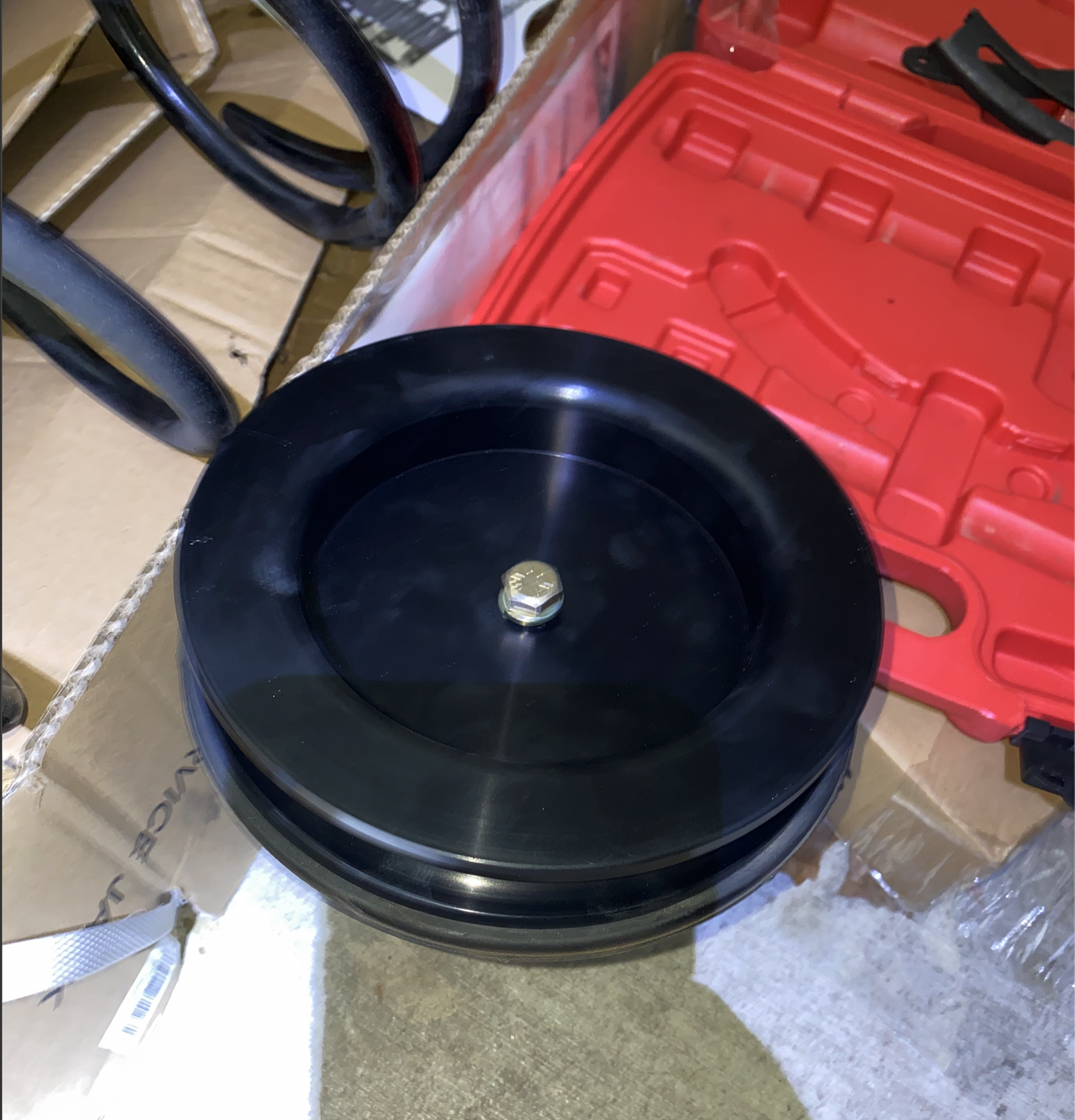

That's what I would expect. Guess I'm confused as @AnyMal 's pic shows a rubber donut in the stack?
Yeah its the existing one.
If you look inside the bucket, the surface is not flat, its dimpled at the stud posts.
My rubber spacer conforms to that, and also fills the outer diameter.
The westcott locates on the studs and is designed to only fit one way to all 4 studs. There is almost no play in it with the way that it was designed. You have to rotate it until it slips on.
The way ive stacked my two, ill get metal to metal at the bucket for a more true torque reading this time, and the rubber “isolator” spacer im still using will help center as well.
Either way there is no play @TeCKis300 , and i rechecked torque in my last install, nothing had budged.

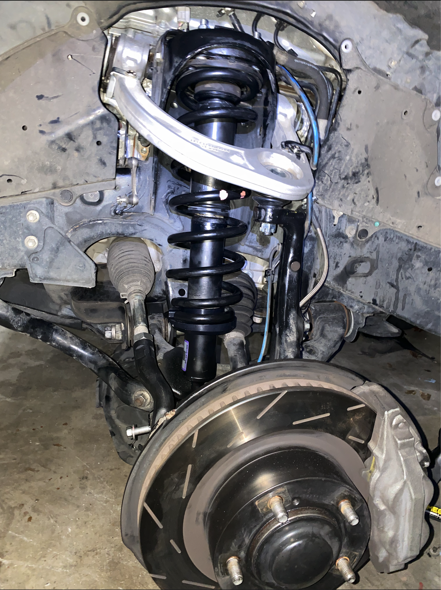

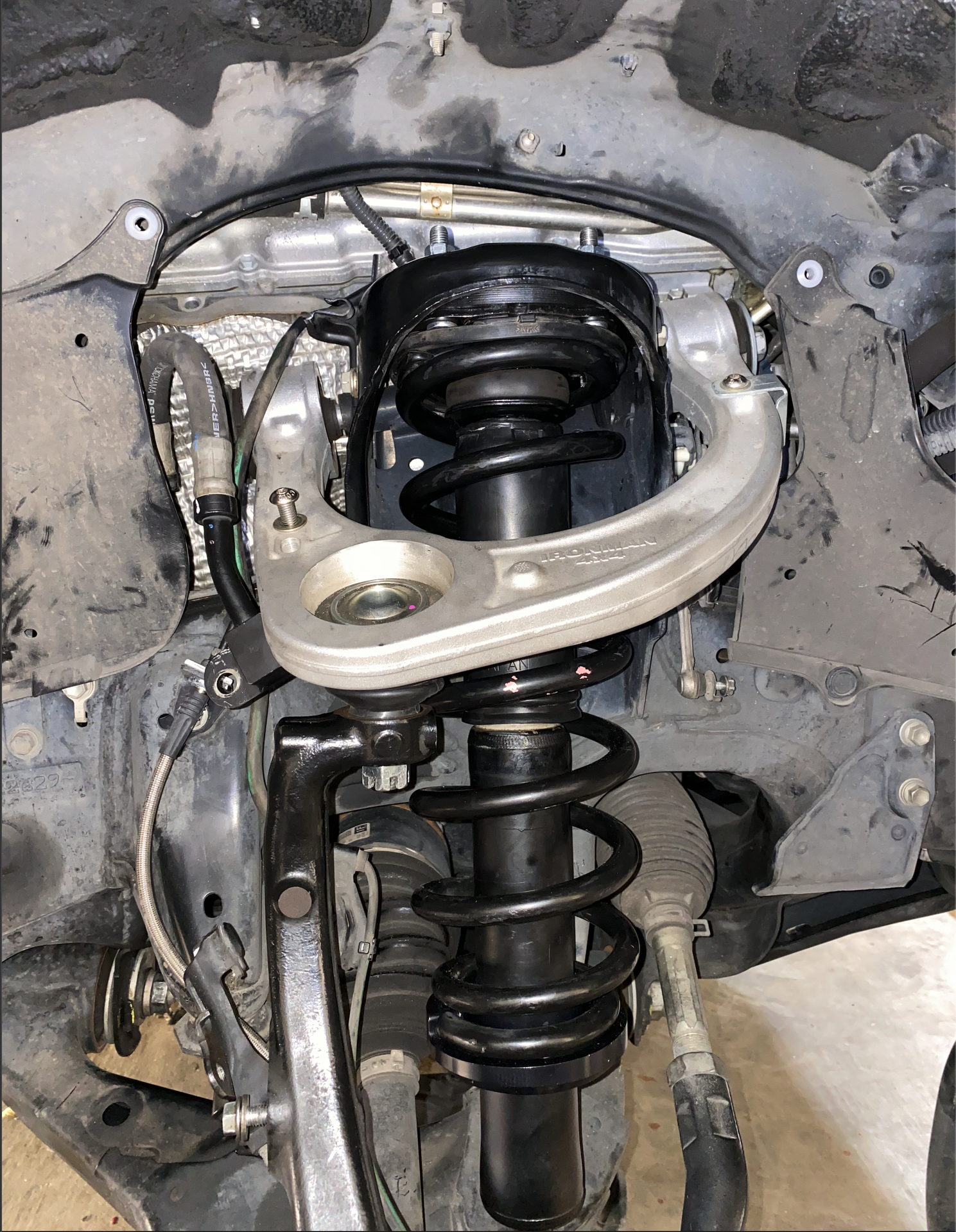

The passenger is in! And boy oh boy was there A LOT of drama.
Fitting that tall ass strut assembly back in there was an utter nightmare.
So much so that I had to cam out my LCA for the coil seat to clear the bump stop sloped mount in the front to pull the shock mount forward for clearance.
So much so that I had to grind out a sliver of the bucket at each side to slip the top spacer through.
This is with everything but the axle and tie rod already completely loosened.
Including the speed sensors detached, slacked, and UCA zip tied up out of the way (im not dealing with that long bolt again).
Good news is the dual locking jaw style compressors worked a treat.
I had a shock alignment issue at first where the top hat no longer matched up to the bucket.
I had the preload collar exact, and the coil EXACTLY where its indentions were on the top hat.
But that clocked it off by about 45 degrees.
It seems that with the preload, the coil rotates a bit under compression, as i believe is normal for a coil to do.
Since its losing length, the coil twists as it compresses. So if youre anal like me and wanted it perfect, that will not work.
Just mark your shock eyelet and collar and but the top plate out markings exactly lined up to the shock mount eyelets outer rim.
The real fun part was the AHC hose, and as im sure @Killacaviar knows, you cant really see s***.
I experienced exactly what you mentioned in the other thread (there are so many) but i did not clock the rubber hose standoff.
My ahc hose did not like that sideways movement. If i twisted it into the sideways possition, the hose collapsed in on itself.
Instead i notched both sides and it fell right in.
I even notched the washer to slip into that gap, and stay there.
The pro tip.
When you reassemble the strut, you want to torque your top nut with that hose standoff bushing clocked exactly in line with everything mentioned above.
Trying to safely alter its position is not only pushing the coil against that whole top plate rubber seat, but also torquing your shocks AHC hard line inlet.
I was stupid for trying to align it to the wear marks, when really, lining this up can be done by eye.
This is pretty much how it should look up there.

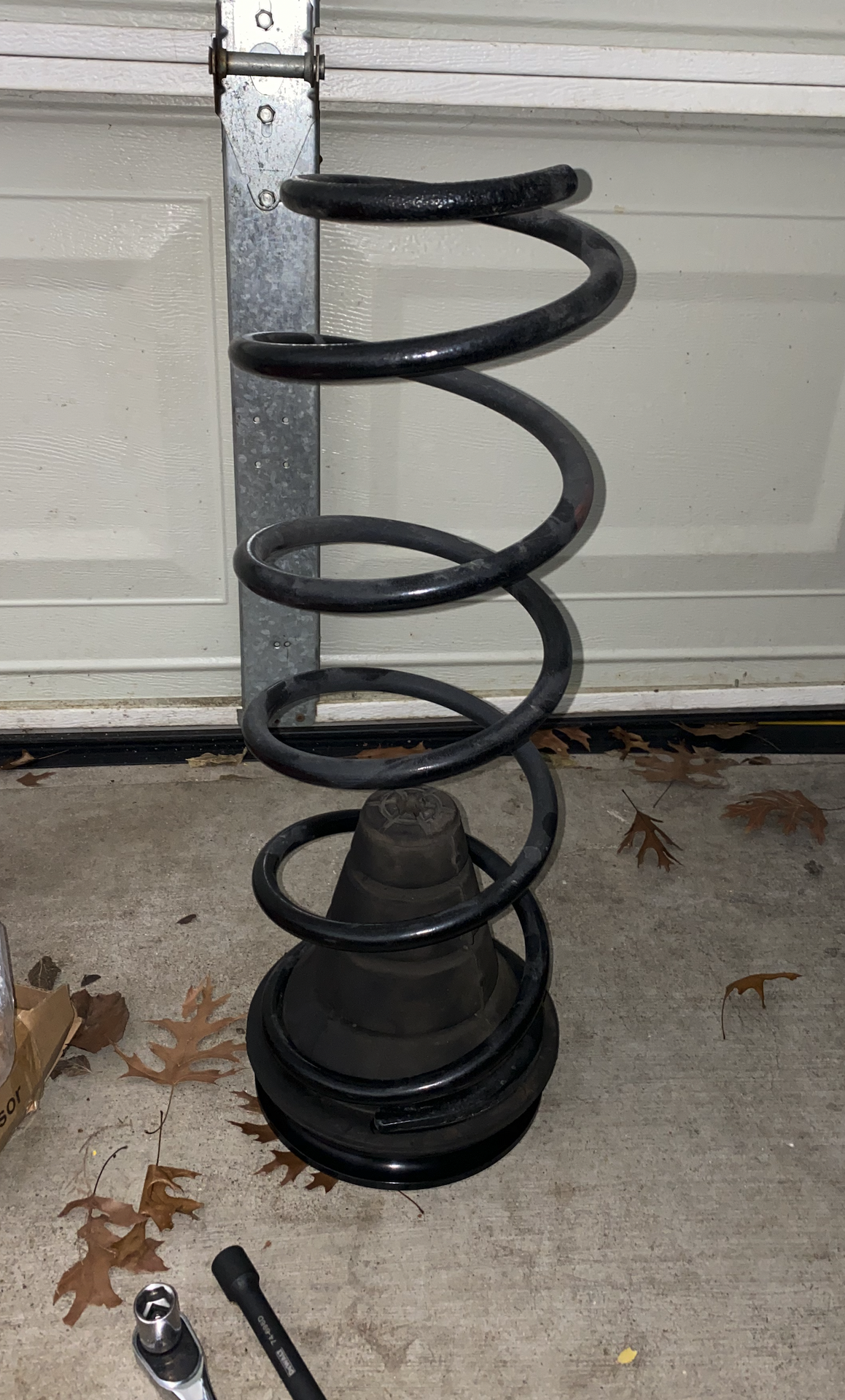

So with all my love marks, can anyone recomend the best hardening oem like touch up paint for all my maring of the coil, ahc fitting, bucket etc?
Just installed new coils over the weekend and had the cheapo rental spring compressor pop. Luckly no one was injured, but yeah.. take extra precaution guys when installing new springs and use a good heavy duty spring compressor.
So just finished the other strut. Remember that “good” compressor i posted?
I decided out of caution to lube and inspect it. One side had most of the threads chewed through. The thread collar inside the body was only like 1/4”. 1/4” of s***ty threads holding your life together. Good thing i ordered three and used the other one.
I dissembled it first and the inside threading was an inch on this one, however all the other pieces were cheaper chinesium.
Apparently SPC makes the “real” one, I’m buying copies of copies.
Specialty Products 40260 Universal Spring Compressor https://www.amazon.com/dp/B0039K4AJA?tag=ihco-20
And its 3x the price.
All of this junk is getting returned, and i don’t think ill be doing coil compression for a long while after this.
And Amazon is unusably bad these days. Its getting old.
There is just so many copy nonsense ”brands”, pages and pages of marked up ali baba drop shipped garbage stockpiled to the US.
$170 doesn’t seem so bad to get a specialty tool. Considering what you’re saving on professional install anyhow.
Do they just not make them like they use to anymore? I have a basic HF spring compressor that I've probably had for 20 yrs and used on prob 10+ installs for myself and friends. Should I knock on wood?
You're probably already doing this but might be worth mentioning... try to grab as many coils as possible at the far ends of the coils as possible, with the compression tool at its full extension. That reduces forces and maximizes compressed length. Grease the threads. Try and compress eveningly.
Shame about the spring compressor, but at least you got the job done and lived to tell the tale. Springs are something I refuse to touch; knowing myself as well as I do, I'd manage to level the whole neighbourhood in the process.

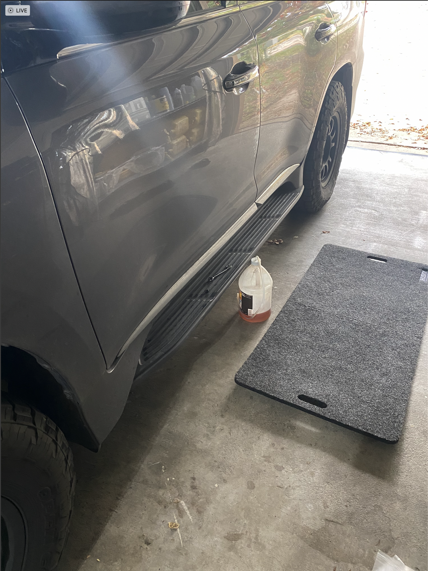

Installing the Westcott Lift Kit:
On this nice 80 degree december day in Texas. Pouring sweat...
Took a quick before pic yesterday as i realized i dont have many photos as it is now, truck is off obviously parked so it rides a bit higher when pressurized.
Specially in the rear.
Step 1: Slam it.
Step 2, lug nuts loosened then and jack:
Step 3: Always top up AHC after any bleeding
This is how i do it, and it couldnt be any easier from all the various methods ive tried. Just a long ass funnel jammed into the inlet tube, sealed with elec tape to avoid leaks. I can do it wheels on and off.
